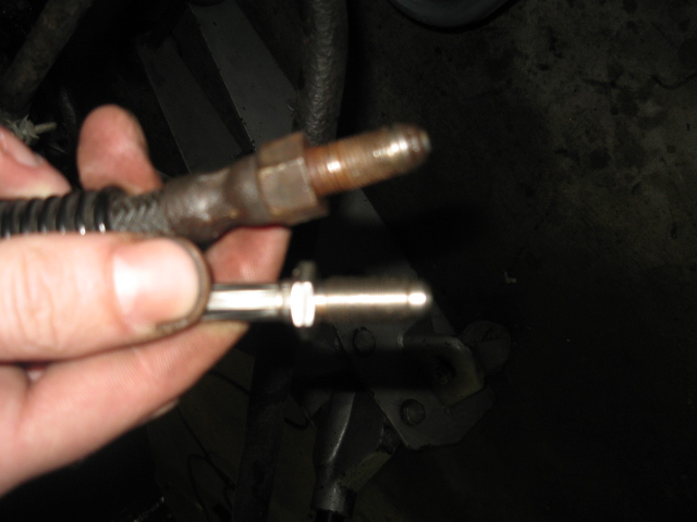

Got some questions on the lines. I tried removing the old ones but one needs a bit more soak in WD to get unstuck. Almost broke the support bracket..
Anyway, here's a pic of the old and the new lines. I tried a fit but it seems that the 6-side bit is too short. The original are at least 9mm and the new ones are only 4mm thick. This way, the hose will spin in the socket. Almost impossible to tighten up because they keep spinning.

Postby RobvdVeer » Mon Apr 11, 2011 10:18 pm
Anybody else had that same thing happening?

Postby RobvdVeer » Sat Apr 16, 2011 12:09 pm
Peter Filsell wrote:Hi Rob,
I know Julian is out of the country till Monday, when he's back im sure he will be able to advise but Im sure Malc and Jules changed their brake lines the other weekend without any issues?
Count yourselves lucky, took me all week to remove the old ones on the front only.
Anyhow I ground of the fixed nuts on the brackets so I can use 2 spanners to tighten them, and the new ones are all tightened up now. The rears will have to wait until autumn.
