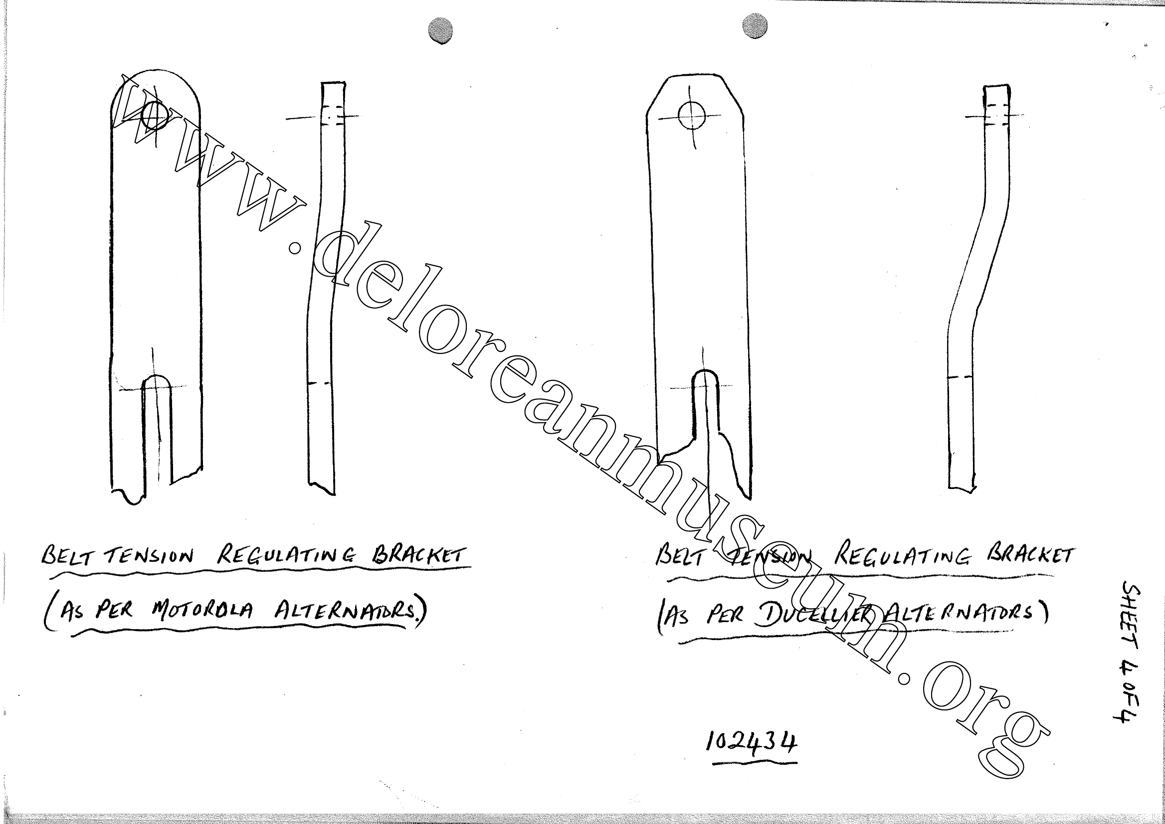

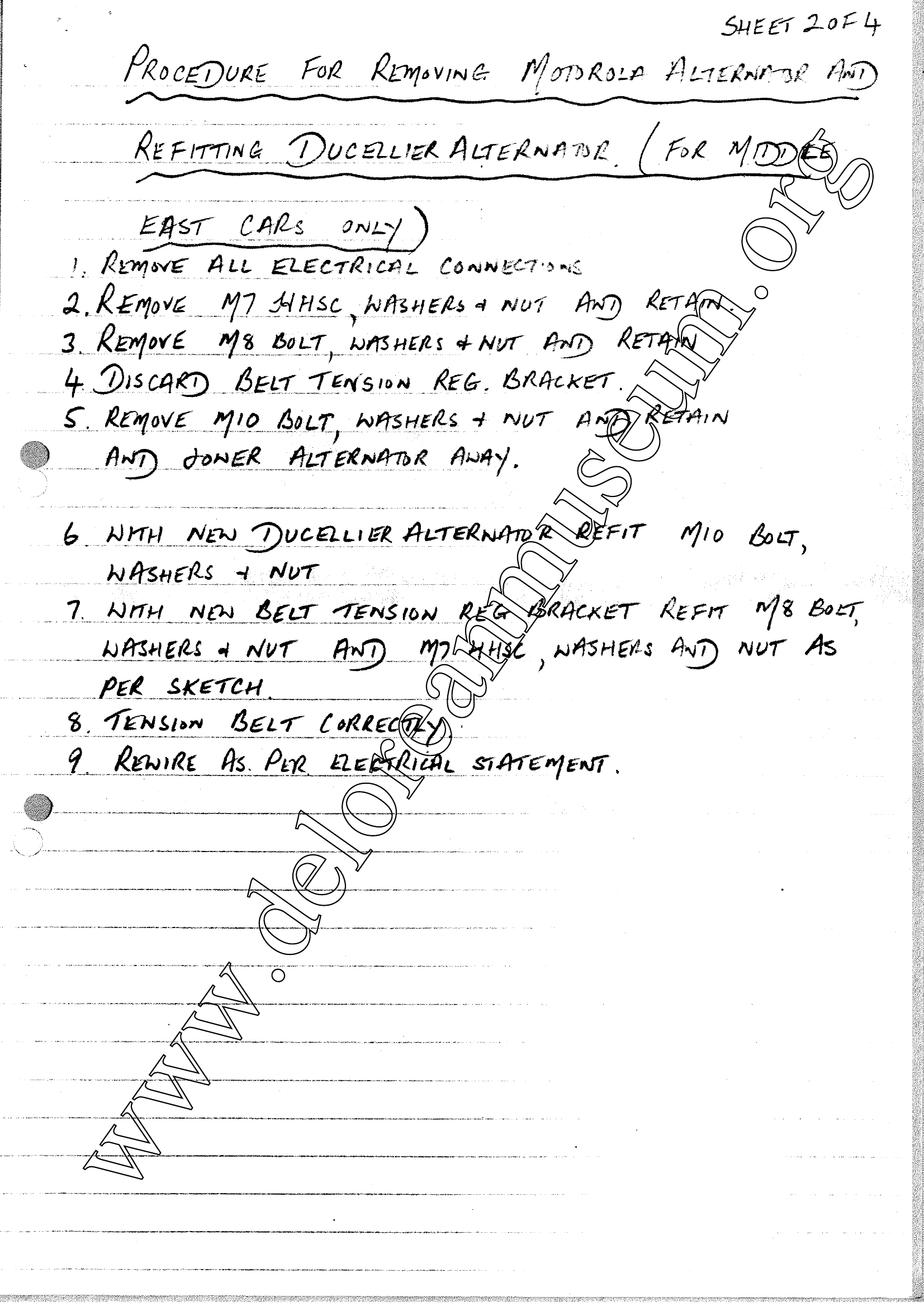

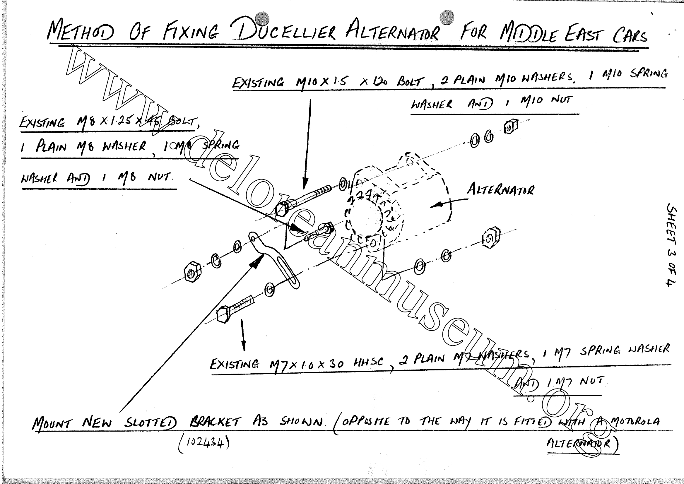

This TSA issued on 3/2/82 (also mentions that the 50 cars were already built which ties in with the Vin's) concerns the replacement of the Motorola alternator with the earlier Ducellier model.

More documents relating to this original TSA.
