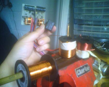

Postby Admin-bloke » Thu May 20, 2010 1:24 pm
Al, I thought I would show you a pic of your central locking pre-repair.
Shows the replacement relay (experimental and blagged for free from a supplier)
Shows an oem coil (purple) against my rewound copper enamelled thicker wire.
The central locking is now fully working
1 solenoid is now fully working

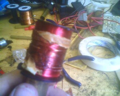

The second pic shows the burnt out solenoid.
This spool shattered when unwinding it heat build up in it.
As soon as you send me another couple of duff ones I will make as many good ones as I can with the parts.
Enjoy :D
