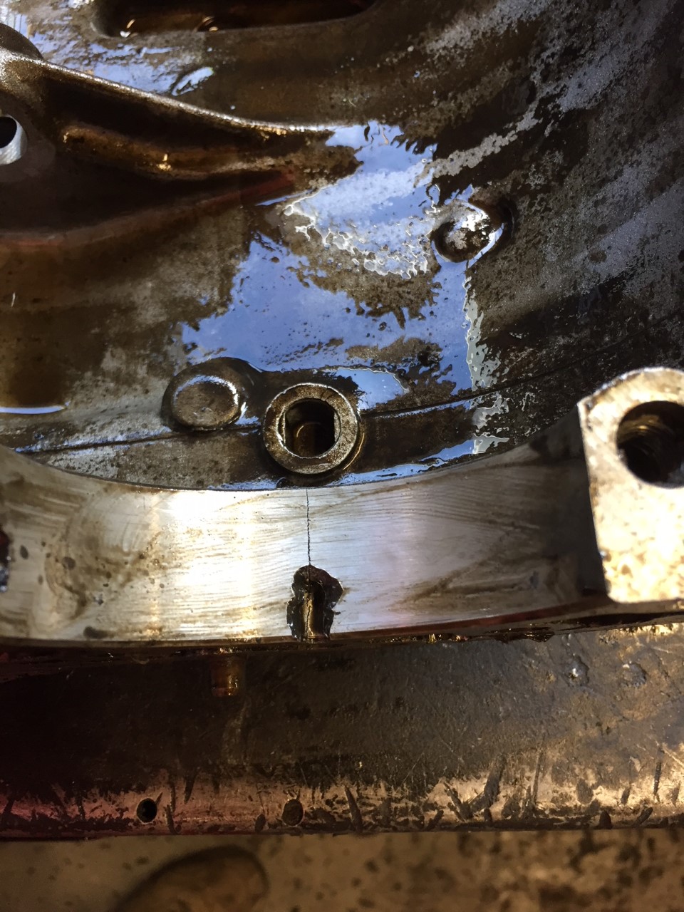

it went up to Eds to have the cold start looked at, and he noticed that the gearbox was leaking oil.
now its always had a slow leak that looked like the crank case seal but it was very slow so id figured id wait until the clutch needed servicing before getting it changed.
however it seemed the leak had gotten much worse, as it also appeared that under the paint on the transmission casing, there was a lot of blue sealant that seemed to be letting oil through.
so it was decided to haul the box out, and have all the gaskets changed.
upon doing so, it was found where the the main part of the leak was coming from
the bearing case had chunk missing out of it along with a crack that ran into gearbox.
after a discussion and concluding that the case was toast, Ed managed to find a spare case and rebuilt the gearbox in that.

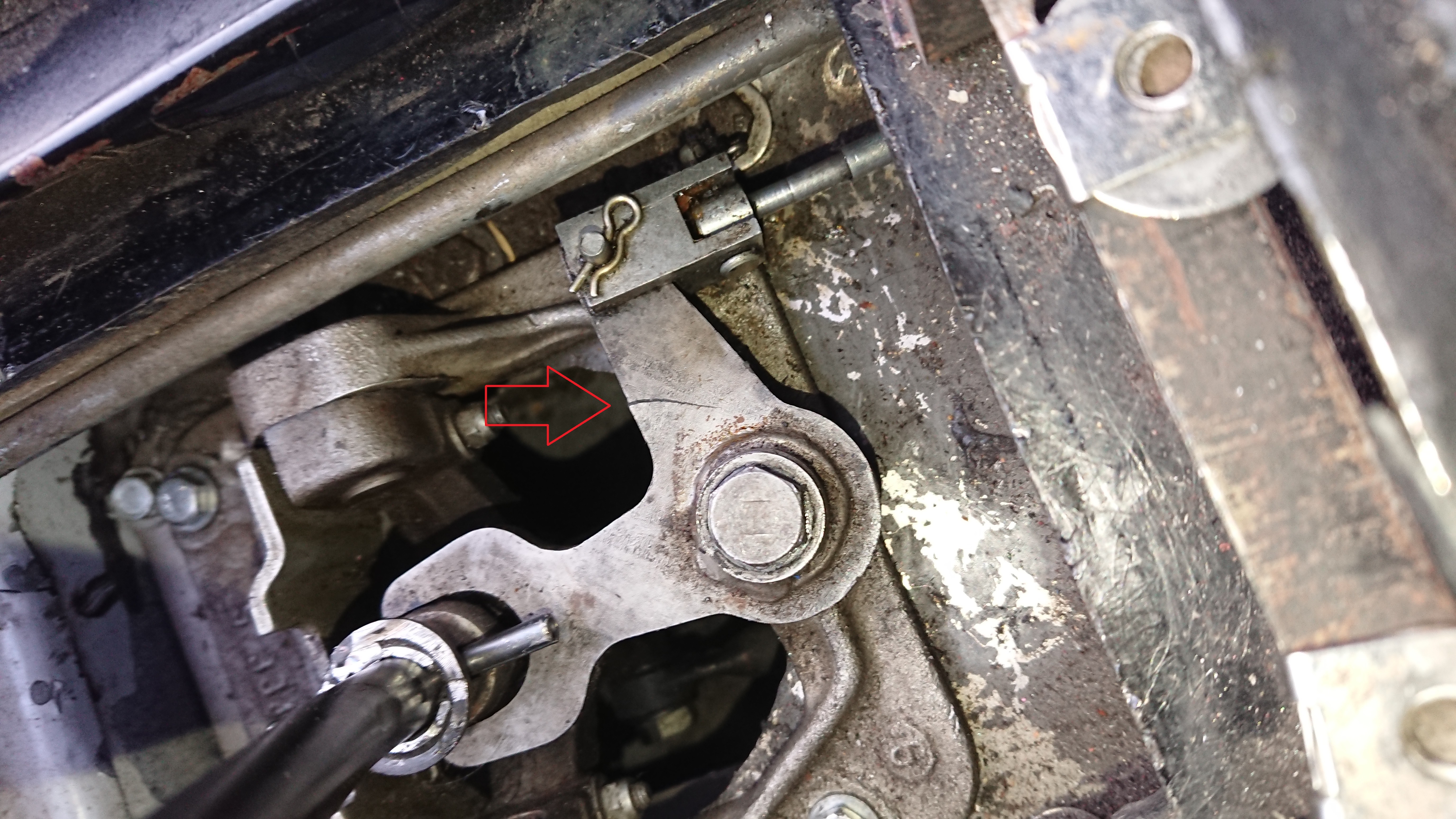

when i stopped for fuel half way home, i selected reverse to pull out of the carpark space and when i lifted the clutch, i got an odd noise followed by the car lurching forwards and then stalling. i then discovered that i could no longer move the stick.
thinking it might be the linkage, i dismantled the shifter cover in the service station car park and found this.
the rotating arm on the shifter was cracked and bent and it wouldnt come out of gear.
cue calling ADAC to get it towed to safety and then a call to Ed to get it trucked back to his place.
he found that the plate the shifter had been mounted on was moving by about 500-800mm when you pulled up on the stick to select reverse.
so over time it had been slowly bending this arm until eventually it had failed. the result was that when i selected reverse it had basically tried to select 2 gears at once bent a few things in side the box and jammed it in gear.
so, gearbox out again to be taken apart and repaired, the shifter arm was repaired and re-enforcement plating was added to the area around the shifter to stop it from flexing.
