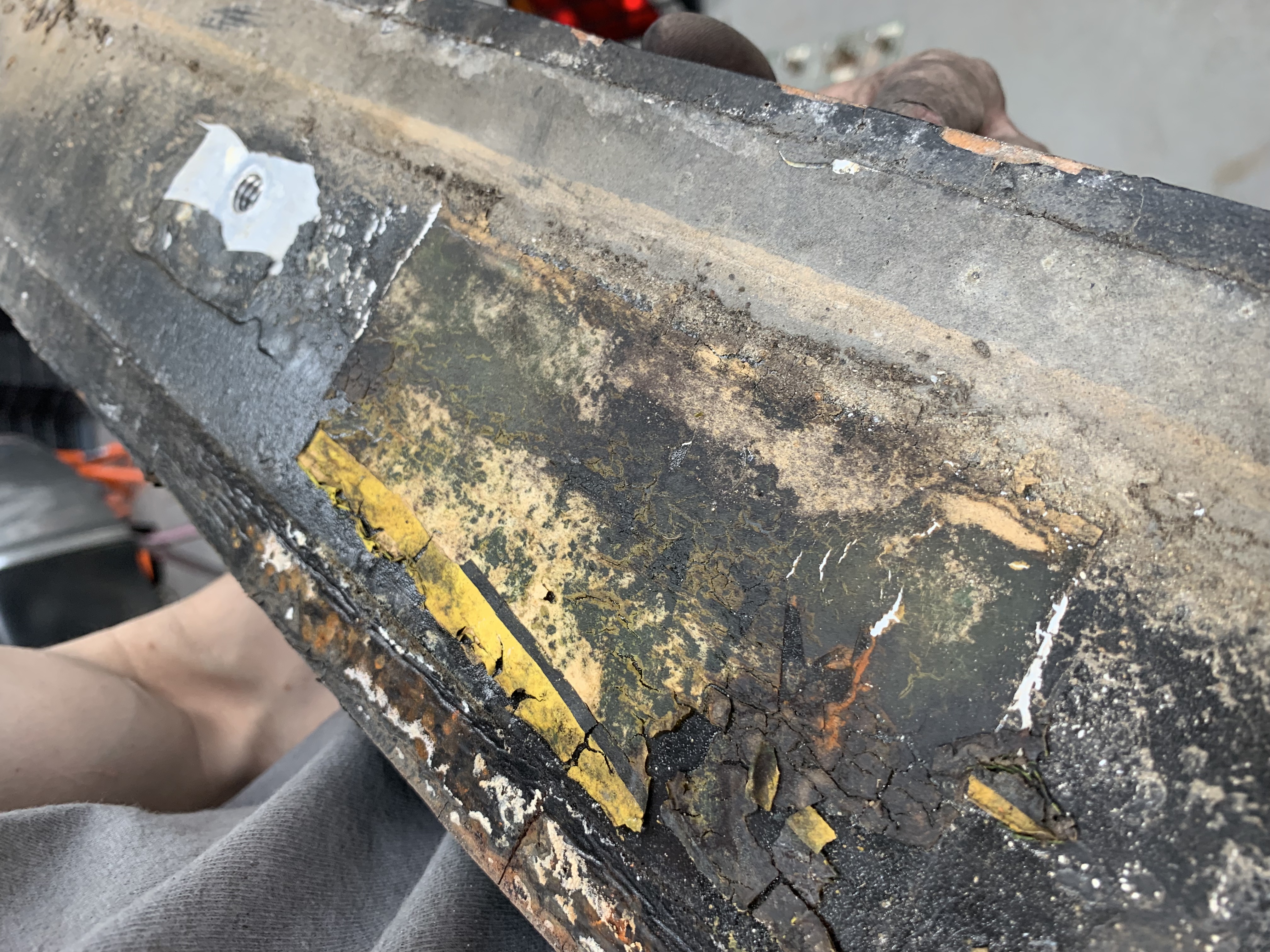

As you can see the number on the frame matches the VIN (11777). The question is, is this the original frame?
The photo below suggests some tampering and welding on the back of the chassis…
Finally, thanks to Alistair, we were able to identify the evidence of a yellow label on the back of the frame and impact foam, which all the Middle Eastern cars had. You can just make out the words in the pic below.
So, still no closer to the truth, but my gut feeling is this is still not 11777 and that someone down the lone has covered their tracks.

Postby A Van » Wed May 19, 2021 8:01 pm
It was quite good being on the video call while you unbolted it!
Here is what mine looked like reference the labelImage

Interesting stuff, Al is the man on the ME stuff
Re: VIN 11777 Middle Eastern Car - Carl's Car
Postby andyd » Wed May 19, 2021 10:33 pm
The photo below suggests some tampering and welding on the back of the chassis…[my gut feeling is this is still not 11777 and that someone down the lone has covered their tracks.
Carl, do you think a non-Irish hand wrote the number on?
Yep, interesting stuff, love a bit of history on these cars!
