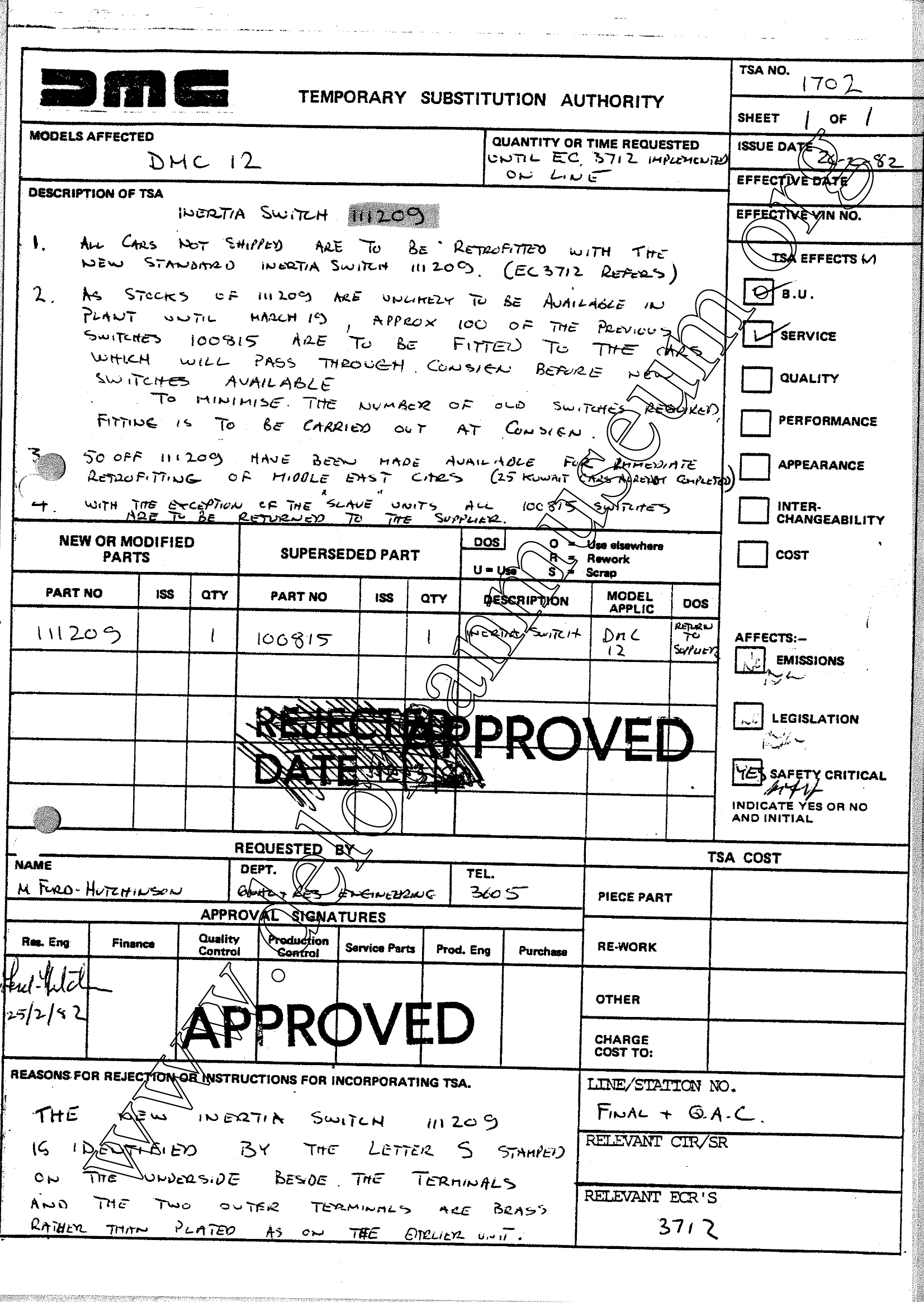

Temporary Substition Authority for change of Inertia switch, also mentions the 25 Kuwait cars were already completed at this stage.
Recently uncovered in the DMC archive.

Interesting info on the switch ... now I know how to identify the later type :)
