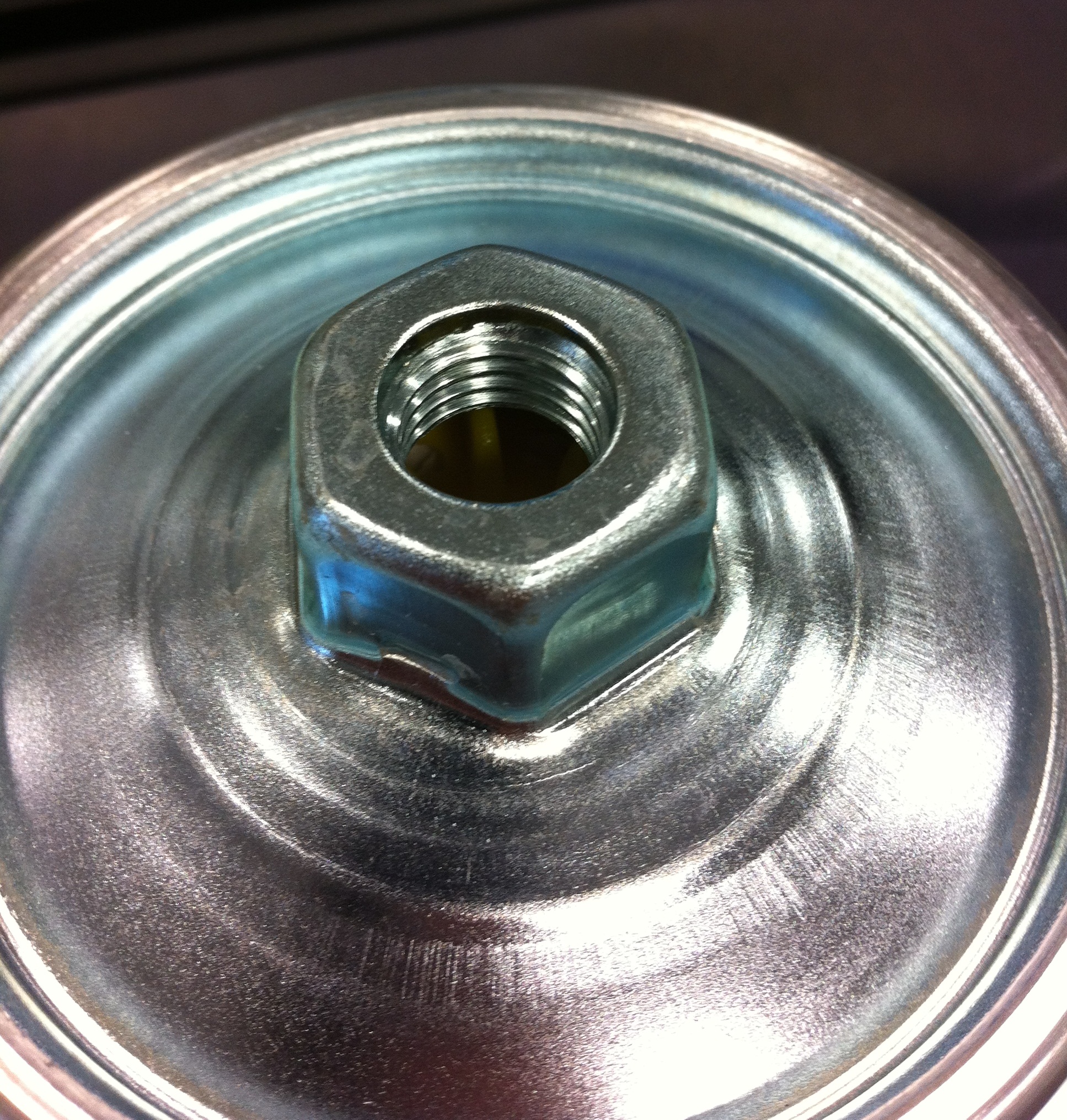

Chris, I discovered the same issue the other week, the Bosch filter has been redesigned and the thread is no longer built into the housing of the filter, it's a captive nut - result being, it's no longer suitable for the D and will leak if used.

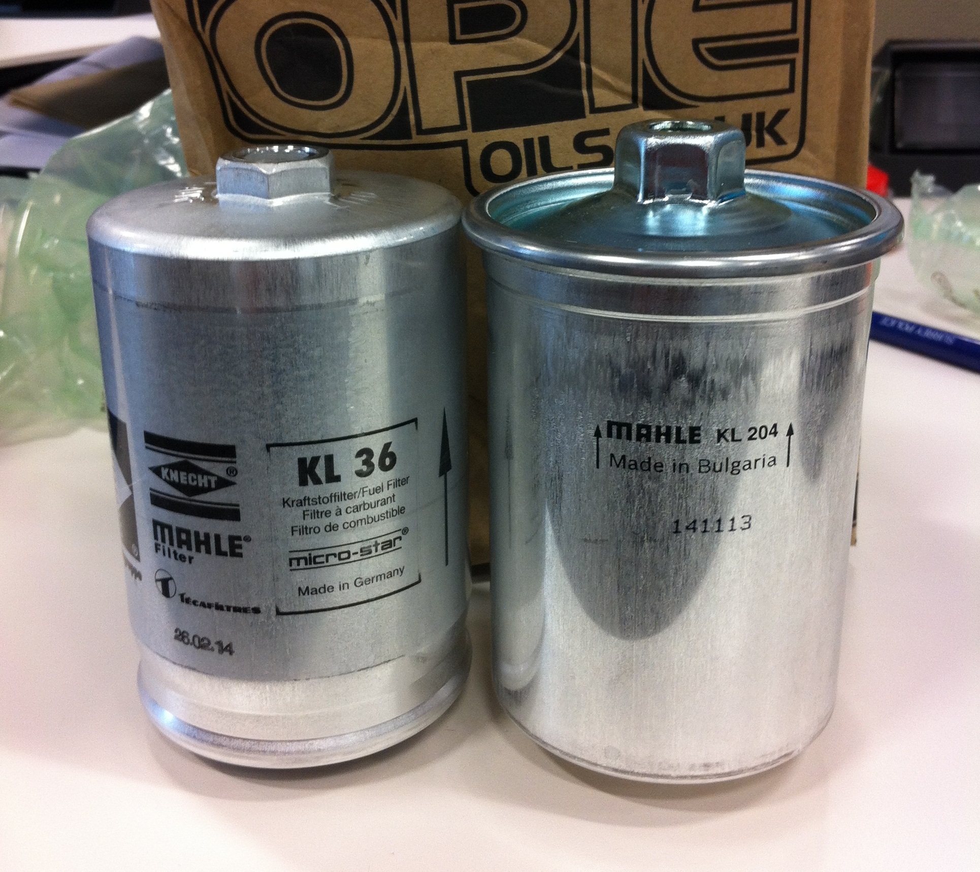

As a replacement, I used the Mahle KL 204, I held off on posting up the part number as I wanted to do put a few miles on it first: http://www.opieoils.co.uk/p-60849-mahle ... saab-.aspx

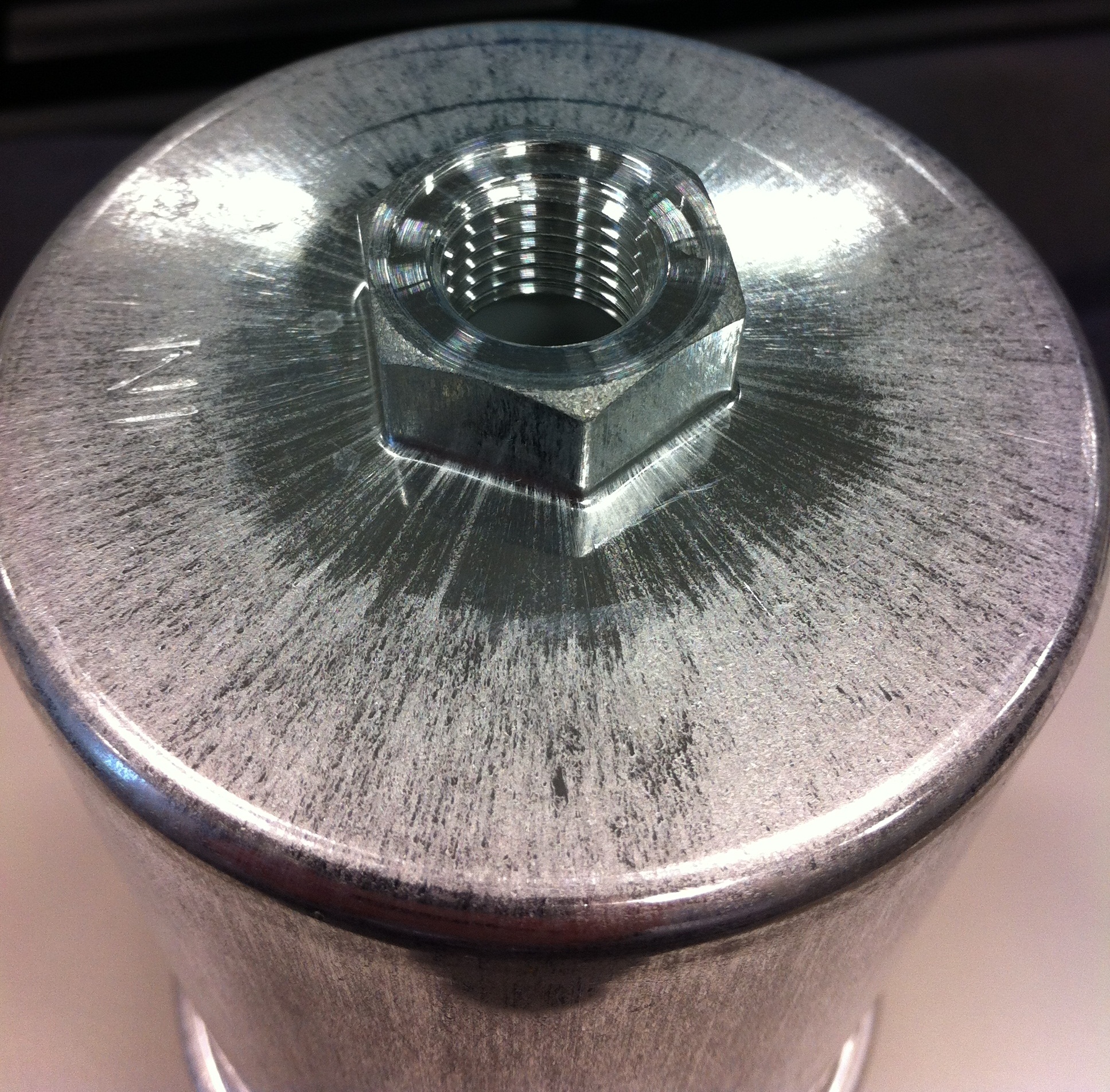

The KL 36 will also work, however the KL 204 best matches the original filter (the KL 204 also comes with copper crush washers for the banjo bolt):
KL 204 Outlet:
KL 204 Inlet:
Re: Servicing Items and Part Numbers
