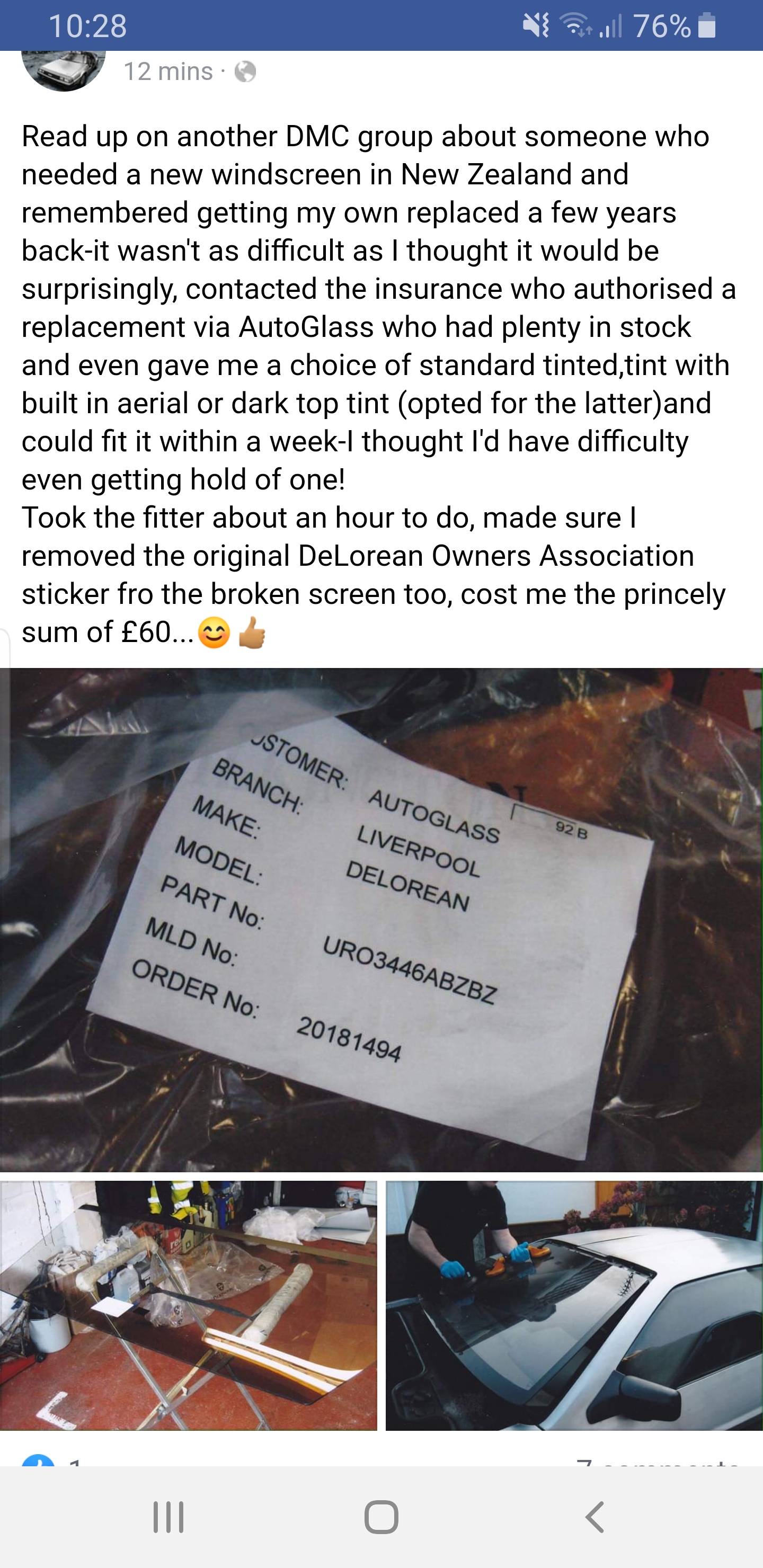

Postby DMC1983 » Sat Sep 05, 2020 4:13 am
I remember screencapping this from facebook quite a while ago if this helps
Screenshot_20191102-102858_Samsung Internet.jpg (1.46 MiB) Viewed 2495 times

Useful tip from http://support.delorean.com/kb/a74/windshields.aspx,
CAUTION: With the windshield removed and the doors open, the roof may actually sag slightly. If the new windshield is glued in place and allowed to cure with the doors open, you'll find that the doors do not close well any more. To prevent this, it is extremely important that you close the doors as soon as the glass is set in place, and keep them closed for at least 12 hours.
I did read you should prop the roof when doing it....re-enforced a bit here http://dmctalk.org/showthread.php?600-W ... eplacement
Bummer about your ripple James, I had the same in a previous car and you are right once you have seen it , it always catches your eye....
