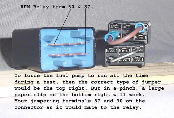

Postby delorean12uk » Sat May 15, 2010 9:49 pm
I'm afraid mr Biggles it's gonna be a process of elemination. Do what Admin stig man said first by testing for a spark, if you have one then there are 2 wires to short out on the RPM relay to overide the pump, that will test to see if thats working. Off hand I have no idea what those wires are because I have left my wiring diagram over my garage, but one of the wires is brown and the other wire is what goes directly to the pump, I believe the wires are directly diagonal to one another on the RPM replay plug.

Postby Admin-bloke » Sat May 15, 2010 10:11 pm
If you get a spark then try as what J suggests.
You could try linking the fuel pump connection as a temporary way of diagnosing the problem
Picture from SpecialTAuto
http://www.specialtauto.com/delorean-pa ... jumper.jpg
Do not use the link as a permanent solution as it bypasses a safety function that the relay provides, nor does it give power to the CPR heater circuit.
