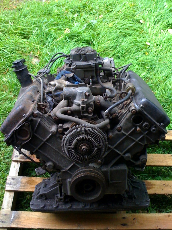

Picked up today:

Postby arranj » Wed Aug 26, 2009 8:46 pm
Great news Tom.
Is there some reason why this doesn't look anything like a DeLorean engine?!
Re: I have an engine!
Postby tourettes tony » Wed Aug 26, 2009 9:33 pm
flywheels on the wrong end :shock: TT
Postby arranj » Wed Aug 26, 2009 10:09 pm
Seriously though, you're swapping a few parts here? What's the difference between this and the engine we all have? :?
Postby DeLorean Cars » Wed Aug 26, 2009 10:31 pm
Steel covers and a flex plate (automatic) with carbs. Probably a 2.6 unless it's from a Pug (don't have much experience of them). The only 2.8 carb that I know of is a GTA atmo and they're all 5-speeds
Postby arranj » Thu Aug 27, 2009 12:59 pm
Yep - I think it's from a Peugeot, although not from a Dakar Rally car! :mrgreen:

Postby DMCDELLBOY » Fri Aug 28, 2009 8:51 pm
may be a late 760 dissy in a diffrent place i think ;good to get old of now ;i think engines are getting very scarce now i have a complete engine out of 262 volvo bertone for a just in case .

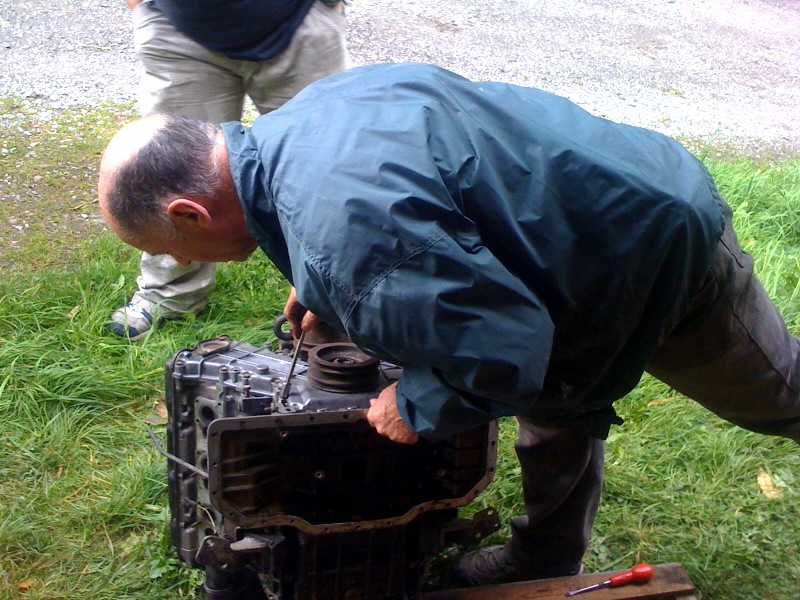

Sallys watching The x factors on telly so i thought i'd give you a bit of an update on the engine situation.

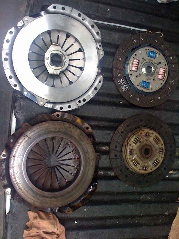

First off, it's off a peugeot 505 auto, which has been rebuilt with new chains, cams and other very interesting bits n bobs. i just picked up a new clutch for it today as well for the bargain price of £100
This morning i started to strip the knackerd engine down, removing the sump sandwich plate and a pipe or 2. The block is a bit of a bodge i may turn it in to a coffee table and get my own back.
As my mornings start at around 2pm i didn't get chance to put the old bits on the new engine, i'll do that tomorrow starting at the crack of dinnertime.
The good news is that while i was taking all the various nuts and bolts off i didn't break, thread, round off or lose anything at all, even the exhaust studs came out ok :shock:
Here are some piccies of the eventfull day
BTW the dizzy will need to be changed for my one as peugeot used a computer thingamabob instead of the volvo/delorean setup
and the other item to note is that the engine will only run on carbs as there are no injector holes :o
OH and its got a mecanical fuel pump running off the other cam shaft, its up to me if i want to use this or the elrctric one i installed in the fuel tank

They're the same, right? I got the part number off here.
photo 4.jpg (180.5 KiB) Viewed 5317 times
