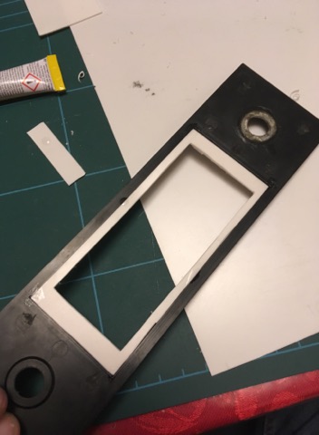

I saw Tristan's post on the forum and I noticed he had modified his Craig faceplate, I didn't realise that this was because the faceplate supplied with the Retrosound stereo is not wide enough. Anyway I decided that I'd modify the original faceplate to accommodate the smaller display on the Retrosound.

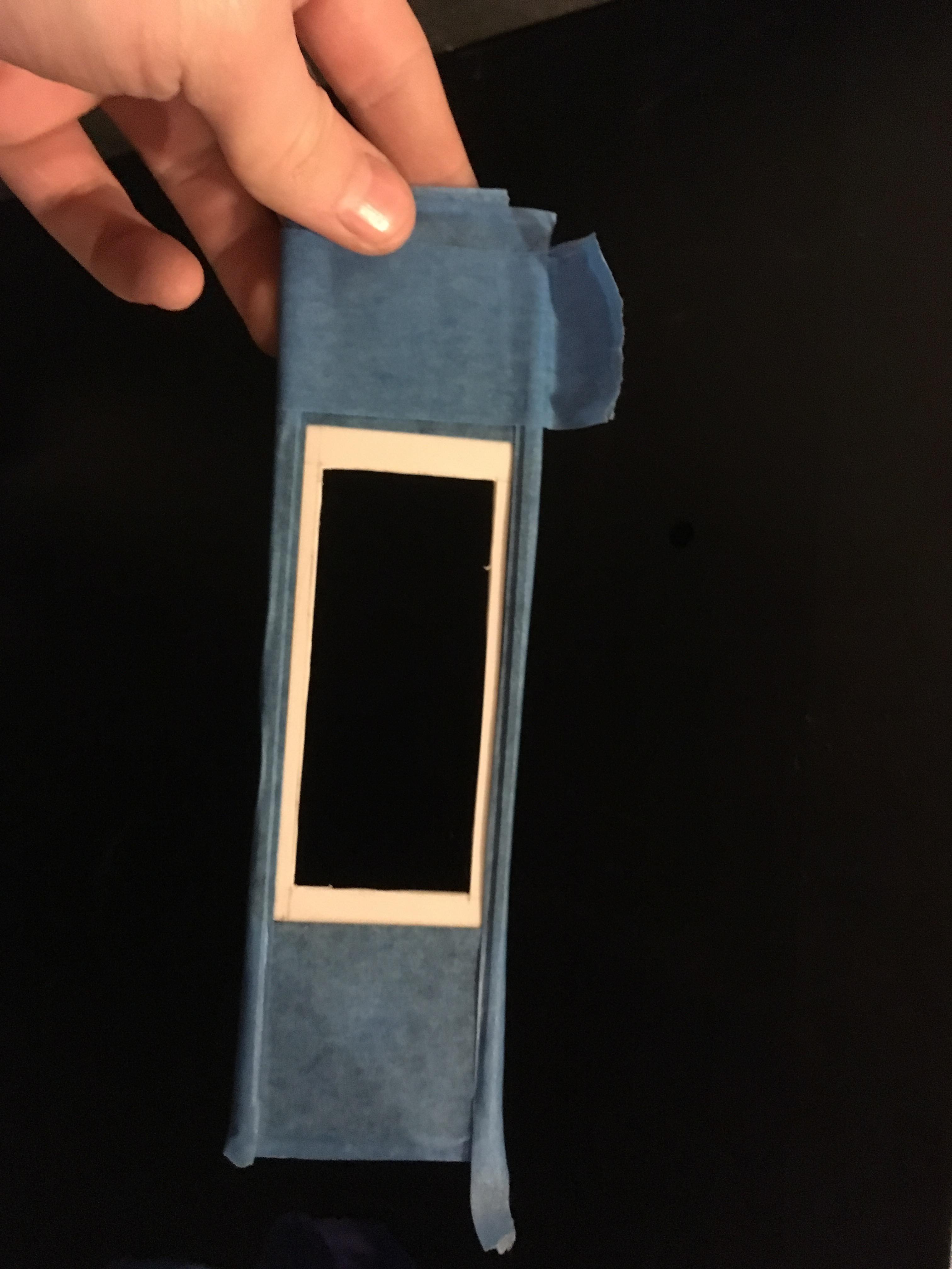

I super-glued a couple of sheets of Styrene together, cut them to size and glued it to the Craig faceplate.
After a little filing it was ready for paint!
A coat of satin black from Halfrauds and it looks nice :D

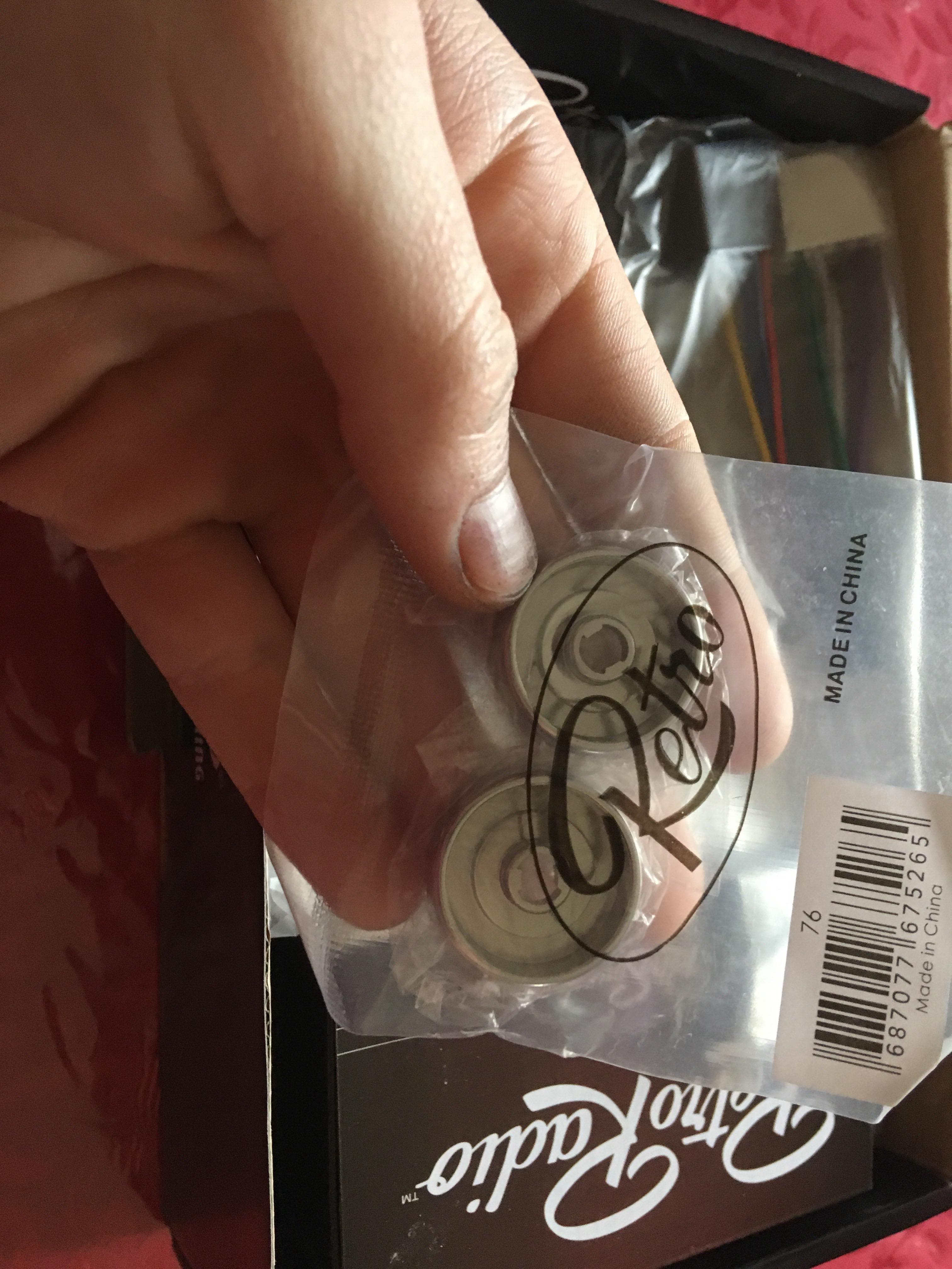

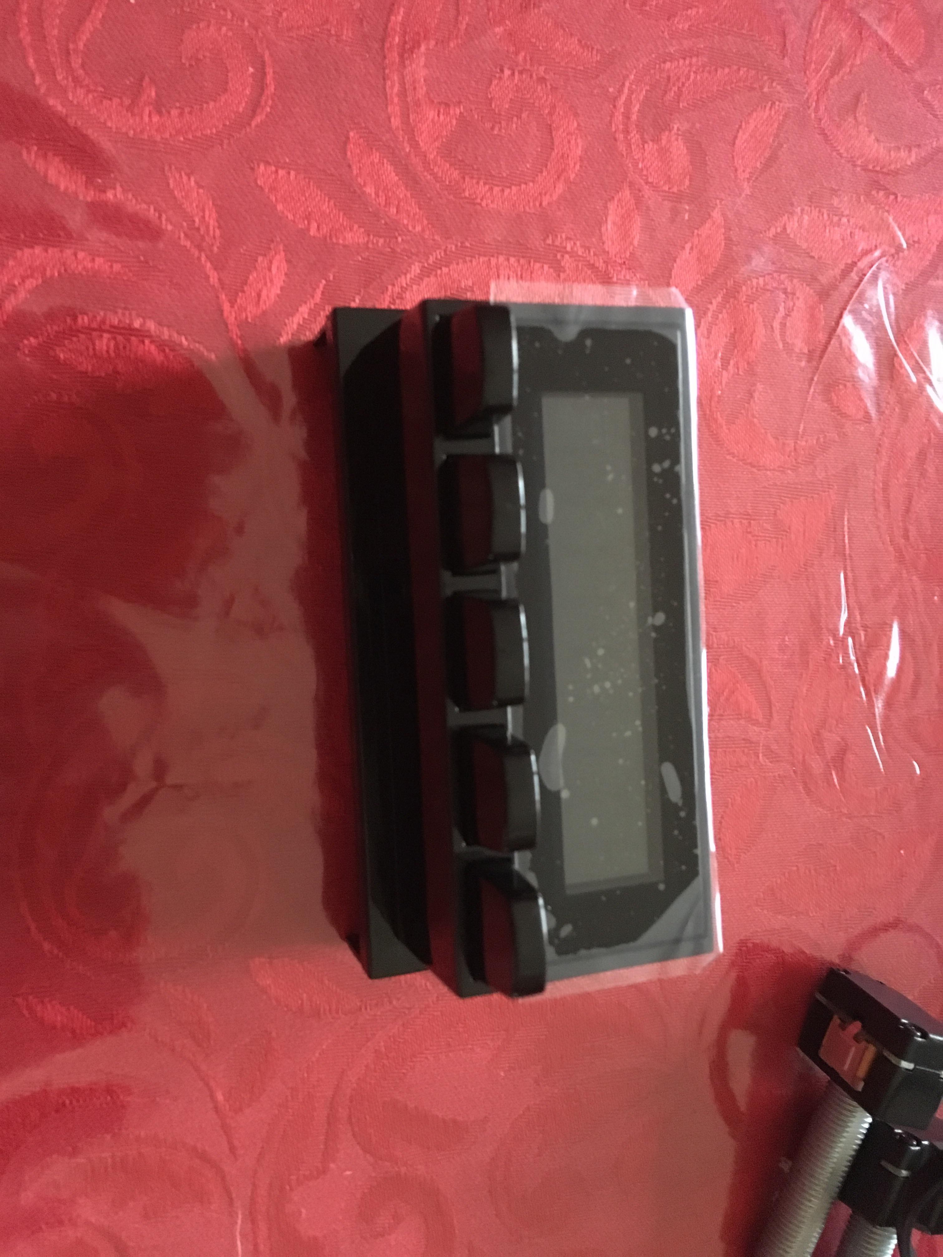

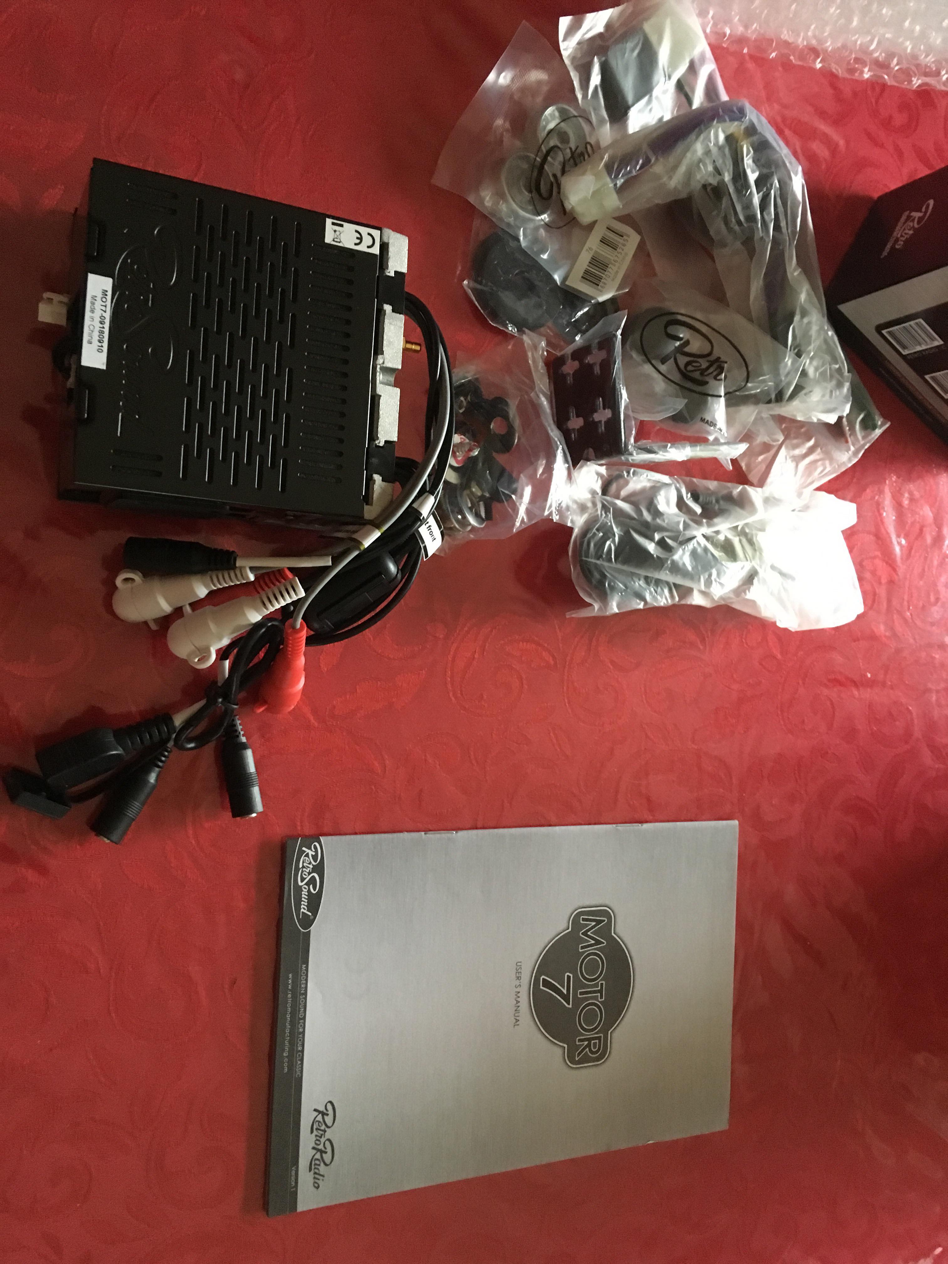

So the Stereo arrived! here are some photos of it:

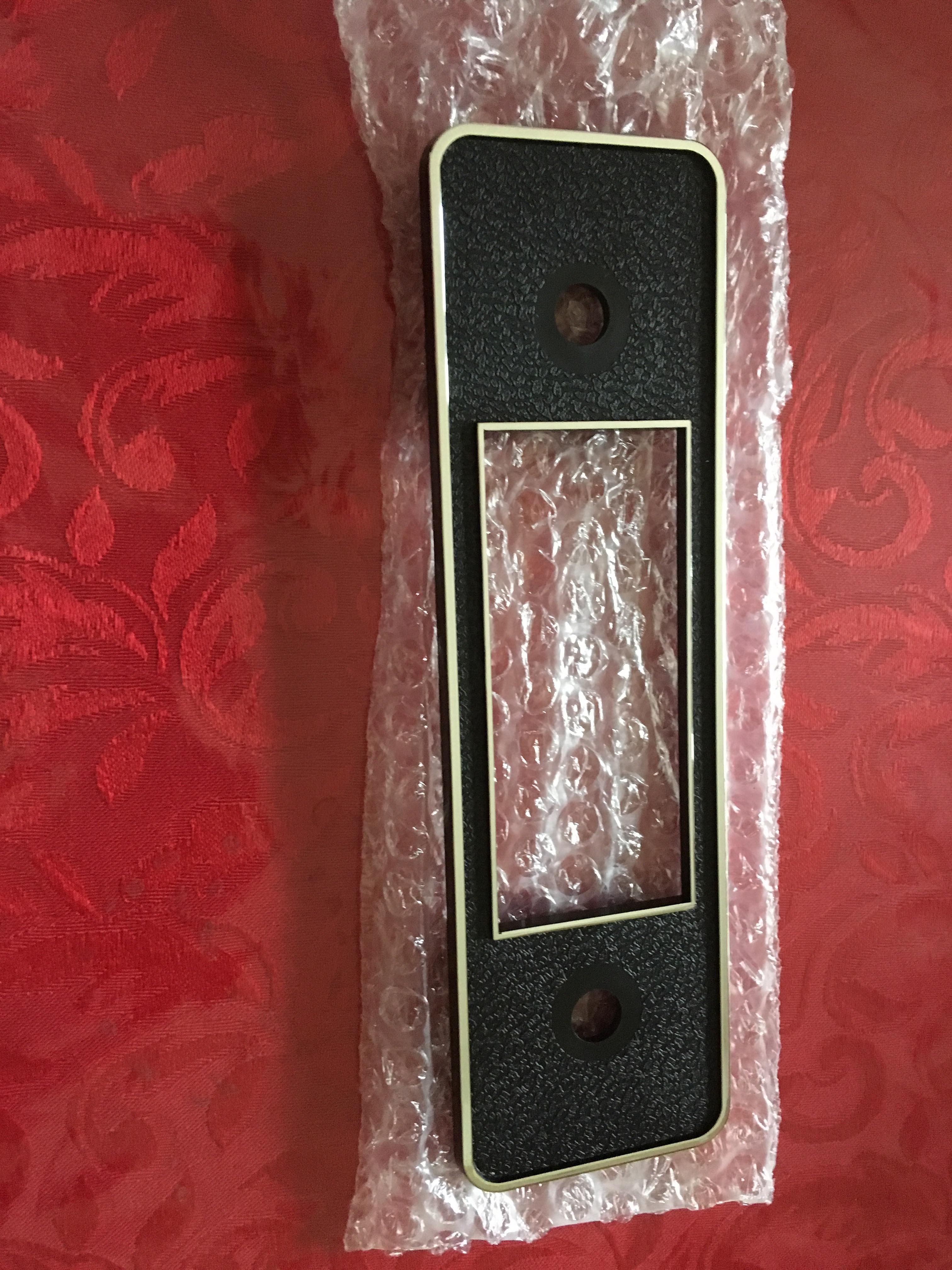

This is the supplied faceplate, it looks nice but the spindle holes are too close together and it's a little plain:

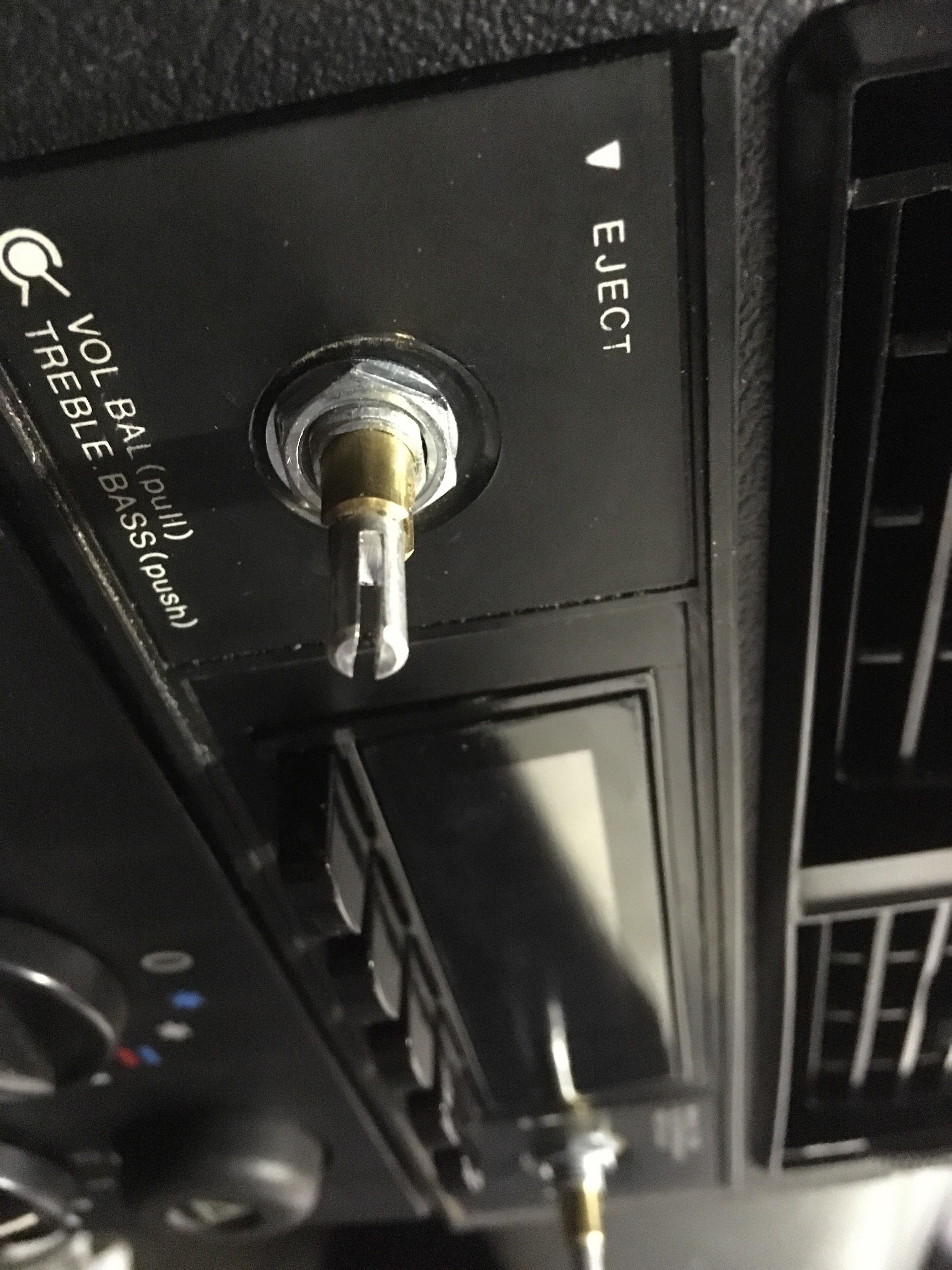

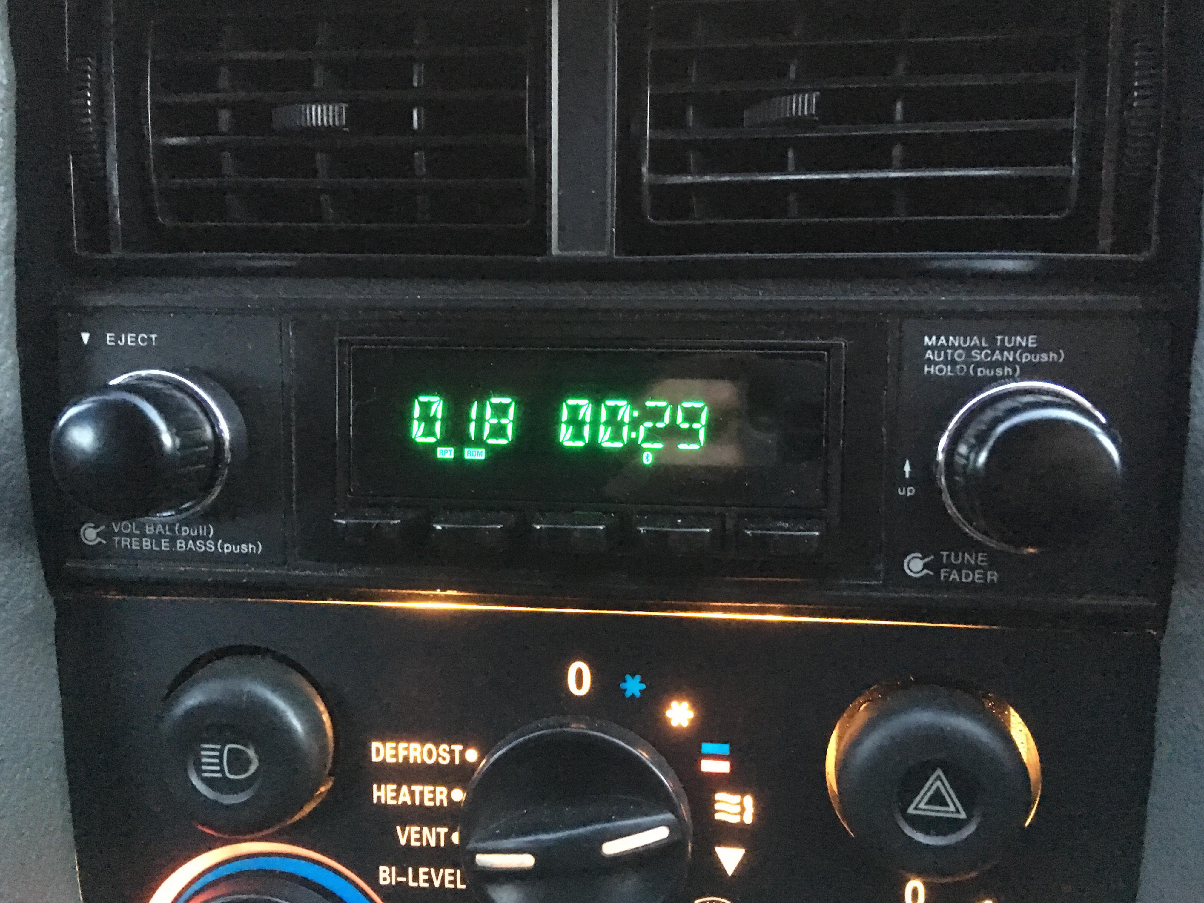

After some fiddling (I had to bend the Infinimount brackets so it would fit) I had this:

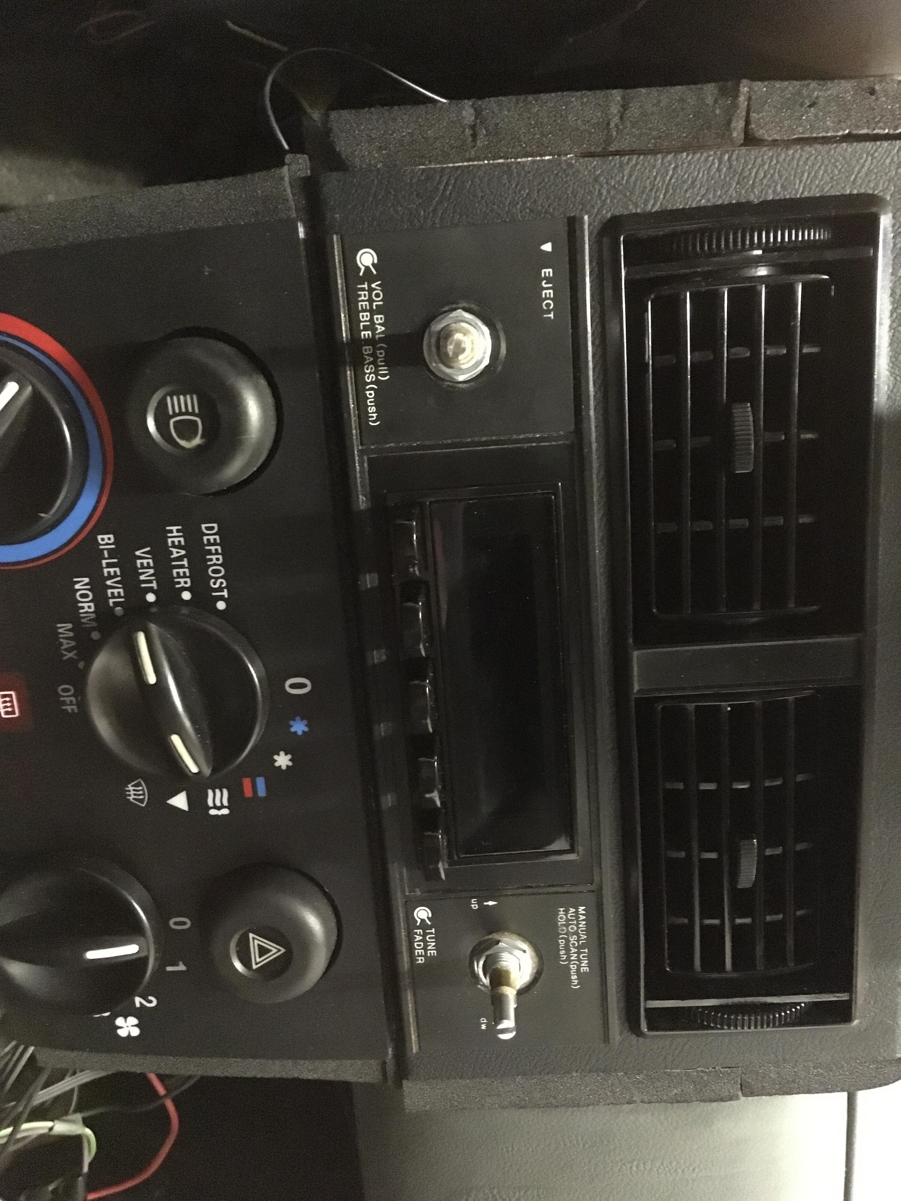

I'm quite pleased with my faceplate modification, from this angle it's difficult to tell which part was added:

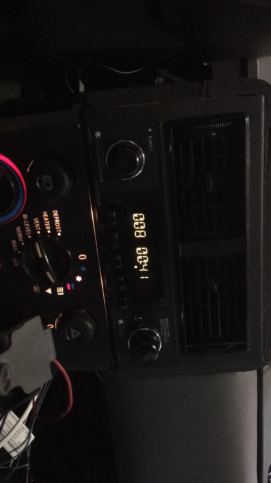

A quick test:

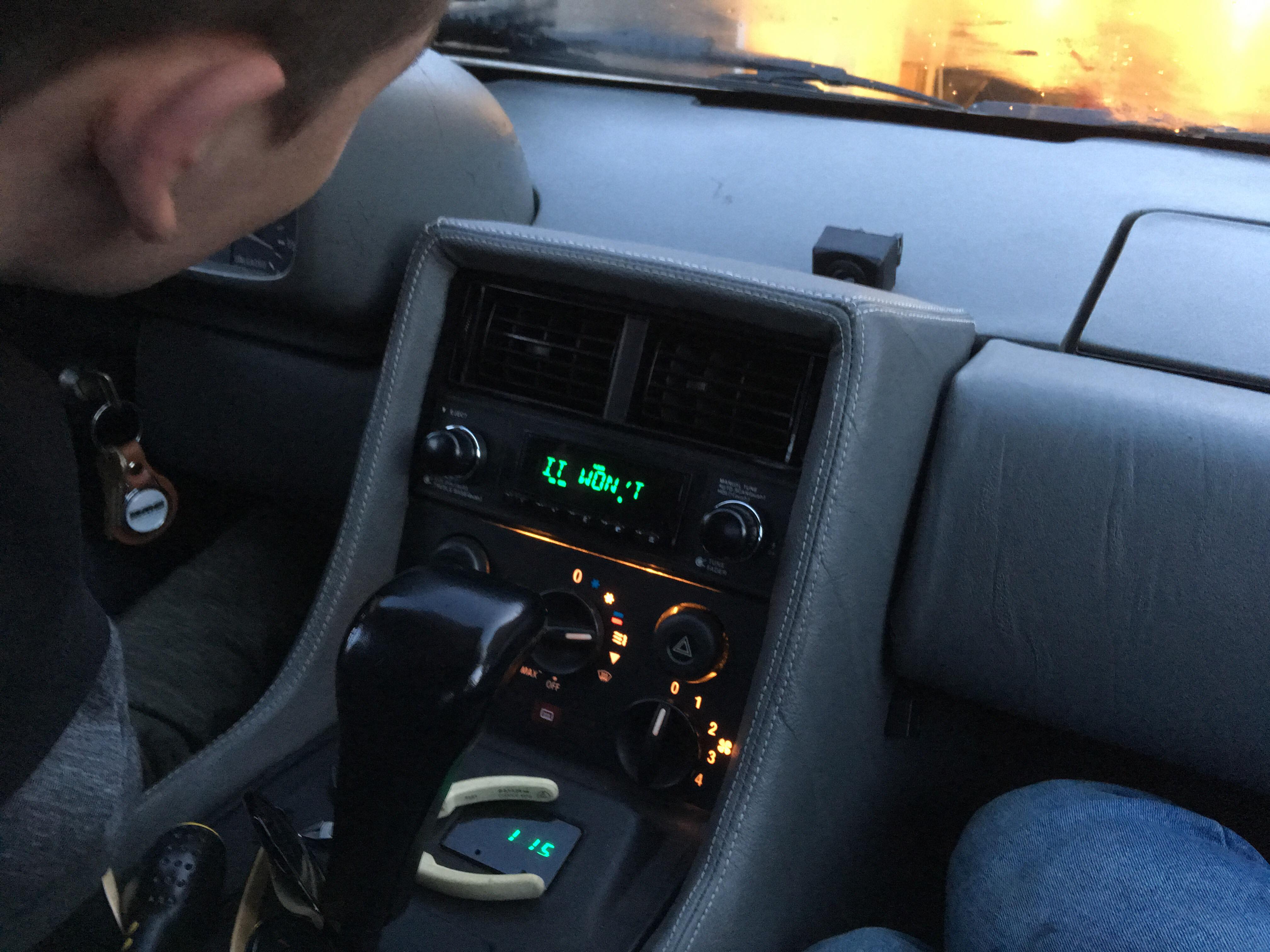

After I tested it, I just had to put everything back together:
£289.99 is a lot for a stereo as you can get stereo that have the same functions for about £100 less. But the sound quality is excellent with my Alpine speakers and I think Retrosound nailed it with the retro look! It has two aux inputs, a USB input, Mic input(mic included), Bluetooth connectivity, AM/FM, DAB/DAB+ and 32000 different colour combinations for the display.
