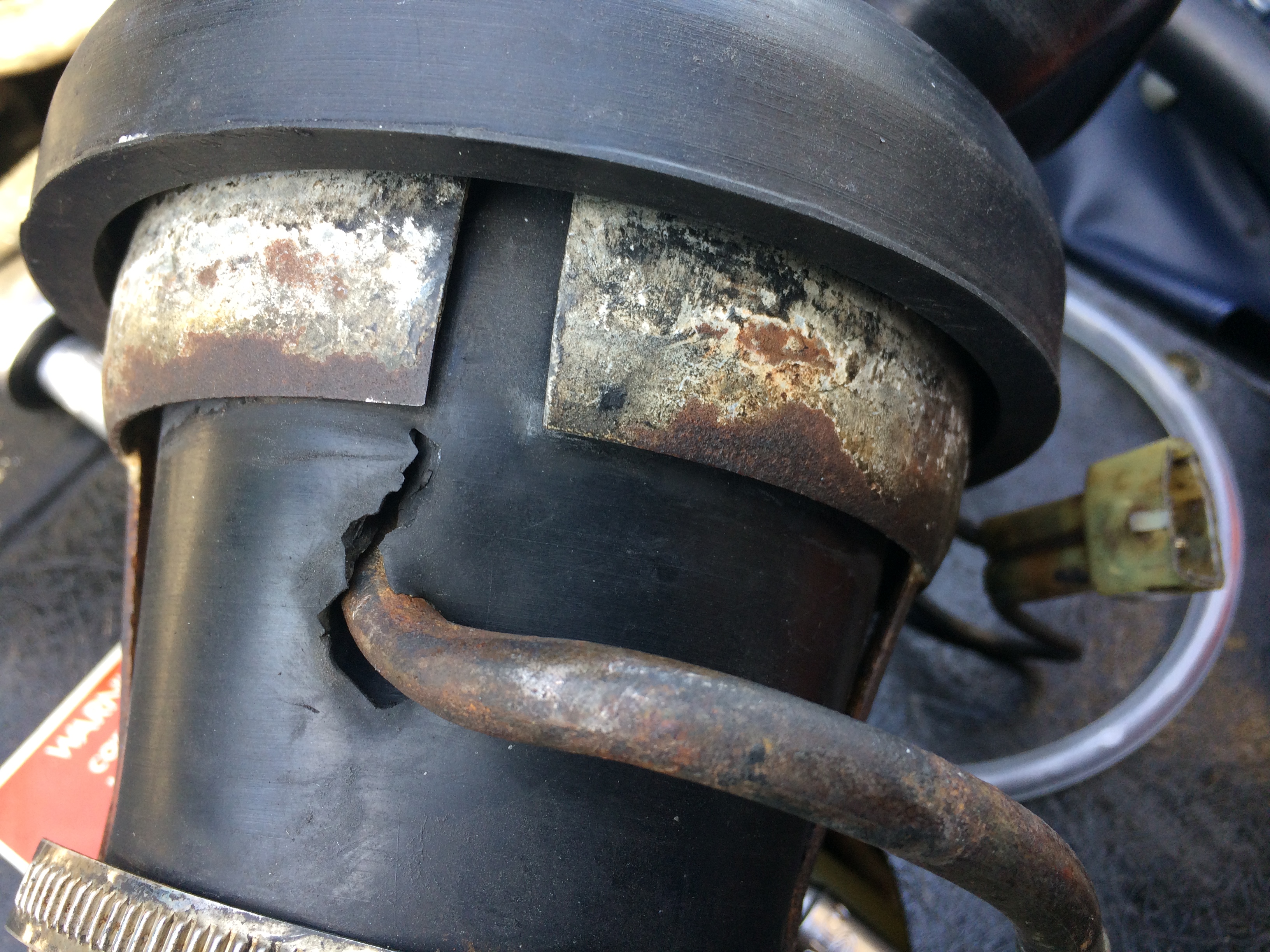

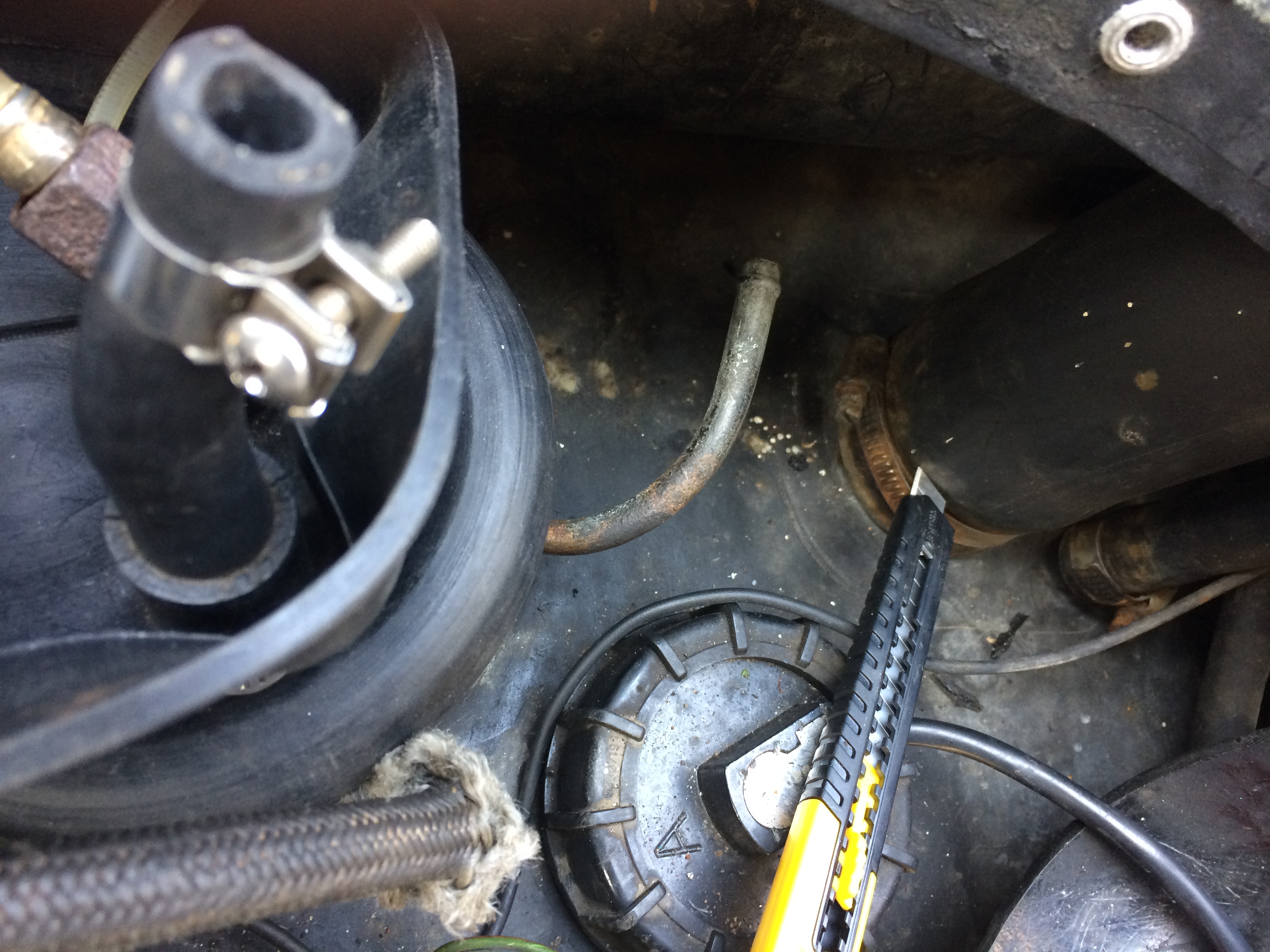

Nor do you need to withdraw the baffle.
Undo the main massive clamp, ease the pump out - there are 2 rubber hoses "in there". The return hose clamps onto the pipe sticking out the side of the pump boot, the pickup hose clamps on the bottom. Un-clamp both hoses, replace the fat one, re-clamp both hoses, job done. Easy 5 minute job (translation: 5 hours).

If it's fuel pressure related, then one of the common items is as Andy had pointed out, there could be a problem with the pick up pipework in the fuel tank. The easiest way to rule this out is to fill the tank with fuel and trial this.

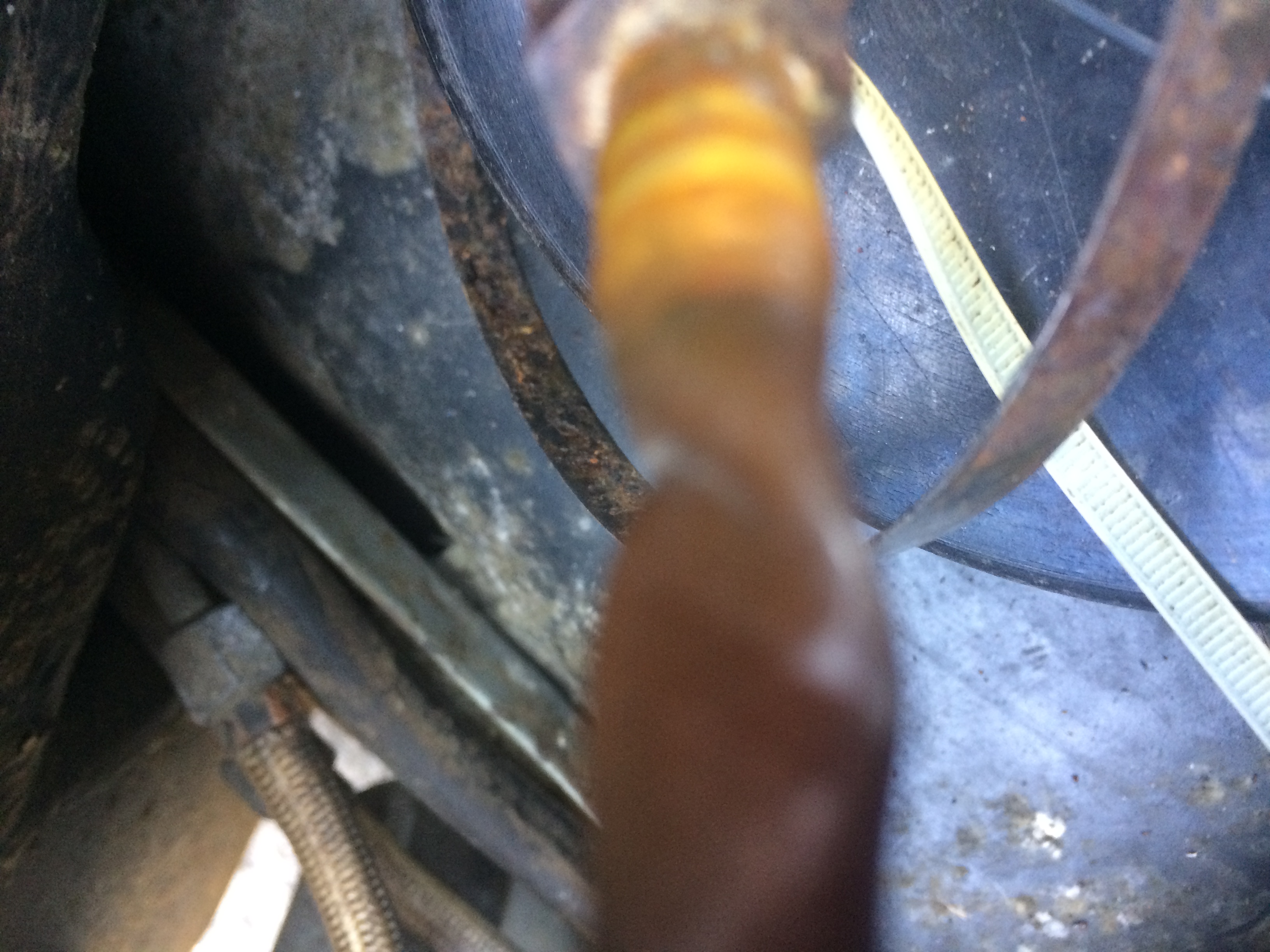

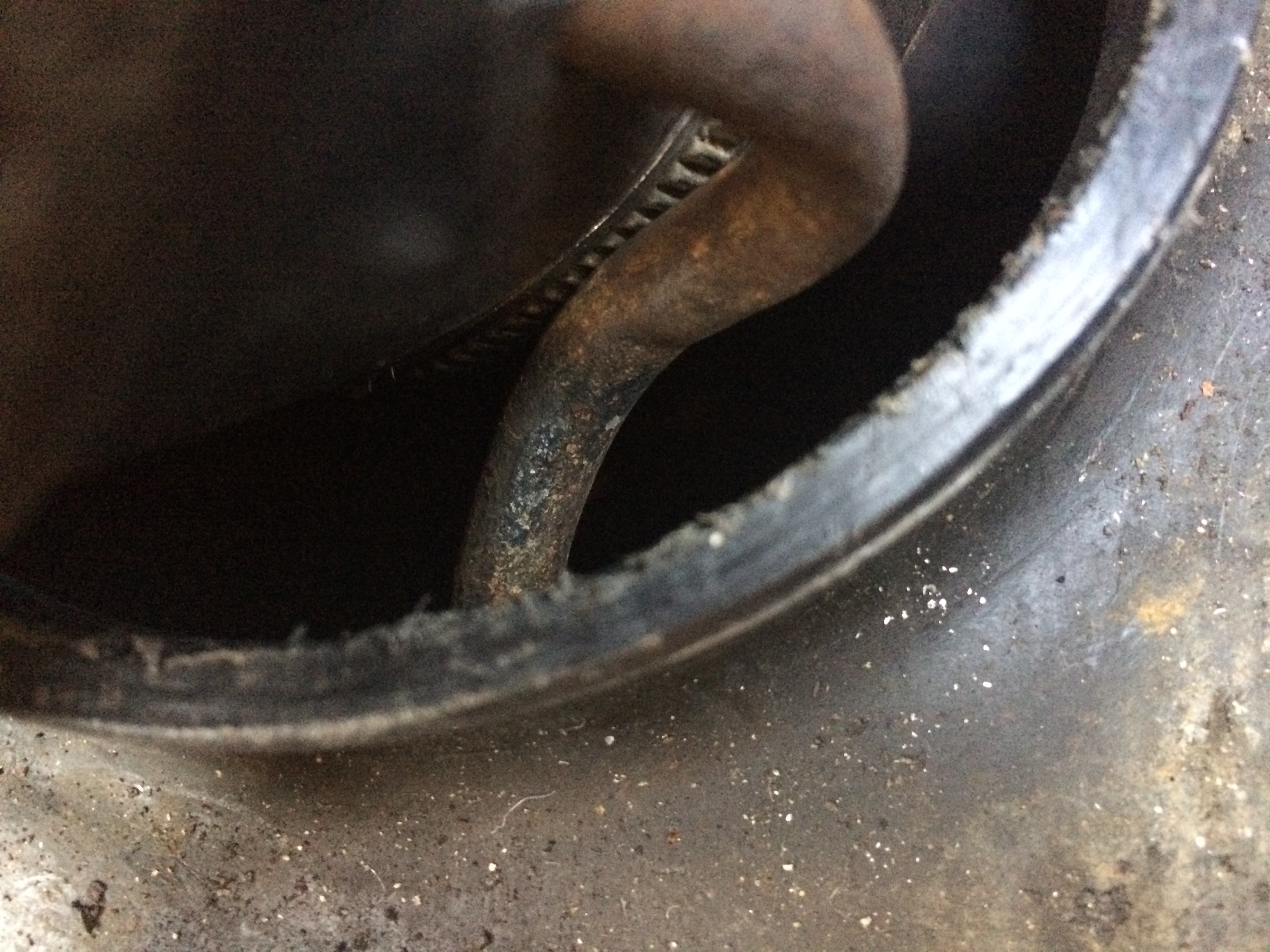

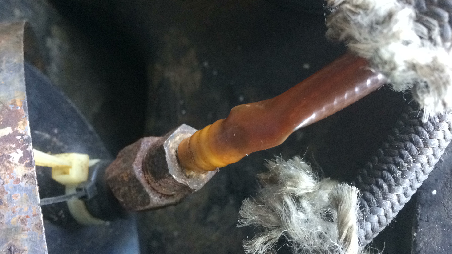

Pickup pipe spares arrived Tue but removal of pump proved impossible. Previous workman had installed it 180 degrees out in an attempt to route fuel hoses clear of spare wheel cover. Fuel delivery banjo is non standard and points wrong way and vertical Fuel return hardware had been twisted to fit the 180deg rotation and was sitting at + 90 deg to pump body which had twisted return hose - see photo Had to remove and replace .Still have non standard hardware to fettle or replace.

And does anyone think that twisted restriction in the distributor return pipe could back pressure and cause some of my symptoms?
