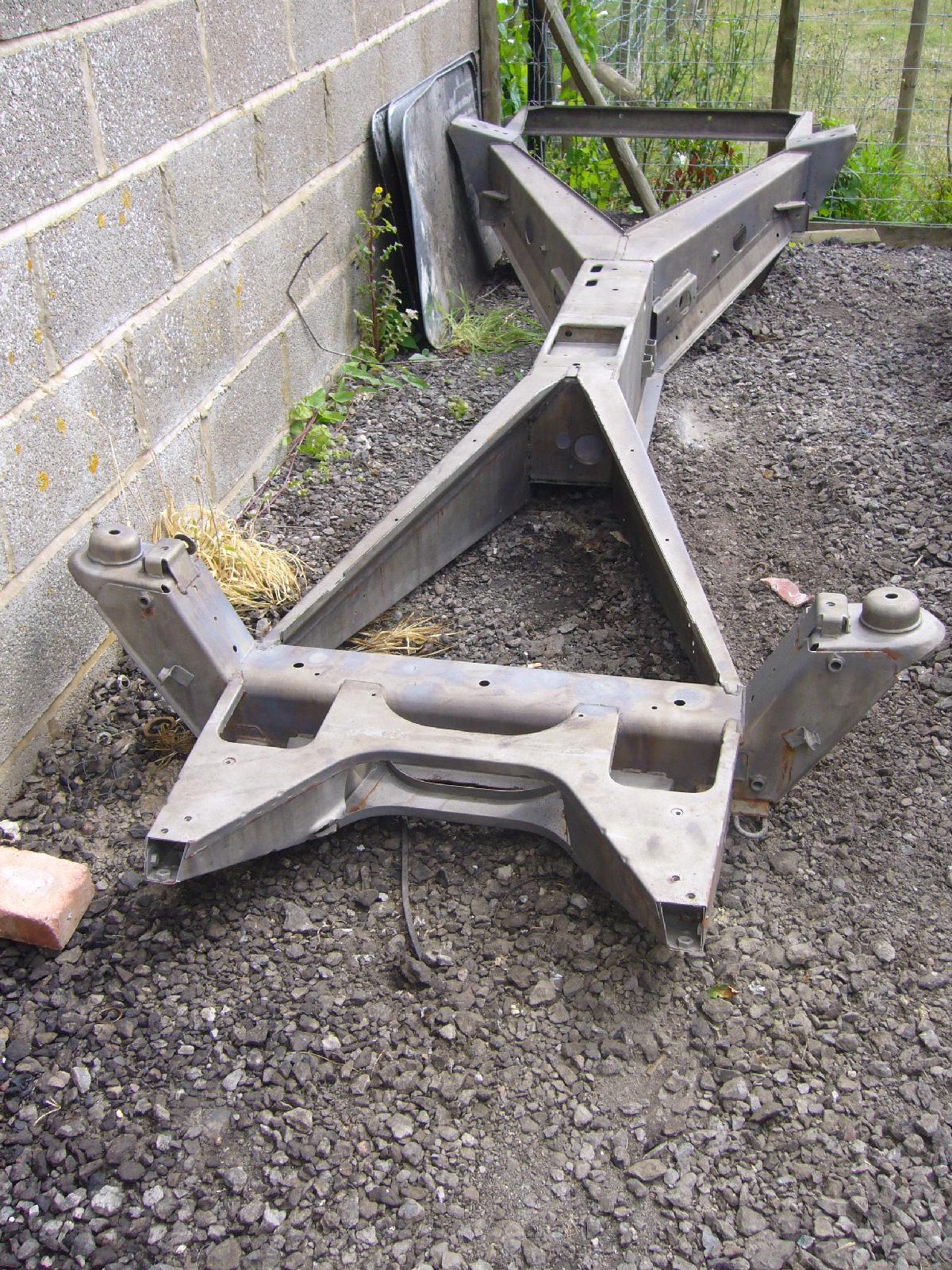

Postby DeLorean Cars » Wed Oct 28, 2009 4:09 pm
This is how the chassis I posted photos of earlier looked after being chemically stripped before being galvanised & coated

Postby bozzzydmc » Wed Oct 28, 2009 4:33 pm
Almost looks too good to powdercoat :) lol
Any idea what happed to the front frame section... looks like it got ripped on a bollard or something ?

Postby Admin-bloke » Wed Oct 28, 2009 4:41 pm
Only looks like a small rip, should be able to weld that back up easily.
Didn't have to strip the whole chassis for that though !!
Mind you it doesn't look in too bad a condition though.
Makes me want to do mine next !!!!!!!!!!!!
Insurance job maybe??? Maybe not, too honest me.

Postby dmc4087 » Wed Oct 28, 2009 4:55 pm
bozzzydmc wrote:Almost looks too good to powdercoat :) lol
My frame has a similar thing on the opposite side - its supposedly caused by torsion from the ARB and not having the frame recall plates. I could be wrong.
John, the frames are fine apart from the holes lol - I think he came across wrong initially with Matthew, but we will see.
