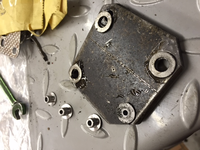

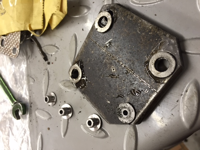

So just as me and Barry were about to finally finish our project car (VIN 3283) we develop a chugging exhaust which turns out to be the seal between the right hand manifold and the cylinder head. Rather than just put a bit more pug on top of that applied by the PO, we decided (as always) to bite the bullet and undertake a proper repair.
Just as well as it turns out to be two snapped manifold studs.
We thought it only right to bump this thread and thank Darren for the loan of his very effective jig with a few photos of yesterdays operation as we know that you all love a bit of engine porn!
Jig with washers and insert stuck in place with a little bit of grease.

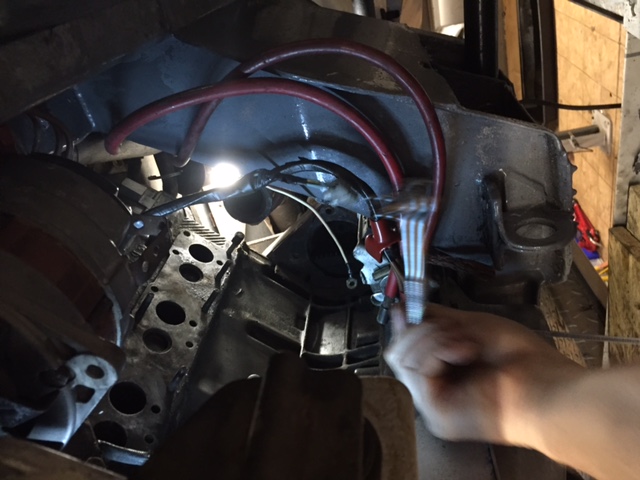

The first thing to do was lift the car up on the ramp and remove the oil filter and starter motor, the alternator was also slackened off and swung out of the way. The two broken studs were top left and top right.
As you can see, not a lot of room.

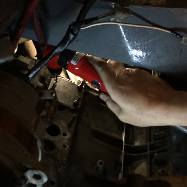

Drilling out the first one seemed to take ages but you just can't rush it, we used a pneumatic angle drill for this as it was pretty compact.

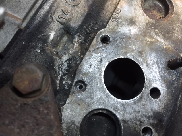

Drilling out the first stud, we managed to retap the hole afterwards

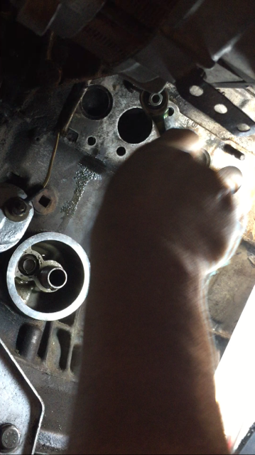

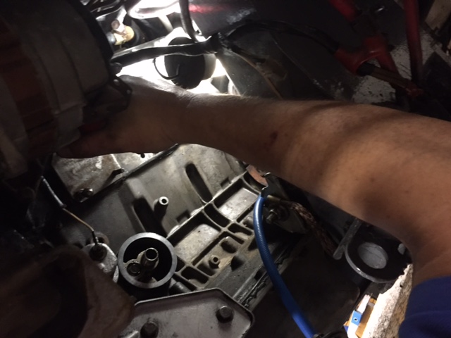

The second hole was a bit more accessible
Jig in place on the second hole
This one drilled out pretty quickly.
Pilot hole drilled lovely and central

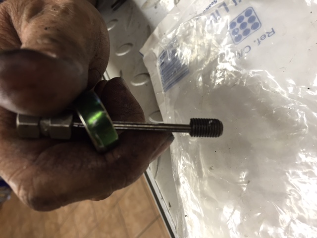

We managed to wind it out with a stud extractor
Removing the snapped thread with a stud extractor
Now, that's a sight for sore eyesI
So there we have it, success and thanks again to Darren C for the loan of the jig.
We boxed everything back up and managed to get a run on the engine before going for a well deserved pint last night. No more exhaust leaks! So glad that it went well.
We have just seemed to have no end of little jobs crop up in our efforts to finish the work on this project car but we are nearly there now with just a final tune and a couple of minor jobs to finish off.
When I get round to it I will update our original thread on the project car as its been a while now!
