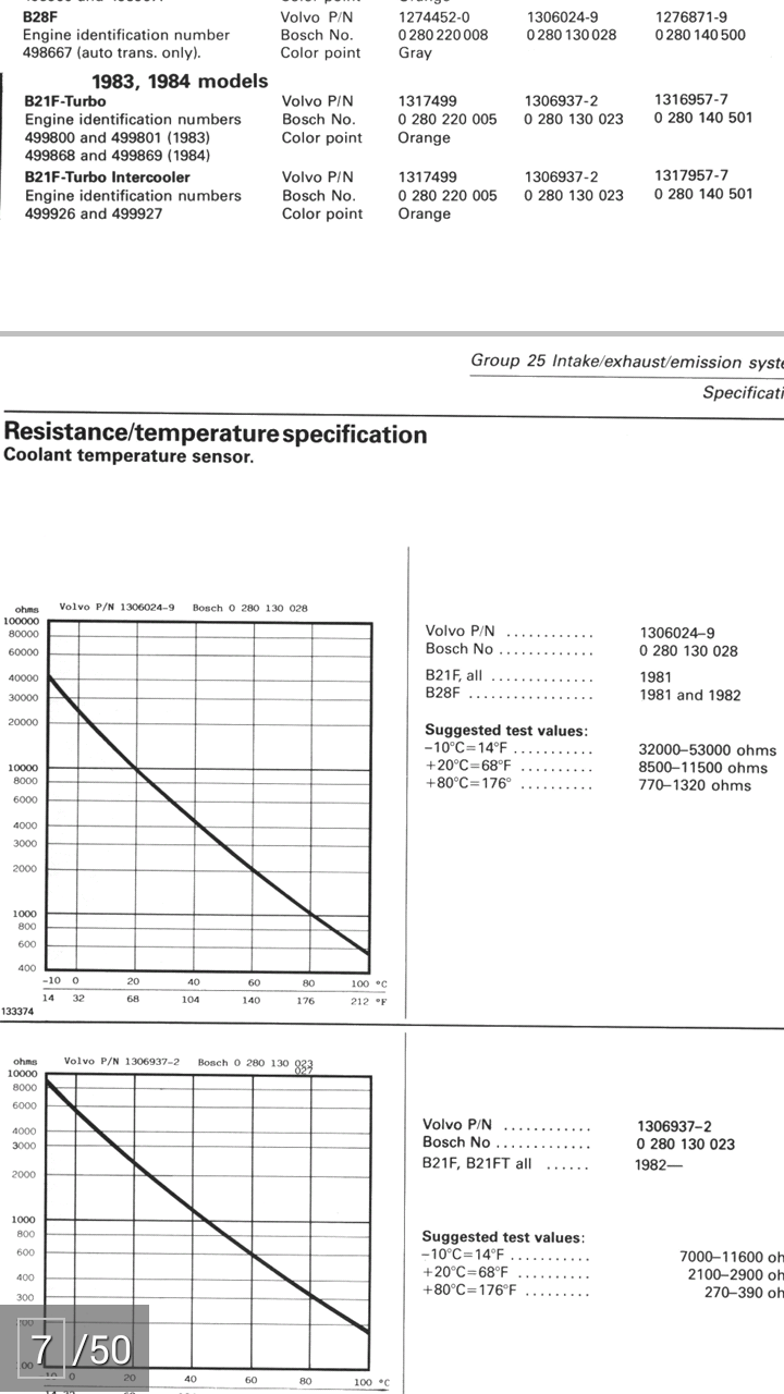

I've checked my notes. The thermistor looks correct. I've edited the posts to note this ( EDIT: )
I've added the resistance vs temp graph from the Volvo Green books from k-jet.org. refer to the top graph. ..
From Volvo Green book
