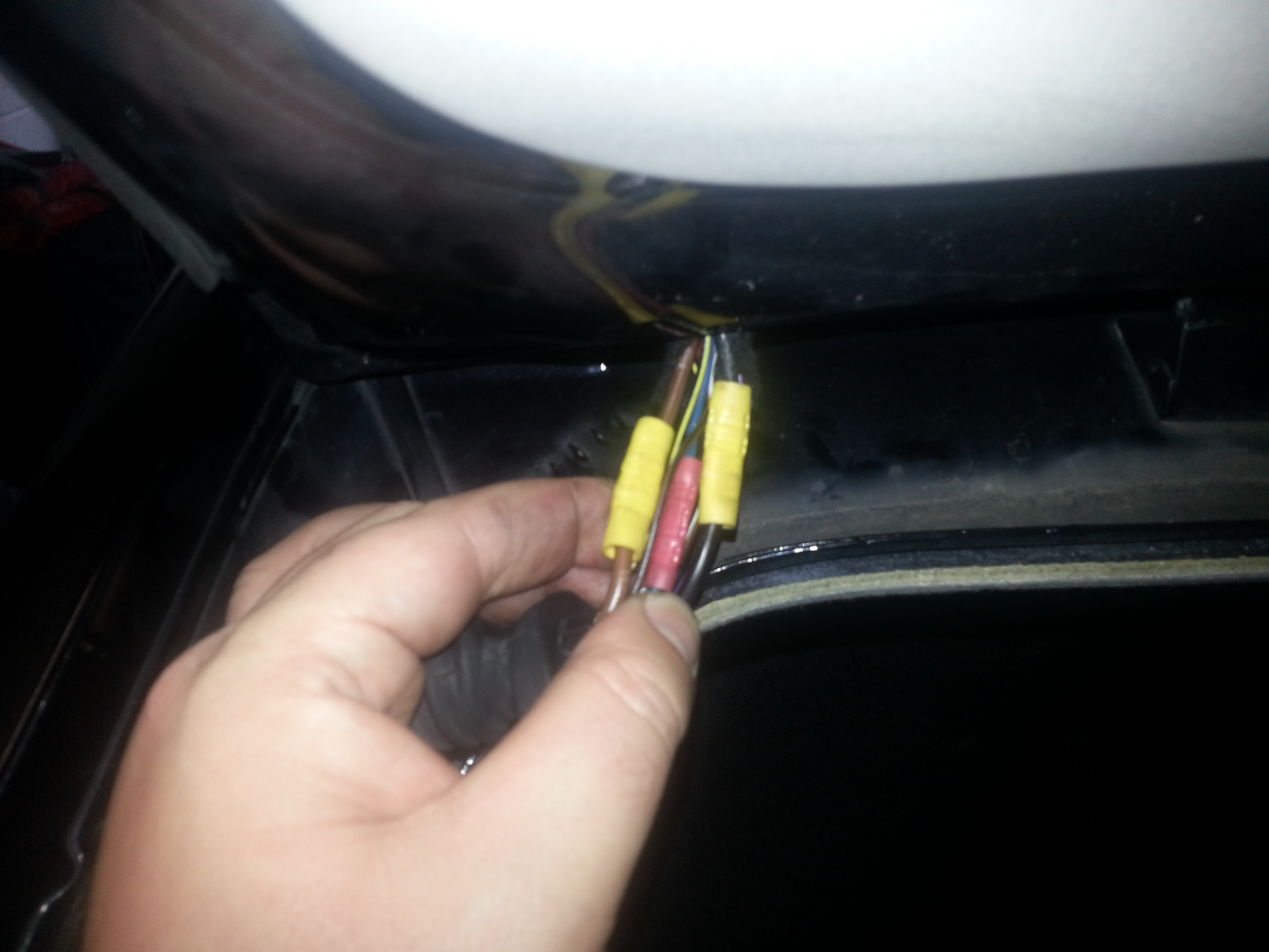

Postby Admin-bloke » Mon Oct 14, 2013 9:51 pm
Ok DC Shed Industries..... my efforts aka Admin-Electrical :shock:
My rear window wiper stopped working on my 8 year old daily driver Vauxhall Astra...
I grabbed the multimeter from the boot of the car (, well, it IS a shed ;) ) and found an issue with the wiring where it flexes at the hatchback pivot.
A few crimps here and there resulted in a now working rear wiper :D
Ps No scotchlocks were used in the repair of this wiring..
Fixed the shitter :)
2013-08-25 15.47.39.jpg (1.2 MiB) Viewed 3332 times

Crimps on the bendy point? This calls for the following line: "nothing is as permanent as a temporary solution" 8)
Re: replacing/fixing door strut fixing brackets.
Postby Admin-bloke » Mon Oct 14, 2013 10:08 pm
RobvdVeer wrote:Crimps on the bendy point? This calls for the following line: "nothing is as permanent as a temporary solution" 8)
This IS a permanent temporary fix :lol:
