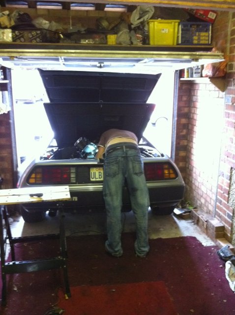

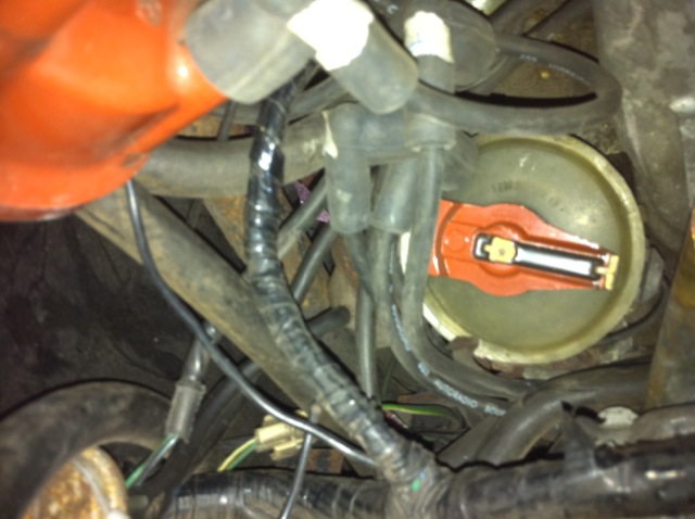

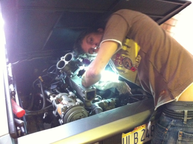

A couple of pics from the distributor / ignition Tec.
Disconnected the fuel return line, popped the 3 RH injectors (no FV :D) and flipped the metering head over to gain access, removed dizz cap, marked where the dizzy body & where rotor arm pointed, undid the nut holding down the dizzy body and pulled. Out it came. As Gez mentioned car fired up straight away and was pritty much on 13deg so timed it to bang on 13deg as per Mr T's advice :)
photo 1(2).JPG (74.06 KiB) Viewed 4160 times
photo 2(2).JPG (58.19 KiB) Viewed 4160 times
Gave Gez all the fiddly jobs of course ;)
photo 3.JPG (86.16 KiB) Viewed 4160 times
photo 4.JPG (110.8 KiB) Viewed 4160 times
