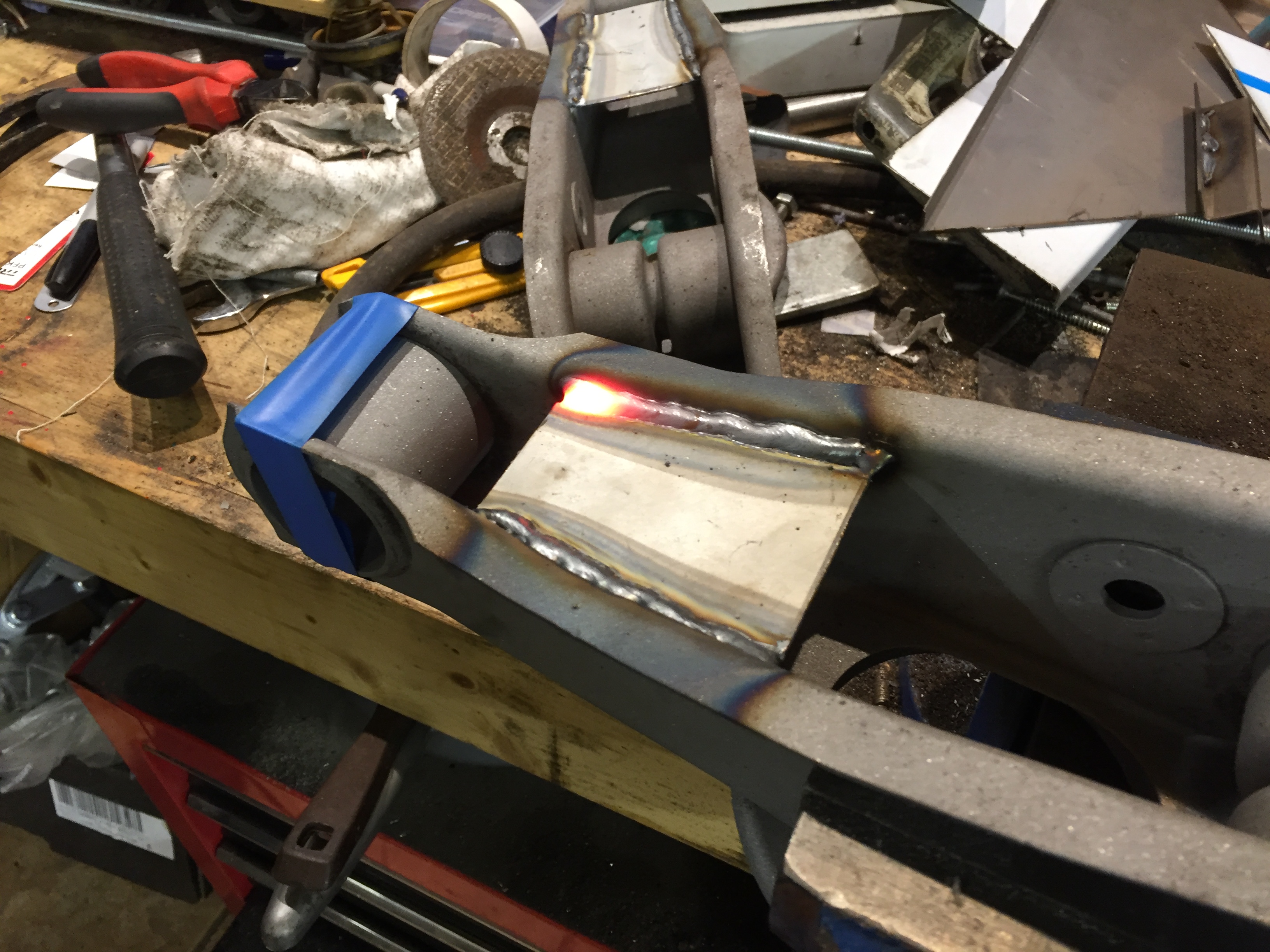

I have got most of the bits to upgrade the front end - springs, PU bushes, recall kit etc. but cant decide between spax or the protech suspension, I am leaning towards Protech as I think these look better on the car.
The main question I have at the minute is regarding the Lower Control Arm. I dont fancy paying huge sums of money on Aluminium or stainless LCA but am thinking of bracing with 5mm plate.
Are these items as weak as it seems or am I reading to many forums?

Welcome Andy - certainly the :spax: are very popular, we've sold *a lot* - colour isn't important on the front anyway, only the backs to worry about - many have simply painted them, see here for an example of that: viewtopic.php?f=20&t=501
I only know of one set of Protechs in existence (Chris Hawes) - I think he was the prototype - I know at one point there was an issue with clearance with the knobs on them - but I presume that's been sorted if they are selling them for real now?
Jason boxed his LCAs in with welded pieces, I think that sounds like a good idea - also if it ain't broke...
If memory serves correct you've already got new lower ball joints - absolutely essential - there is this upgrade from Rob Grady too, to reinforce that area: http://www.deloreanclub.uk/lower-ball-j ... -pair.html
LCAs do break, it isn't that common, but it does happen...: viewtopic.php?f=41&t=4690&start=42

I went with :spax: , lowered from springs and strengthened the LCAs in my own way
And I'm very happy with the result
I wouldn't worry about looks as Aran said you can paint the :spax:

As for the LCAs I think I will just get it together and get the welding done next winter. I just want to get out and enjoy it.
