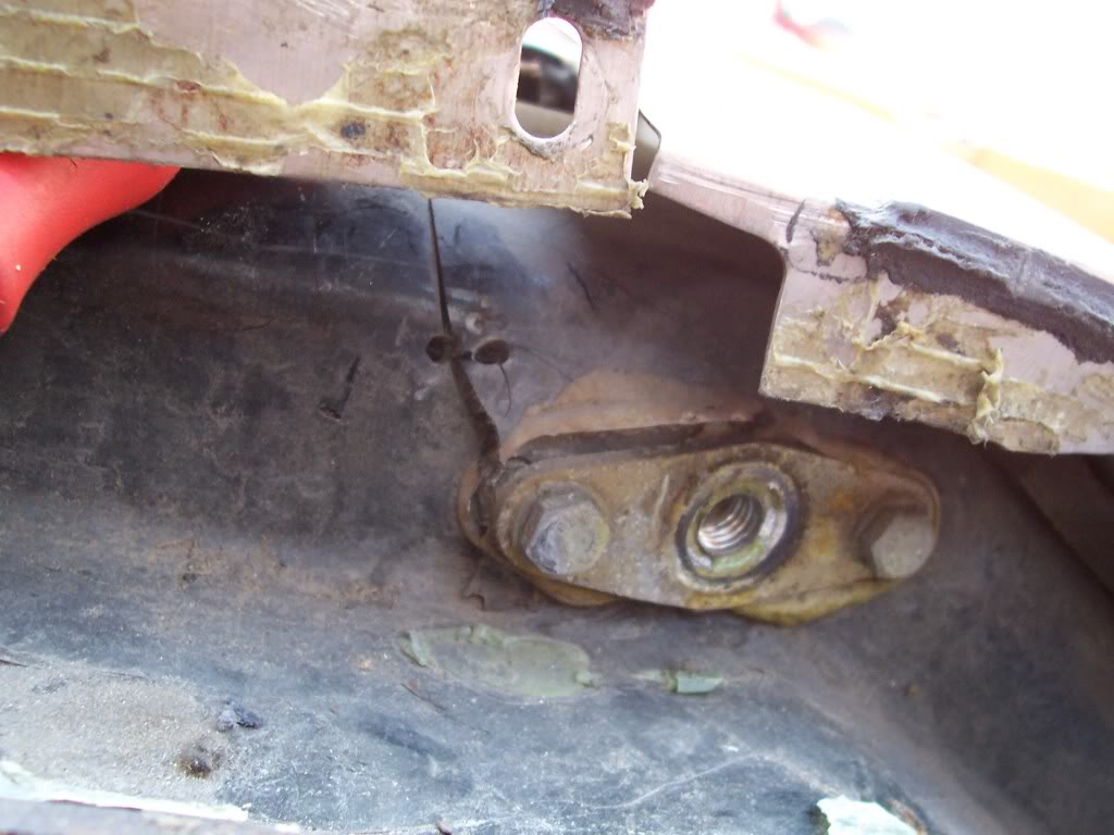

This is what usually happens

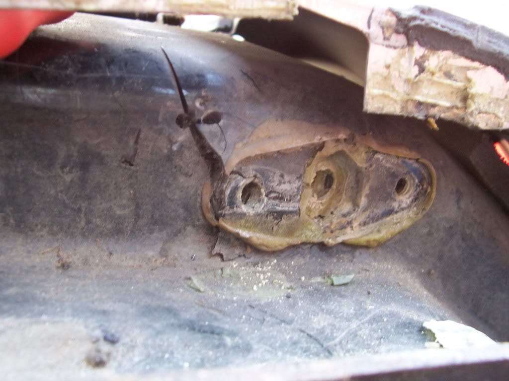

With the bracket removed you will usually find this.
Repairing the tub with glass fibre is very time consuming, messy, difficult to guarantee strength and the T & quarter has to come off!

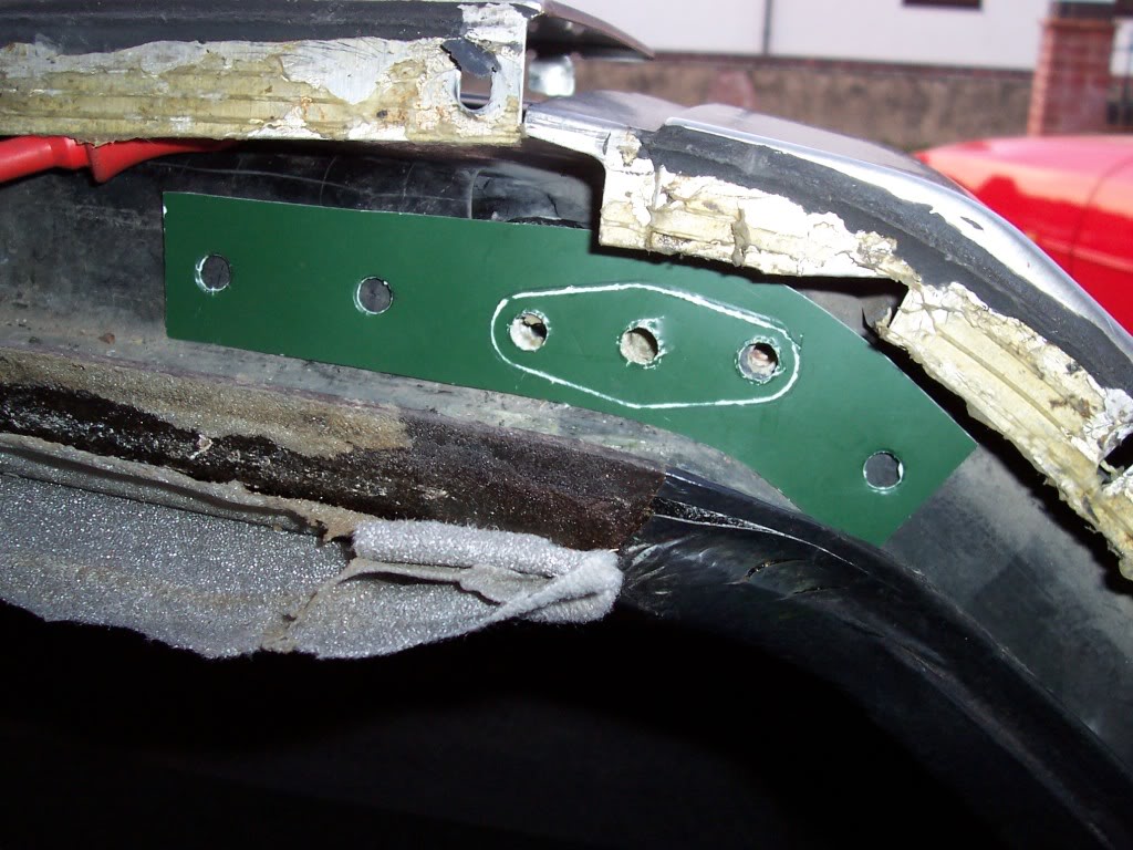

So I made a template

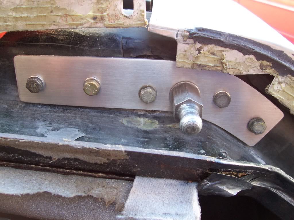

Then a brushed stainless bracket with a smaller back plate with welded captive nuts, to fit inside the tub.

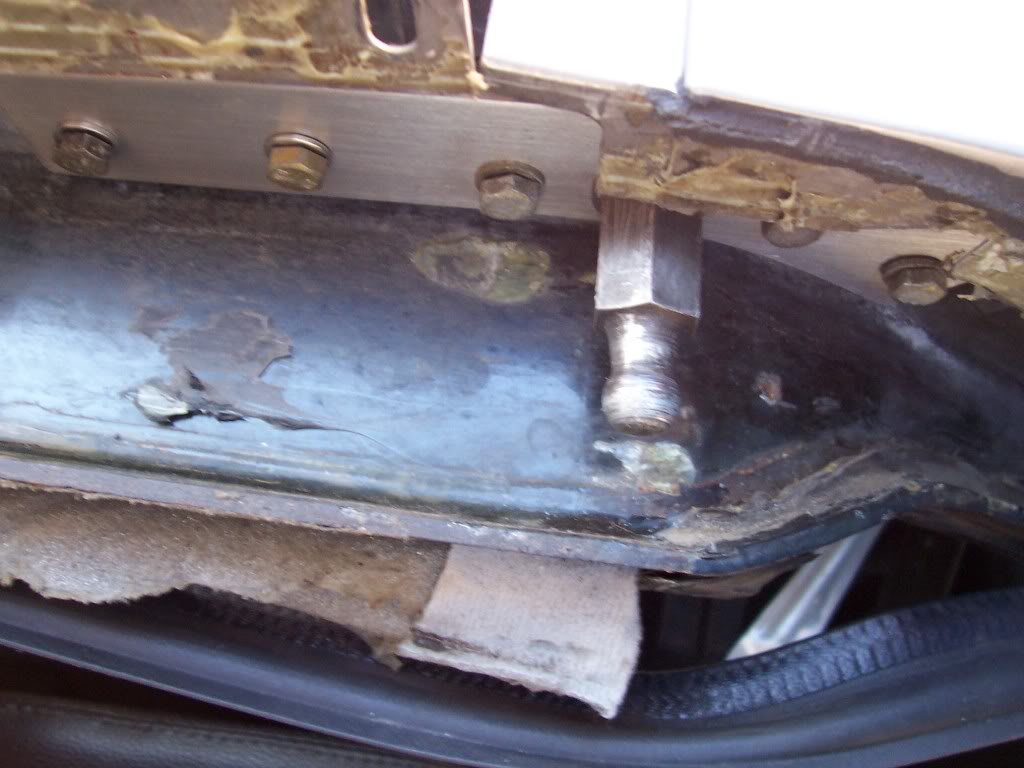

Sandwiched with Tigerbond to water seal it and held with M6 bolts, giving a much stronger and longer lasting support than original.
Making a nice straight strut mounting point.
Then put back together for an "invisible" repair.

Postby Darren C » Tue Jul 05, 2011 7:17 am
Hi Phil,
The two top M6's "screw into" a rectangular plate with two M6 nuts welded on the back. This fits inside the tub through the letterbox slot under the headliner. (with a bit of foam dug out) This then clamps the plate to the tub so no fear of it tearing out again.
The bottom M6 has a nut and large penny washer with flats cut on it, so that it fits inside the tub.
The two centre M6 (either side of pin) go into the original oval bracket.
A new M10 nut is welded behind the new stainless front plate (which is drilled 8.5mm) this allows to tap out the thick stainless plate to give a really long thread for the pin.
More than meets the eye in the picture!
