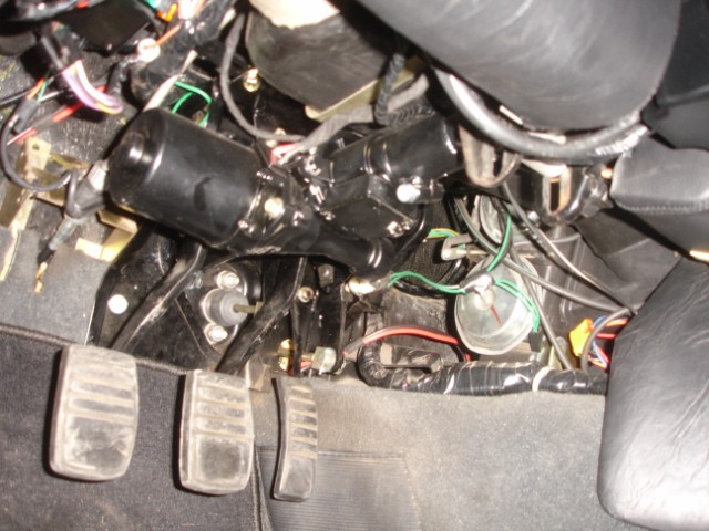

I like to share the new power steering unit we have.
It is a speed relate set, that start form 0 mile with max assist, and build it off to 40 mile. Thane it is all back to original. There is a special pick up adaptor between the Speedo cables, to get the right pulls to the computer. If you loos power the car work like a stock Delorean, the axe is still one piece. And the column can still be adjust in height and slide still in and out. On 31 December we did have a public test day in The Netherlands. I know the comment that we don’t neat it, but as soon you drive it you know better, it make a car a lot easier to drive in town.
The set will be for sale in the us as well.
