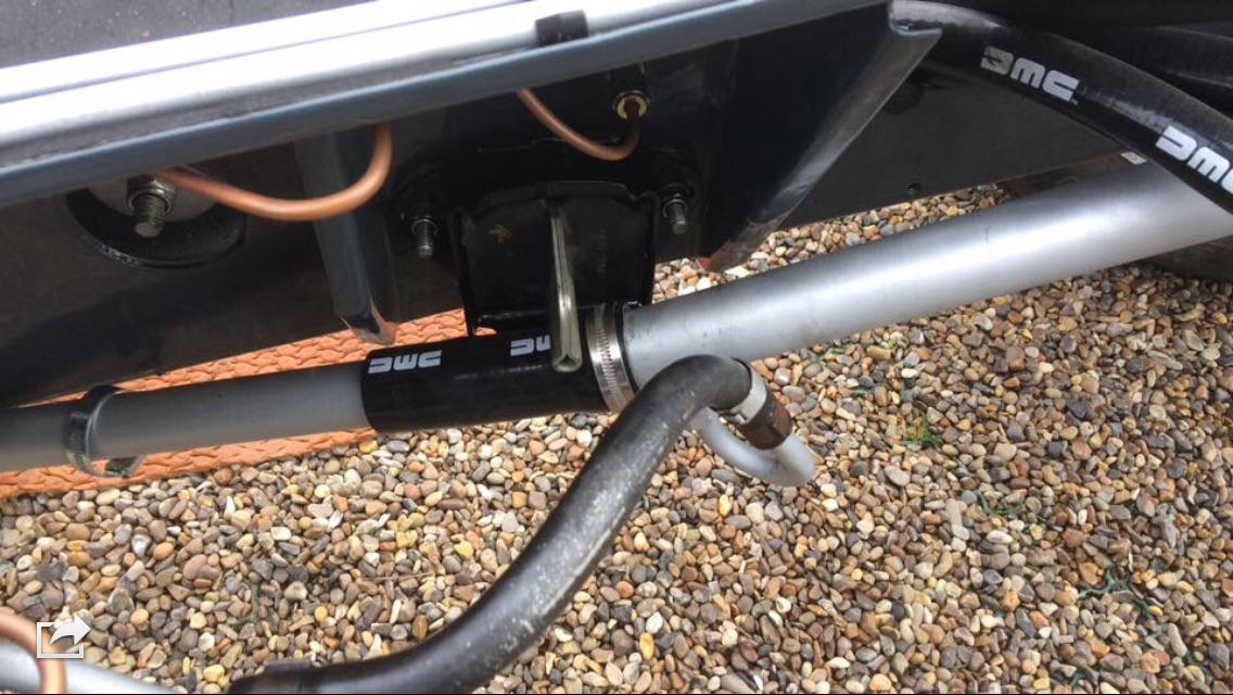

Hi! In just having trouble with getting the oil cooler pipe for the auto box that's partbof the radiator pipe work in the right place . It seems awfully tight up against and below the transmission mount right hand side. Can someone confirm which is the correct route please? That would be great, here's a picture.

That looks like you are using a straight piece, where as it is meant to be a 45 degree bend.

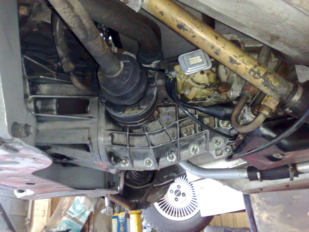

Postby delorean12uk » Mon Oct 05, 2015 9:27 pm
Thats the only picture I can find, I hope that helps
