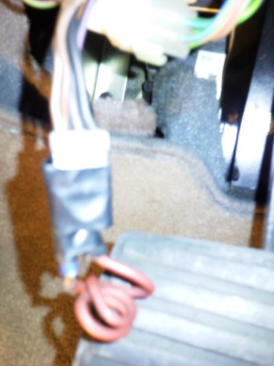

Postby delorean12uk » Tue Sep 15, 2009 2:42 pm
Their should be a section on this forum where we can name and shame previous bodges on our beloved pieces of crap. I found the problem why the engine was cutting out when the doors were locking, and that is because somebody wired the inertia switch into the door circuit. I would like to thank the Novice Electrician who done that and ask him not to give up his day job!!!
I would like to thank everybody who contributed Ideas and suggestions as to what it could have been, I would especially like to thank Martin because he was absolutely spot on..............................Martin, have you ever worked on this car before 1999?? :lol: No seriously a big thank you to everybody that contributed ideas, without them I would probably still be pulling the car apart tracing the wiring through. Cheers J
