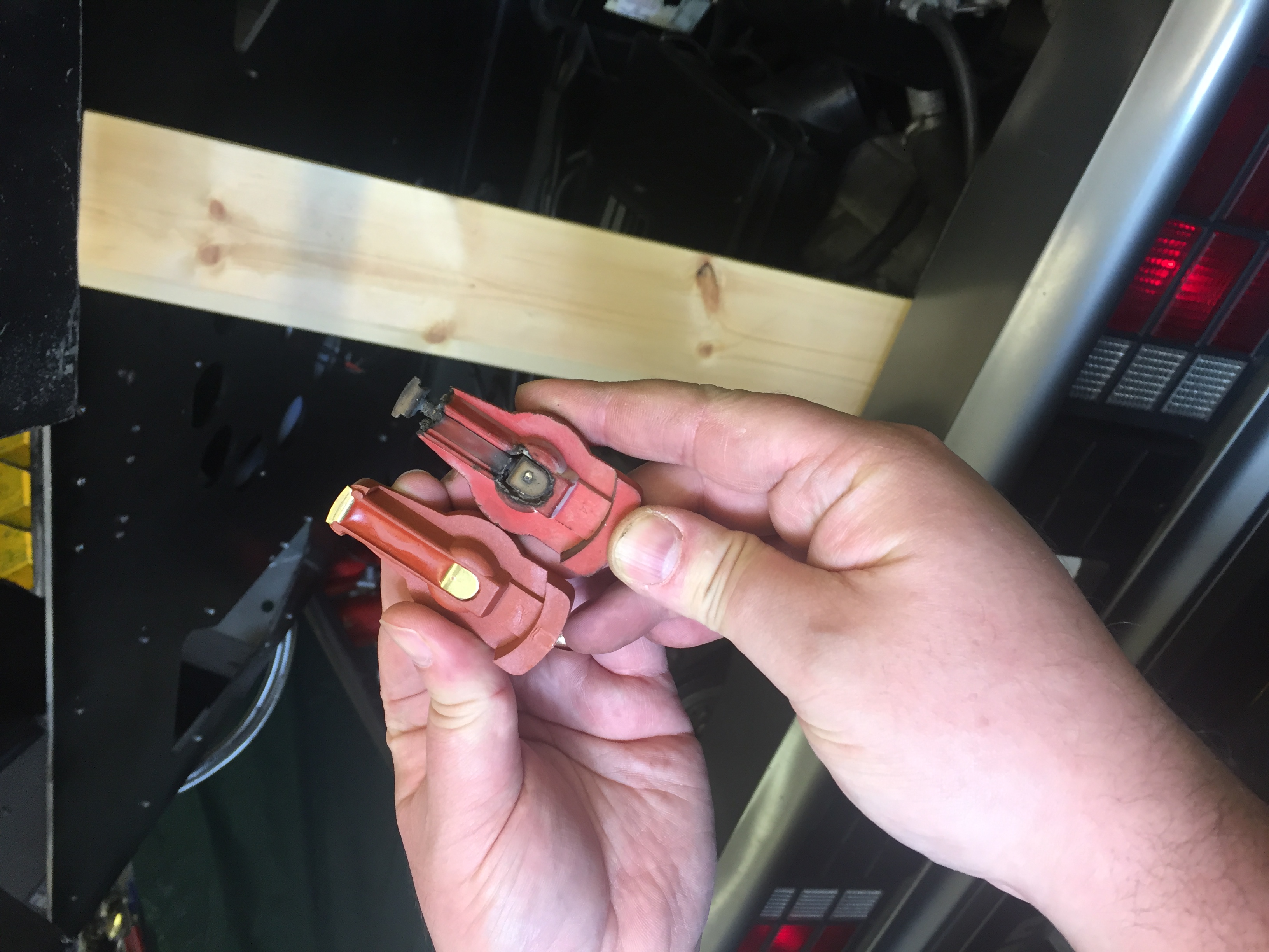

Postby Deloreanyorkshire » Mon Feb 27, 2017 11:36 am
Thanks to Nick again for a last min Yorkshire tech session yesterday.
I am hoping that the car is back to normal now and I can enjoy it again.
The cause of my problem seemed to be a knackered rotar arm which stopped the sparks getting to the plugs.
For reference:
Feb 2017,
new spark plugs
new distributor cap
new ht leads
Brand new rotar arm
Changed 6 O rings after taking off intake manifold
Fingers crossed for issue free motoring for a bit.
Difference between a good and bad rotar arm
Mike
