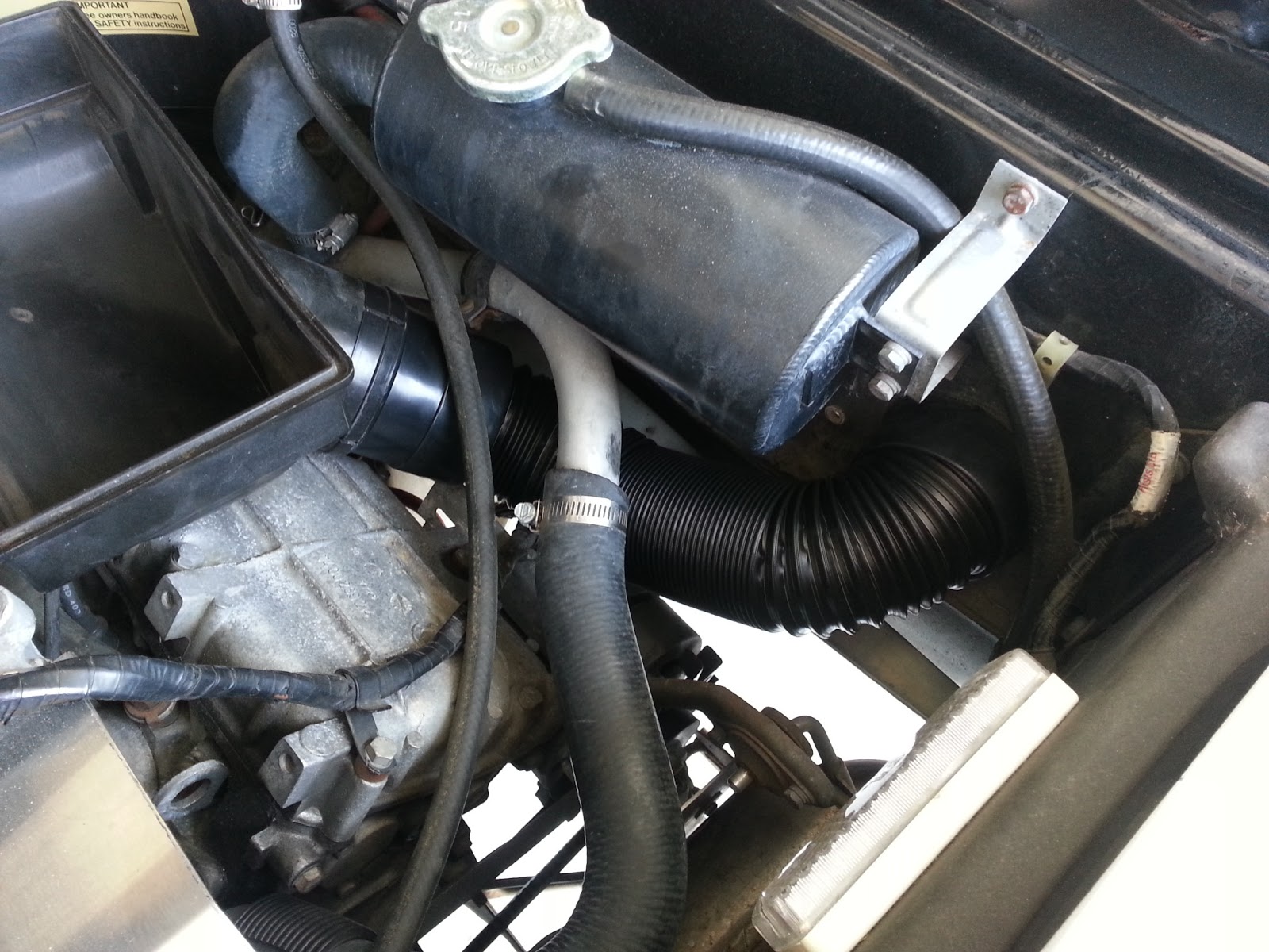

Postby arranj » Thu Mar 09, 2017 9:27 pm
Couple of random pics - couple of slightly different angle solutions here. As Gary says, it is only very cold, like northern Sweden cold. Something that came over with the Volvo - the part you'd be ripping out actually has "Volvo" stamped on it.

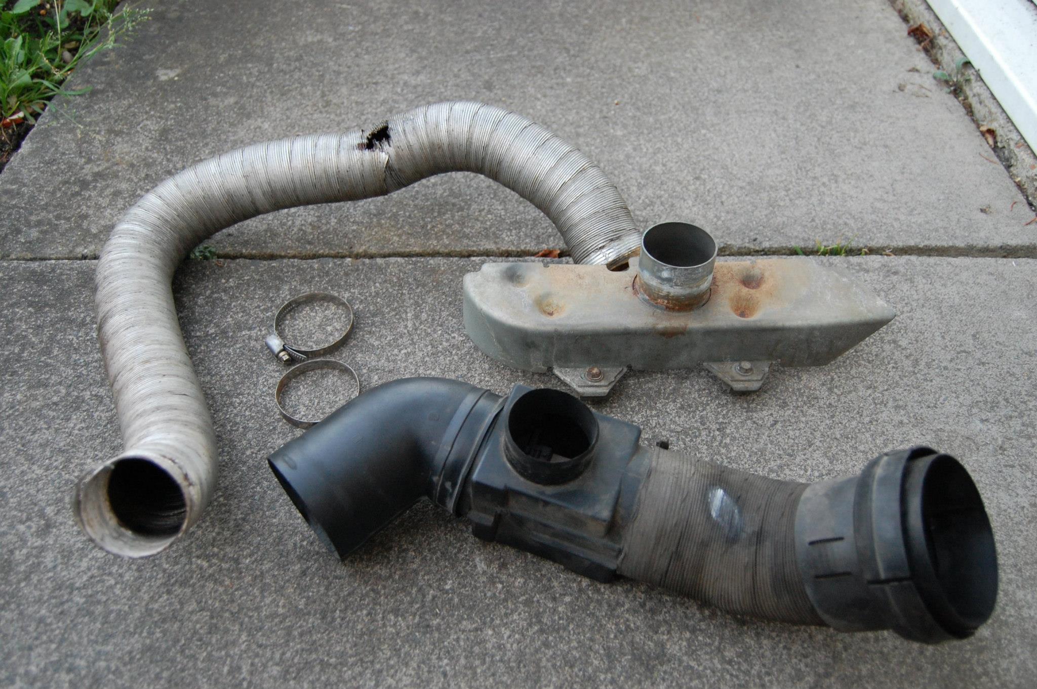

Postby MikeWard » Fri Nov 02, 2018 5:58 pm
eric wrote:What do I do with the other end of the rusty pipe ? just remove totally and leave a hole.... This explains why I had so much trouble trying to fit with the existing fitting in line :)
Remove everything you see here.
OE air intake.jpg (401.8 KiB) Viewed 5002 times

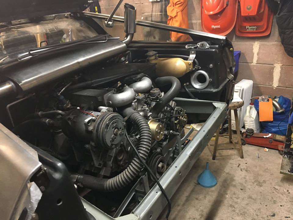

Postby Spudmurphy » Sun Nov 04, 2018 1:34 am
I bought the new hose from Ed - well I was in Amsterdam anyway so why not ? :-)
I ended up buying an aluminium Air intake cone from Ash silicone hoses and bonded it in with some wurth bond. I later made some sexy SS bands for Ed's hose and it's looking good.
This is an old pic with the old coolant bottle ... but you can see the cone.
ali cone.jpg (93.1 KiB) Viewed 4951 times
