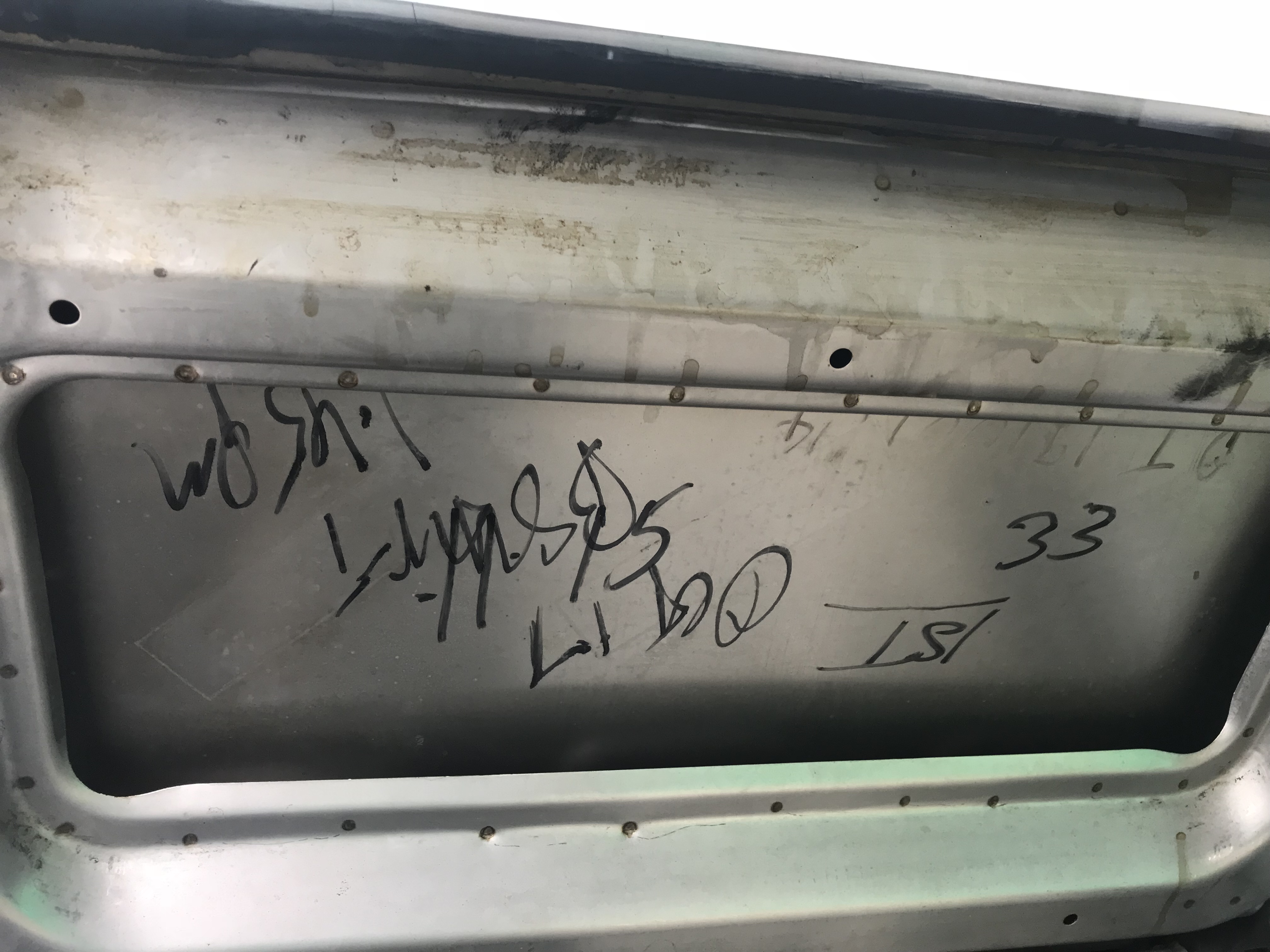

One slightly strange thing we found when we took the top panels off the doors to see what was written inside - one could easily be seen and figured out it read - “ b shift - the date and some kind of signature but on the other door you could just about see the same writing but was sprayed over with a grey paint ??? Strange - also between the door and panel ( where the writing is ) a sheet of reflective foil insulation was inserted???

Mine had the foil sheeting too - you're the first I've heard of another car having it, I assumed a PO added it for some reason.
Re: Work starts on the done deal Delorean
Postby andyd » Mon Oct 16, 2017 6:07 pm
Mine had a polystyrene panel!! Presumed noise deadening?

Spooky..... :o
1st Oct 17 written in the door.......
What date, month and year is it now for you to reveal that?

Yes stu and I couldn’t understand the 17 or why the other side had been covered up with spray paint ??

Darren C wrote:Spooky..... :o
Well spotted.....

I think it's "1st" then "Oct 17" so October 17th the door was built or fitted; "1st" could be something else entirely. :)

Dan Willis wrote:I think it's "1st" then "Oct 17" so October 17th the door was built or fitted; "1st" could be something else entirely. :)
Nah, Dan
I much prefer the time travel paradox :lol:

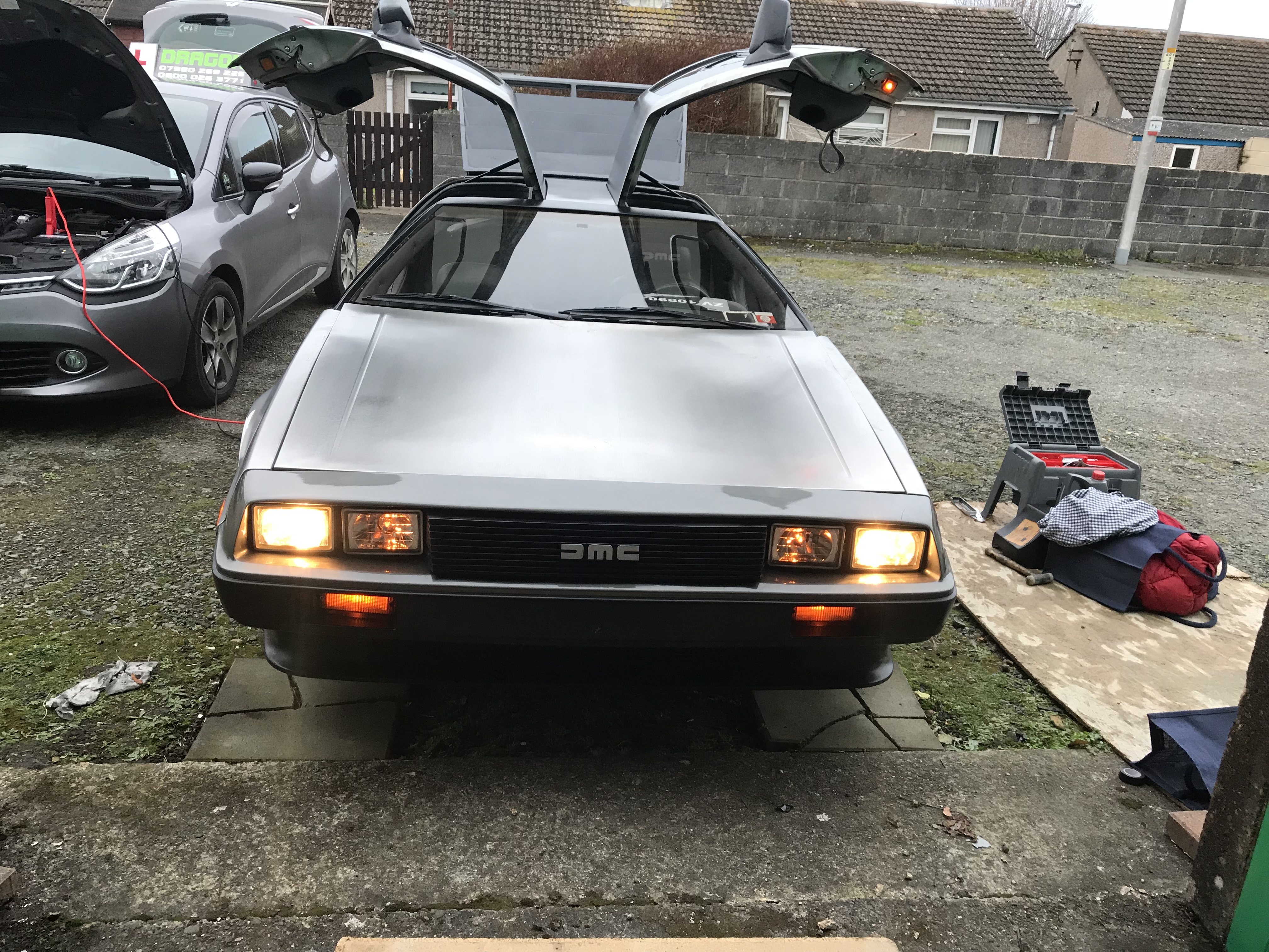

Postby Dave M » Mon Oct 23, 2017 3:38 pm

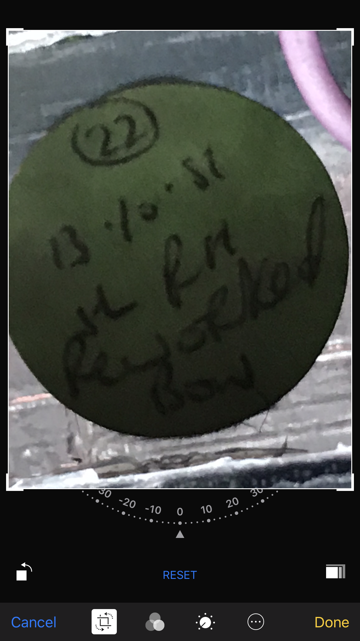

Found the problem with my headlights or lack of them !!!! Wires were off the back but also the switch has melted so new one on its way but at least they work and nothing serious. - also we spotted this green sticker behind the trunk light in the bonnet !!! Interesting !?!?
