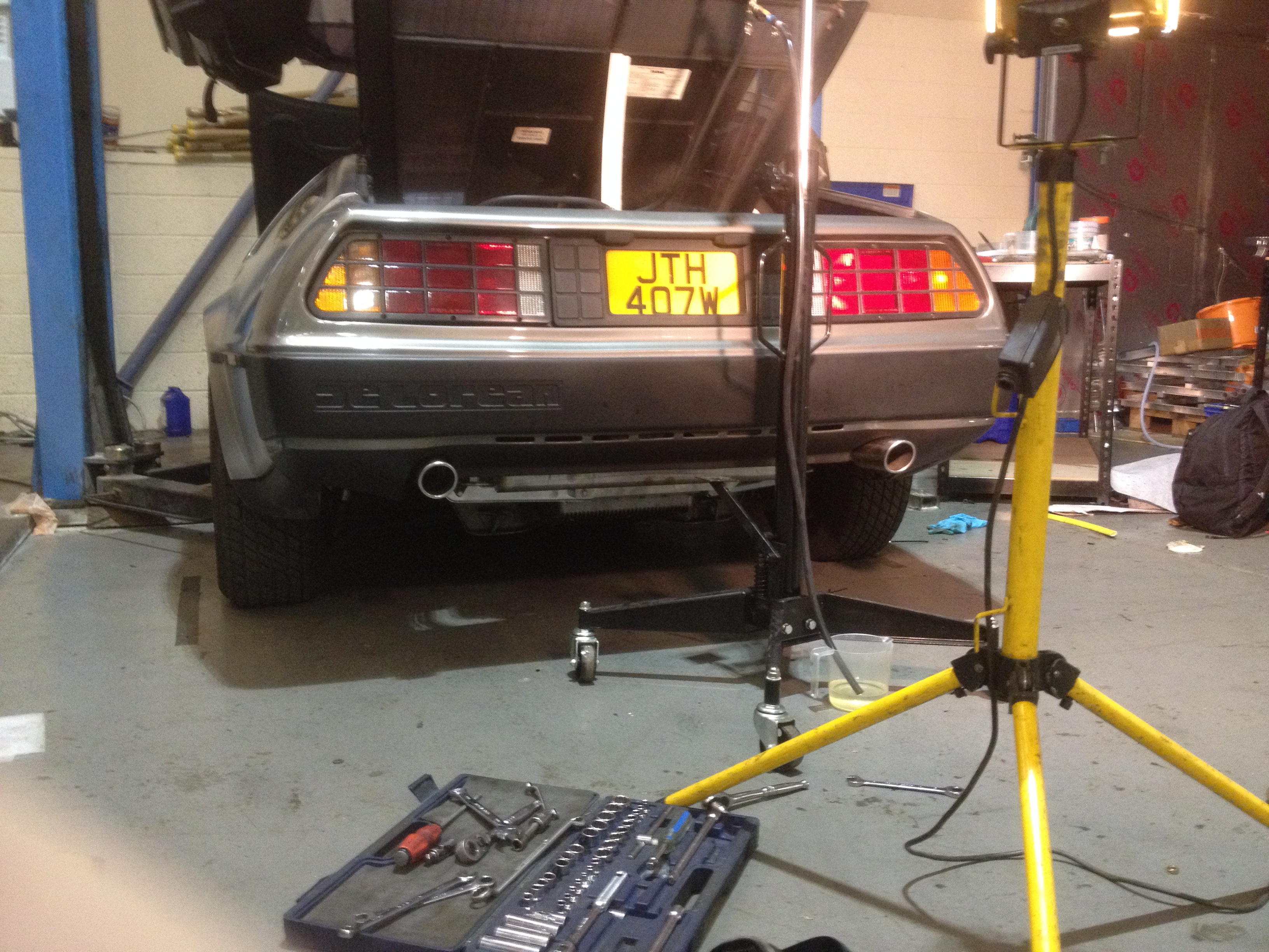

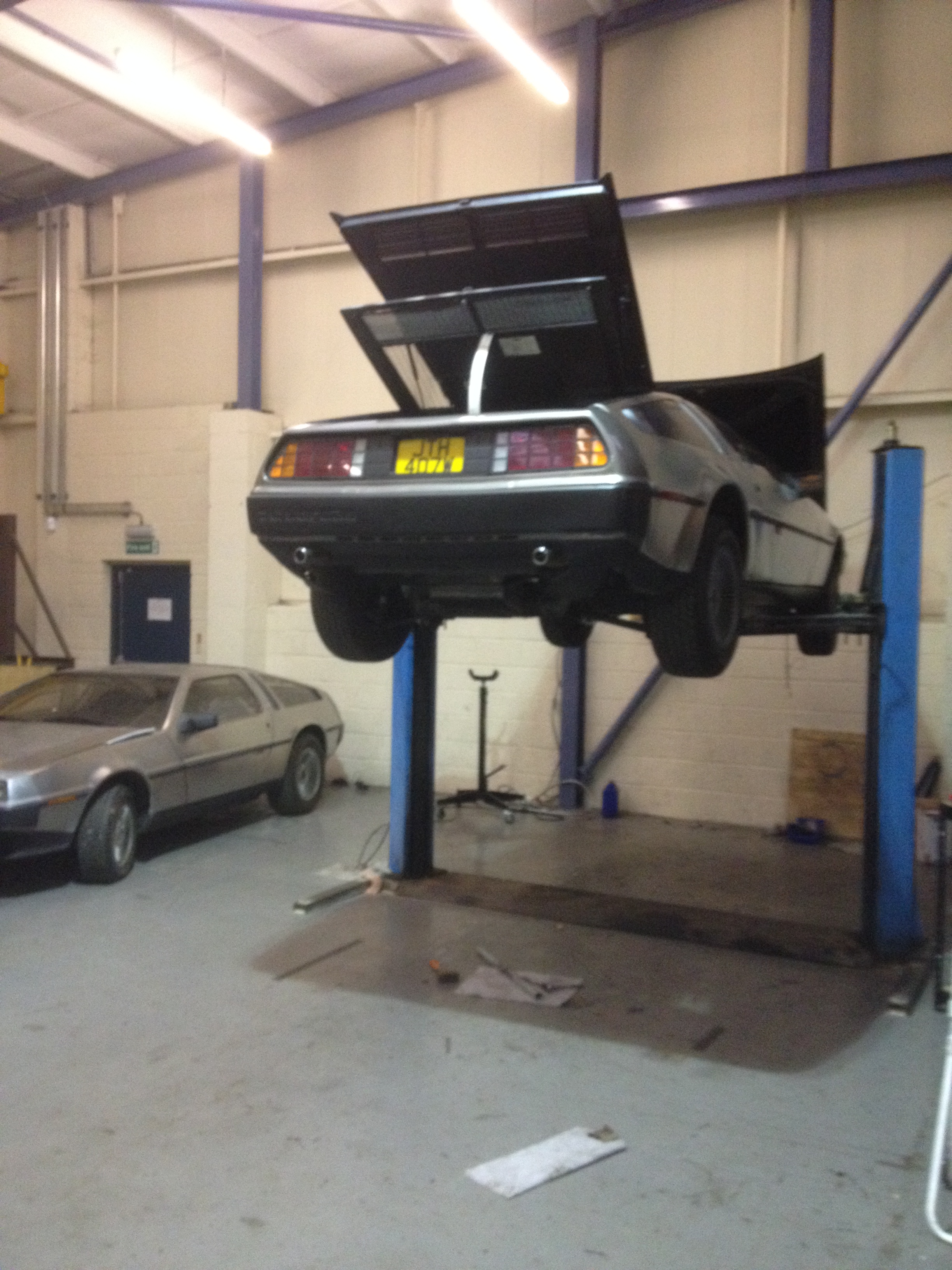

I arrived in a secret location near Southampton, and got the car on the lift about 6pm on Friday night. Best to disconnect the battery at this point- there are quite a lot of unshielded lives around the starter and alternator.
A pot of proprietary J12 penetrating fluid and a paintbrush was waiting for me. Some say this is an acetone-ATF mix, but I dont think anyone really knows whats in it...
When applying this to hot manifold nuts, be extremely careful- the flash point of the solvent is comparatively low, and potentially this could go up if the engine is too hot... You have been warned!
We decided to see if they would move. To our delight, all did. Probably due to the hot engine we thought?? The holes in the ally head expand away from the steel stud, and we thought all the ones we could get to came out. More on that later.

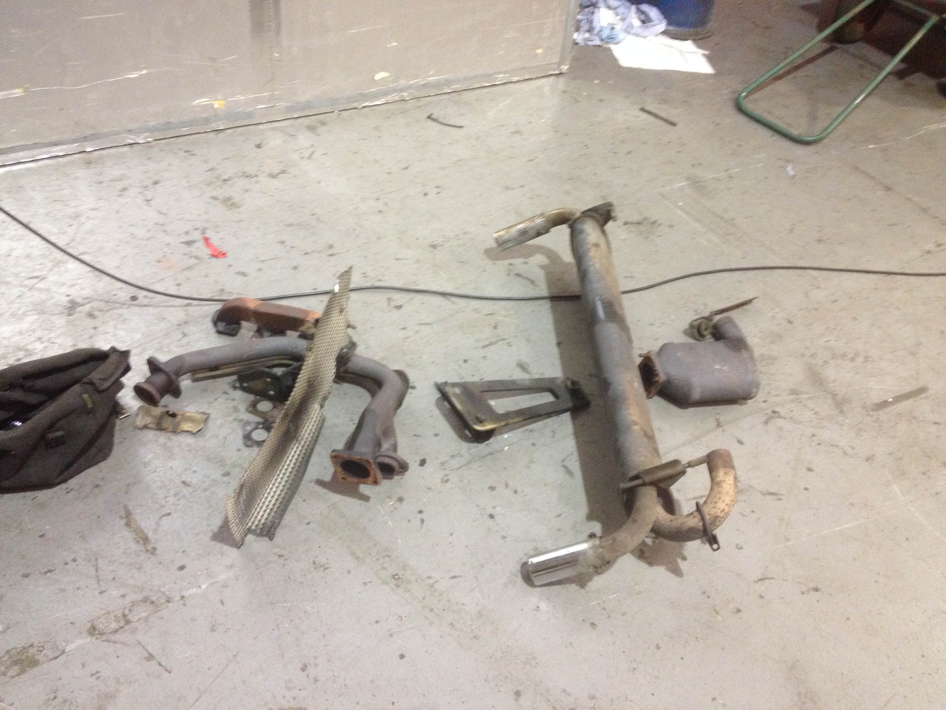

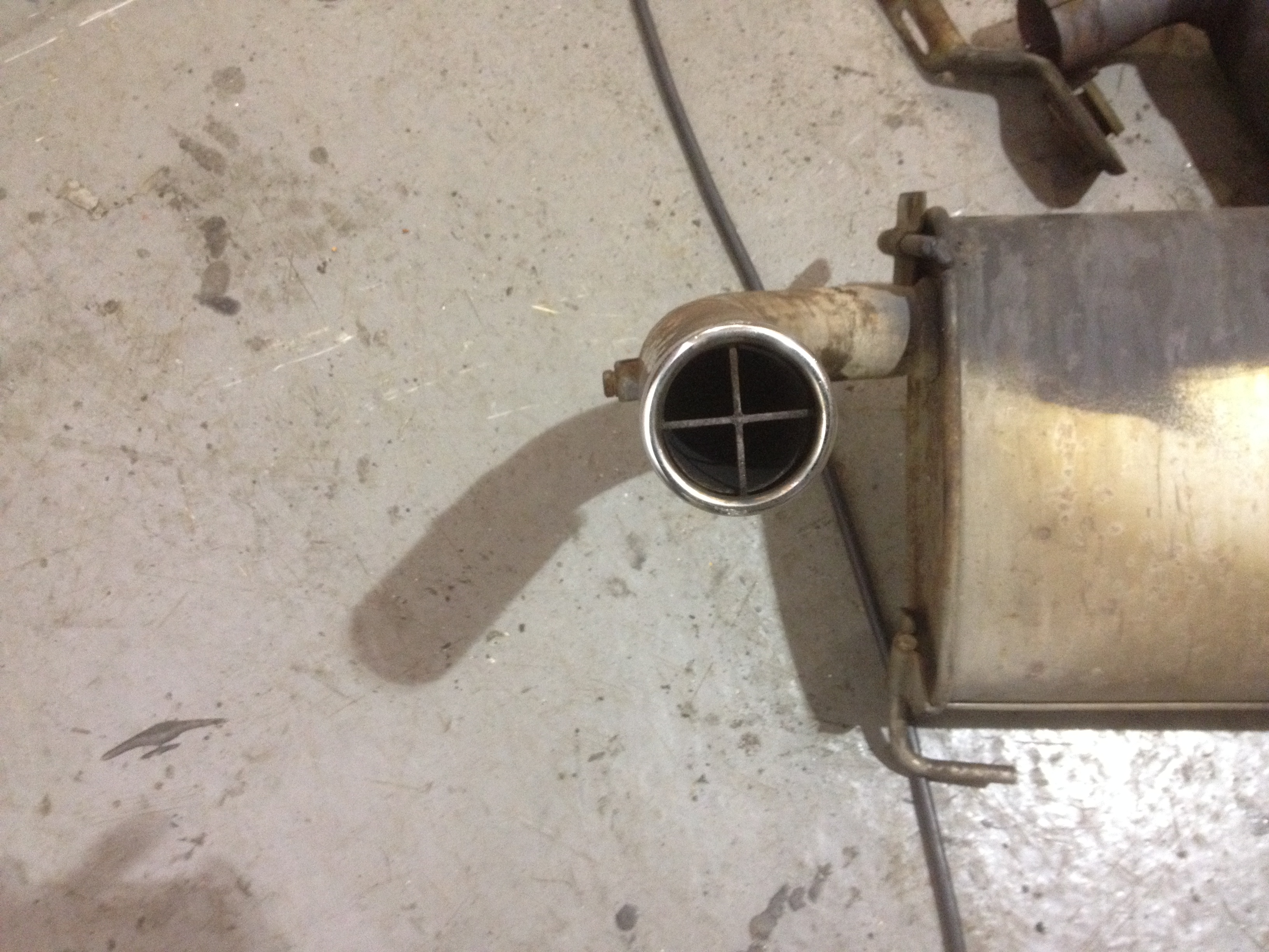

Its easiest to remove the manifolds, then the Y-pipe,knock the cat off the silencer and take the latter out, with the brackets and heatshield still attached.
Silly tail finishers be gone!!
Nows also a good time to remove the starter and alternator.
Be careful not to snap any studs on the alternator or starter. Doing so will delay the job!

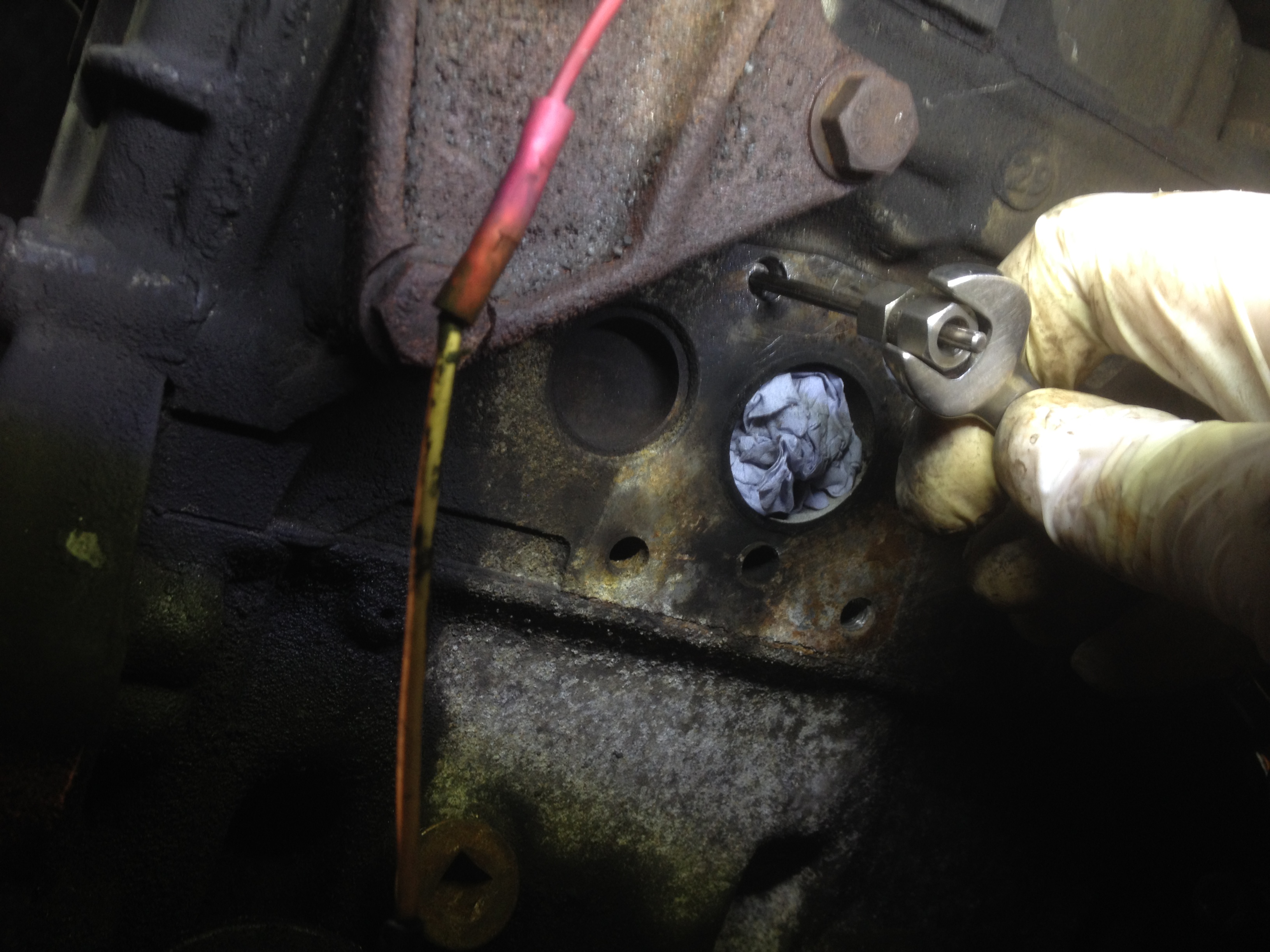

At this point we also noticed a previously snapped stud, so we decided to remove this.
This man is a hero:

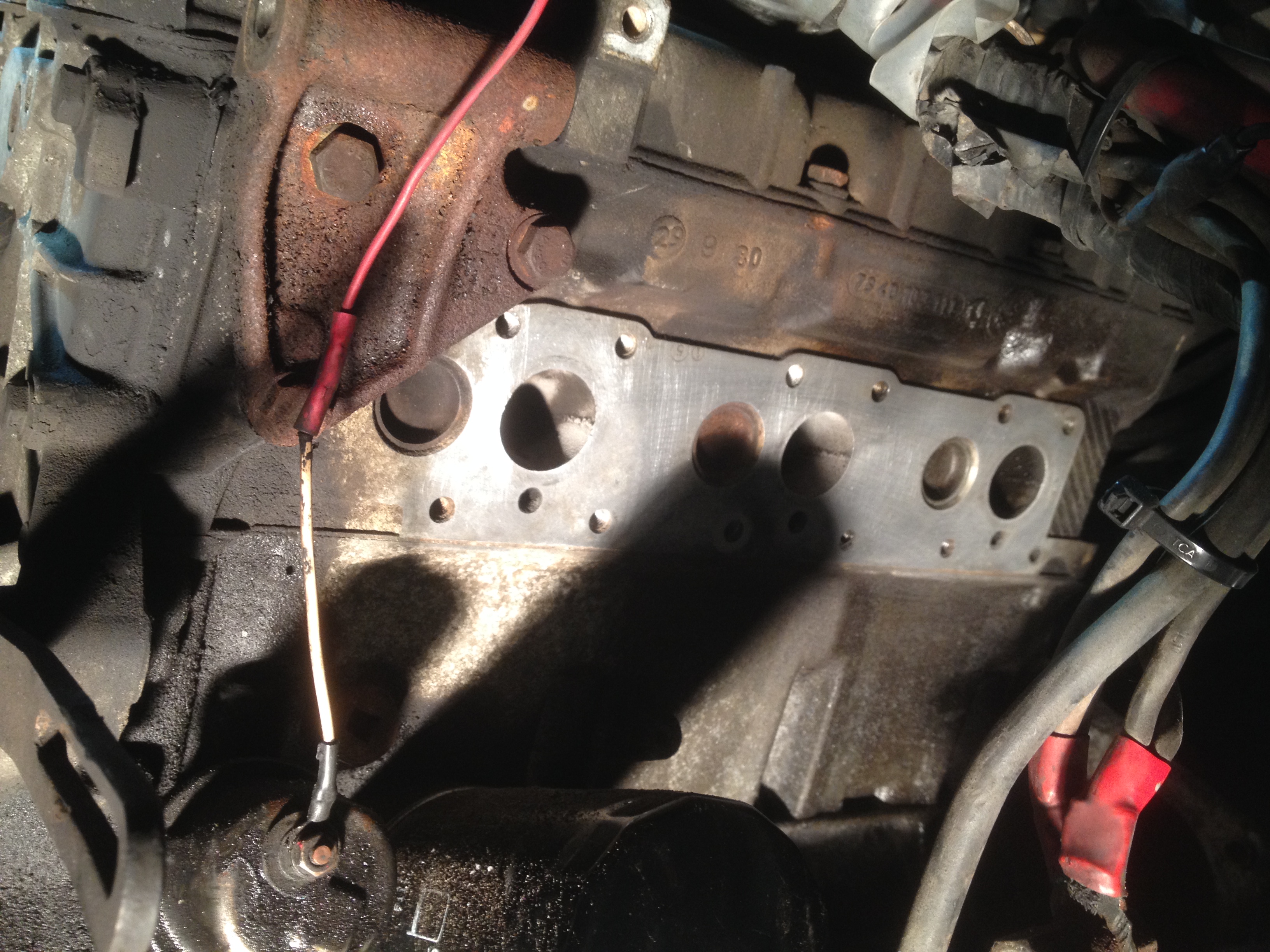

With a nice 90 degree air drill, Snap-On stud removal kit, and a lot of skill, we go this:
I can only imagine the pain of doing this on my tod, lying on my back, with a face full of swarf, with the sump 2 inches from my nose...

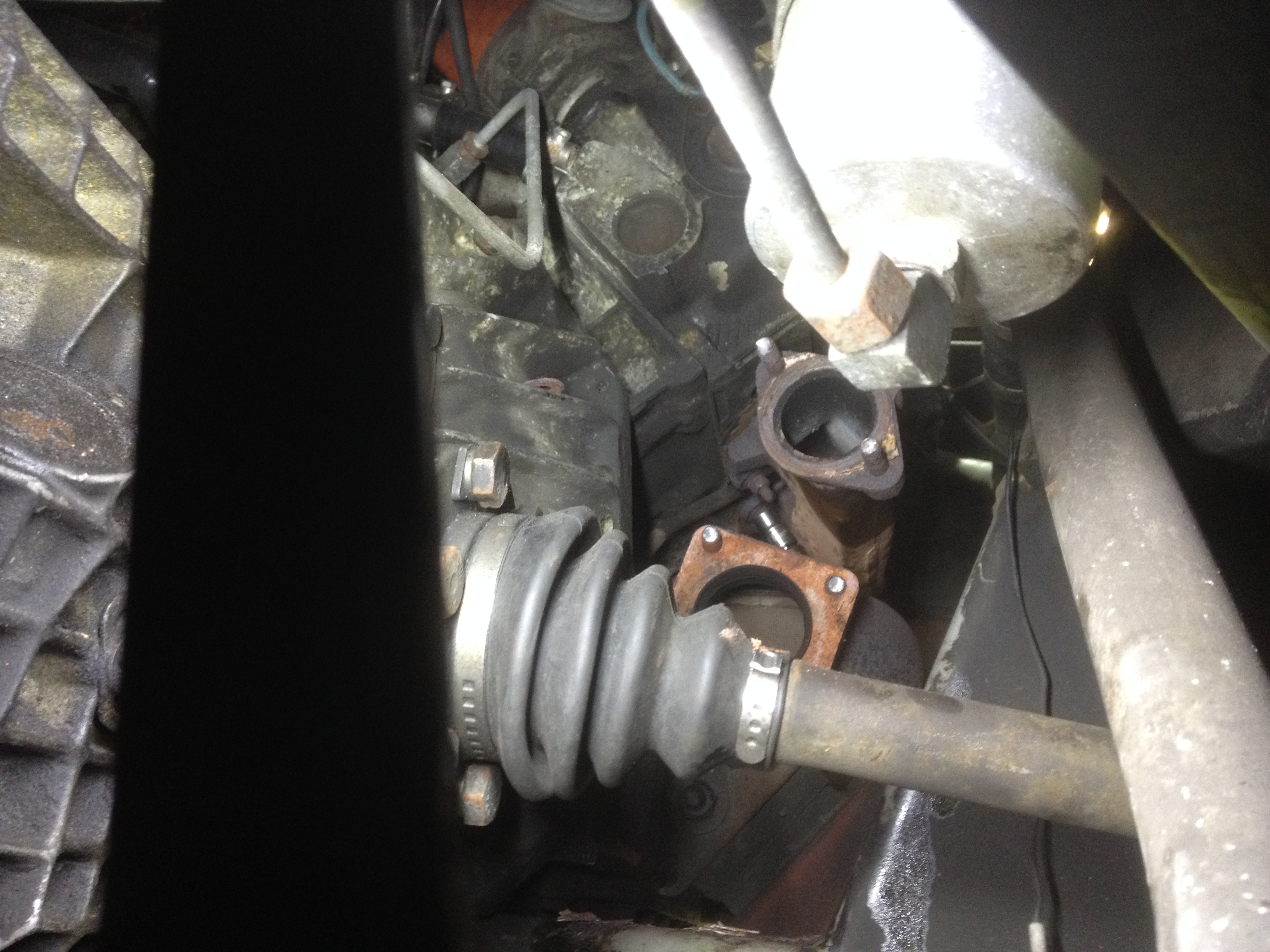

We cleaned up the mating surface with emery paper, and I reconnected with my cultural heritage...
Re: HaggisTek (or notes on fitting an exhaust)
Postby andyd » Sun Nov 05, 2017 8:04 pm
Nice clean mating surface,

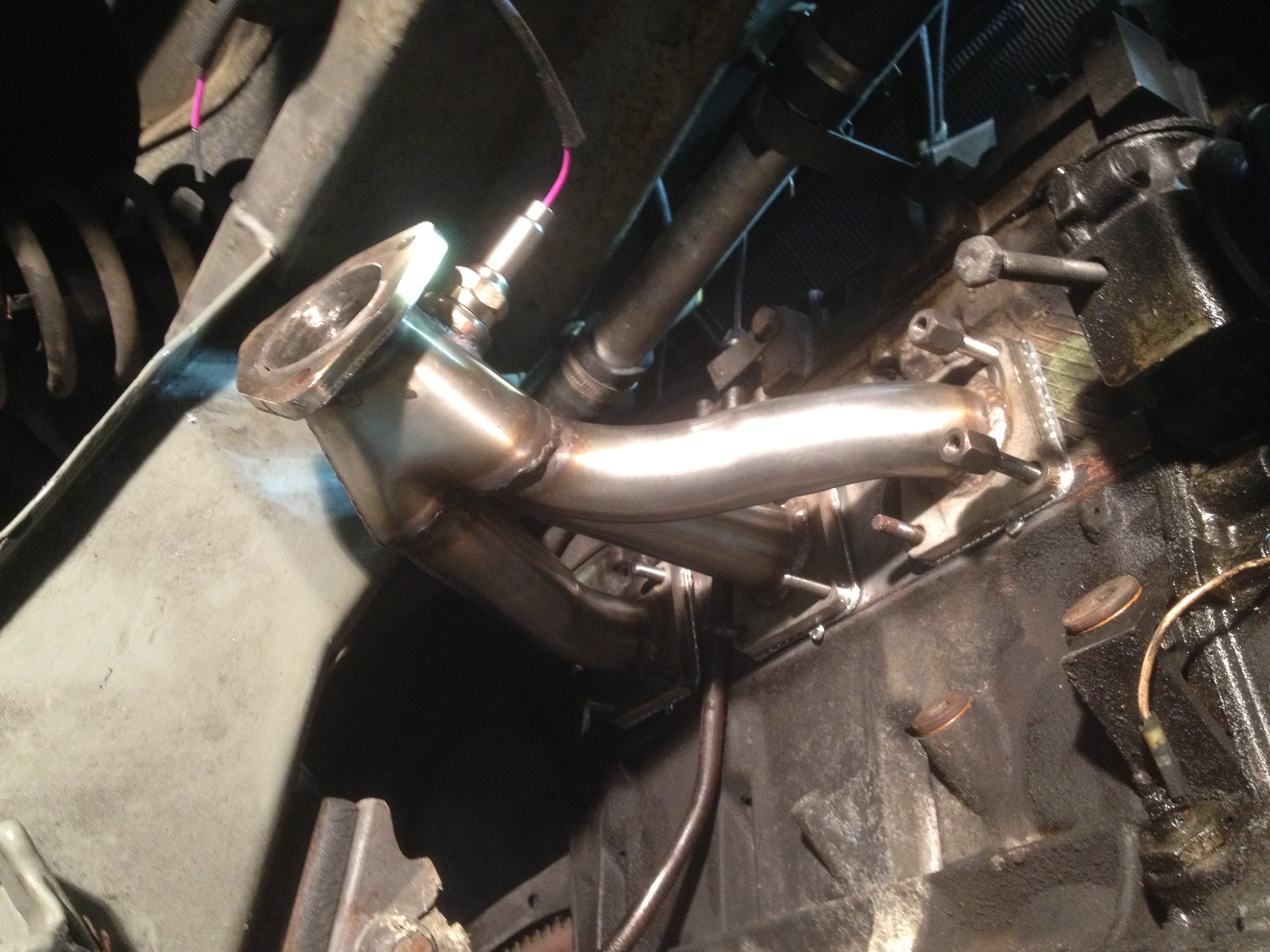

Note the new lamda sensor above.
Then, with both sides headers on, with gaskets, and tightened down, we loosely bolted the link pipes to the silencers, again with gaskets.

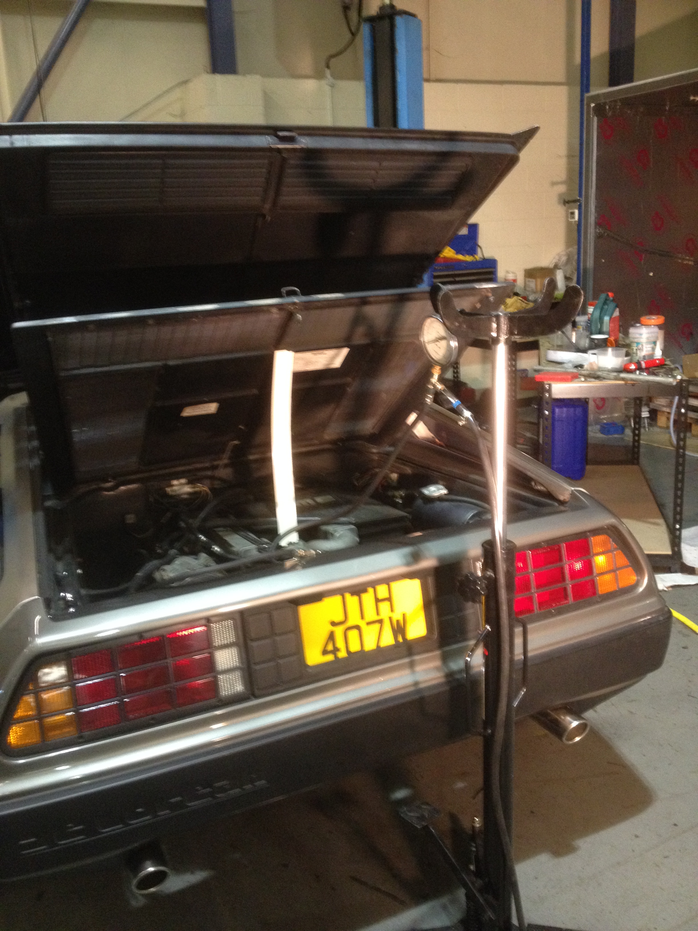

We then adjusted the fuel pressures slightly (5.3-5.4 bar for this exhaust.)
It fired up nicely, and sounded good.
Out for a quick blatt to get it up to temperature, and set the timing and mixture. But that, my friends, is a story for another night!
