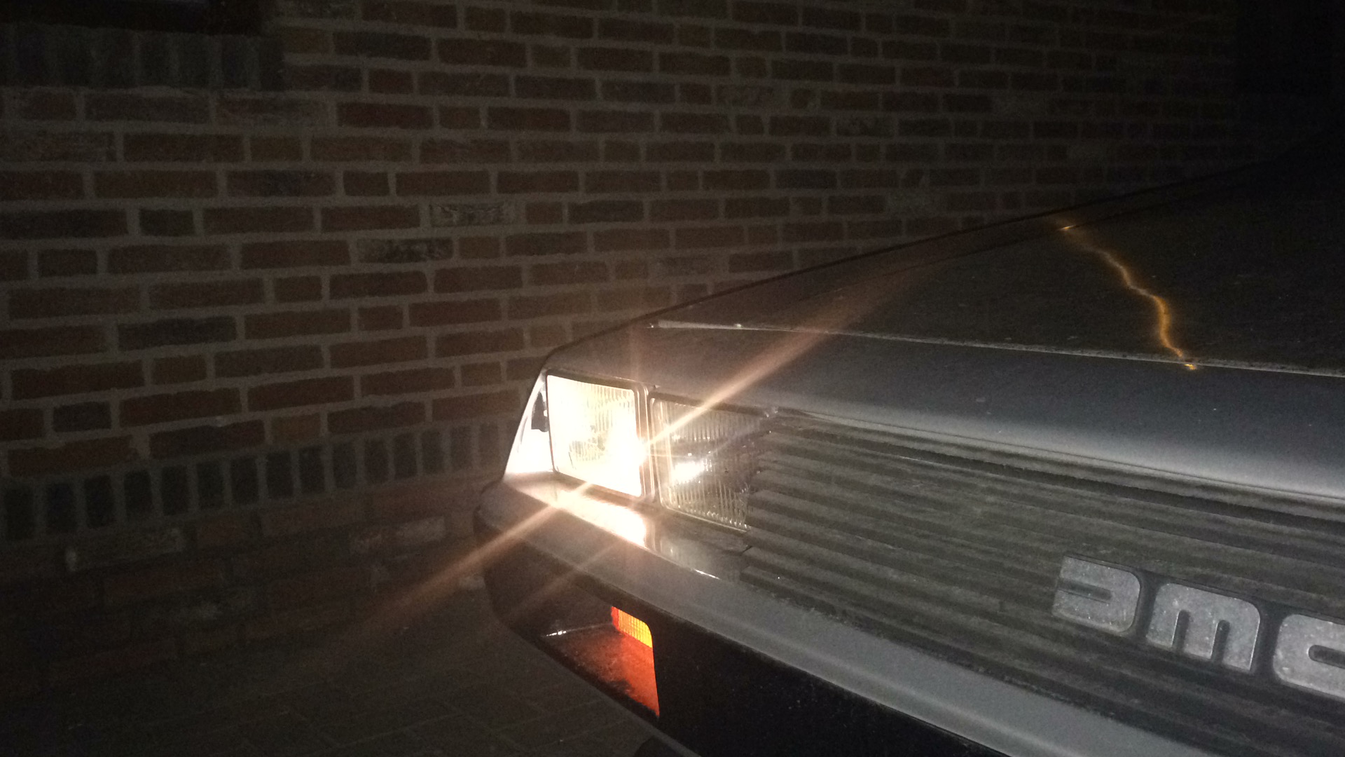

New Hella Headlights, running ground wires to and from the fuel pump. Replaced the sidemarkers, side marker leds

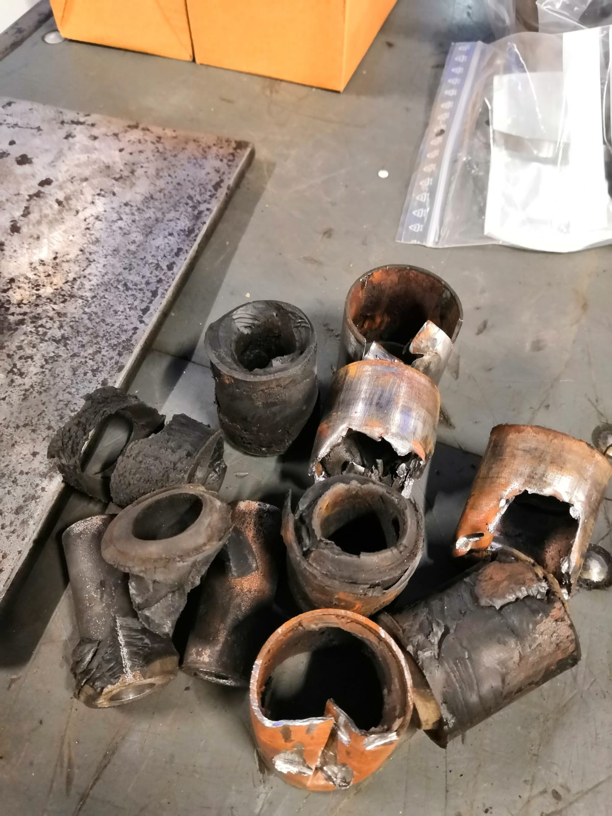

Crusty rear suspension bushings...

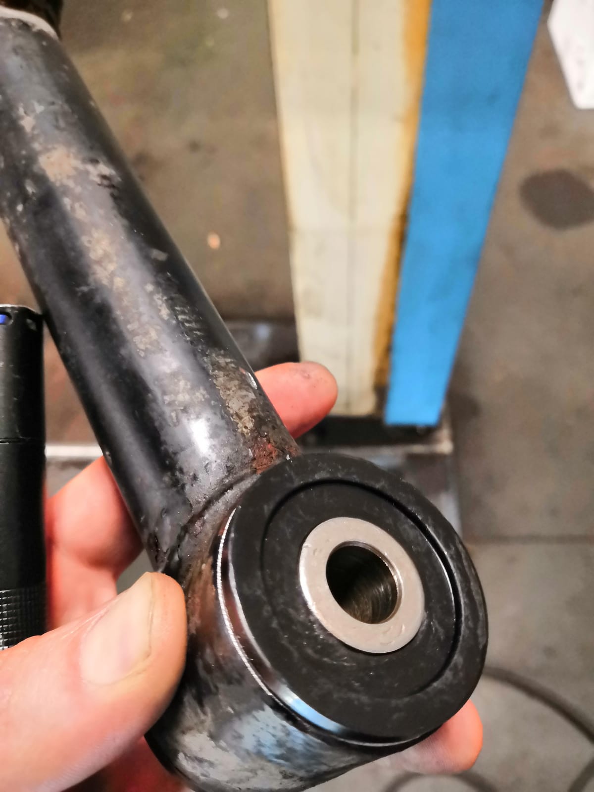

New urethane bushings, and reassembled rear axle.

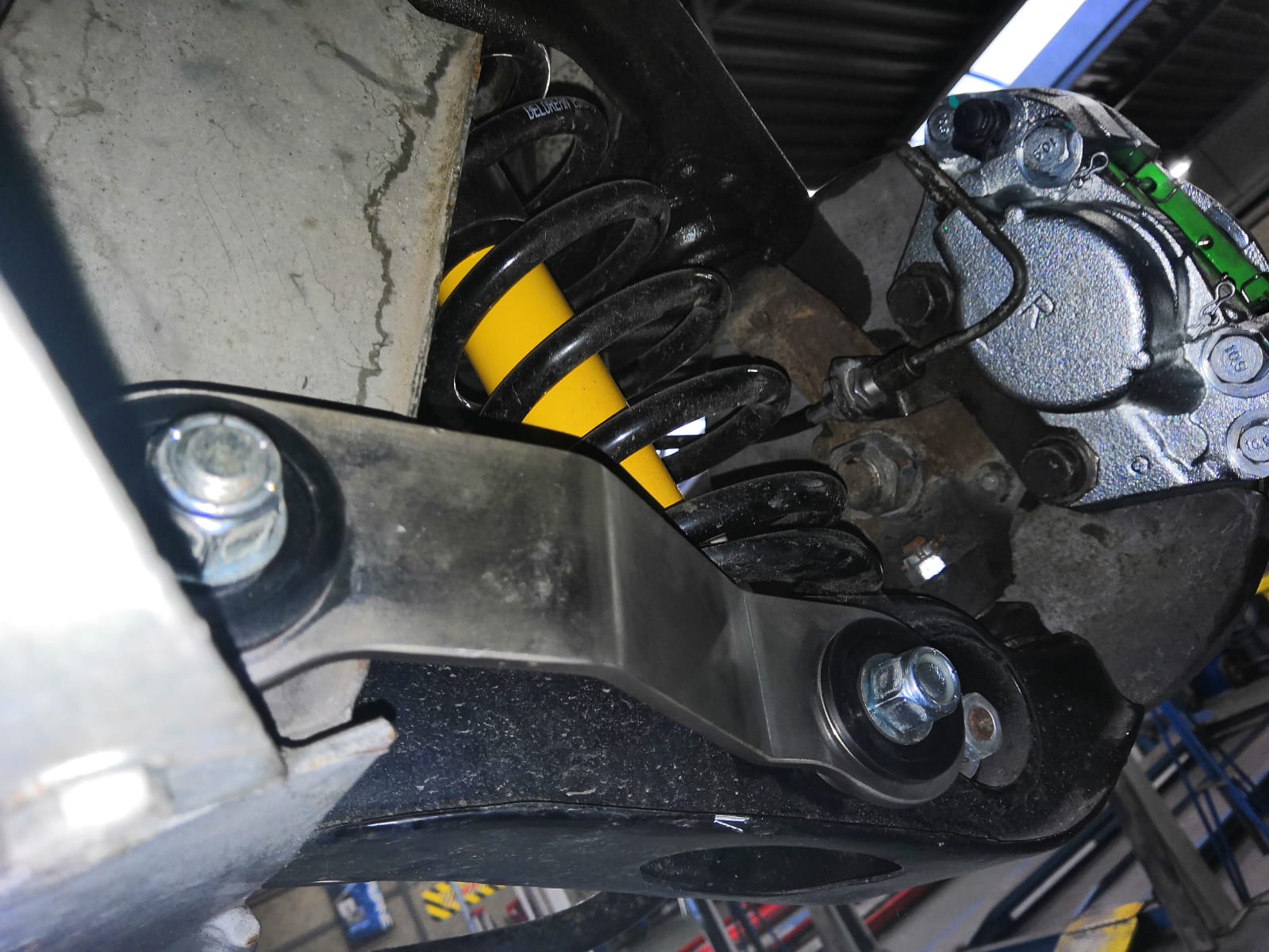

Front suspension rebuild. New lower wishbone support brackets, upgraded front brakes (vented discs), new wheel bearings

Were the rear bushings bad then must admit I hadn't paid any attention to them were they in one piece?

Ah, just a 37 year old car. Can’t expect everything to be new. So basically picking up, where you stopped.
You already did a vast amount of work on the car. I’m just continuing it.
