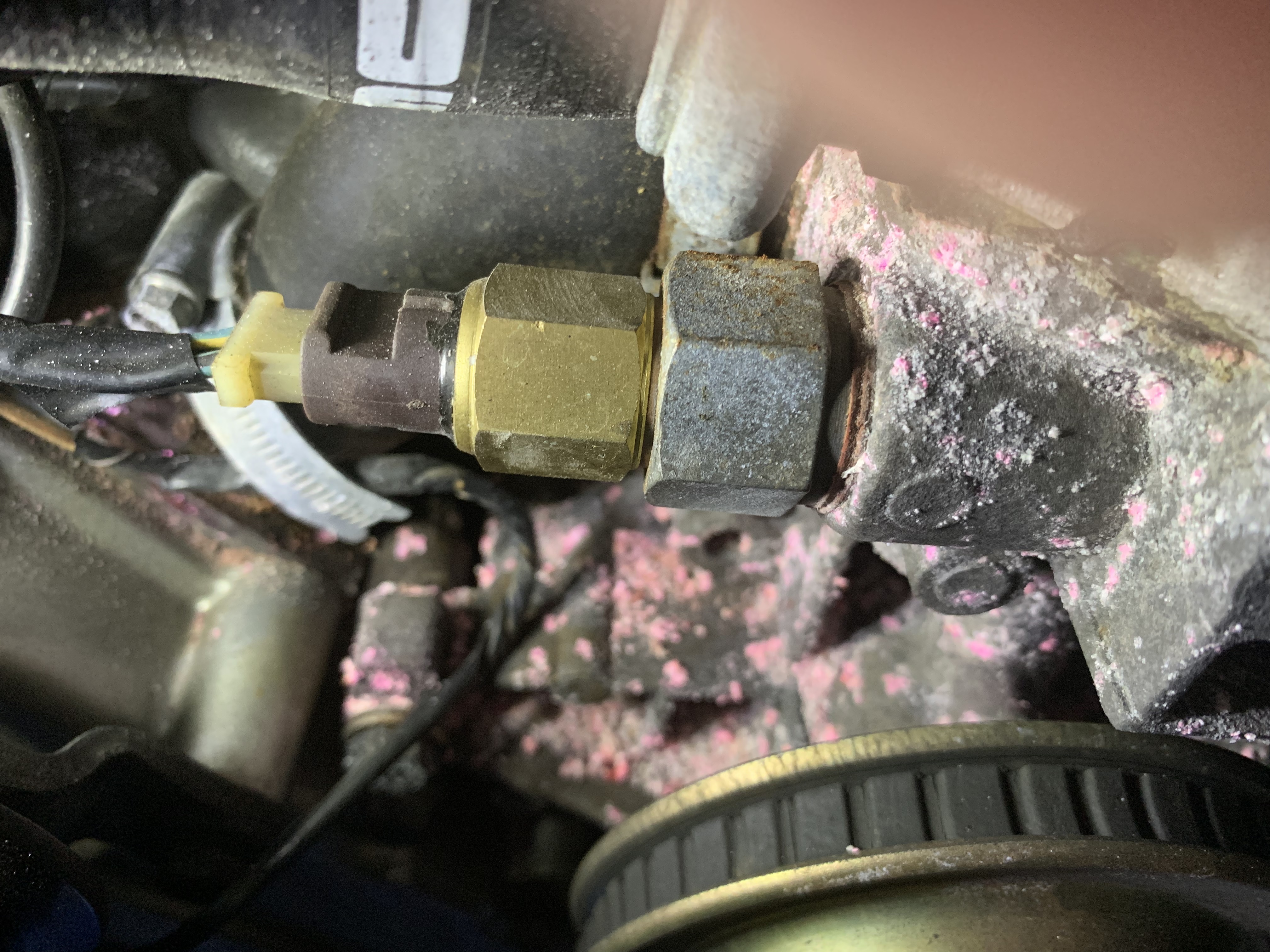

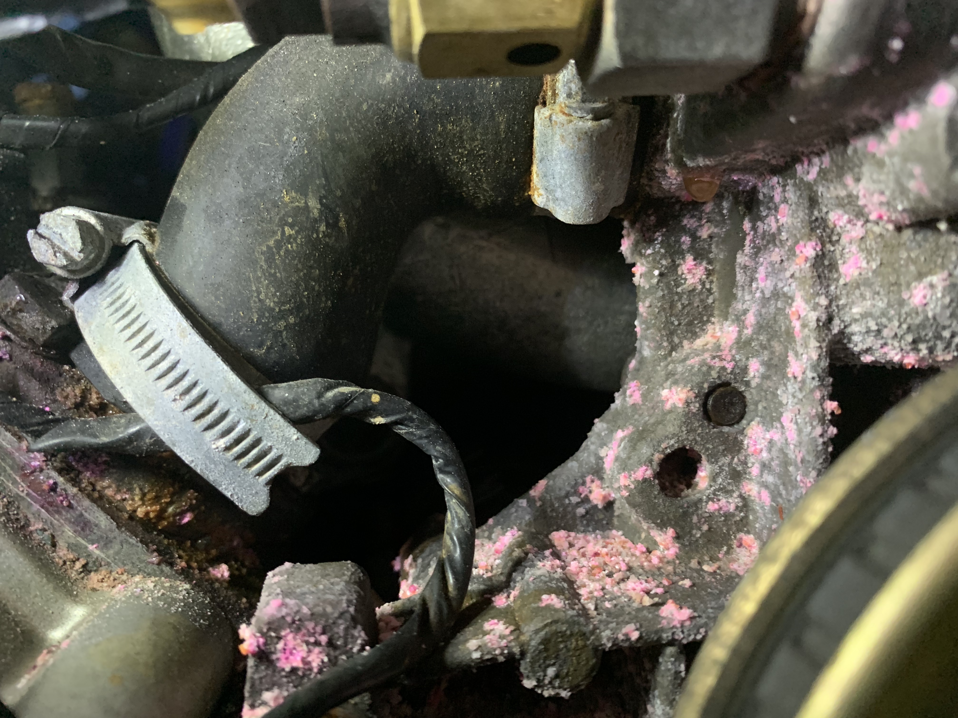

Just picking all your brains regarding my coolant leak - before I bought the car it had quite a bit of work done by PJ GRADY - head gaskets, chains - all hoses but losing about a pint every 50 miles or so since I have owned it - can’t see any wet - drips or moisture just this dry residue - just can’t see where it’s coming from - doesn’t seem to be anything on garage floor either - any ideas ?

I would it pressure tested
It looks like there has been a leak around the pump area
It could be leaking into the valley and evarporating with the heat so you don’t see it sloshing over.
