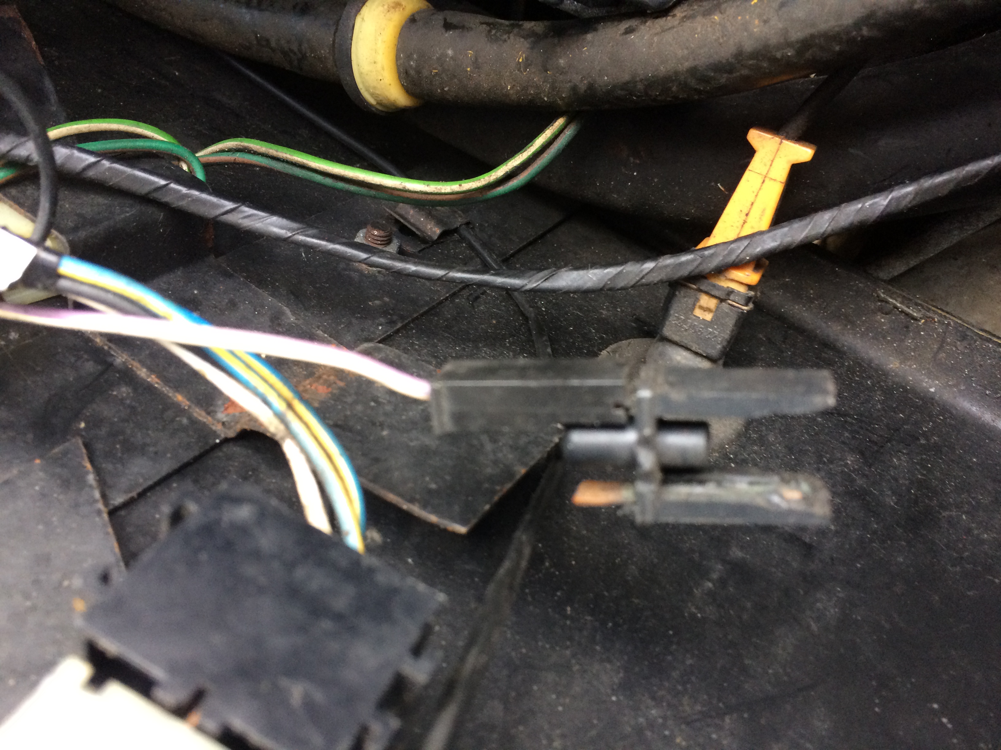

Very low! Engine cut out when tester parked and 5-6 hot start attempts before I drove 200 yards and engine died totally in traffic intersection no start for 10 min then 200yards home.Numerous unconnected plugs and wires in front left engine bay and ECU lead out of bulkhead is not connected -to o2 sensor. Am I open loop,too lean and causing the problem? Need to buy new trolley jack tomorrow to access underneath. Nick set the system up so it should be perfect.

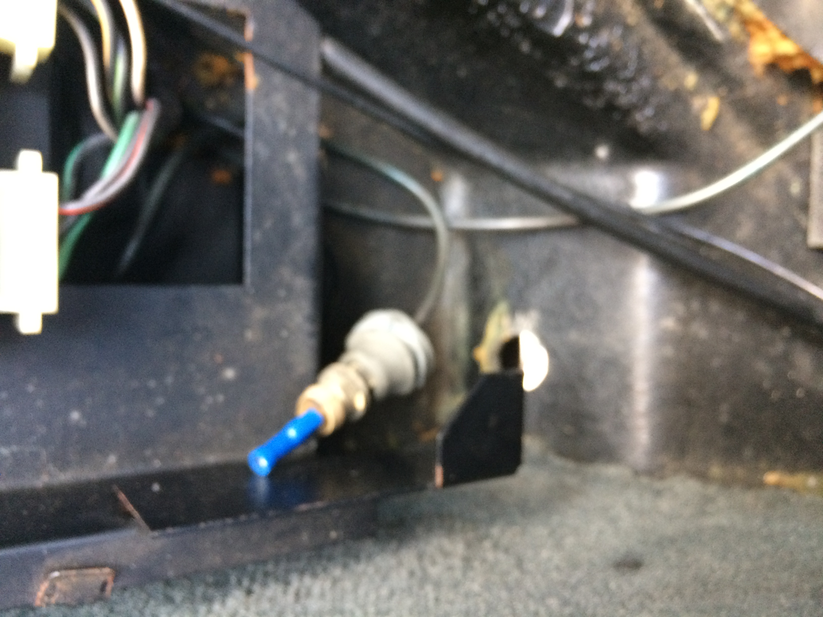

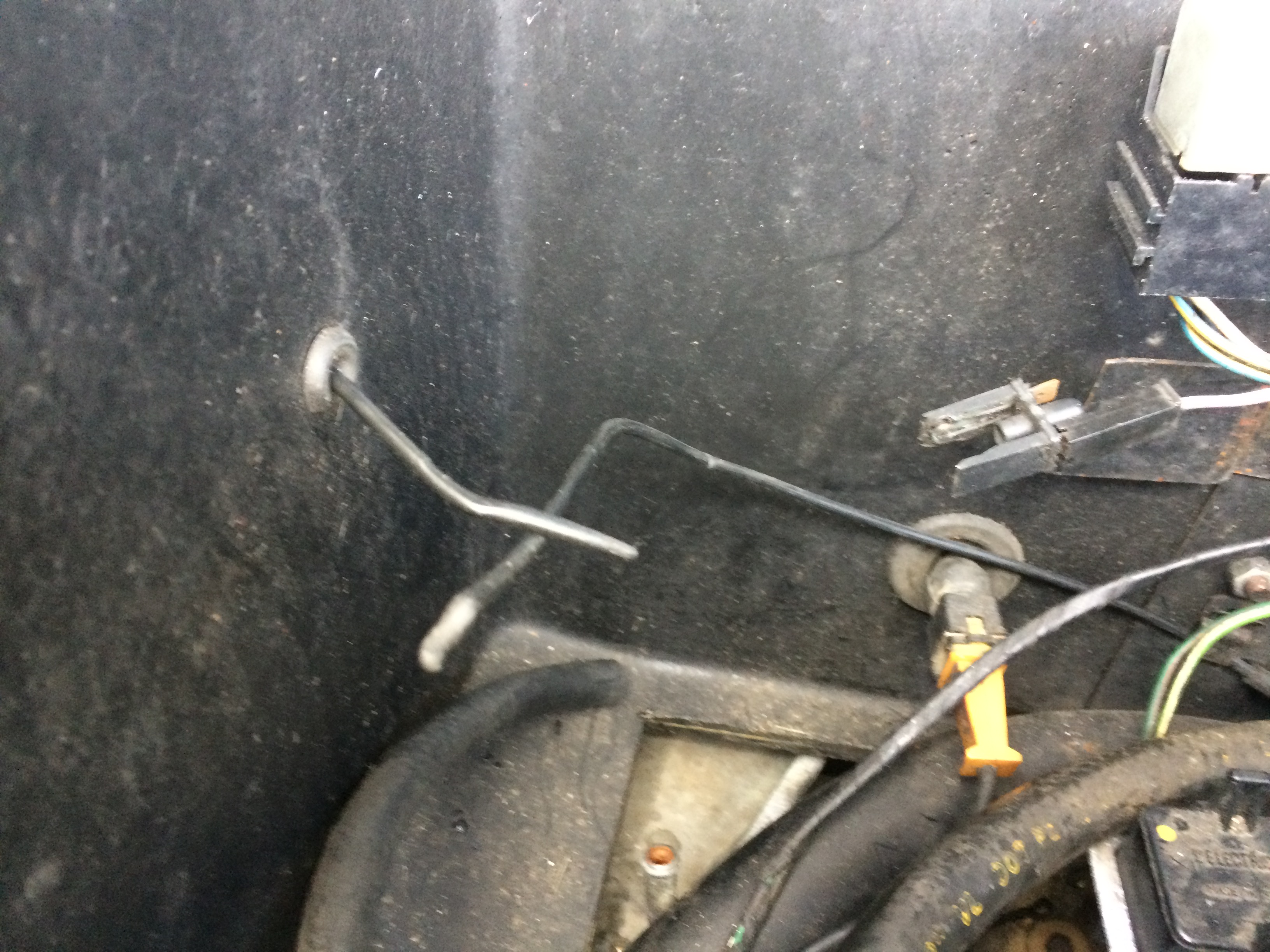

Have tried to show forward left part of engine bay and loose connectors .If not clear msg me
ECU BULKHEAD GROMMRT

Postby Corsair » Sun Jul 21, 2019 1:18 am
Last few photos are unconnected ECA lead into back bulkhead and previous show carbon cannister lead to? Engine fume system.
