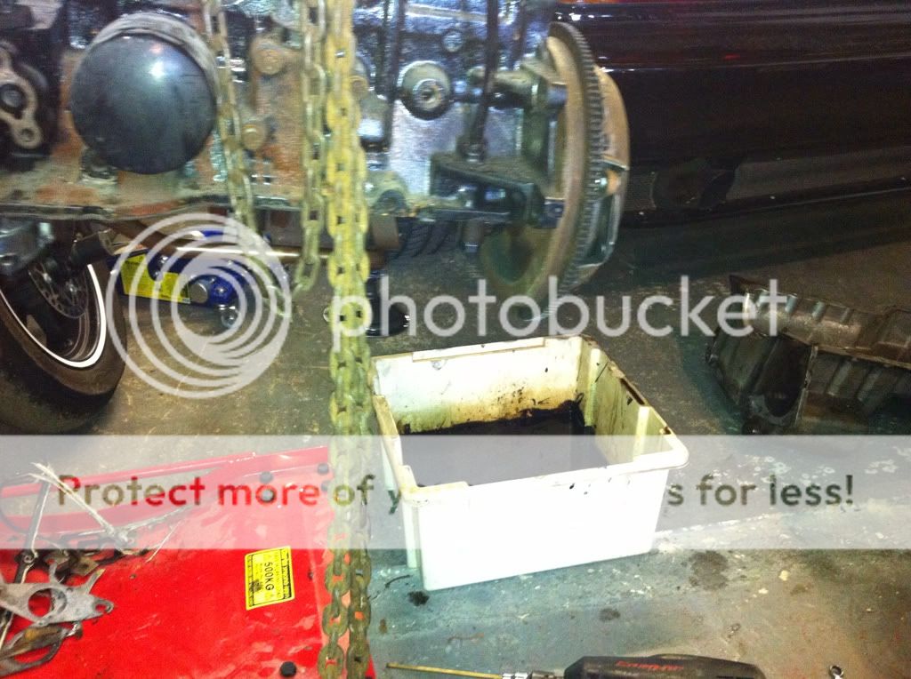

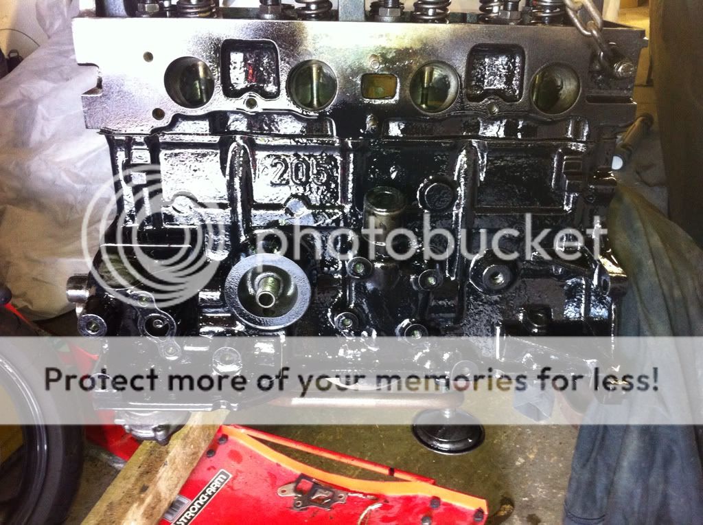

Postby bandit » Sat May 12, 2012 3:11 pm
Stripped engine today, gave the block a clean & wire brush & a nice coat of black.ImageImage

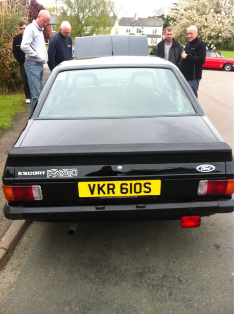

I saw a mint one at a meet near me last weekend
Re: Me RS2000
Postby bandit » Sat May 12, 2012 6:49 pm
Very nice Al, that's pretty much what mine looked like before the scum struck. But it will again!

Postby Darren C » Sat May 12, 2012 7:45 pm
Don't forget to clean that paint off the oil filter seal and manifold face. ;)
Re: Me RS2000
Postby bandit » Sat May 12, 2012 8:16 pm
No fear Darren, it's having a 'blocking' down once it's dry. Good old iron block & head, you can 'give em' some. :D

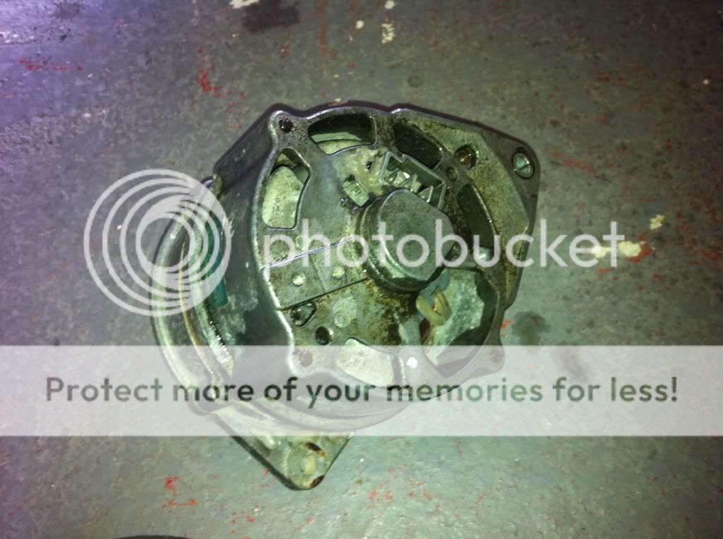

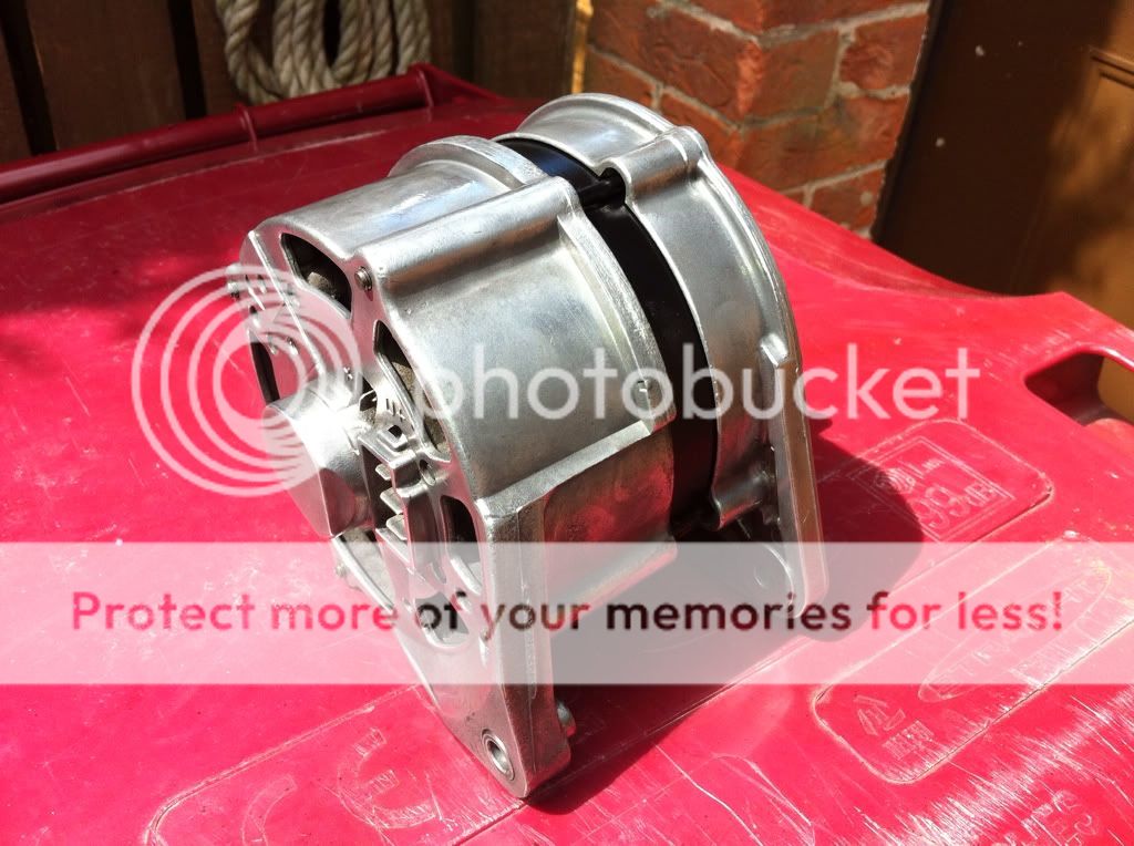

Postby bandit » Sun May 13, 2012 2:20 pm
Had an hour this morning & gave the alternator a clean up. Pulley & fan is off for plating. ImageImage

Postby Admin-bloke » Sun May 13, 2012 4:32 pm
It's looking great :thumbsup:
What did you use to clean the alternator?
Re: Me RS2000
Postby bandit » Sun May 13, 2012 5:08 pm
Took it apart Mr AB, then used a brass wire wheel on my upright bench drill. Finished it off with the rough mop from the polishing kit. Don't want it bling, just nice clean ally. It will 'dull off' nicely now & look spot on when it's fitted.

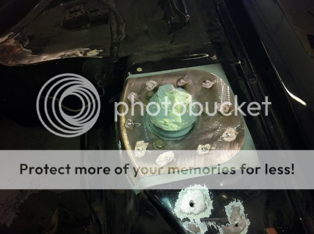

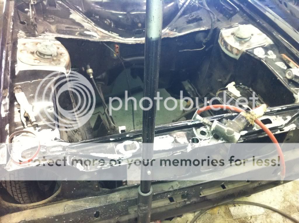

Postby bandit » Thu May 24, 2012 5:32 pm
We are gettin on with it now, engine bays first jobImageImage
