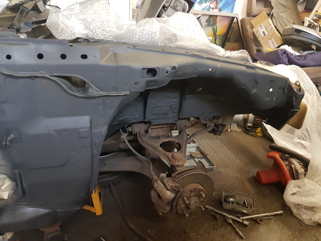

Another little update today, I've now got all the inner wing cleaned up and 2 coats of stone chip applied...

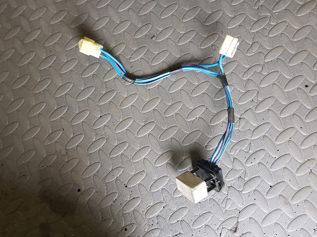

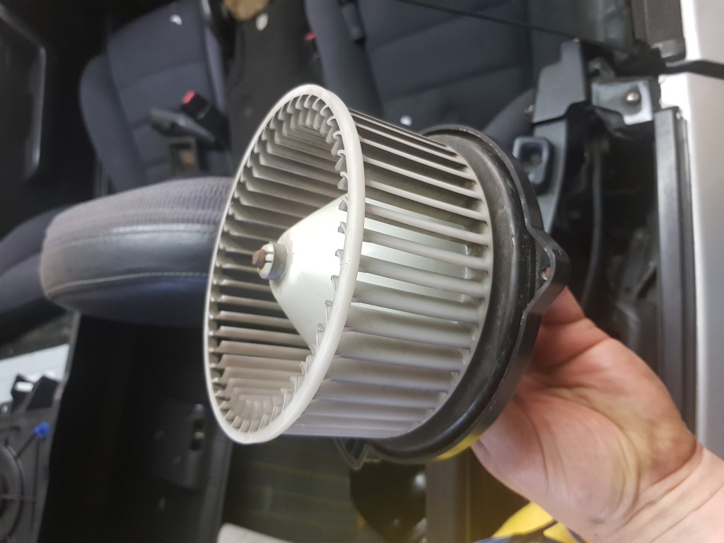

I've then turned my attention to the heater not working, 1st i checked all the fuses, they are all good, so i took the motor out and checked this outside of the car ..
20191016_211248 (Medium).jpg (126.18 KiB) Viewed 8892 times
It powered up fine so I have come to the conclusion its the heater resistor that failed..
20191015_151303 (Medium).jpg (410.5 KiB) Viewed 8892 times
This is a sealed unit and they are only just over a tenner 2nd hand, so I'm going to order one and see how i get on.

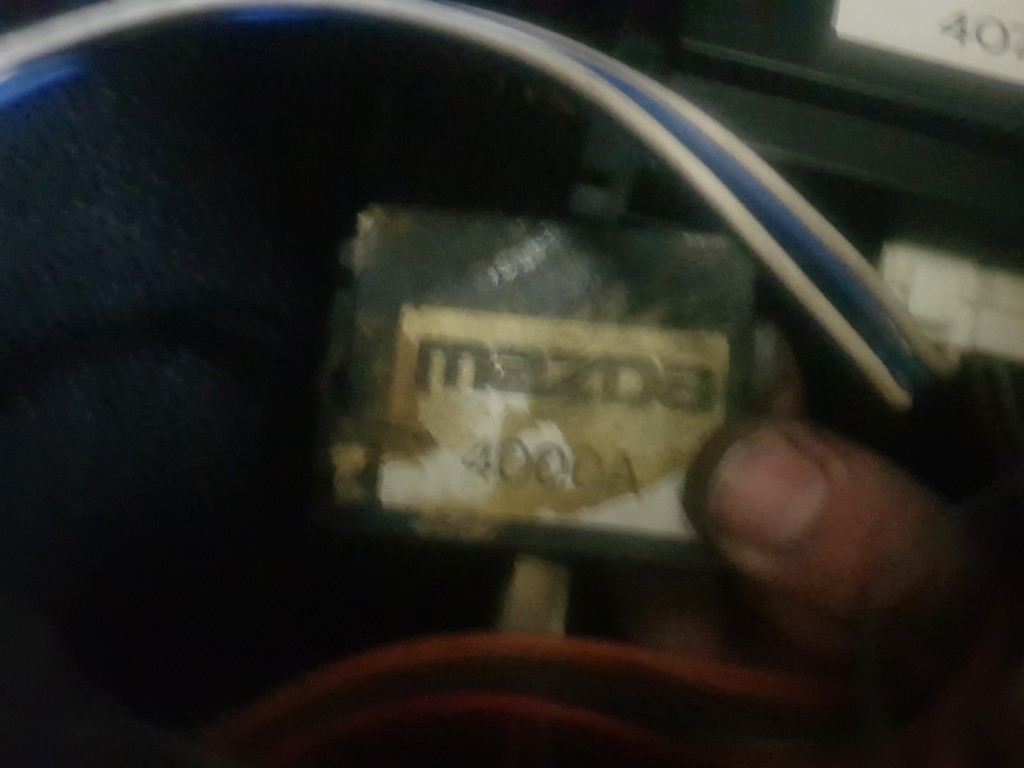

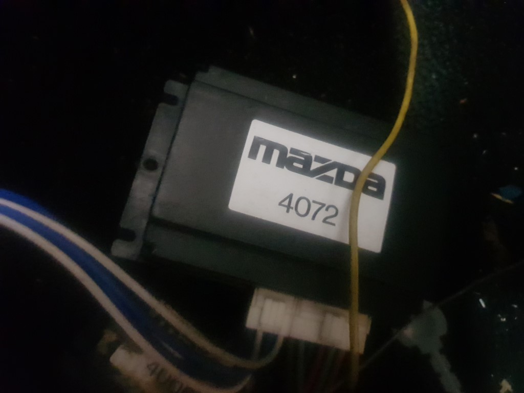

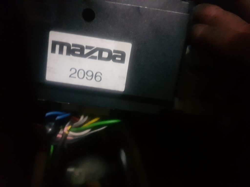

When i removed the glovebox to access the heater motor, 3 modules fell down...
20191007_003741 (Medium).jpg (76.08 KiB) Viewed 8892 times
20191007_003732 (Medium).jpg (101.8 KiB) Viewed 8892 times
20191007_003727 (Medium).jpg (89.49 KiB) Viewed 8892 times

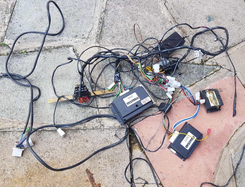

I had a look online and found that these were an add on alarm system when the car was new, which also gave the car central locking and auto up windows upon locking, on inspection wires had been cut and nothing was actually connected anymore, why people don't remove things properly I have no idea, there are no solenoids in the doors and i don't have any remotes for it so i set about removing all the old wiring which ran into the doors, engine bay, window switches etc ...
20191015_143008 (Medium).jpg (414.4 KiB) Viewed 8892 times
what a mess !! Behind the dash is a lot neater now

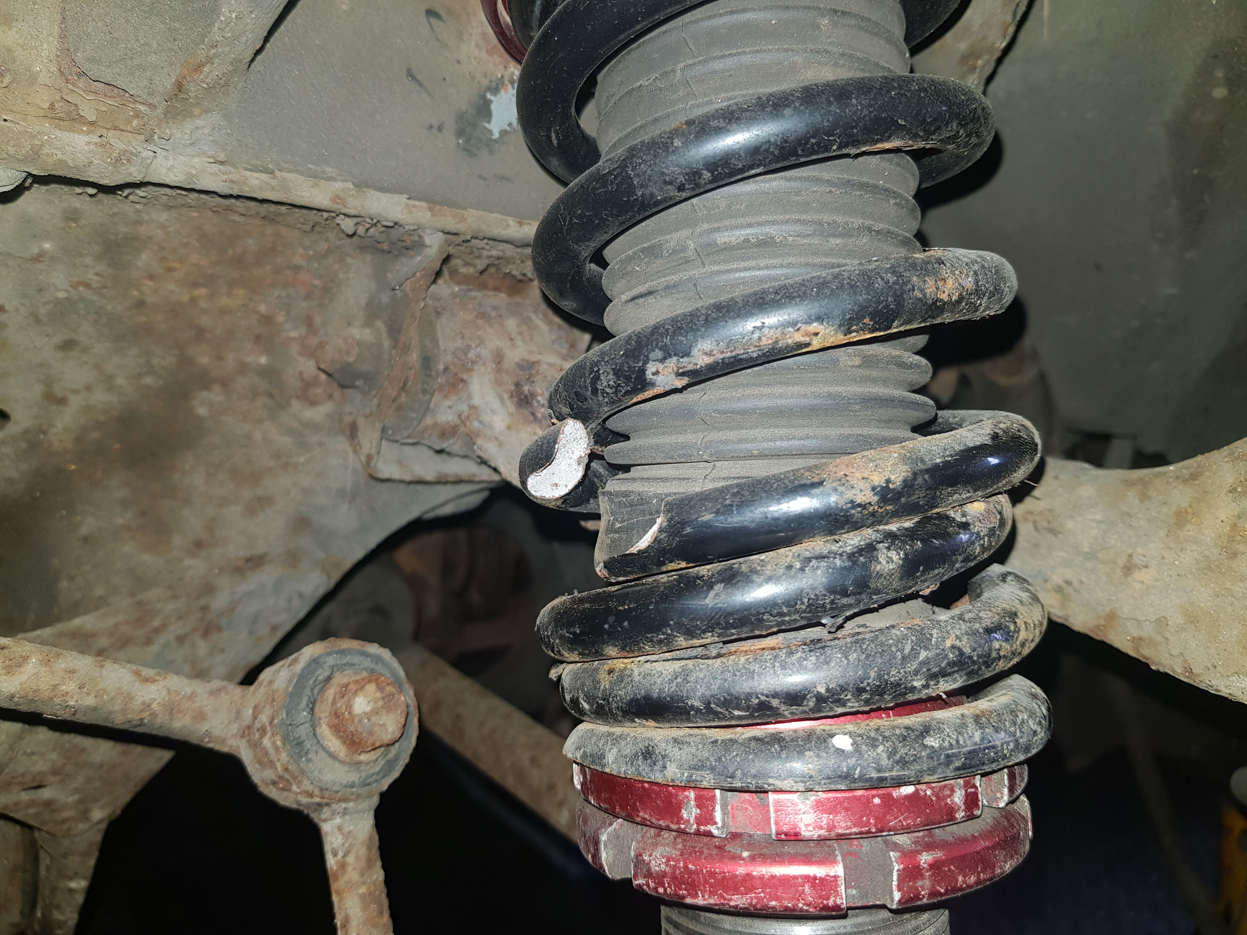

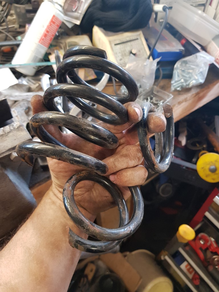

Now i went onto the suspension, in the ad when i bought the car it said the car had coilovers but the front ones have been changed back to standard because the old front coilovers lost there dampening, so i knew Id have to do something about it, just not this soon, I looked under the rear arch to see what coilovers were on it and found this...

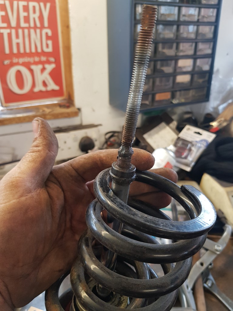

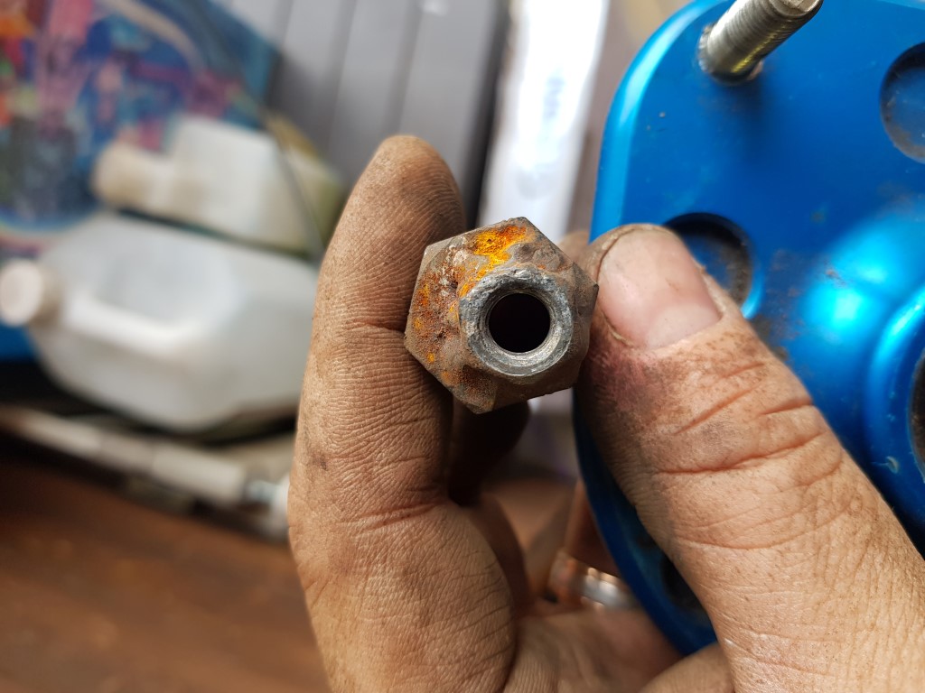

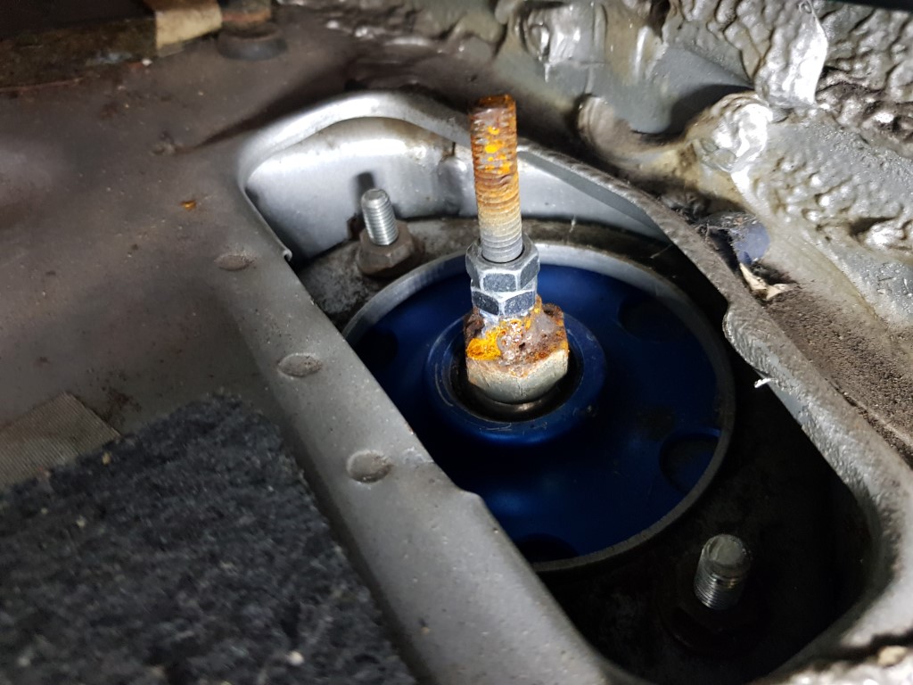

So looks like i gota sort out the suspension sooner than thought, I took out the rear coilover and it had been proper bodged in the past...
20191015_121222 (Medium).jpg (167.34 KiB) Viewed 8892 times
20191015_122400 (Medium).jpg (219.71 KiB) Viewed 8892 times
and the spring was snapped in 3 ! ..
20191015_122411 (Medium).jpg (241.14 KiB) Viewed 8892 times
and a bodged shim in the top mount :doh:
20191015_123007 (Medium).jpg (176.64 KiB) Viewed 8892 times

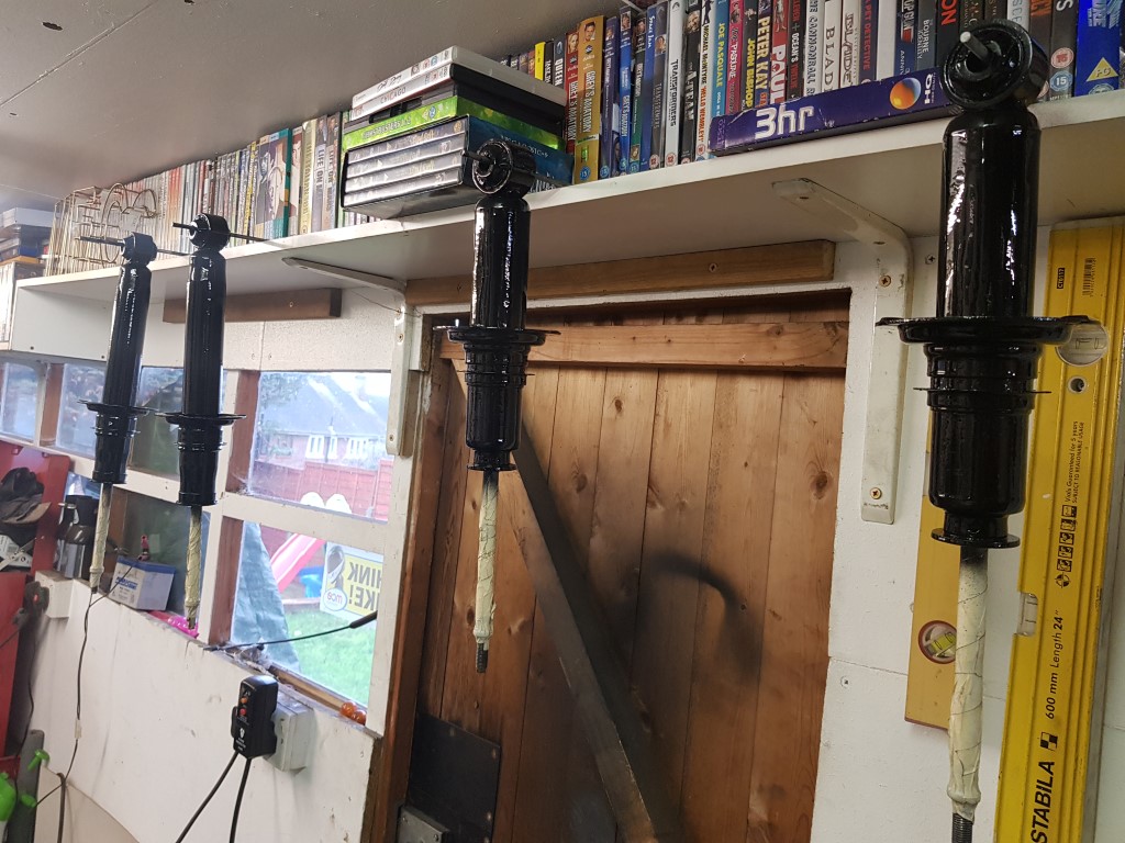

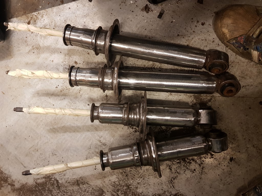

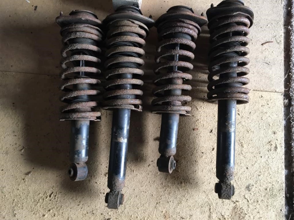

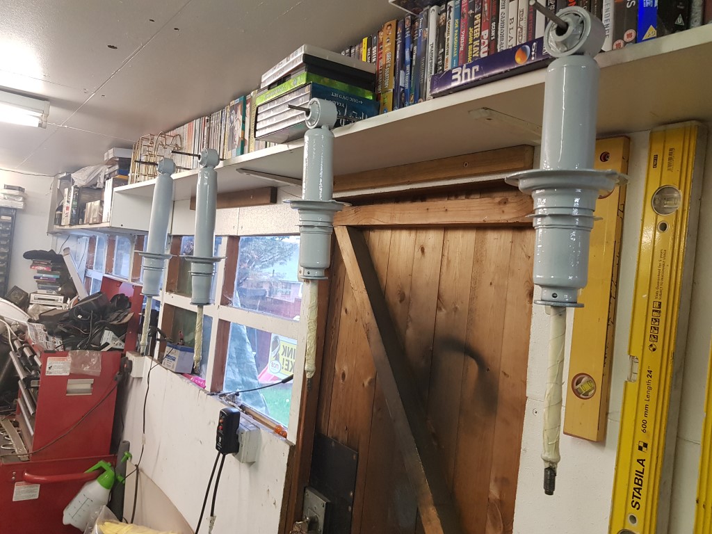

Bit of an update on Poirot, I have finally managed to sort out the suspension, originally i bought a cheap set of ebay coil-overs for it but i wasn't very happy with these and because I had mismatch suspension on the car the top mounts wouldn't fit without loads of mods, so i found on Facebook a standard set of suspension for £10 ! ...
facebook springs (Medium).jpg (201.71 KiB) Viewed 8621 times
I bought these cause because they are leak free and came with all the standard Mk1 top mounts, on the car the front suspension that had been fitted was off a Mk2 and although this fits it wasn't right, and on the back the old coil-overs had there own top mounts which as per the previous pics had been massively bodged on one side so having a matching set of top mounts was needed, now these are very tatty so some refurbishing was needed ...

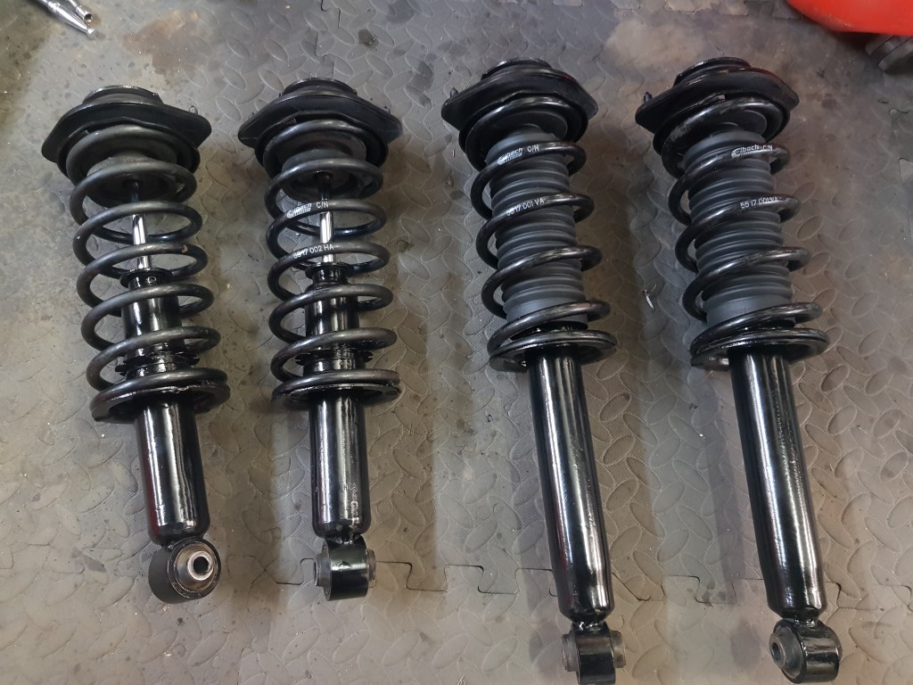

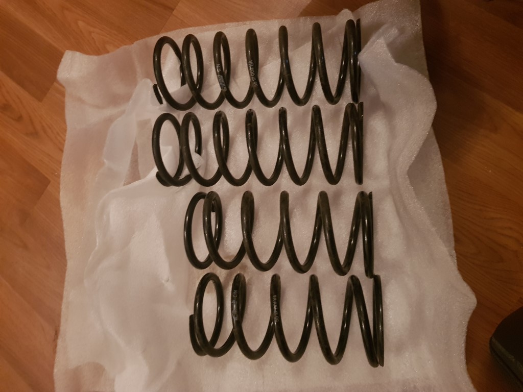

And of course i wasnt going to leave it standard height so i managed to win a set of Eibach lowering springs on ebay for £81 which i thought was a good deal...
20191204_160213 (Medium).jpg (146.6 KiB) Viewed 8621 times
these were then assembled on the refurbed shocks and top mounts...
20191216_102431 (Medium).jpg (214.42 KiB) Viewed 8621 times

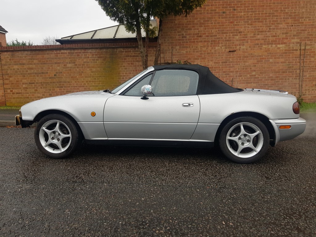

and then fitted on the car ...
20191217_134745 (Medium).jpg (314.91 KiB) Viewed 8621 times

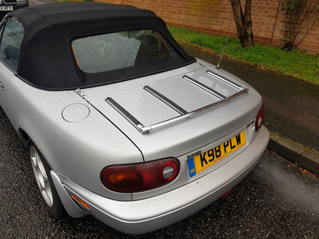

Its not massively low but a nice height and usable with speed humps etc
I have also refitted the original boot lid that came with the car, the previous owner had fitted a plain one which he preferred, but i think i prefer the original just because its a bit different and its what the car came with...

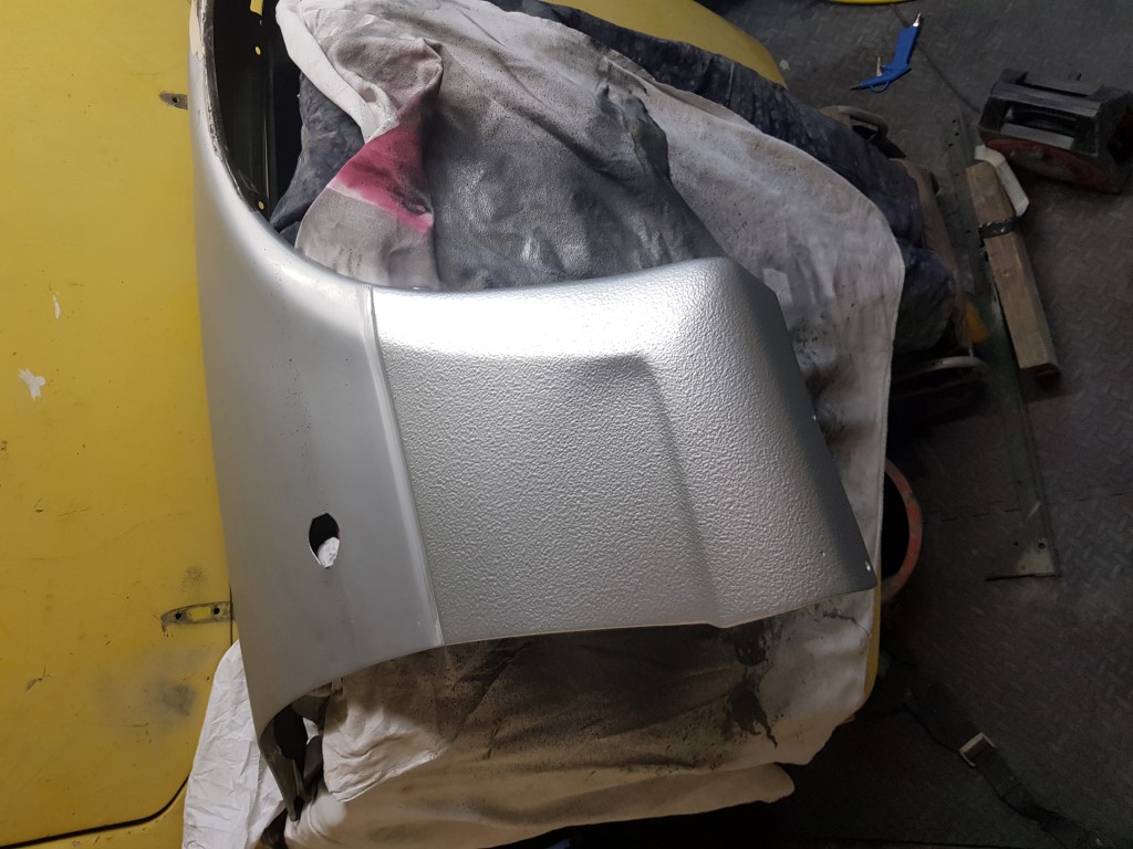

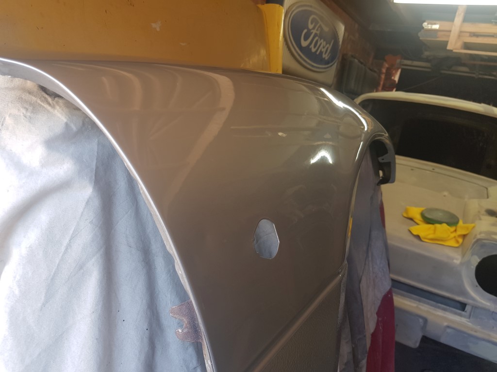

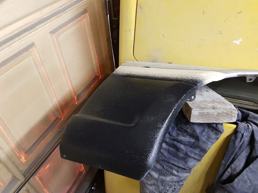

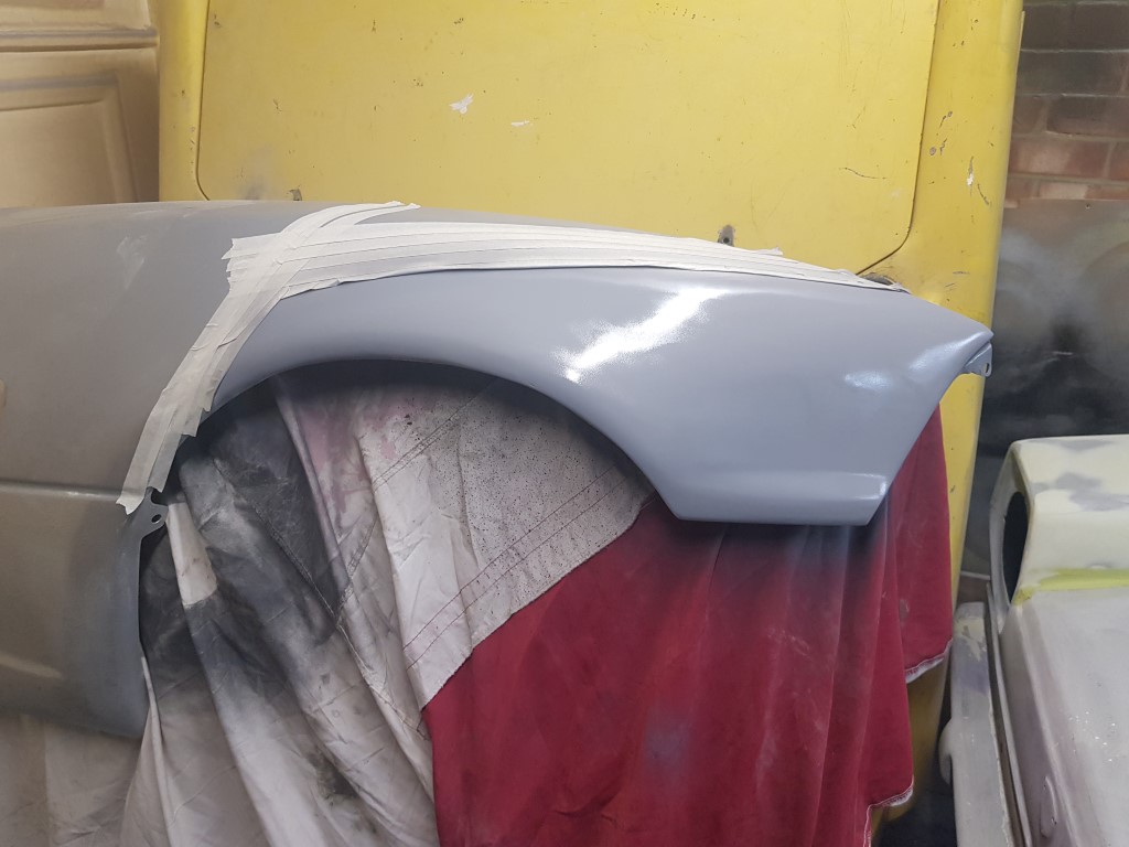

Here is the Stone chip on the wing repair i had done to match the lower side of the car which is stone chipped below the swage line from factory...
20200423_170708 (Medium).jpg (189.39 KiB) Viewed 7986 times
I then base coated this in silver...
20200426_134955 (Medium).jpg (199.89 KiB) Viewed 7986 times

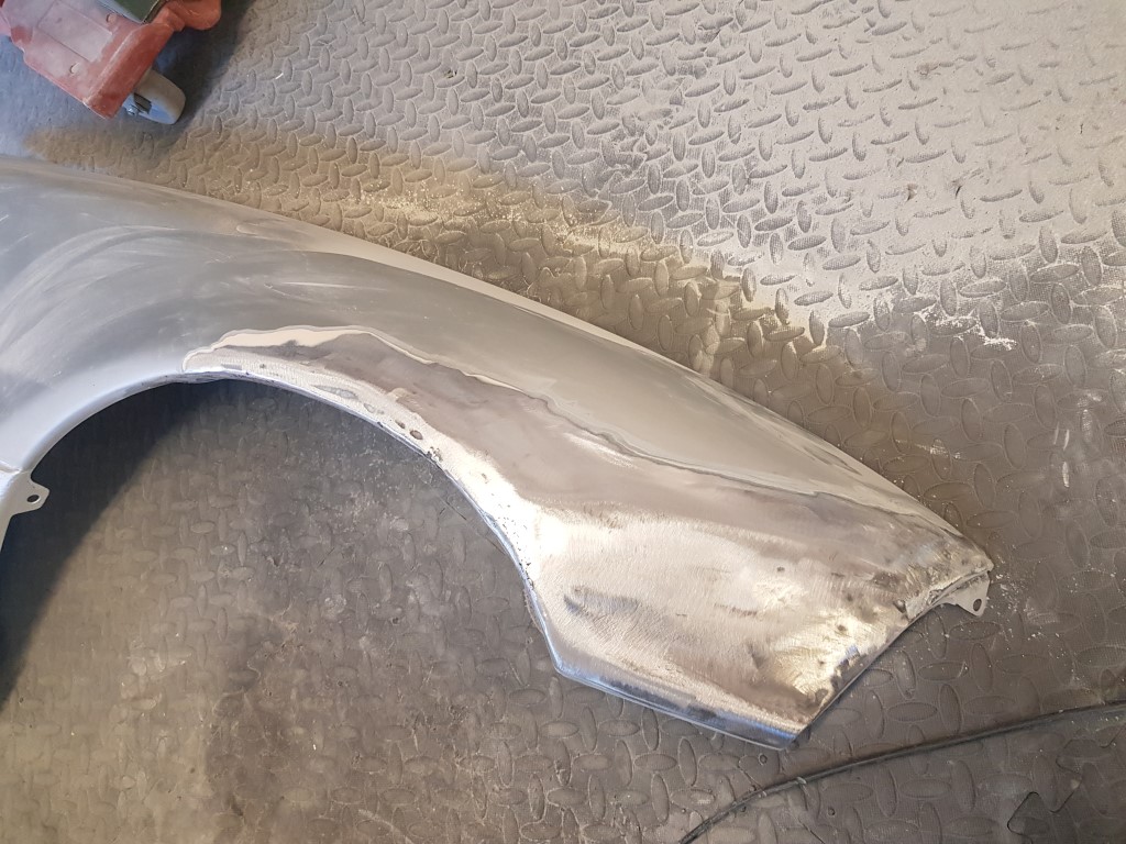

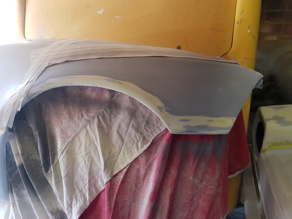

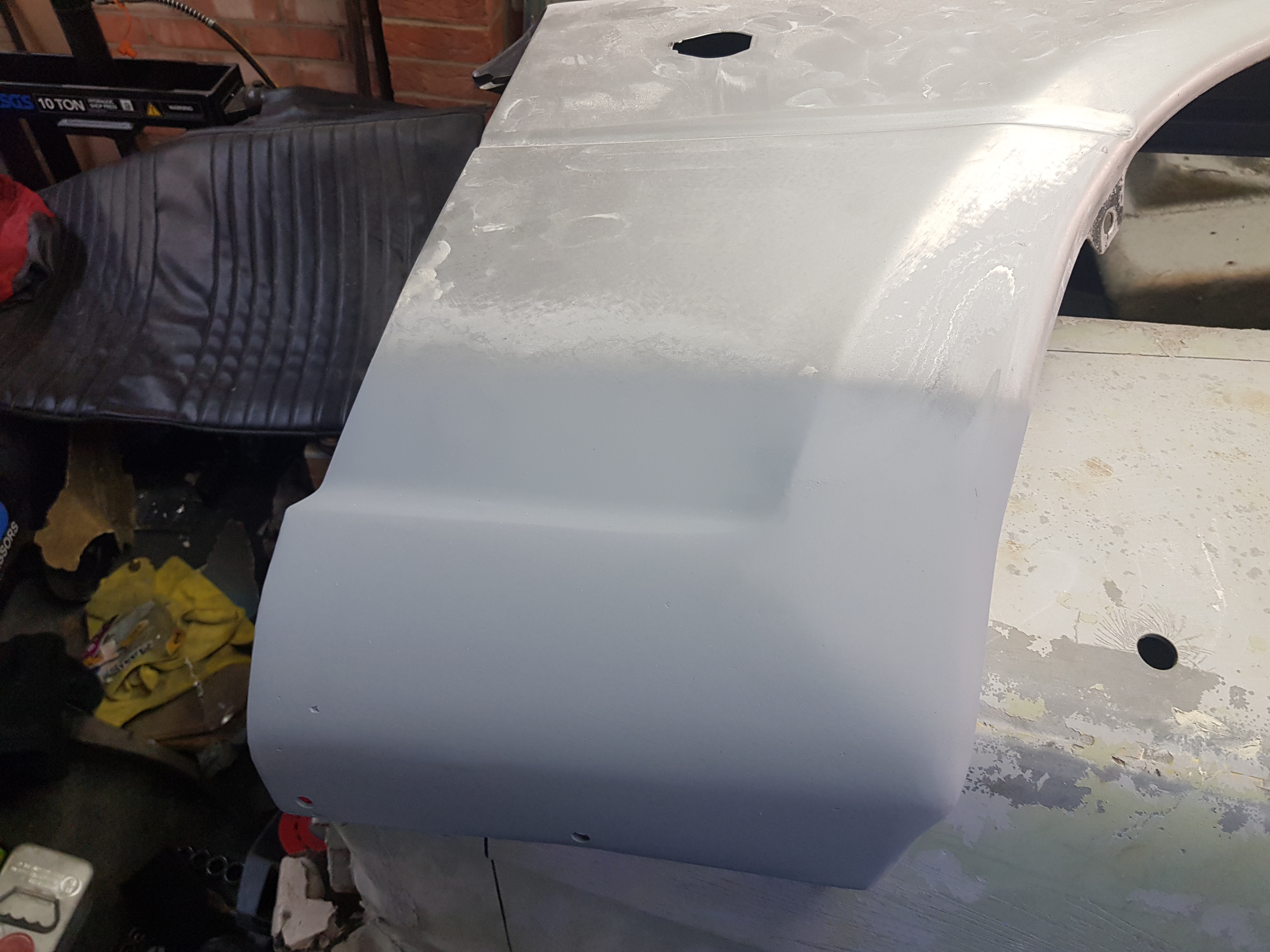

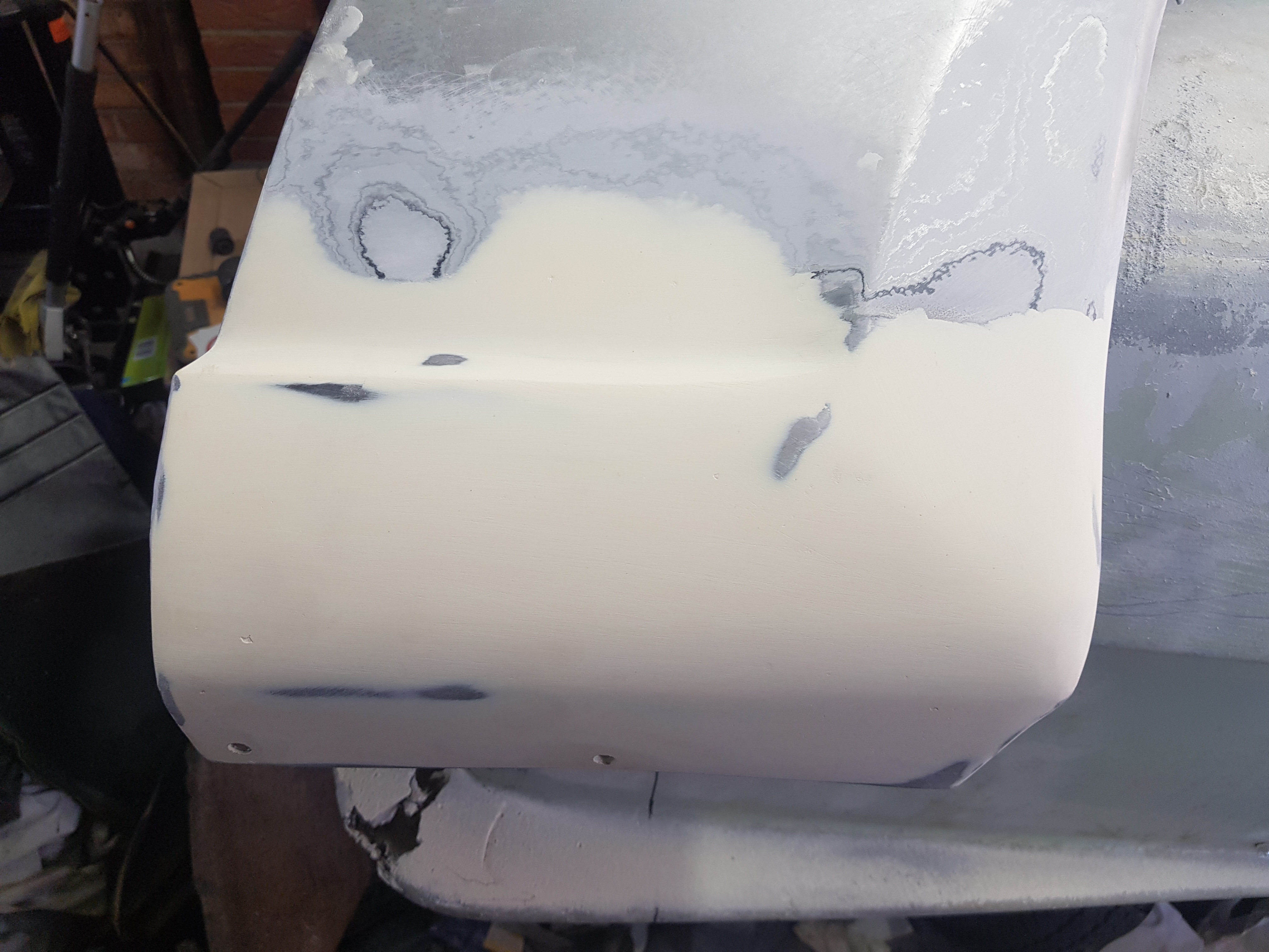

I then went onto the other end of the wing and stripped it back to metal to make sure my new filler wouldn't react with the old stuff and also to minimize the thickness of the filler, once it was sanded it was only a very thin skim
20200523_170241 (Medium).jpg (251.06 KiB) Viewed 7986 times

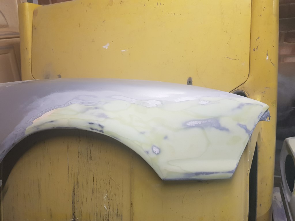

I went through a few stages of filler to get the shape right and ended up with this ...
20200527_002121 (Medium).jpg (122.67 KiB) Viewed 7986 times
I then primed it ...
20200527_002900 (Medium).jpg (149.08 KiB) Viewed 7986 times
I wasn't quite happy with it so had to do a bit more...
20200527_141751 (Medium).jpg (184.18 KiB) Viewed 7986 times
Then re-primed it and once this was dry i wet flatted it with 1000 grit paper...
20200527_201359 (Medium).jpg (165.82 KiB) Viewed 7986 times

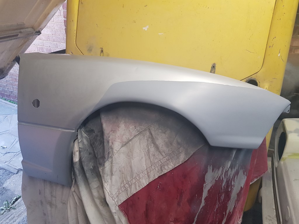

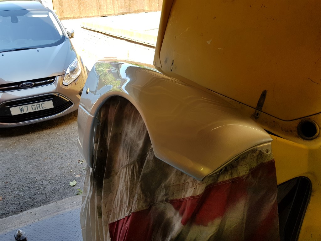

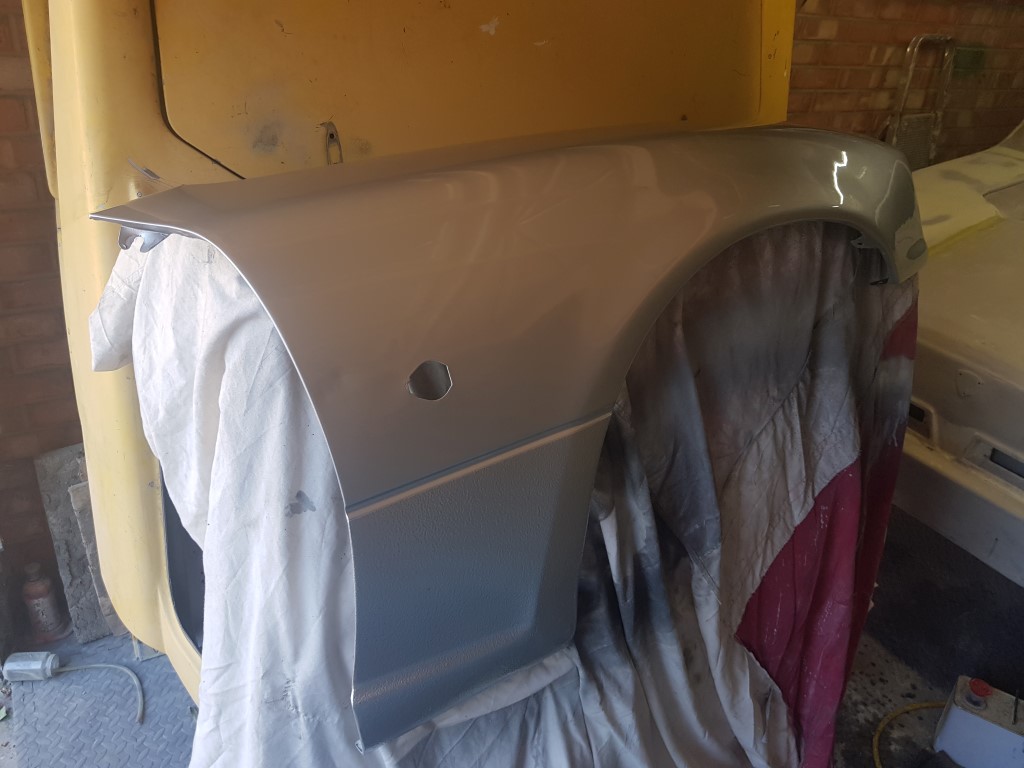

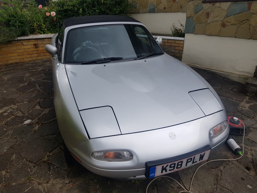

I then painted the complete wing in silver base coat and used 2K lacquer in a can which you have to activate to release the hardener into it, this is basically the same sort of product a body shop would use and because it has a hardener it can be wet flatted once dry and polished to get rid of any dirt in the paint, this is what i ended up with ...
20200531_115434 (Medium).jpg (148.21 KiB) Viewed 7986 times
20200531_115441 (Medium).jpg (141.85 KiB) Viewed 7986 times
20200531_115451 (Medium).jpg (180.35 KiB) Viewed 7986 times
I'm very pleased with the finish i got, I know that silver should really be blended on the car as it never matches but i didn't have a lot of choice as the car still isn't at my house so i took a gamble

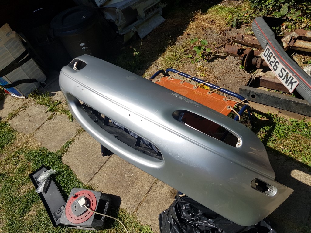

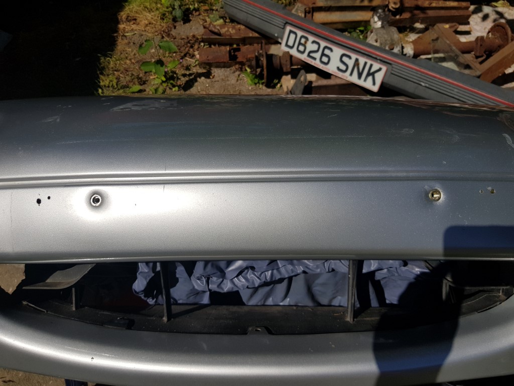

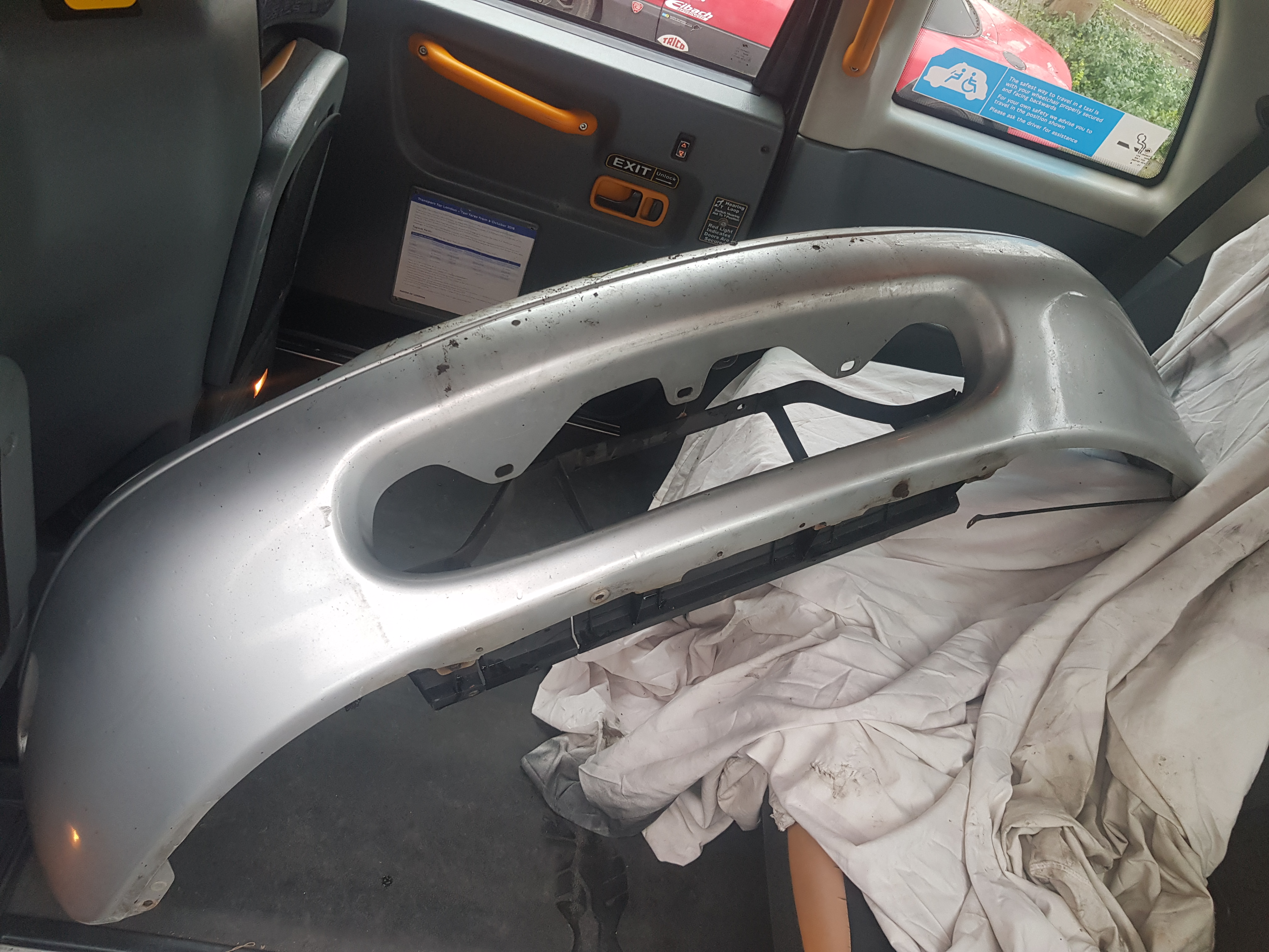

Ive also machine polished the 2nd hand bumper i bought...
20200528_145942 (Medium).jpg (340.31 KiB) Viewed 7986 times

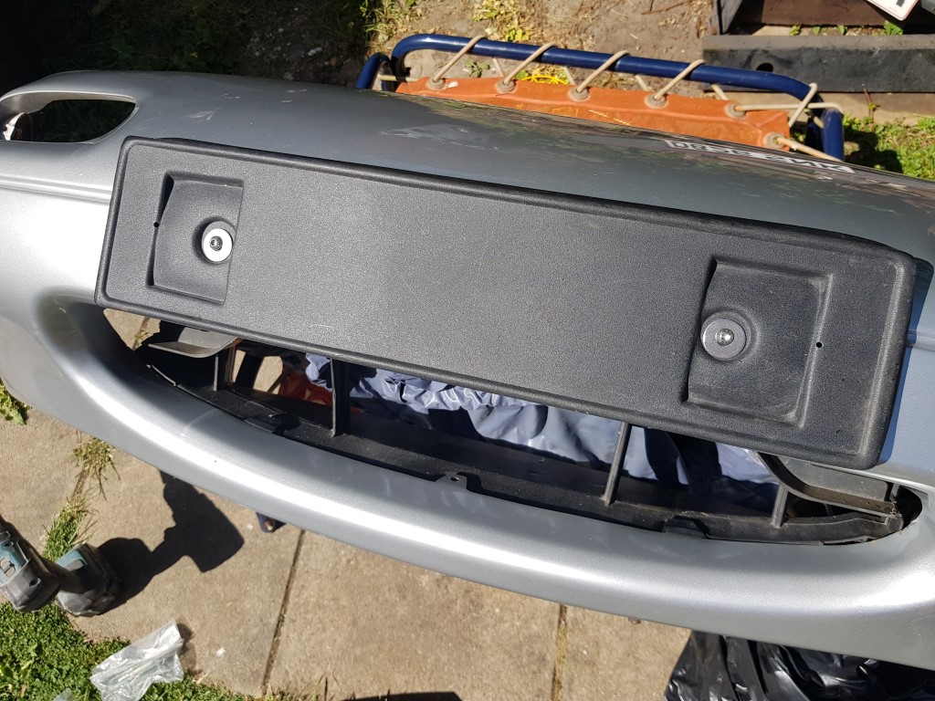

I chose not to paint it as I need to get the car on the road, so although its not perfect its presentable enough for now, I've also added rivnuts to mount the No plate plynth onto ...
20200528_151133 (Medium).jpg (176.49 KiB) Viewed 7986 times
20200528_151633 (Medium).jpg (294.38 KiB) Viewed 7986 times

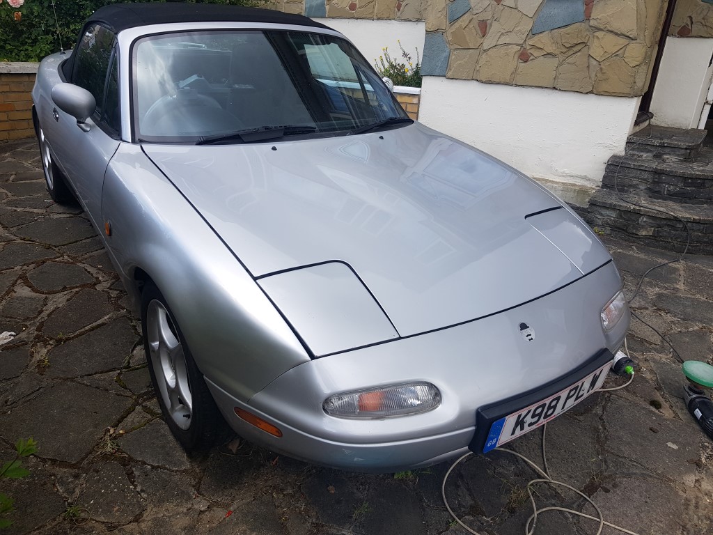

I also added new genuine bumper to wing brackets to bolt it on and packed it all in the cab to go to my Grandads house to fit them ...
20200605_110717 (Medium).jpg (229.33 KiB) Viewed 7986 times

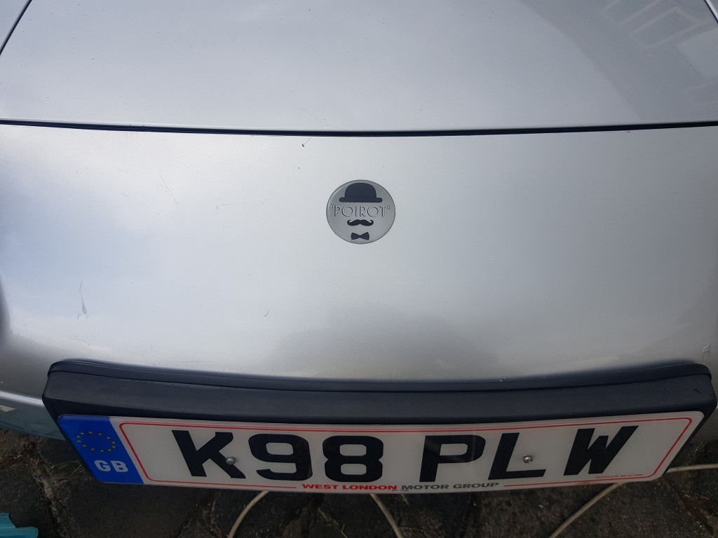

The colour match is by no means perfect but its ok for now, it actually looks better in real life, you can also see in the above picture the outline of the badge on the 2nd hand bumper where its been masked when painted in the past, this is a circular badge which is the Eunos import badge, my car is a UK car so I didn't want to put an import badge on, i was thinking of reinstating the mustache sticker that gave "Poirot" his name in the 1st place, then Gem came up with the idea of a custom made badge ;) ...
20200604_131117 (Medium).jpg (125.15 KiB) Viewed 7986 times
20200605_111048 (Medium).jpg (127.1 KiB) Viewed 7986 times
20200605_111111 (Medium).jpg (259.77 KiB) Viewed 7986 times
I'm well chuffed with the badge, it covers the circular mark on the bumper and allows Poirot to have his mustache just a bit more subtle ;)

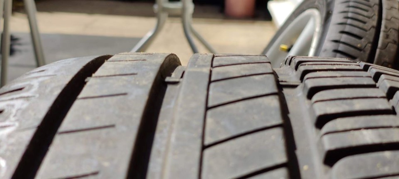

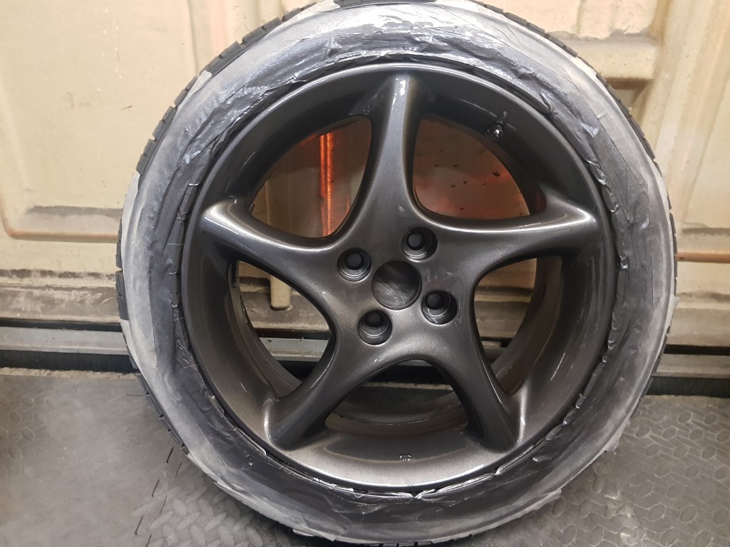

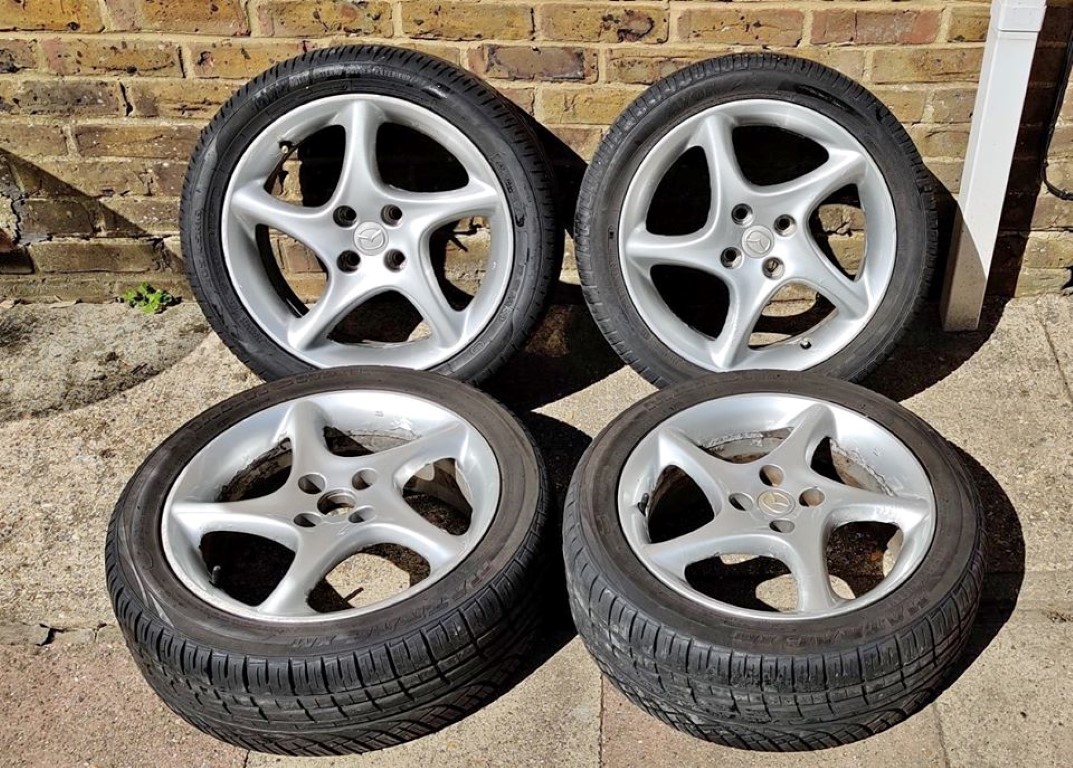

So onto the subject of the wheels, I have never been much of a fan of the style of wheels fitted to Poirot, they are from a Mk2 which is fine just not sure about them and also the tyres fitted although legal are all starting to crack so i thought this needed addressing, as this is a budget project i wanted to find a deal, which ended up being these...
new mx5 wheels (Medium).jpg (289.25 KiB) Viewed 7986 times
new tyres (Medium).jpg (113.43 KiB) Viewed 7986 times
These again are from a MK2 but the sport model, they are 16" so 1" bigger that whats on the car and 2" bigger than standard, as you can see from the pictures they are scabby but the tyres are like new and i got the lot for £80 ! I'm well happy with them but I think a little refurb is in order ;) ...

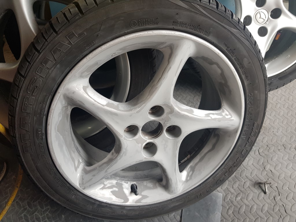

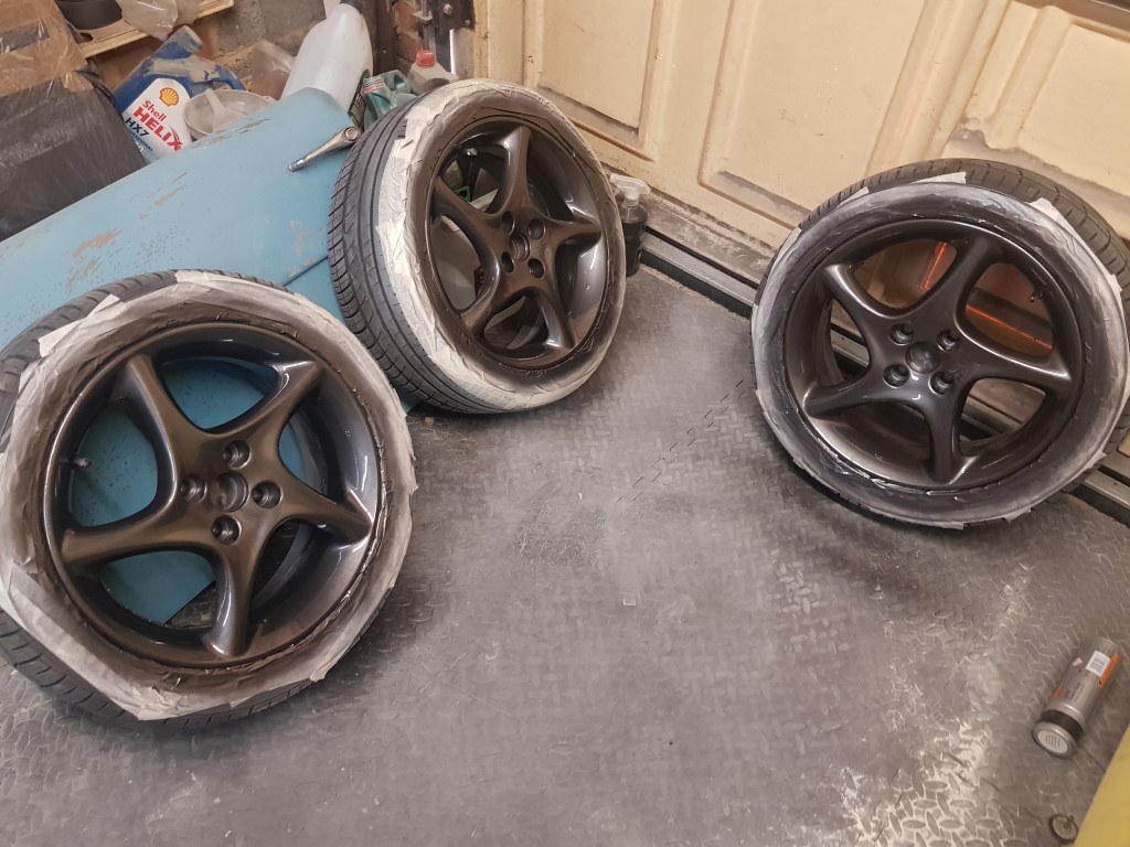

Firstly I Sanded them back ...
20200603_175828 (Medium).jpg (231.58 KiB) Viewed 7986 times

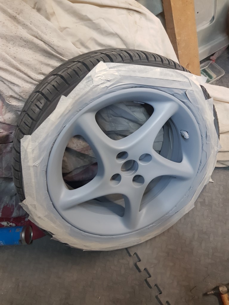

then primed...
20200604_101232 (Medium).jpg (169.81 KiB) Viewed 7986 times
Then Painted and 2k lacquered ...
20200606_100325 (Medium).jpg (181.71 KiB) Viewed 7986 times
20200606_100312 (Medium).jpg (203.75 KiB) Viewed 7986 times

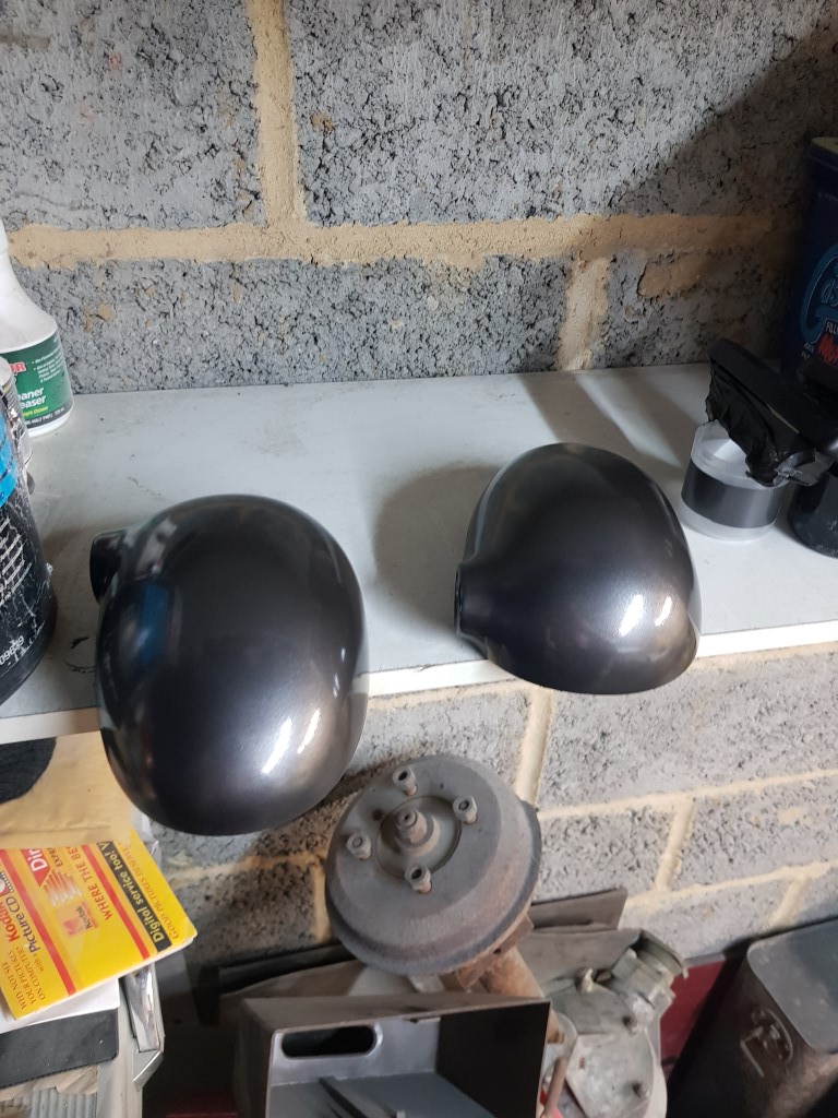

I'm well please with the result, you may remember that the door mirrors needed repainting after taking off the stickers so i have done these in the same "Ford Graphite Grey" to match the wheels ...
20200605_201624 (Medium).jpg (236.22 KiB) Viewed 7986 times
