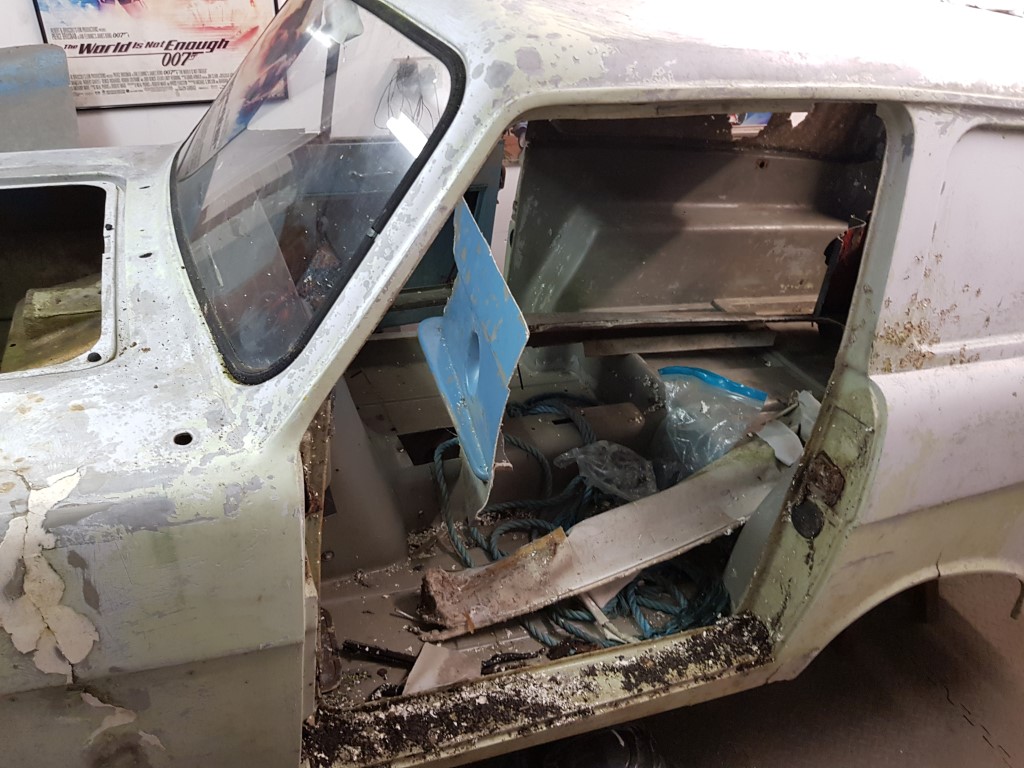

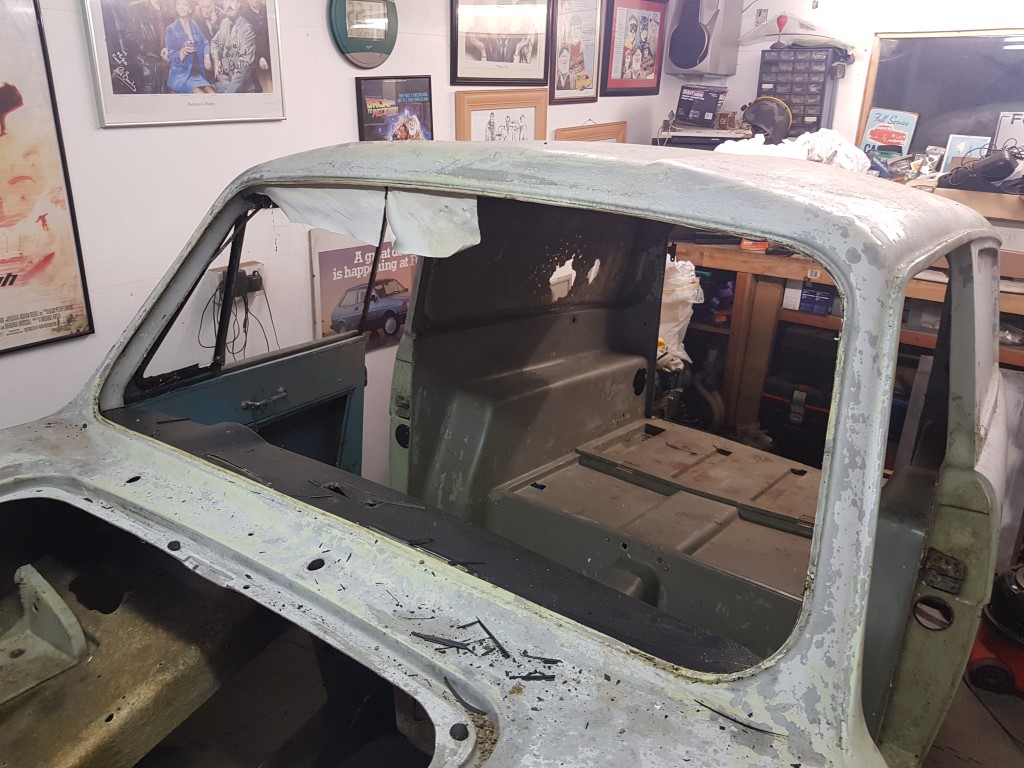

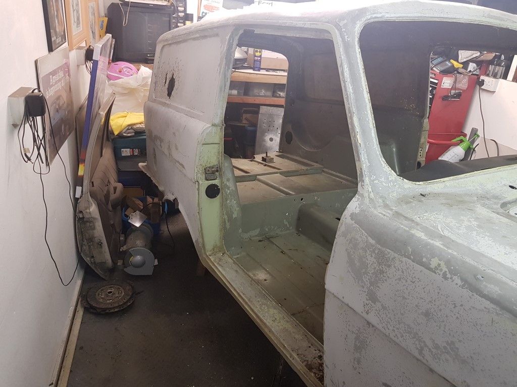

Little update on Project Plonker tonight, I have stripped the shell of what was left on it ...

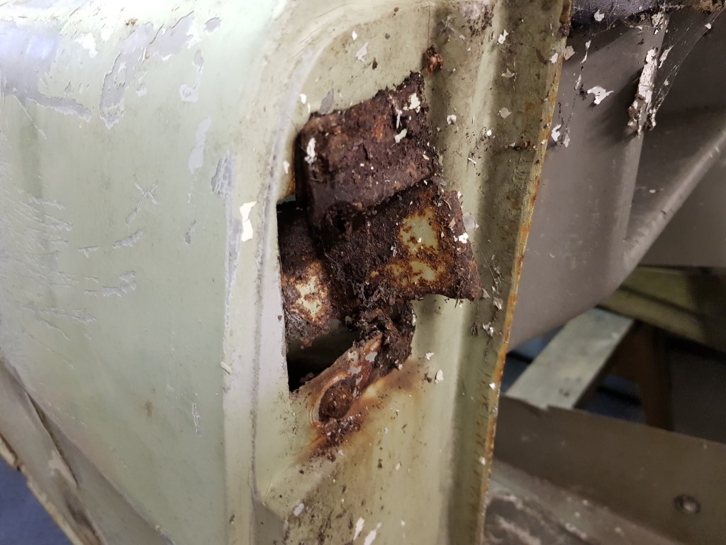

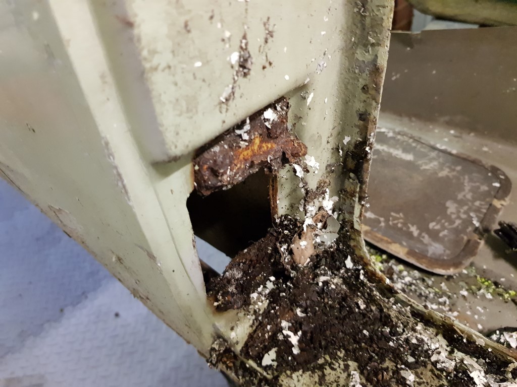

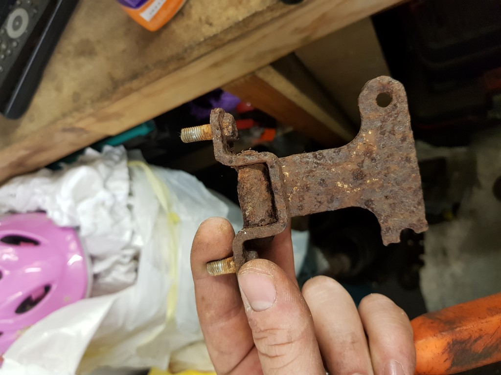

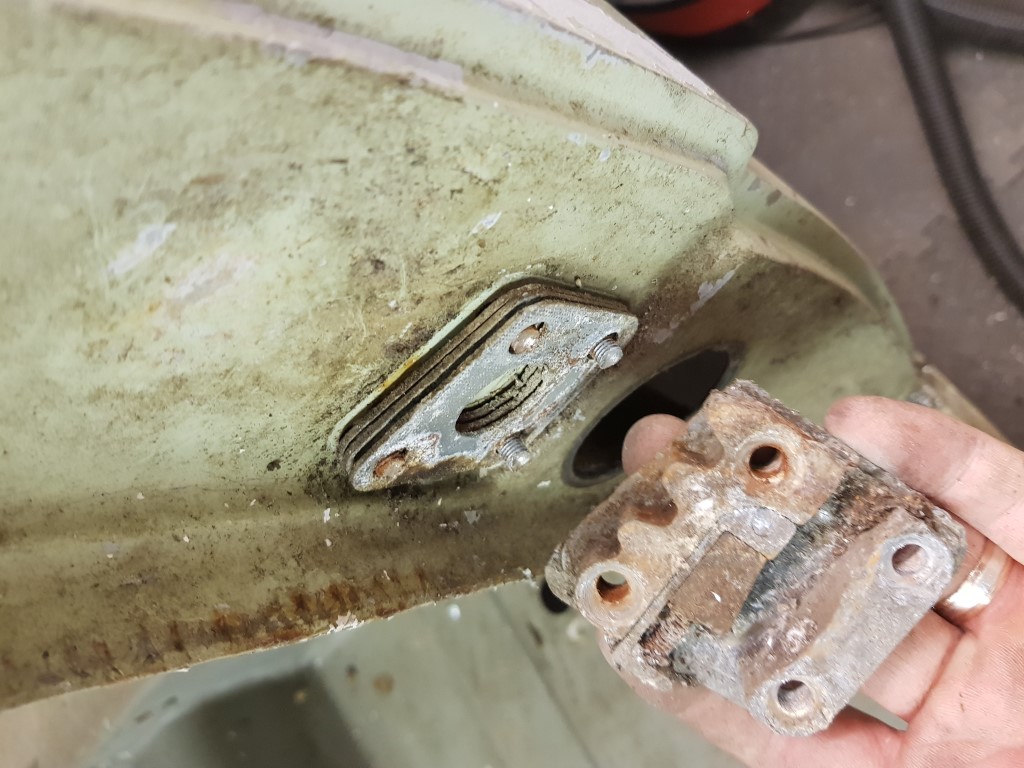

Passenger door hinges have completed rotted away..

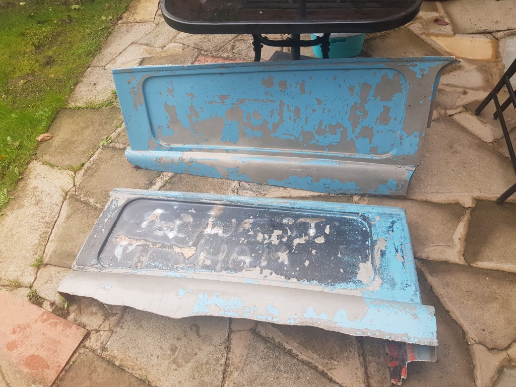

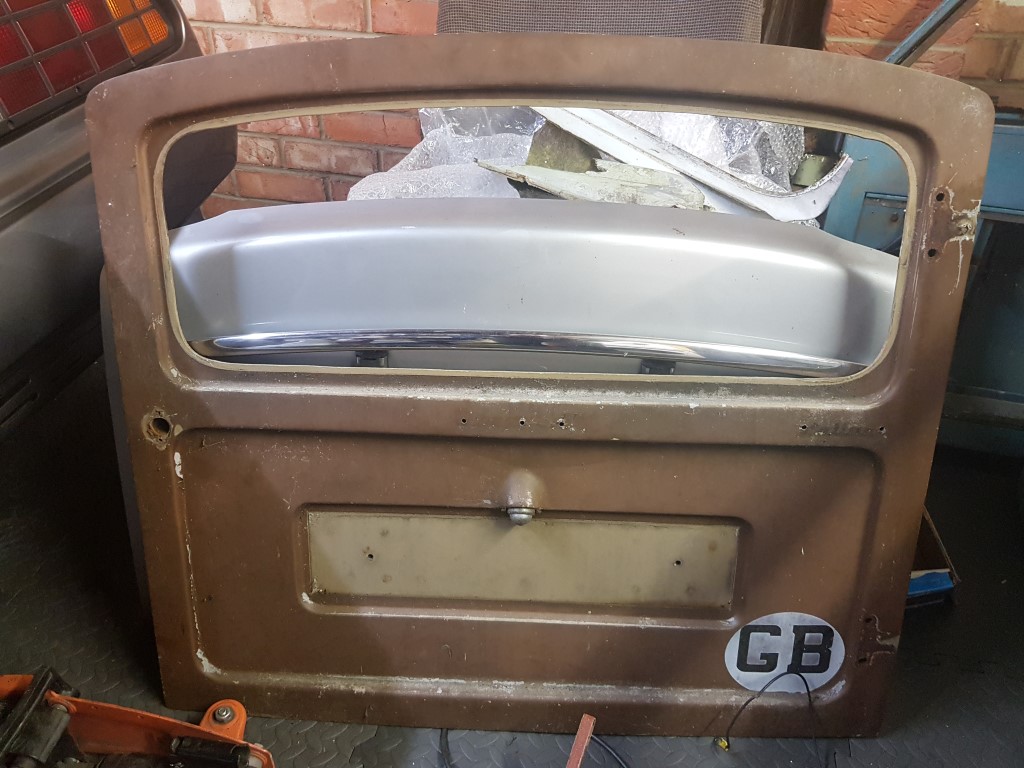

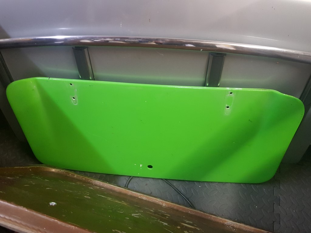

Also when i bought the van, it came with a number of repair sections, two of which are the rear side panels, I decided that I did not need these as mine are repairable so I used these to trade along with a bit of cash to get myself an original rear door and bonnet panel...
20191116_130611 (Medium).jpg (313.35 KiB) Viewed 9075 times
20191127_212019 (Medium).jpg (159.66 KiB) Viewed 9075 times
20191127_212033 (Medium).jpg (99.41 KiB) Viewed 9075 times

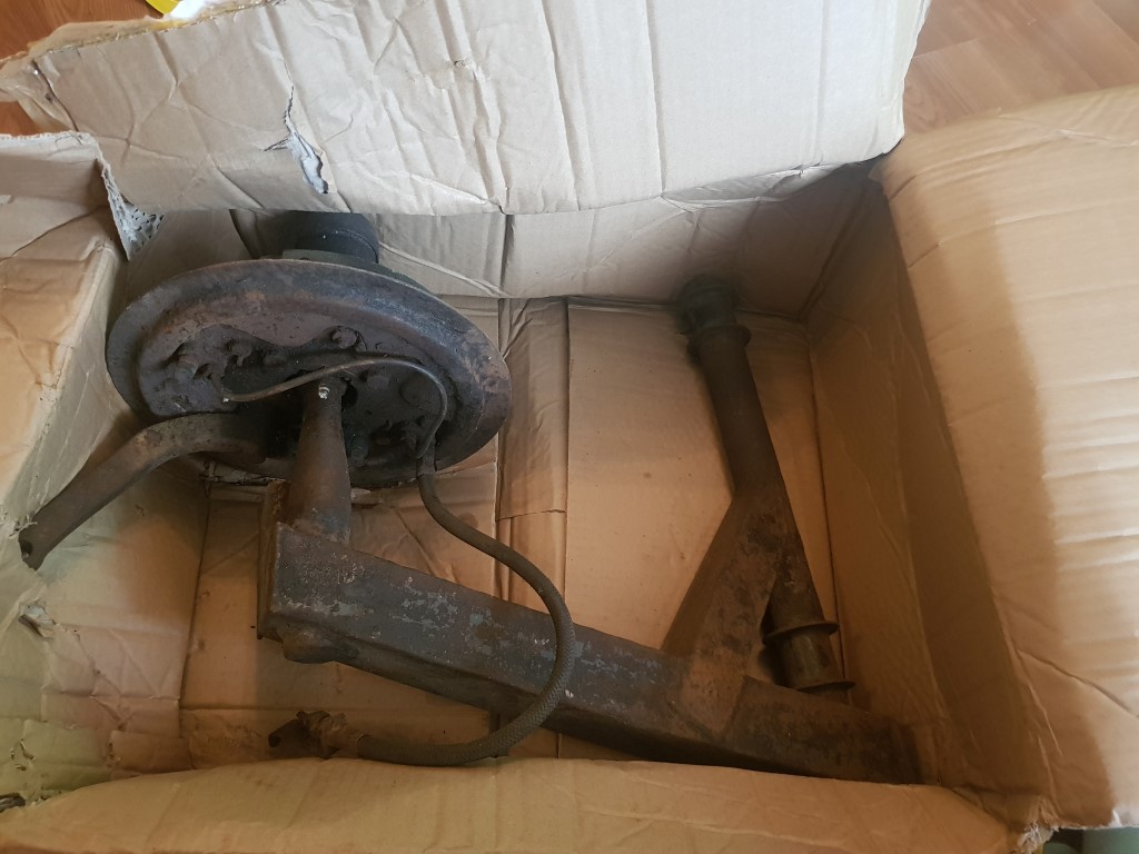

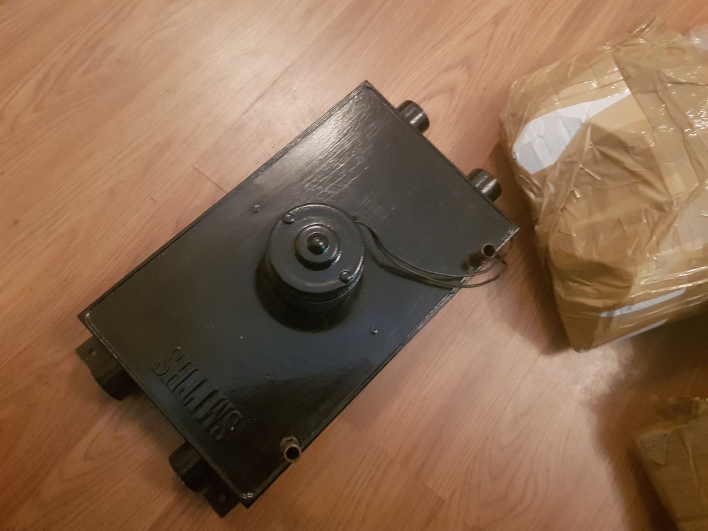

I also took delivery of a new A frame and heater unit today ...
20191127_150120 (Medium).jpg (146.24 KiB) Viewed 9075 times
20191127_150123 (Medium).jpg (127.58 KiB) Viewed 9075 times

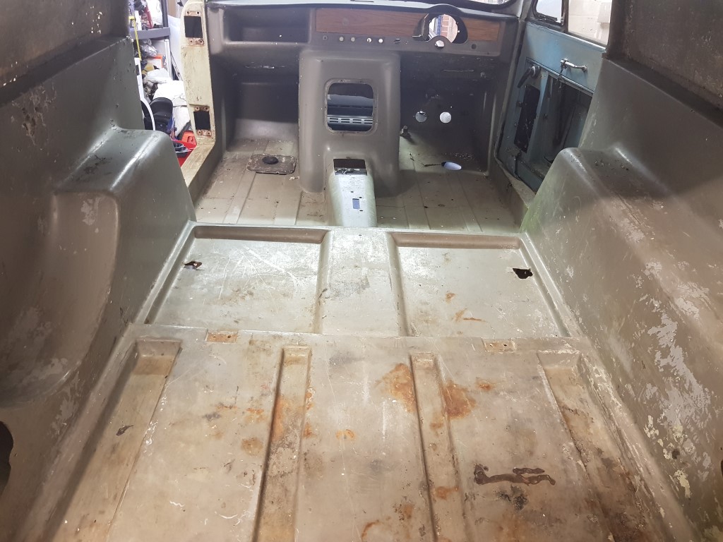

Finally I gave the inside a hoover lol..
20191116_210506 (Medium).jpg (182.29 KiB) Viewed 9075 times

Wow those hinges :o
Re: Project "Plonker"
Postby cis6409 » Mon Dec 02, 2019 3:48 pm
bandit wrote:Wow those hinges :o
Was thinking the same! ...
Erased from existence!

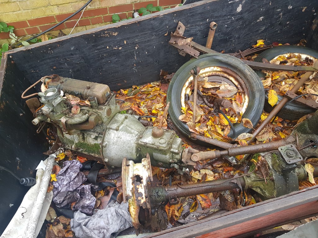

Hope you all had a great xmas and new year, bit more of an update for you all, i started off bt going through all the parts i got with the van...
20191128_105336 (Medium).jpg (401.58 KiB) Viewed 8820 times

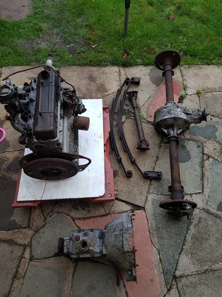

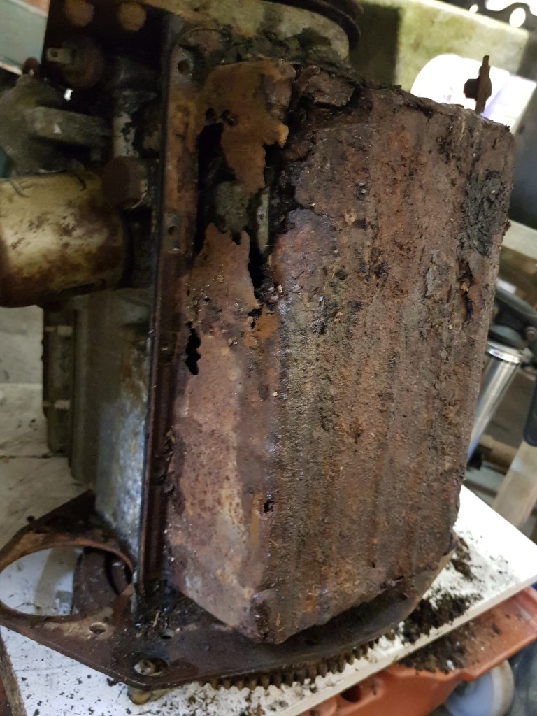

Since these have been in my trailer they have gathered some leaves, i was too hopful about most of this as its all been outside for years, the engine i knew when i got it was seized so at this point i didnt know if it was savable or not, so i went through the various parts that were there and this is what i was left with ...
20191129_153218 (Medium).jpg (388.98 KiB) Viewed 8820 times

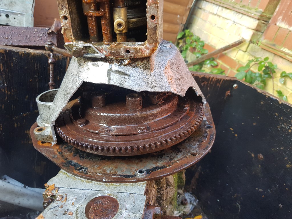

the engine had a gearbox on it but it was so rusted on i had to destroy it getting it off..
20191129_130916 (Medium).jpg (285.85 KiB) Viewed 8820 times
I ended up unbolting the clutch to get it apart

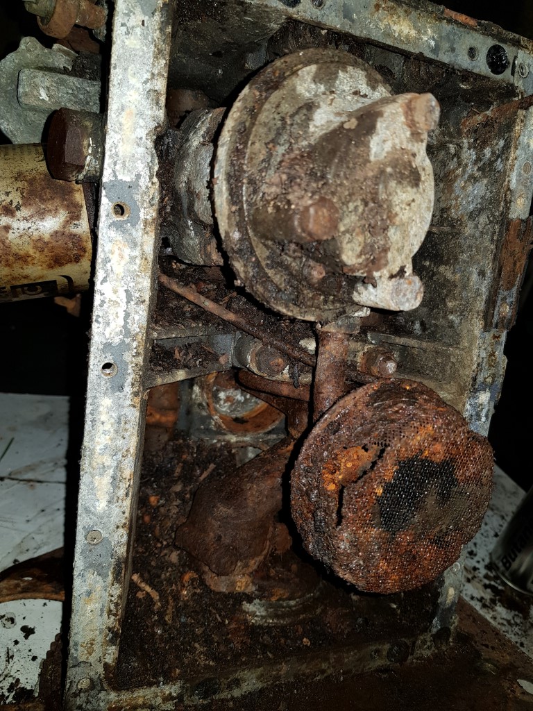

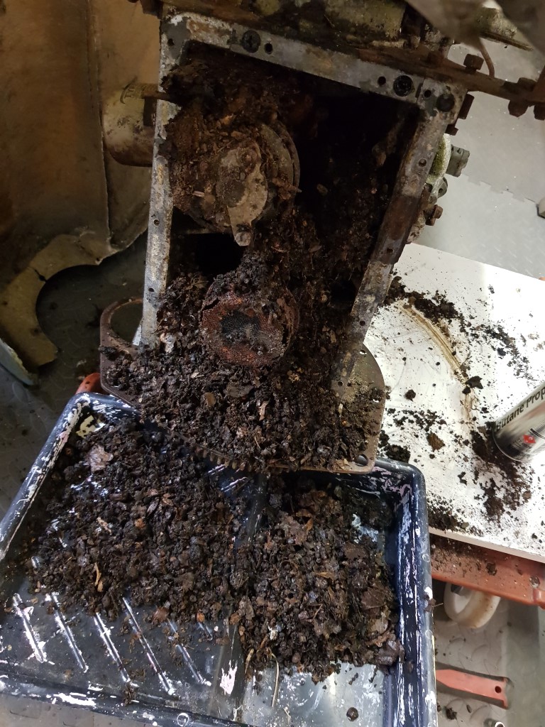

So i started on the engine ...
20191129_233842 (Medium).jpg (223.44 KiB) Viewed 8820 times
not looking good
20191129_234031 (Medium).jpg (302.35 KiB) Viewed 8820 times
shagged i think is the term...
20191129_234523 (Medium).jpg (385.5 KiB) Viewed 8820 times

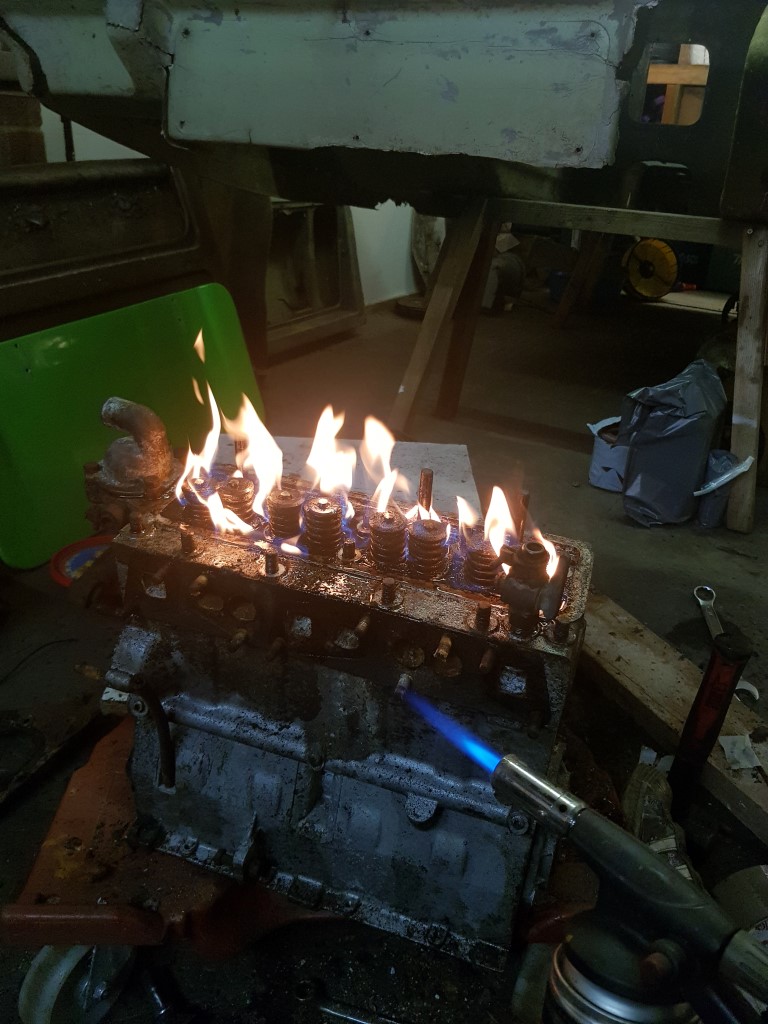

In the hope it could still be saved i tried to get the head off, I tried everything to get it off, no luck, i even set alight to it ! ...
20191205_002607 (Medium).jpg (179.27 KiB) Viewed 8820 times

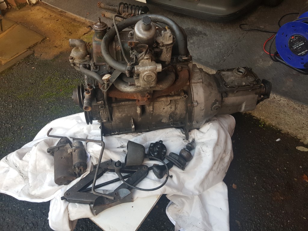

So in the end after 3-4 goes trying to get it off i gave up and managed to source a good used 850cc engine and box, the same as Dan has for his...
20191221_124601 (Medium).jpg (264.94 KiB) Viewed 8820 times

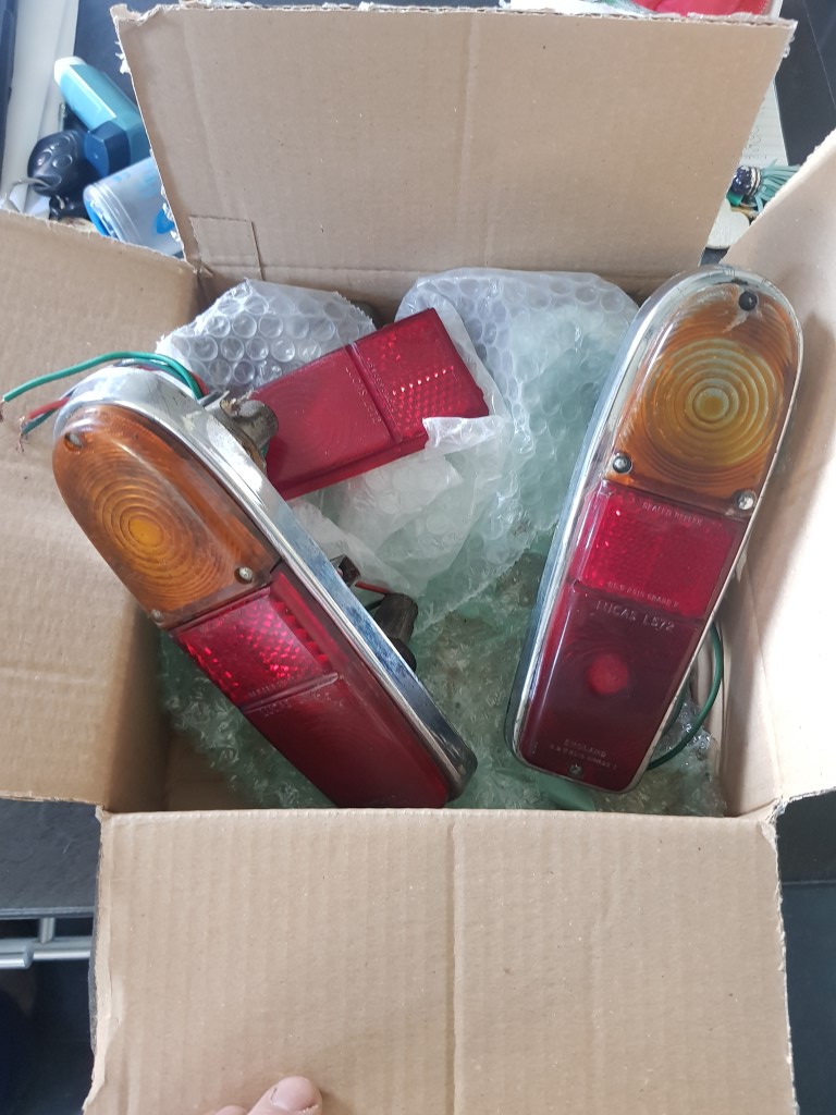

Ive also got some rear lights ...
20191223_110430 (Medium).jpg (186.75 KiB) Viewed 8820 times

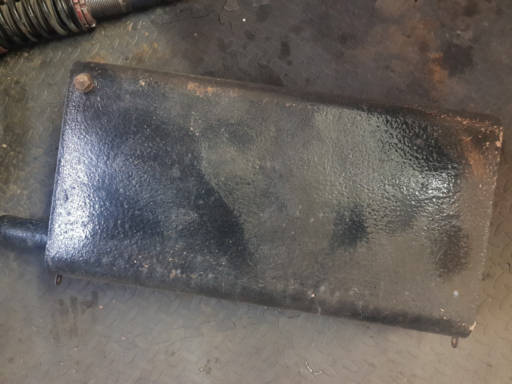

and an original fuel tank...
20200102_205334 (Medium).jpg (230.41 KiB) Viewed 8820 times

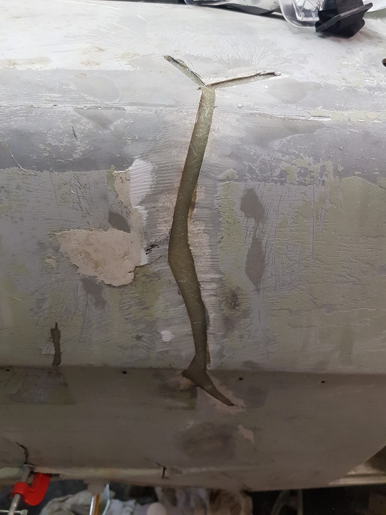

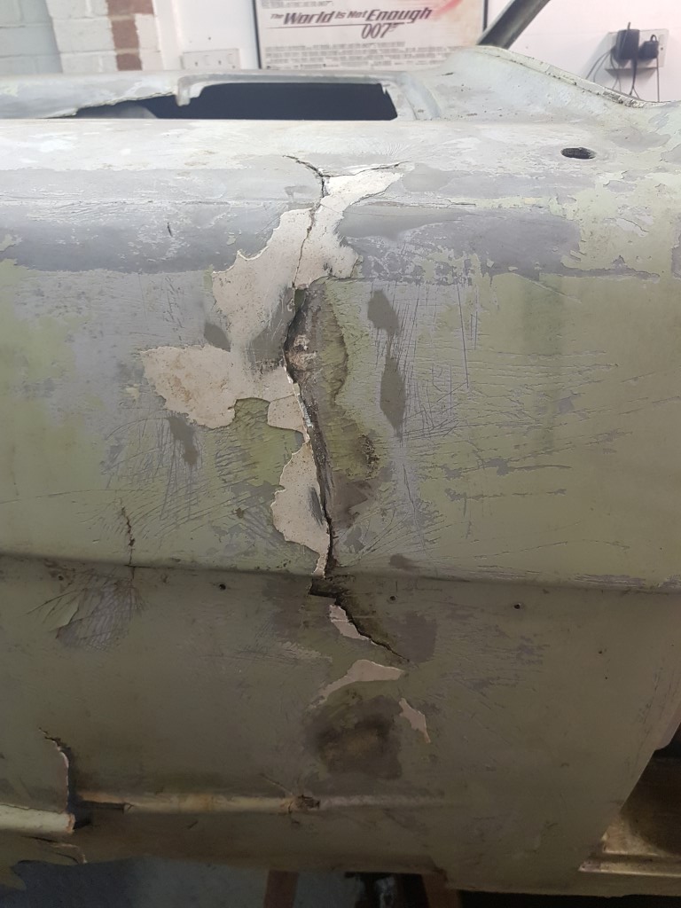

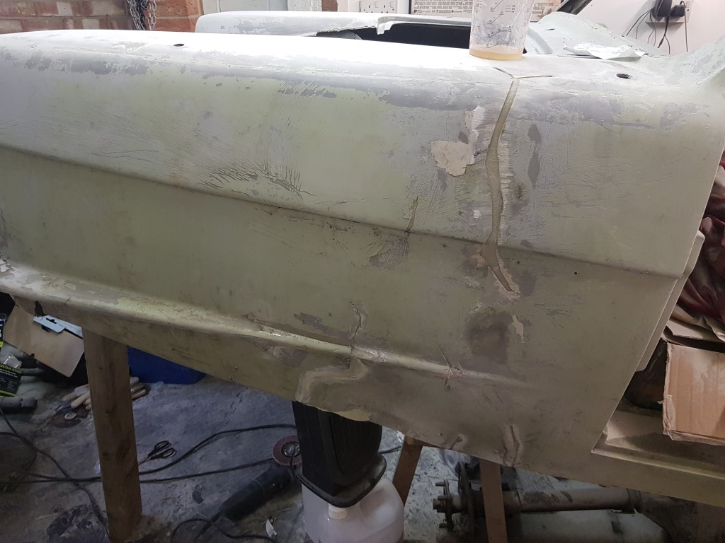

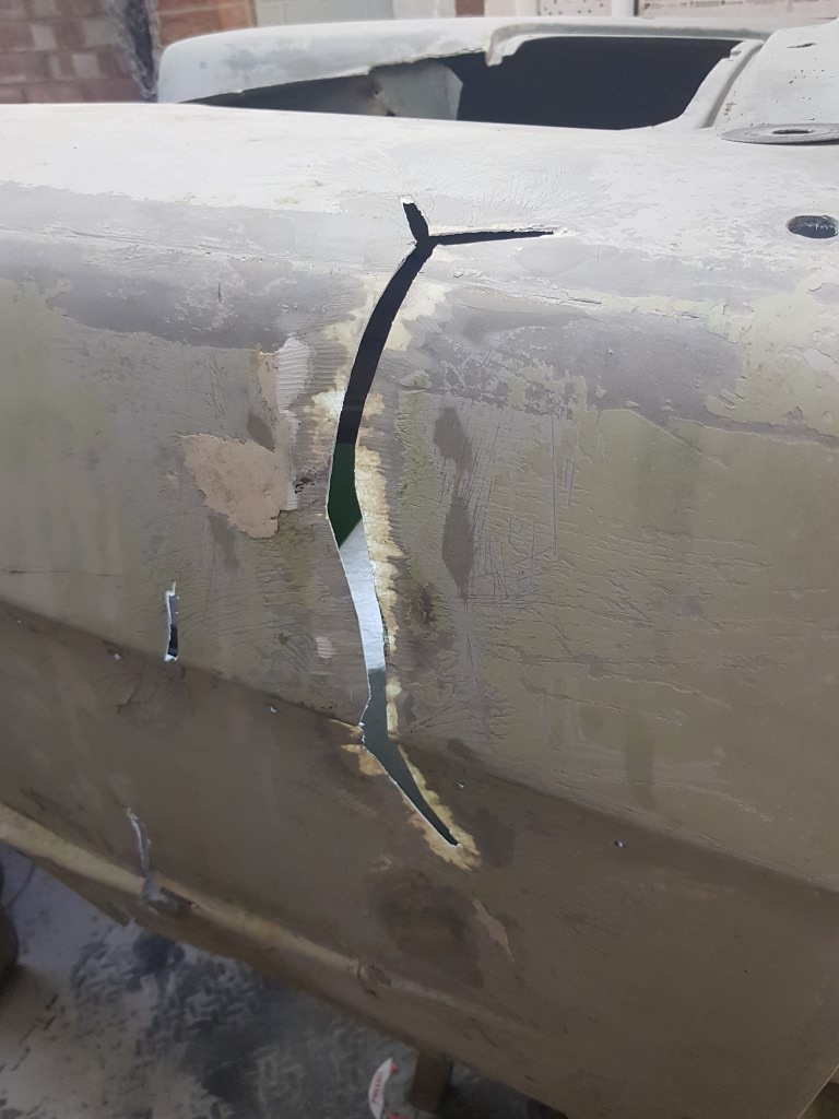

So last night i finally started on some fibreglass repairs, i started with the bit split on the passenger side front wing area...
before
20200102_205445 (Medium).jpg (193.04 KiB) Viewed 8820 times
I then opened up the crack to get some nice clean edges on the fibreglass
20200102_213529 (Medium).jpg (177.86 KiB) Viewed 8820 times

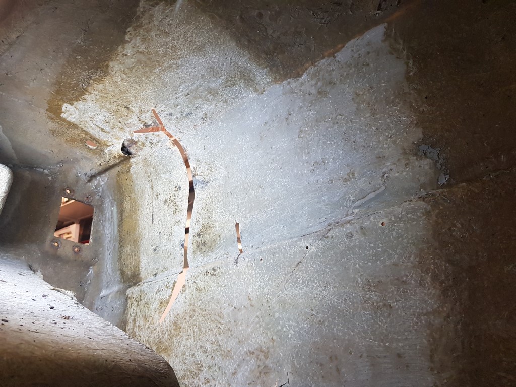

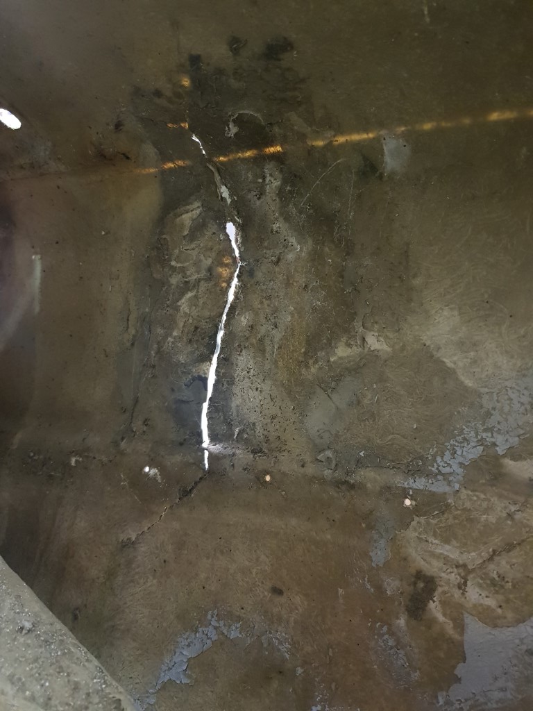

Then from inside i cleaned off all the rubbish filler and crap from a previous repair...
this was before ...
20200102_205459 (Medium).jpg (184.85 KiB) Viewed 8820 times
all prepped up ...
20200102_215335 (Medium).jpg (273.57 KiB) Viewed 8820 times

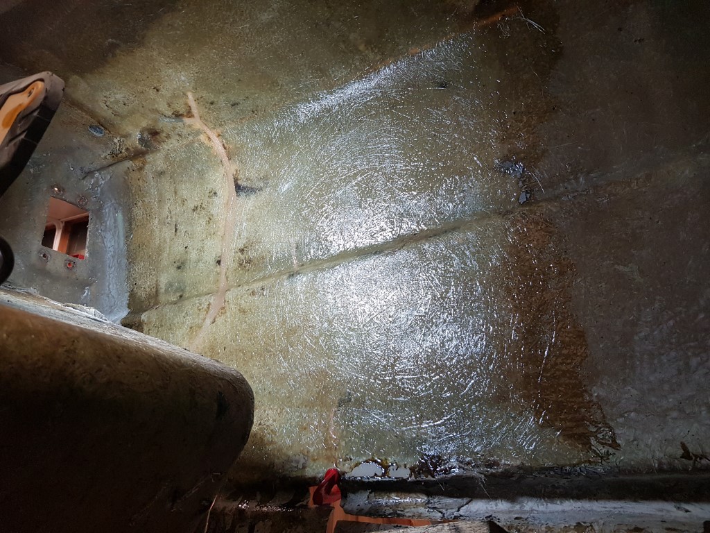

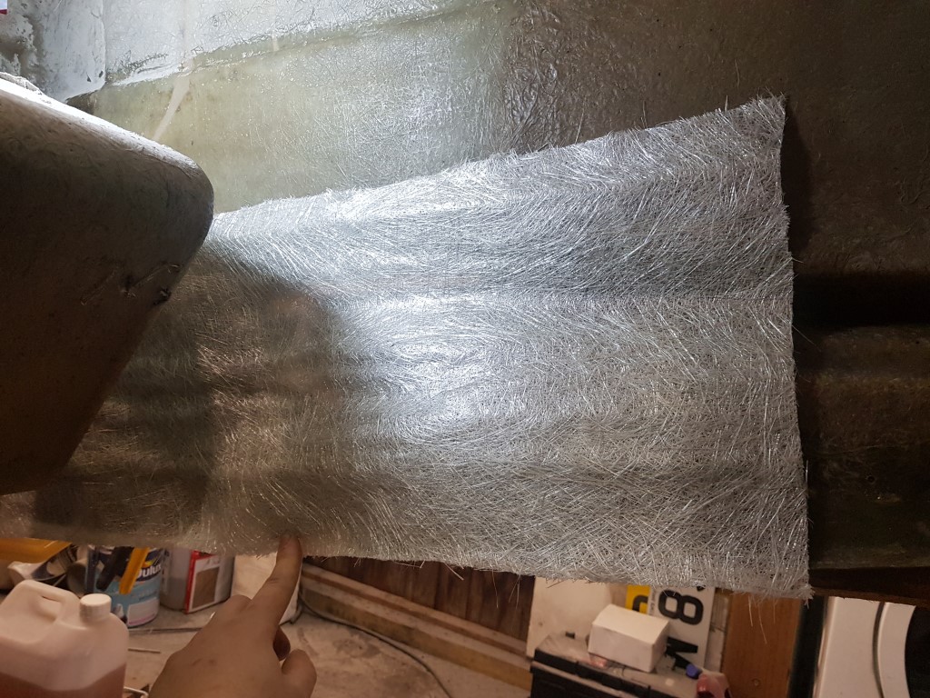

And finally with 2 layers of fibreglass ...
20200102_224921 (Medium).jpg (321.47 KiB) Viewed 8820 times

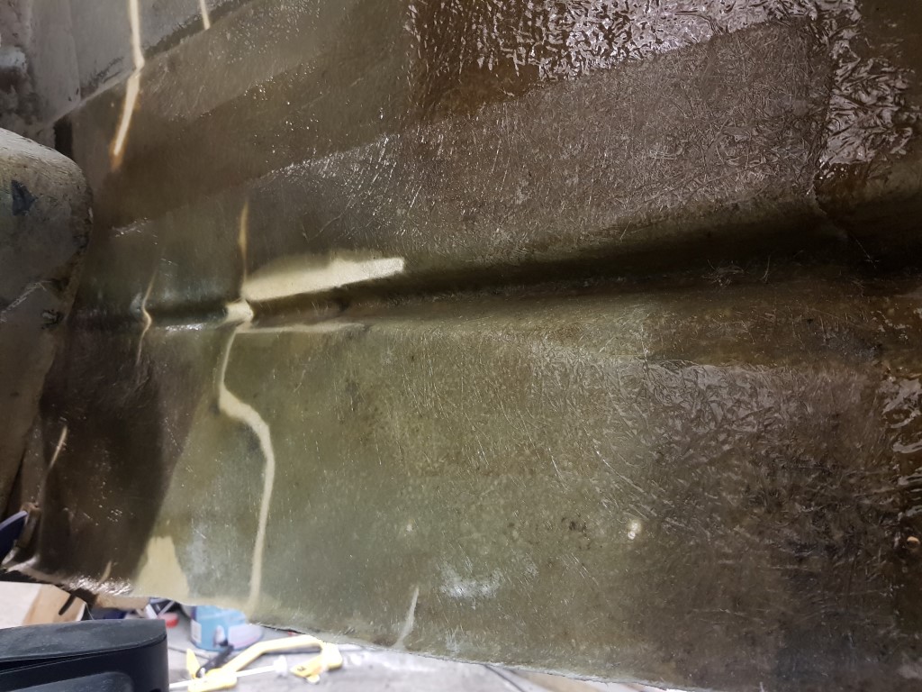

20200102_231546 (Medium).jpg (215.81 KiB) Viewed 8820 times

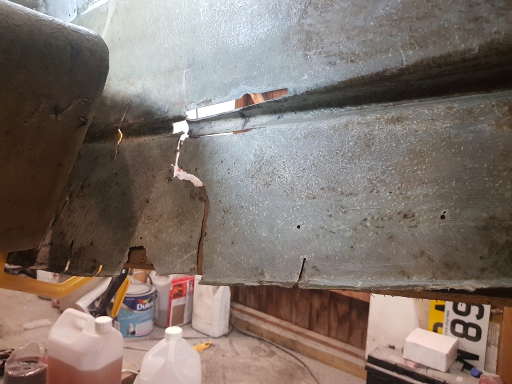

I then moved onto the lower half of this panel ...
20200103_153419 (Medium).jpg (200.64 KiB) Viewed 8820 times

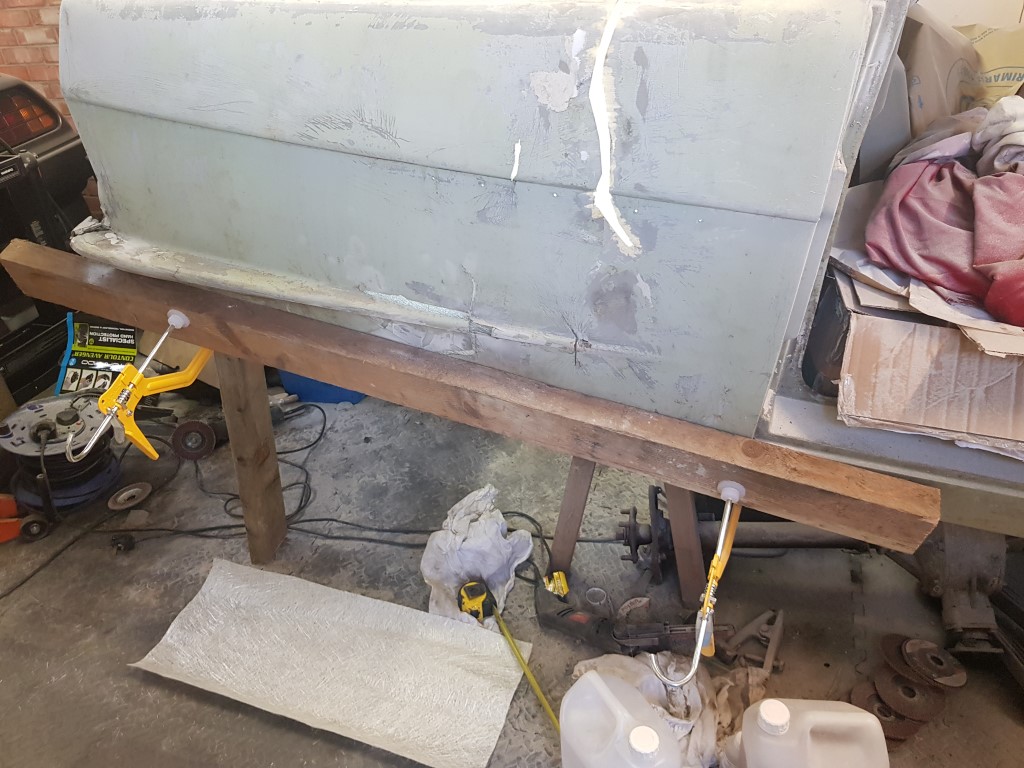

I clamped a length of wood on the outside to try and keep things straight..
20200103_153351 (Medium).jpg (228.5 KiB) Viewed 8820 times
Fibreglass cut to fit ...
20200103_153449 (Medium).jpg (301.43 KiB) Viewed 8820 times
With resin added...
20200103_164839 (Medium).jpg (220.6 KiB) Viewed 8820 times
Its now one piece again..
20200103_170058 (Medium).jpg (184.05 KiB) Viewed 8820 times
It doesnt look pretty at the moment but I'm going to do all the structural repairs from behind first then all the fibreglass filler repairs after.
I was very surprised how strong this is now :D
