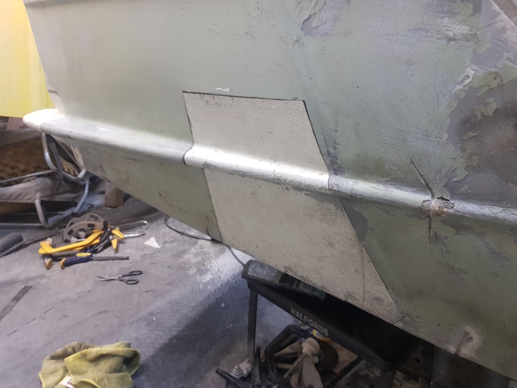

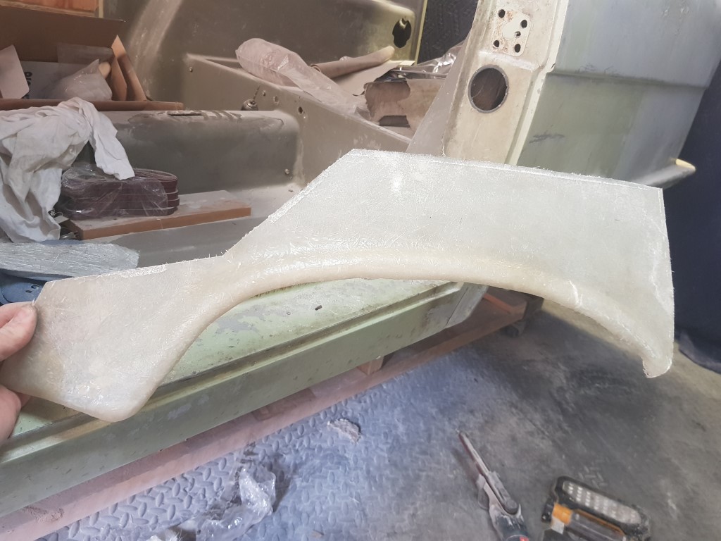

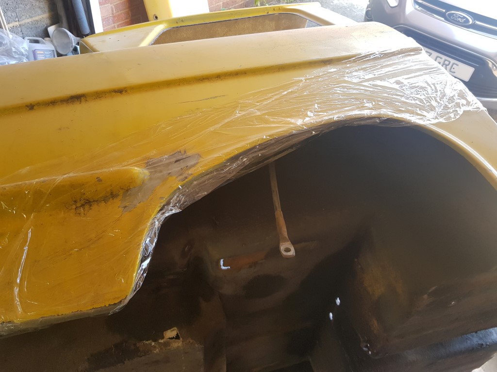

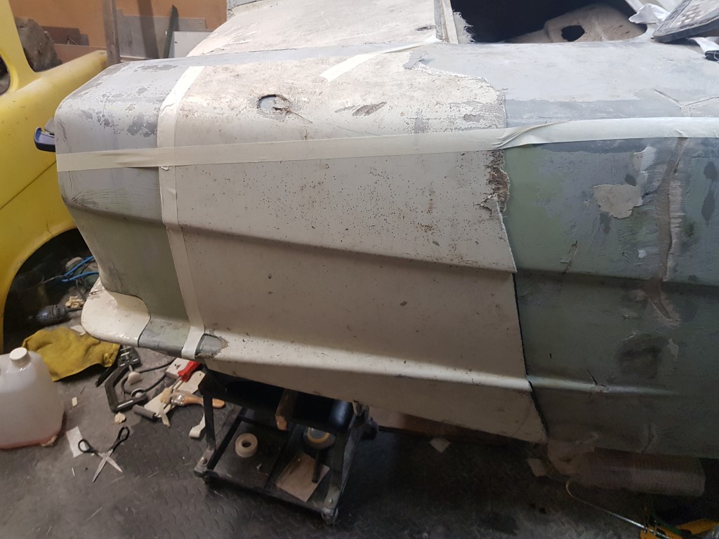

so next i wasn't really very happy with one of the 1st repairs I did on the passenger side lower wing area, as I have a section of wing off the white front end, i decided to redo this repair...
i started with this...
20200405_012001 (Medium).jpg (189.21 KiB) Viewed 8009 times
and ended up with this ...
20200417_145526 (Medium).jpg (141.04 KiB) Viewed 8009 times
this took an age as i had to do the fibreglass in sections to get it to fit correctly, im much happier with the repair now

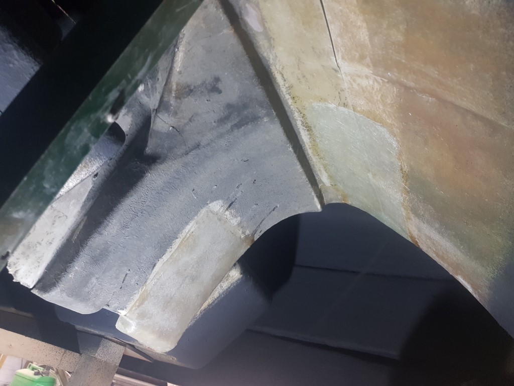

Next was the drivers side rear arch, i had one section of this to fit but the lower corner was totally missing, now i was going to cut the bits i needed off the saloon rear but i have potentially sold it as it is so didnt want to cut any more chunks out of it so i came up with this ...
20200407_142719 (Medium).jpg (221.25 KiB) Viewed 8009 times
20200407_142725 (Medium).jpg (181.76 KiB) Viewed 8009 times
20200407_143714 (Medium).jpg (211.93 KiB) Viewed 8009 times
20200407_161949 (Medium).jpg (165.45 KiB) Viewed 8009 times
20200423_094428 (Medium).jpg (109.87 KiB) Viewed 8009 times
20200423_094436 (Medium).jpg (107.1 KiB) Viewed 8009 times
This centre repair i actually used a lower corner bit of the arch I had, its not quite the right shape but has given a good basis to fill and shape on

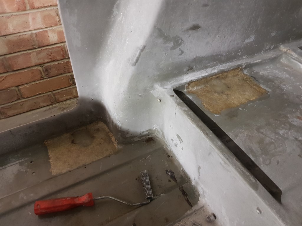

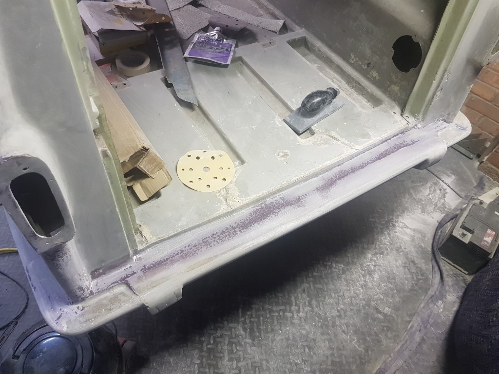

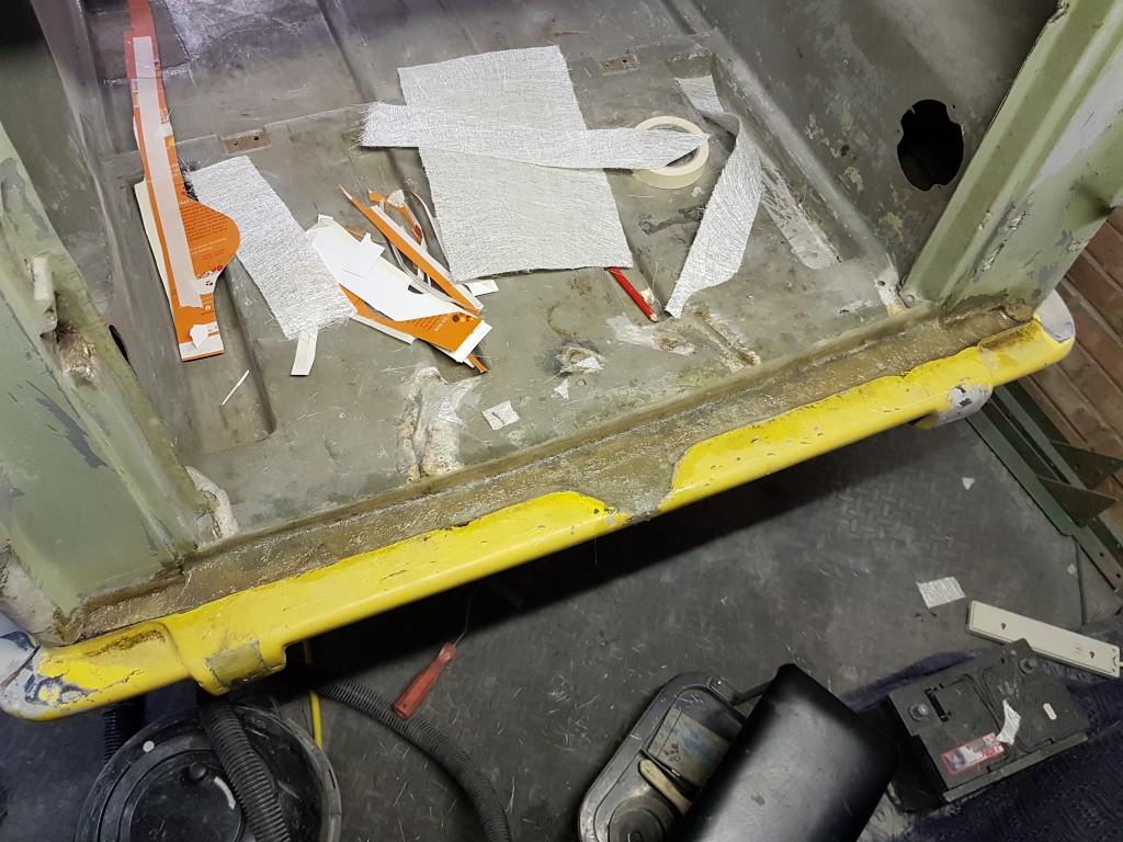

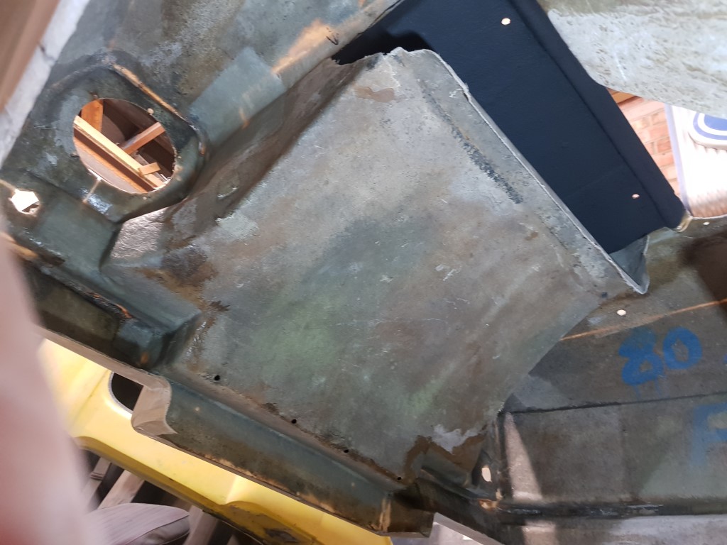

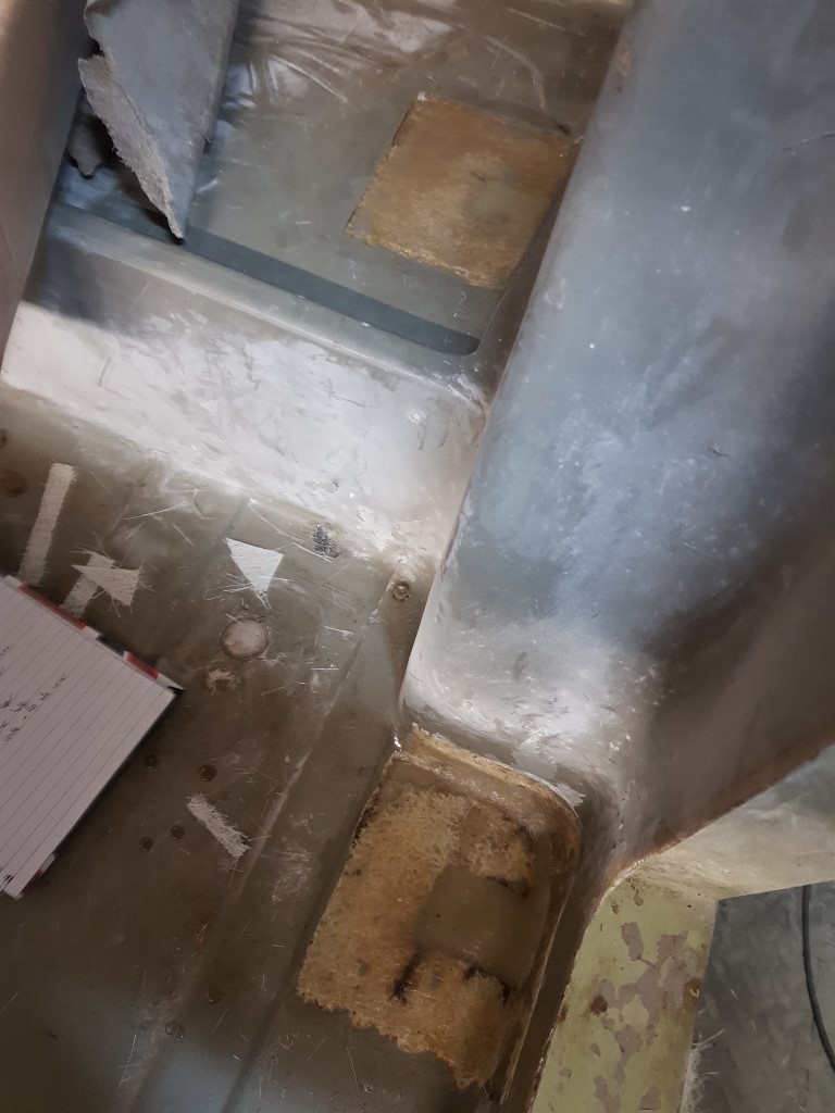

next i wasn't happy with the strength of the floor repairs where the body bolts on, although they are very strong i wanted to go belt and braces so i buzzed back the repair areas on the inside and renforced them so the thickness is now doubled and fibreglassed from both sides...
20200418_235558 (Medium).jpg (145.24 KiB) Viewed 8009 times
20200418_235606 (Medium).jpg (150.44 KiB) Viewed 8009 times

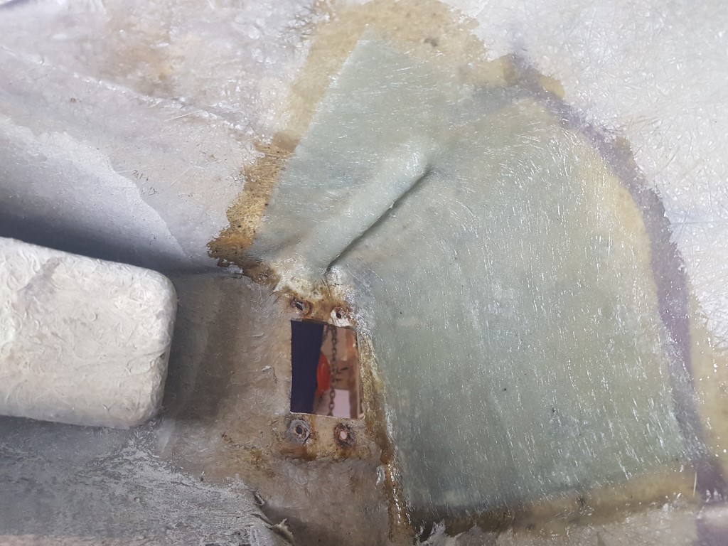

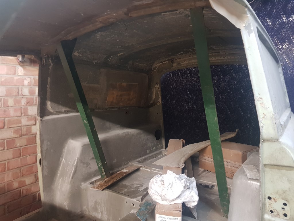

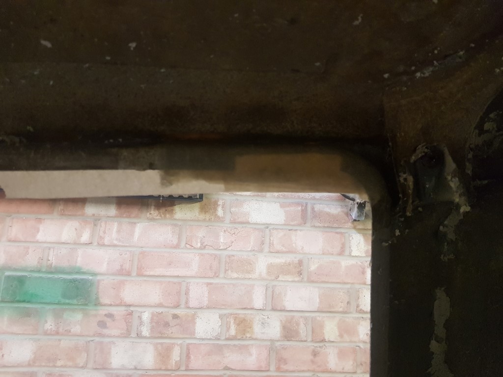

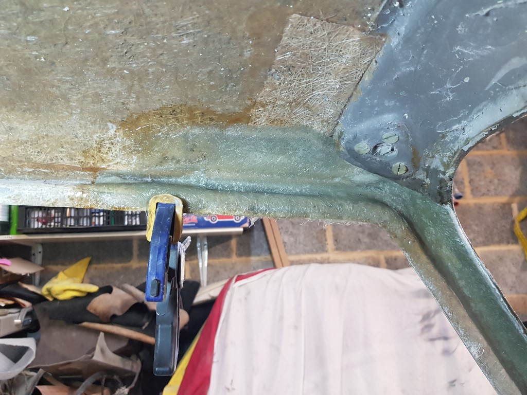

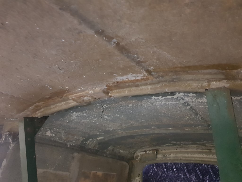

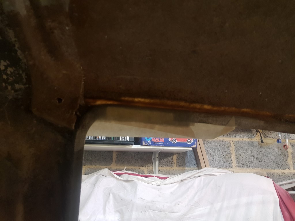

whilst im inside the van i noticed one of the roof struts was cracked in 2 places, so these are now repaired...
20200420_010319 (Medium).jpg (170.49 KiB) Viewed 8009 times
20200420_010325 (Medium).jpg (142.95 KiB) Viewed 8009 times

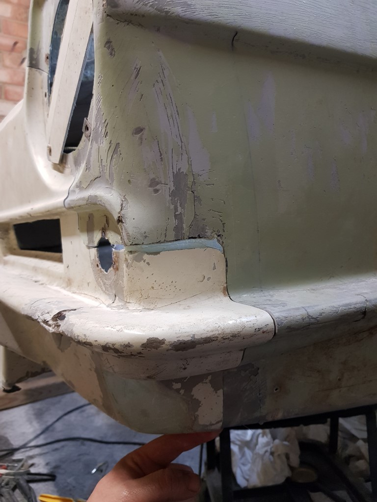

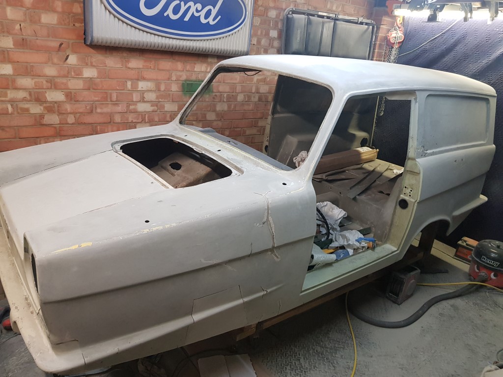

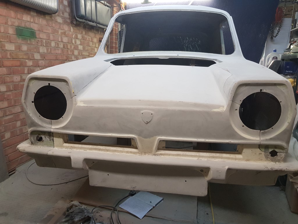

Back on the front end, there are a couple of repairs around the no plate area and also I have finished the bumper corner repair, and i added a reinforcing strip right across the underside of the bonnet from wing to wing, then before i fitted the air scoop section back on i painted the bonnet area with stone chip as this would not be accessible once the scoop is on...
20200423_180101 (Medium).jpg (169.19 KiB) Viewed 8009 times
then fitted the air scoop...
20200424_100001 (Medium).jpg (162.53 KiB) Viewed 8009 times

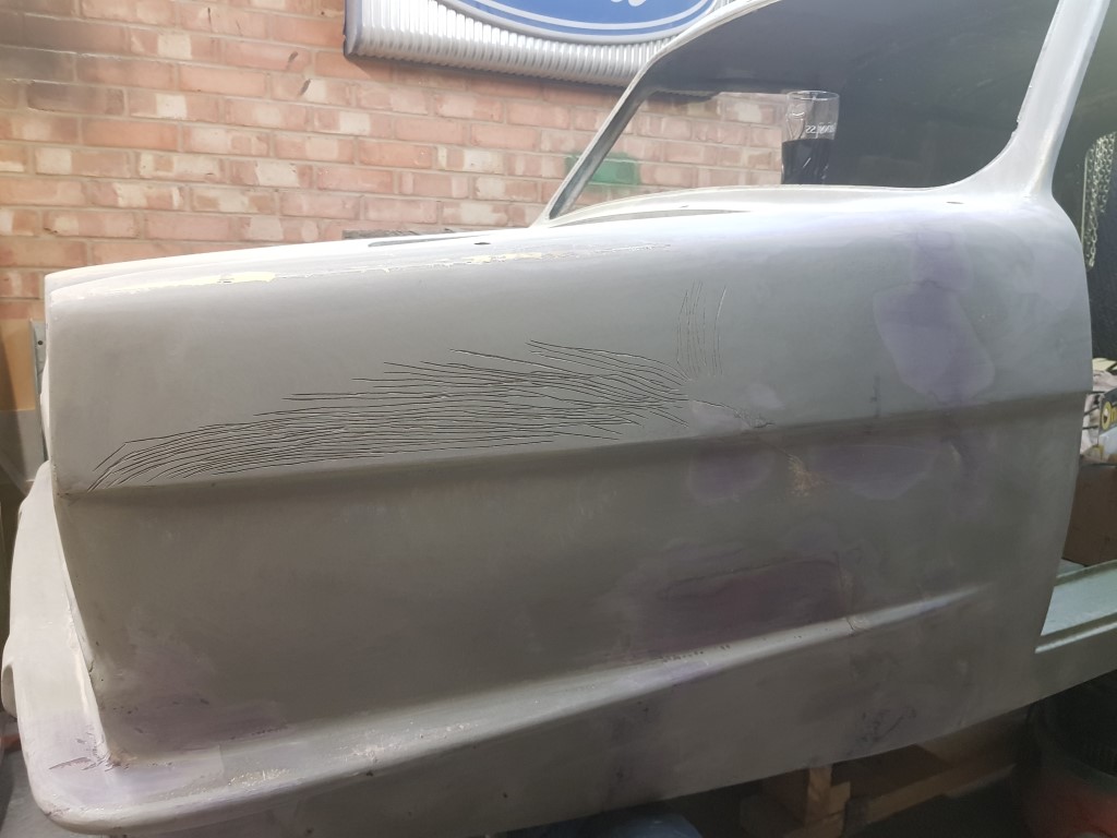

Finally, I have started sanding ! ...
20200420_183312 (Medium).jpg (155.38 KiB) Viewed 8009 times

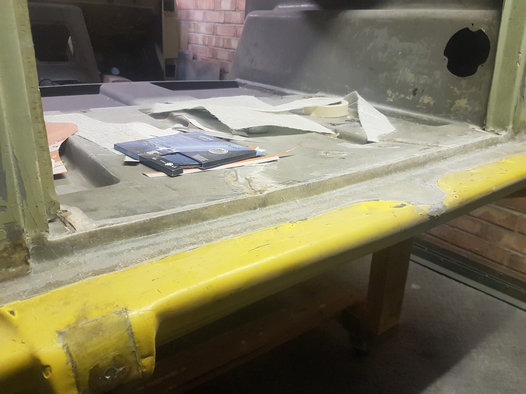

And just for you Julian, proof that the rear floor is strong ...
20200407_132936 (Medium).jpg (223.41 KiB) Viewed 8009 times

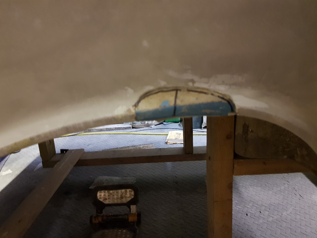

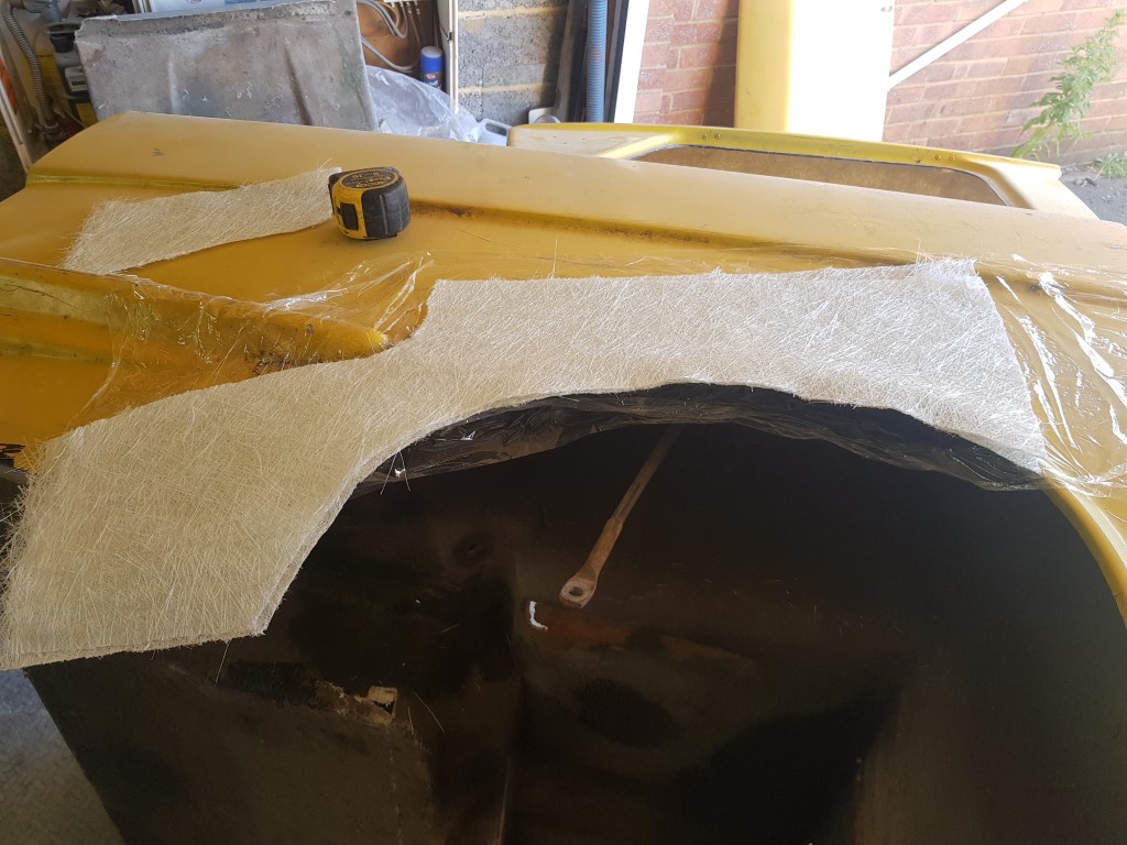

At the end of the last post I had fitted the front half of the air scoop, however before i could fit the back half there were a couple of jobs i had to do first, the first thing was the A pillar reinforcements, on the shell these are the only metal items and as you would expect as with everything else on the van that was metal, they were rotten as a pear...
20200426_145802 (Medium).jpg (286.51 KiB) Viewed 7772 times
you can see in this picture from the outline of the fibreglass that there is about 2 inches missing off the end, the other end which goes down to the bottom of the A pillar and under the front wing has also dissolved...
20200426_151842 (Medium).jpg (275.88 KiB) Viewed 7772 times

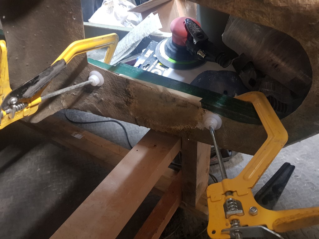

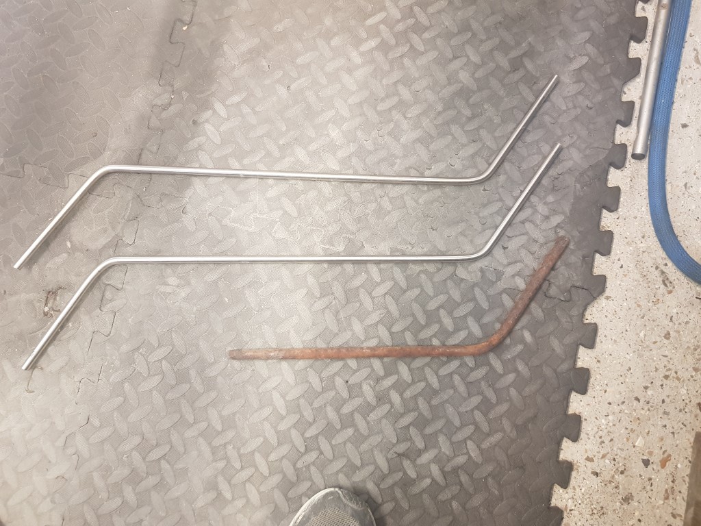

So i proceeded to cut both sides out and made replacement ones out of solid stainless steel rod rather than the original hollow tube...
20200430_143805 (Medium).jpg (183.06 KiB) Viewed 7772 times
new ones made...
20200502_145331 (Medium).jpg (244.74 KiB) Viewed 7772 times

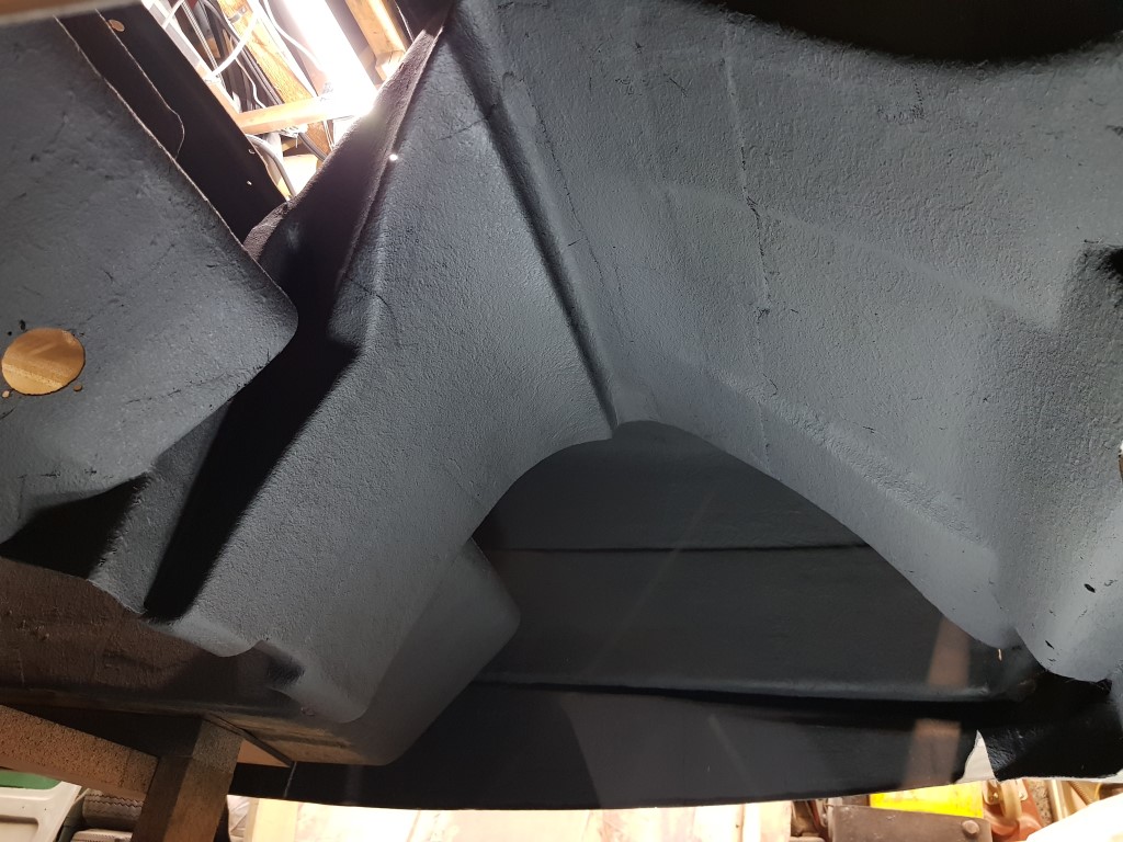

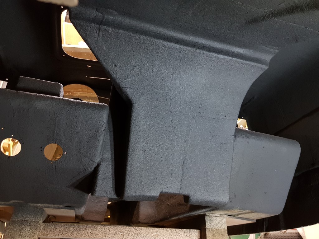

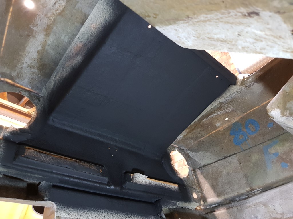

Then the rear of the dash and foot wells could be cleaned and stonechiped...
20200504_103021 (Medium).jpg (168.09 KiB) Viewed 7772 times

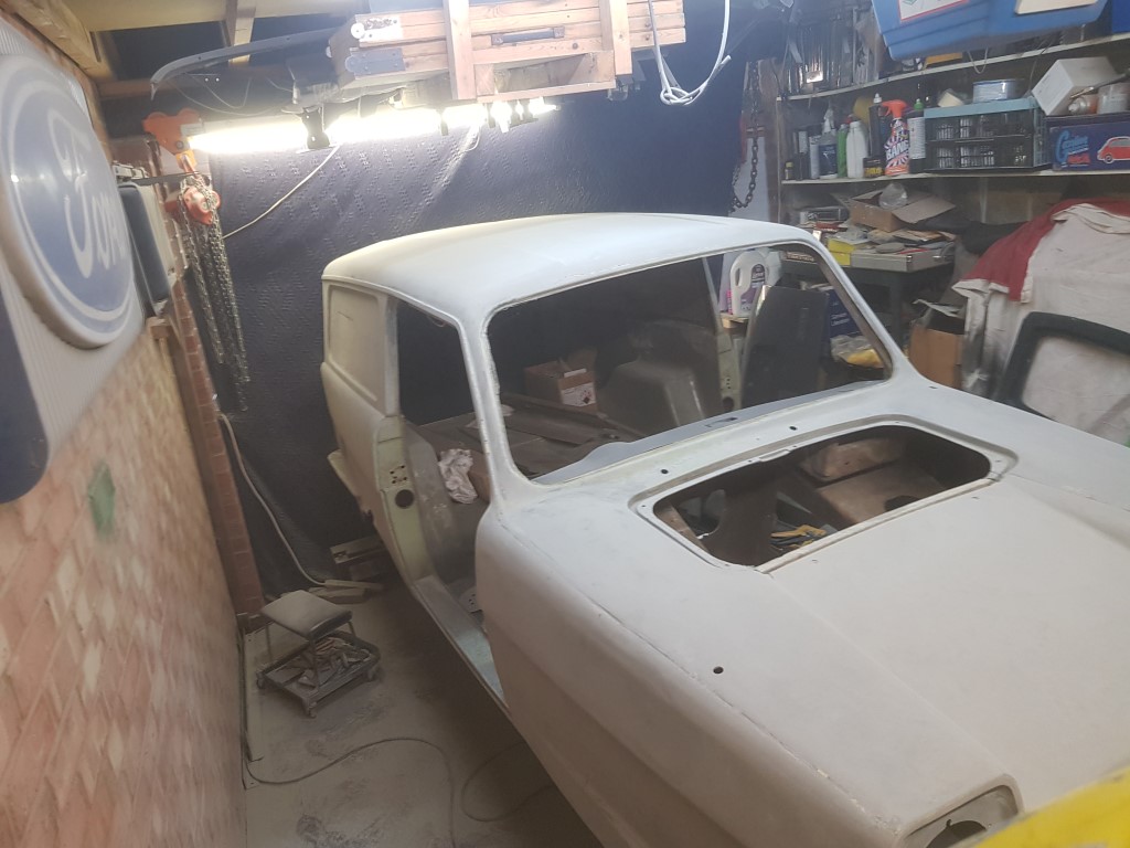

Now this was done i could start fixing the rear half of the scoop in...
20200505_173738 (Medium).jpg (148.28 KiB) Viewed 7772 times

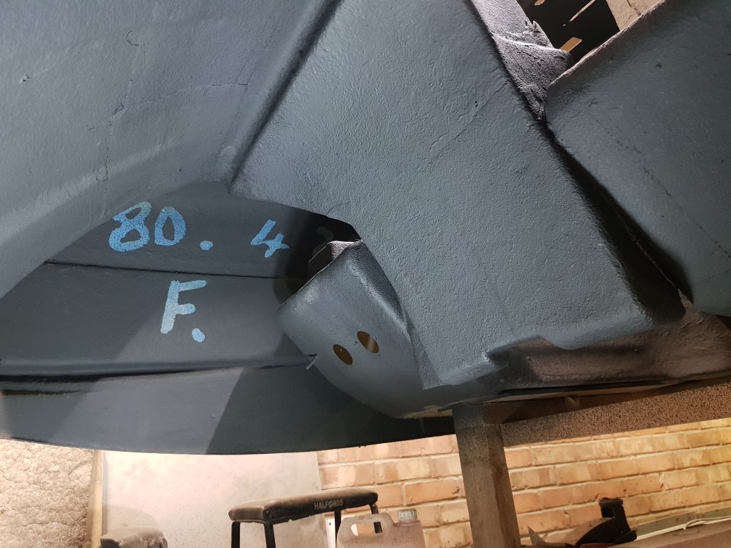

Once this was all fibreglassed in and strong,it also received a coat of stone chip along with the rest of the inner wings...
20200506_160646 (Medium).jpg (208.55 KiB) Viewed 7772 times
20200506_160722 (Medium).jpg (193.76 KiB) Viewed 7772 times
20200506_160752 (Medium).jpg (198.74 KiB) Viewed 7772 times
You can see in the last picture i took the time to mask the original number code on the drivers side inner wing, this is suppose to be the date the shell was made, but this is not the case with mine as the regal went out of production in 1973 so could not have been 1980 as the numbers suggest.

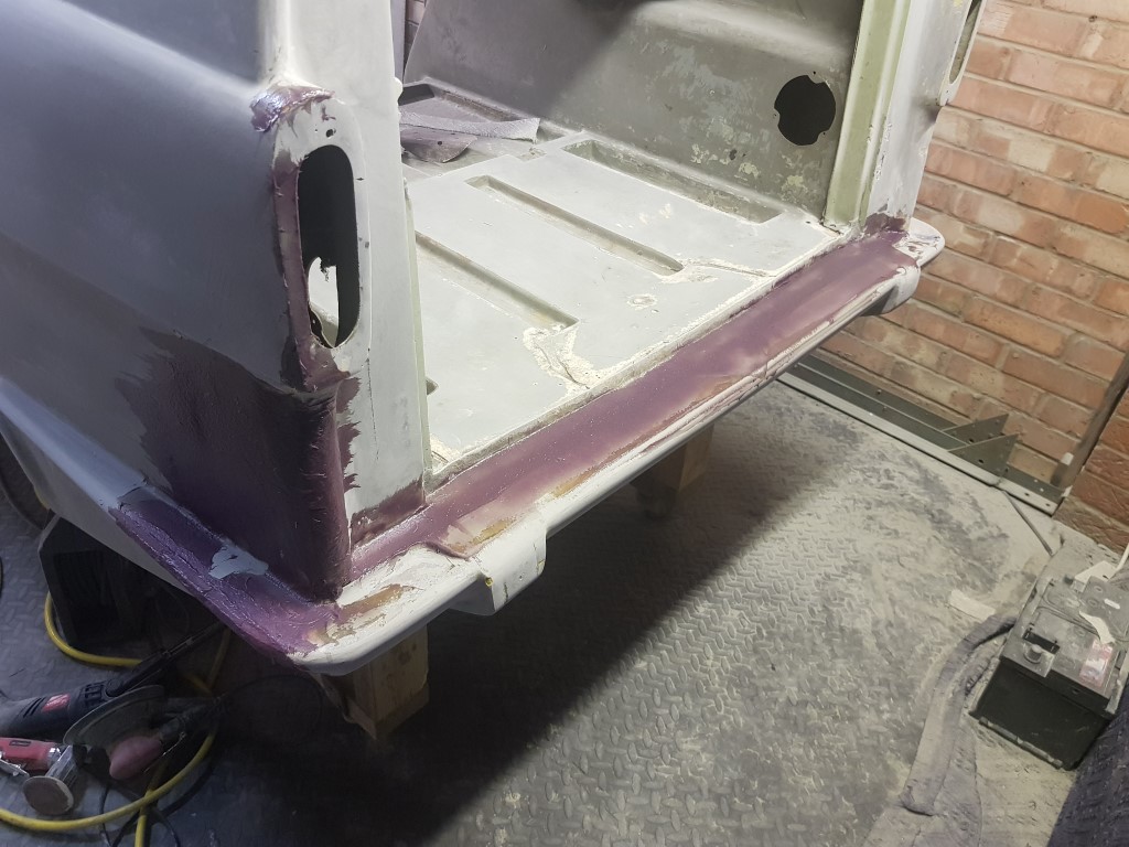

Now this was complete there were only one more big-ish bit of fibreglass to finish which was the rear bumper area, some CAD (cardboard aided design) was needed for this...
20200428_164816 (Medium).jpg (212.43 KiB) Viewed 7772 times
20200428_172905 (Medium).jpg (267.02 KiB) Viewed 7772 times
20200429_135521 (Medium).jpg (183.3 KiB) Viewed 7772 times
After a few more small repairs the fibreglass stage is Finally COMPLETE !! :dance:

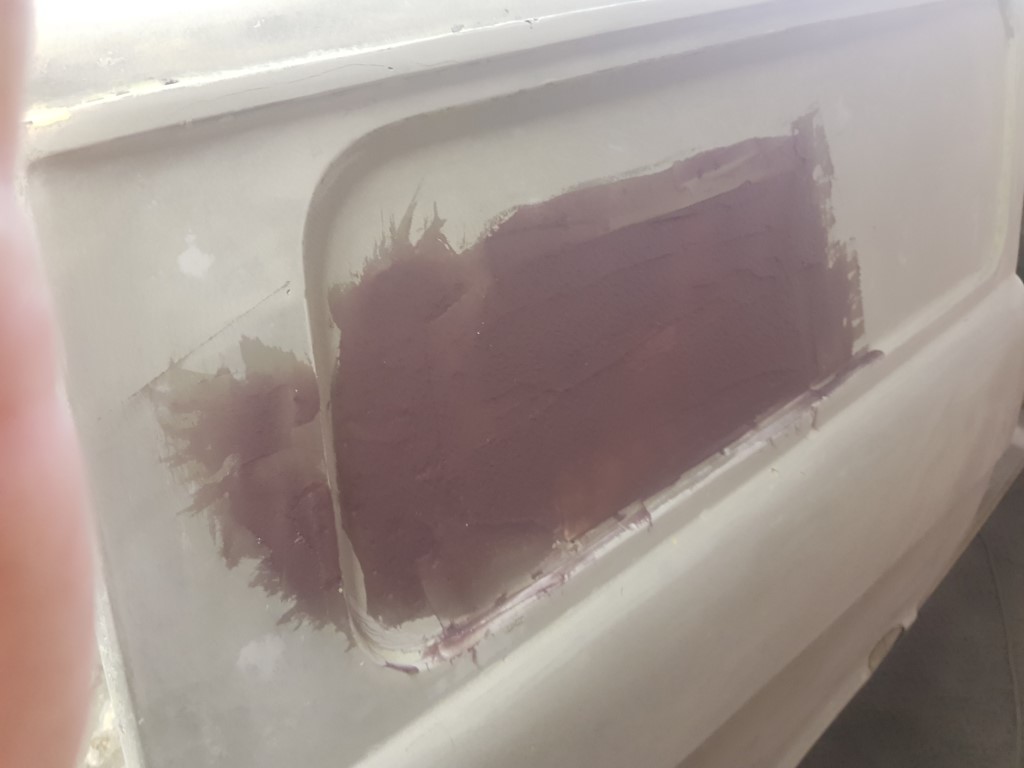

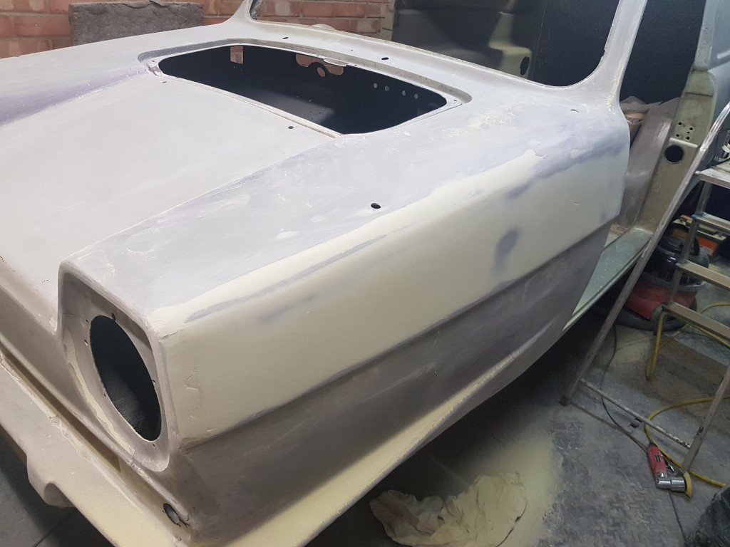

To start with i wanted a fibreglass filler to use for all the big repair areas and where the panels had been joined so i used this ...
20200427_130234 (Medium).jpg (188.85 KiB) Viewed 7772 times
This fibreglass filler is also renforced with Kevlar so should be just what I need, I have done various areas so far all round the van, here are some of them...
20200429_005458 (Medium).jpg (178.59 KiB) Viewed 7772 times
20200429_172944 (Medium).jpg (176.37 KiB) Viewed 7772 times
20200430_141547 (Medium).jpg (182.17 KiB) Viewed 7772 times
20200501_114327 (Medium).jpg (190.17 KiB) Viewed 7772 times
20200429_005518 (Medium).jpg (85.21 KiB) Viewed 7772 times
20200501_115904 (Medium).jpg (161.87 KiB) Viewed 7772 times

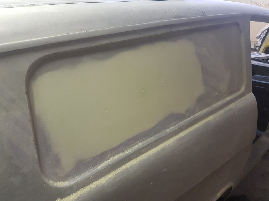

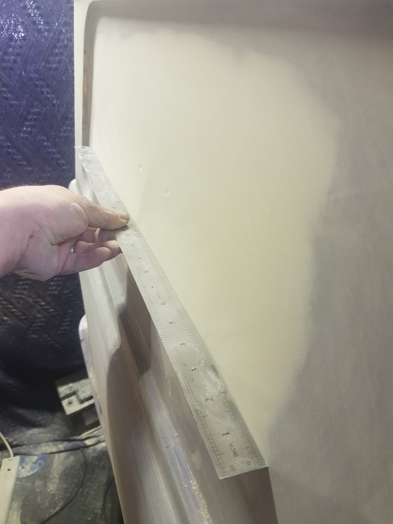

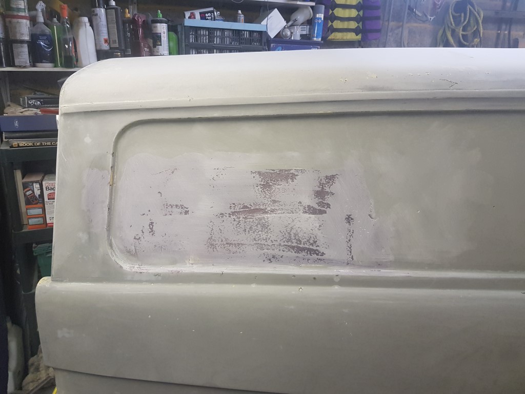

You get the idea on this, this side panel needed 2 layers of the fibreglass filler before i then moved on to a more conventional finishing body filler made by the same company Evercoat, this filler is called Rage Gold and is a very nice bit of stuff, here you can see the side panel now it has a layer of this added...
20200507_103506 (Medium).jpg (122.86 KiB) Viewed 7772 times
20200507_104019 (Medium).jpg (111.13 KiB) Viewed 7772 times

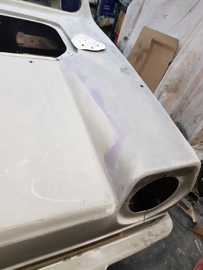

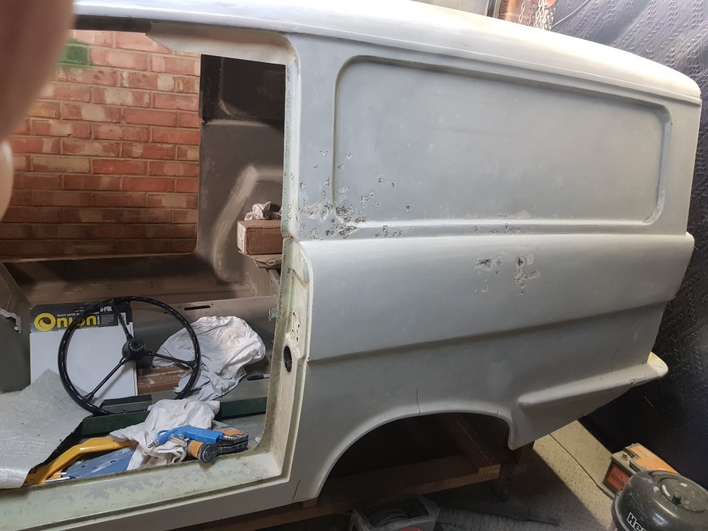

Now although this still needs finishing as there are a couple of divits that need going over its certainly better than the bullet holes that were in it :D

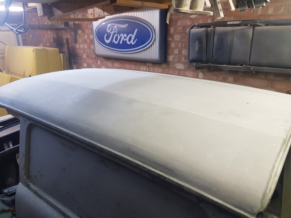

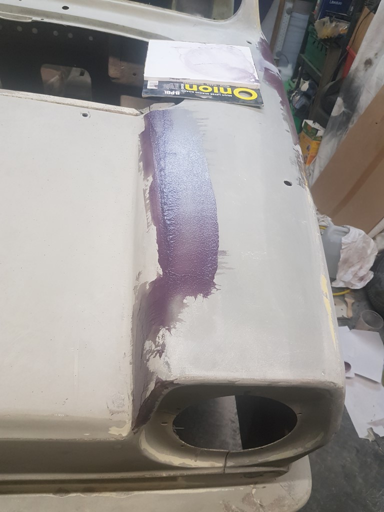

I've also started repairs to the roof and passenger front wing with the finer filler now too, and wherever there have been cracks in the Gel coat i have just a Dremel and gently grooved these down to the fibreglass so the filler has something good to key to, looks like i have tree bark effect body panels...
20200507_173004 (Medium).jpg (188.7 KiB) Viewed 7772 times
20200509_152628 (Medium).jpg (155.39 KiB) Viewed 7772 times
20200509_143913 (Medium).jpg (126.18 KiB) Viewed 7772 times
20200509_163922 (Medium).jpg (164.47 KiB) Viewed 7772 times
Again the front wing requires more work but its a definite improvement, that's it for now guys, i think its safe to say ive got a lot more sanding to do yet :doh:
