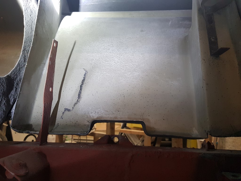

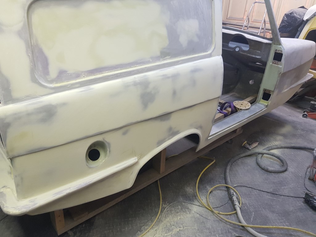

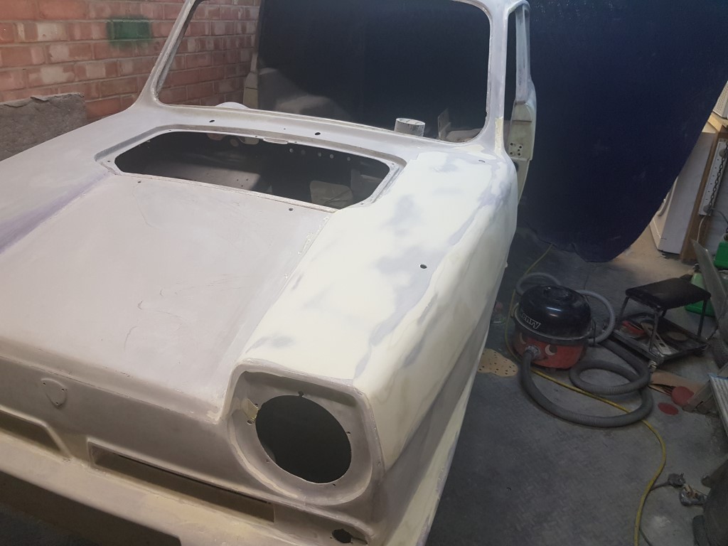

Postby mec » Sat Jun 06, 2020 2:31 pm

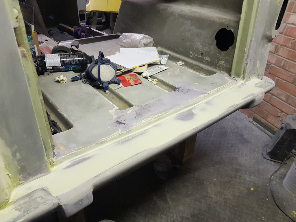

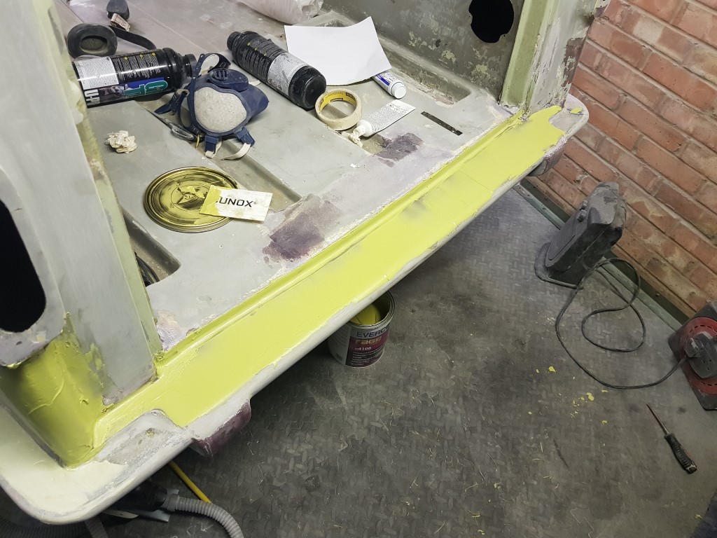

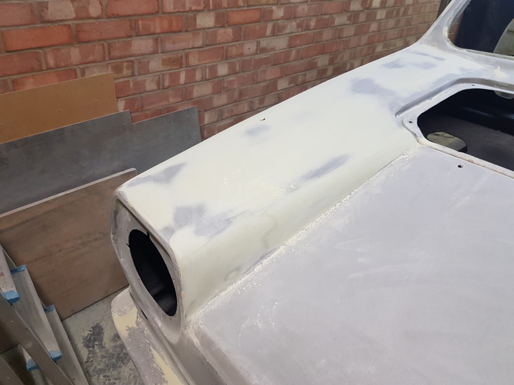

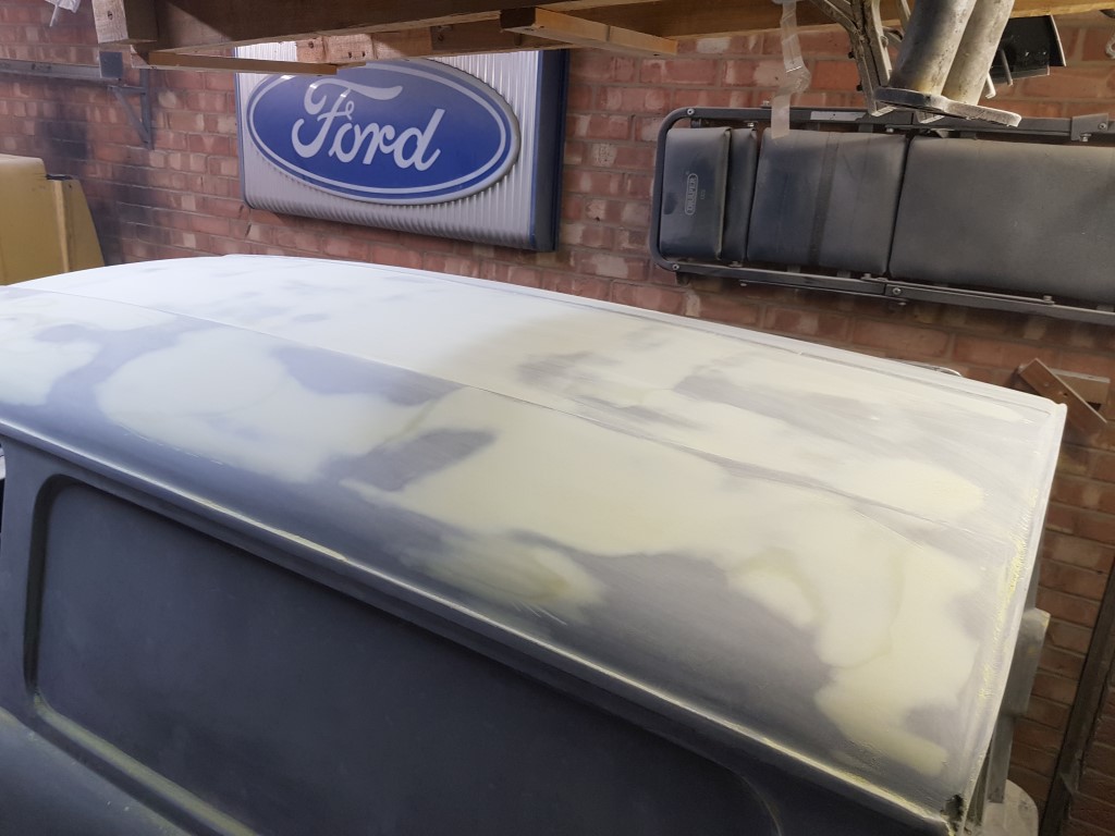

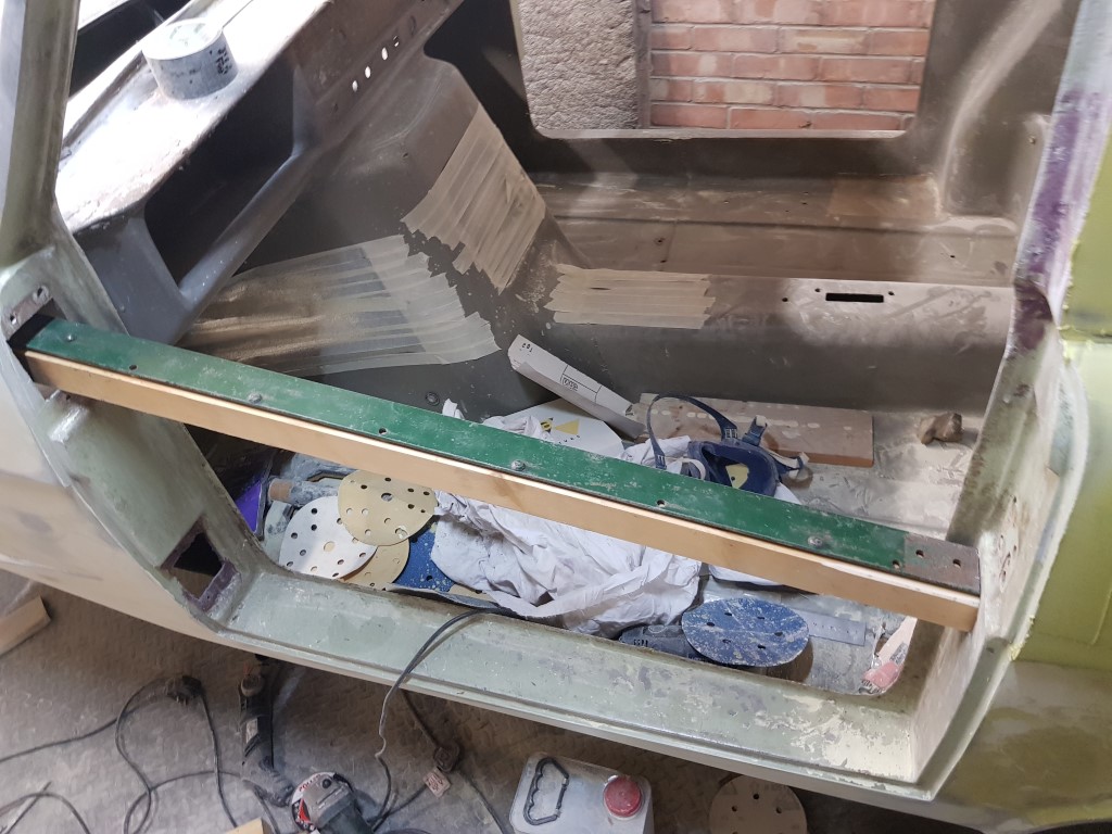

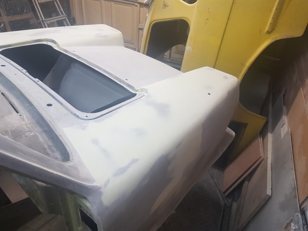

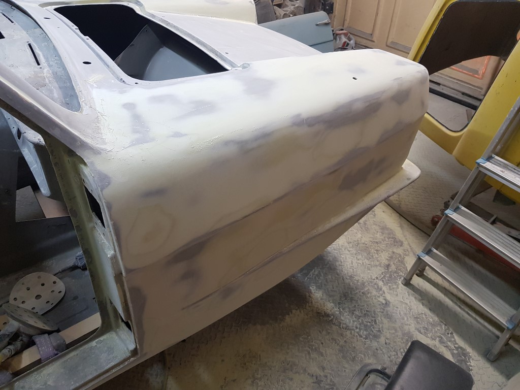

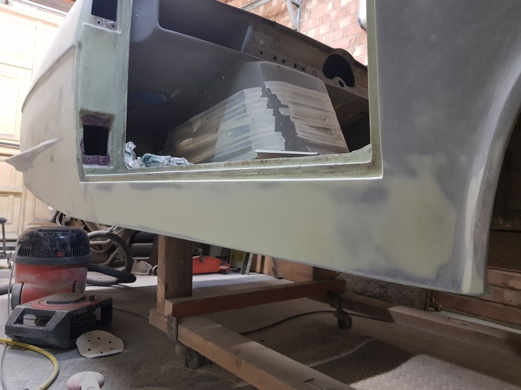

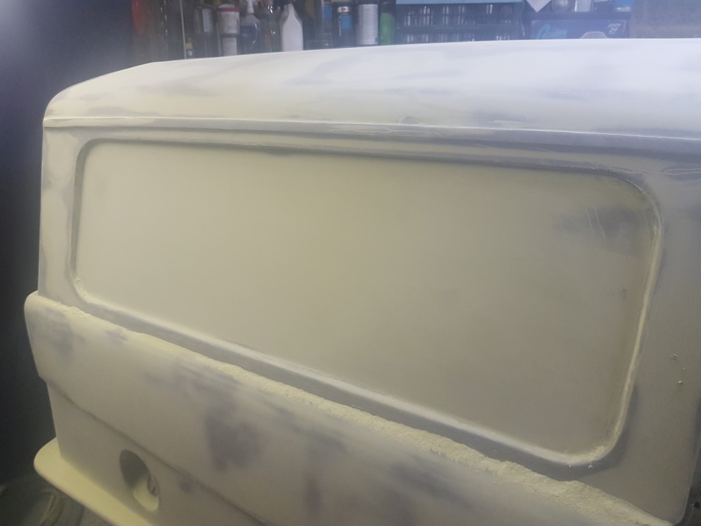

Hi All
Hope you are all well, another update on PP, many many hours of filling and sanding have been taking place, heres some pics...
20200510_172228 (Medium).jpg (164.7 KiB) Viewed 10753 times
20200511_181650 (Medium).jpg (145.05 KiB) Viewed 10753 times
20200515_164351 (Medium).jpg (149.06 KiB) Viewed 10753 times
20200516_155121 (Medium).jpg (210.66 KiB) Viewed 10753 times
20200516_165707 (Medium).jpg (199.64 KiB) Viewed 10753 times
20200517_173615 (Medium).jpg (171.17 KiB) Viewed 10753 times
20200519_235803 (Medium).jpg (101.67 KiB) Viewed 10753 times
20200520_114920 (Medium).jpg (143.42 KiB) Viewed 10753 times
20200525_155250 (Medium).jpg (191.46 KiB) Viewed 10753 times
20200525_155300 (Medium).jpg (153.23 KiB) Viewed 10753 times

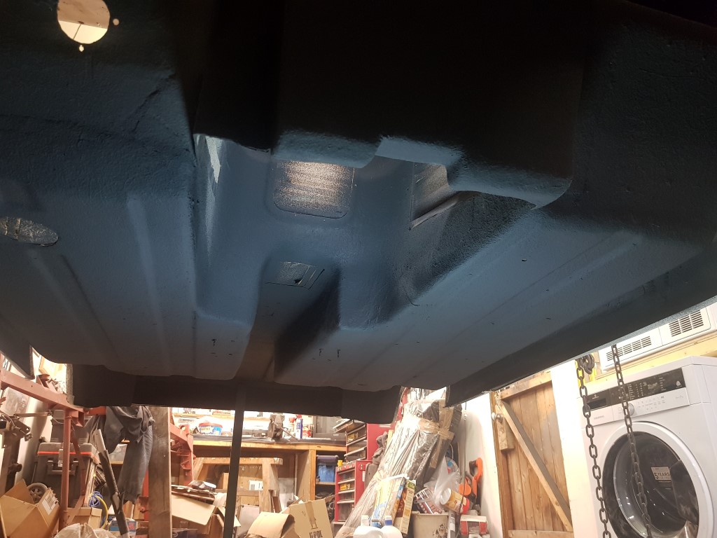

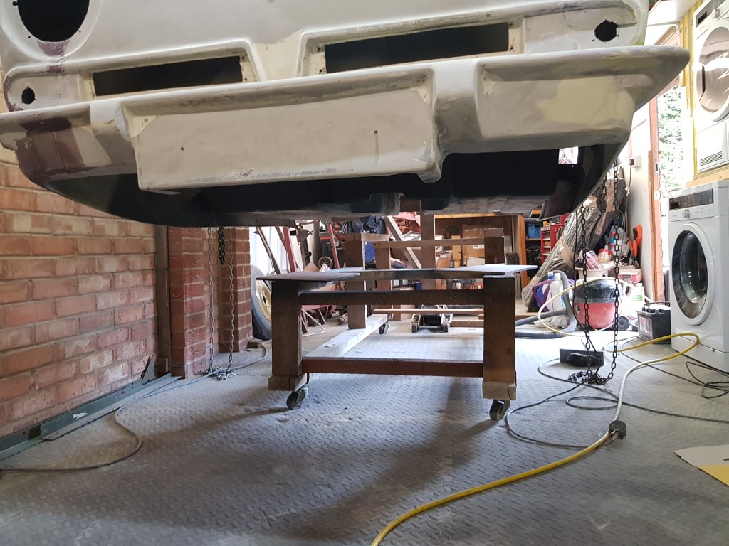

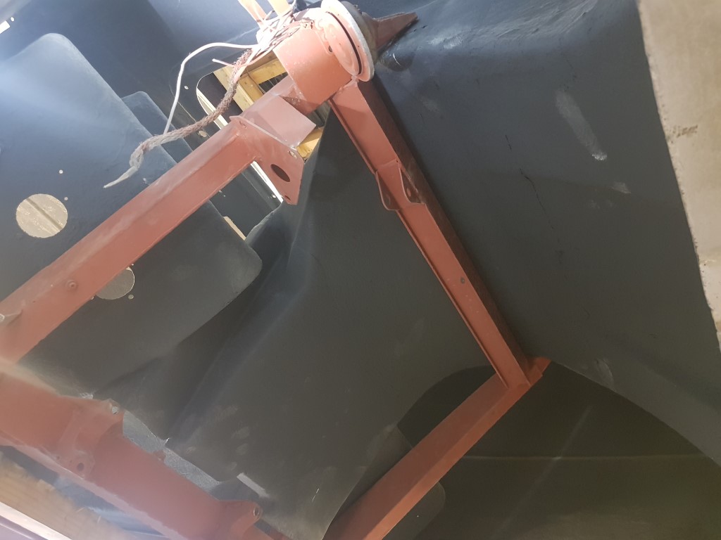

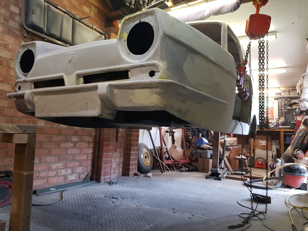

I have also made the van into a hover van ;) ...
20200513_133749 (Medium).jpg (196.52 KiB) Viewed 10753 times
20200513_144843 (Medium).jpg (252.43 KiB) Viewed 10753 times
20200513_144921 (Medium).jpg (264.07 KiB) Viewed 10753 times

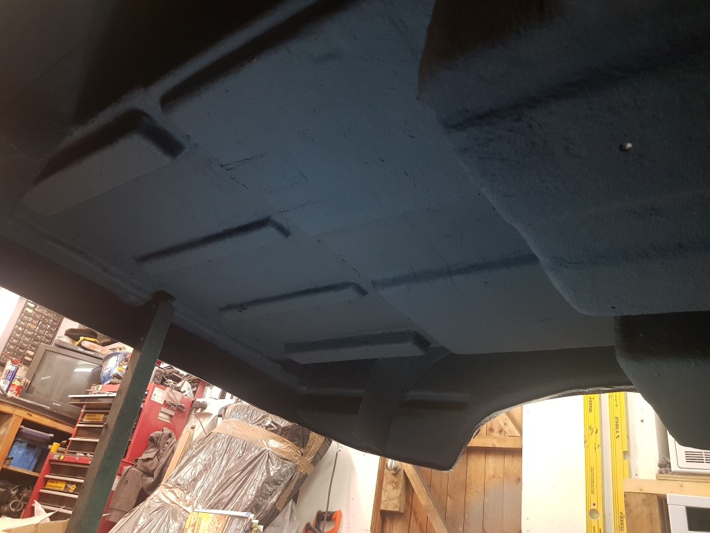

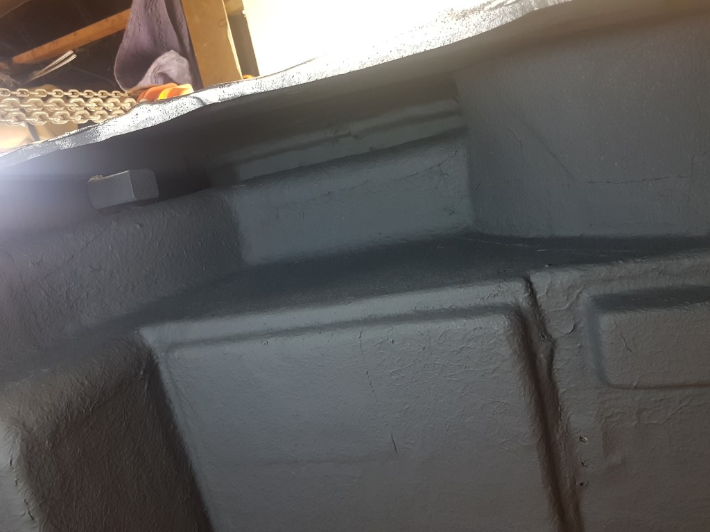

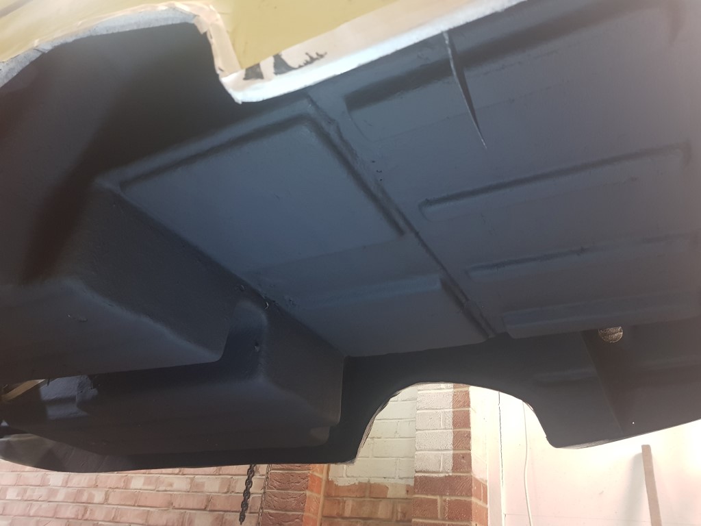

This was so i could finish the underside off, this is now fully painted with stone chip so give it a uniform look...
20200514_235059 (Medium).jpg (168.77 KiB) Viewed 10753 times
20200514_235125 (Medium).jpg (145.42 KiB) Viewed 10753 times
20200514_235206 (Medium).jpg (99.63 KiB) Viewed 10753 times
20200514_235219 (Medium).jpg (134.21 KiB) Viewed 10753 times

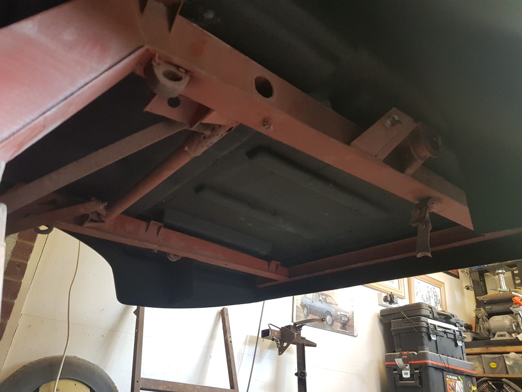

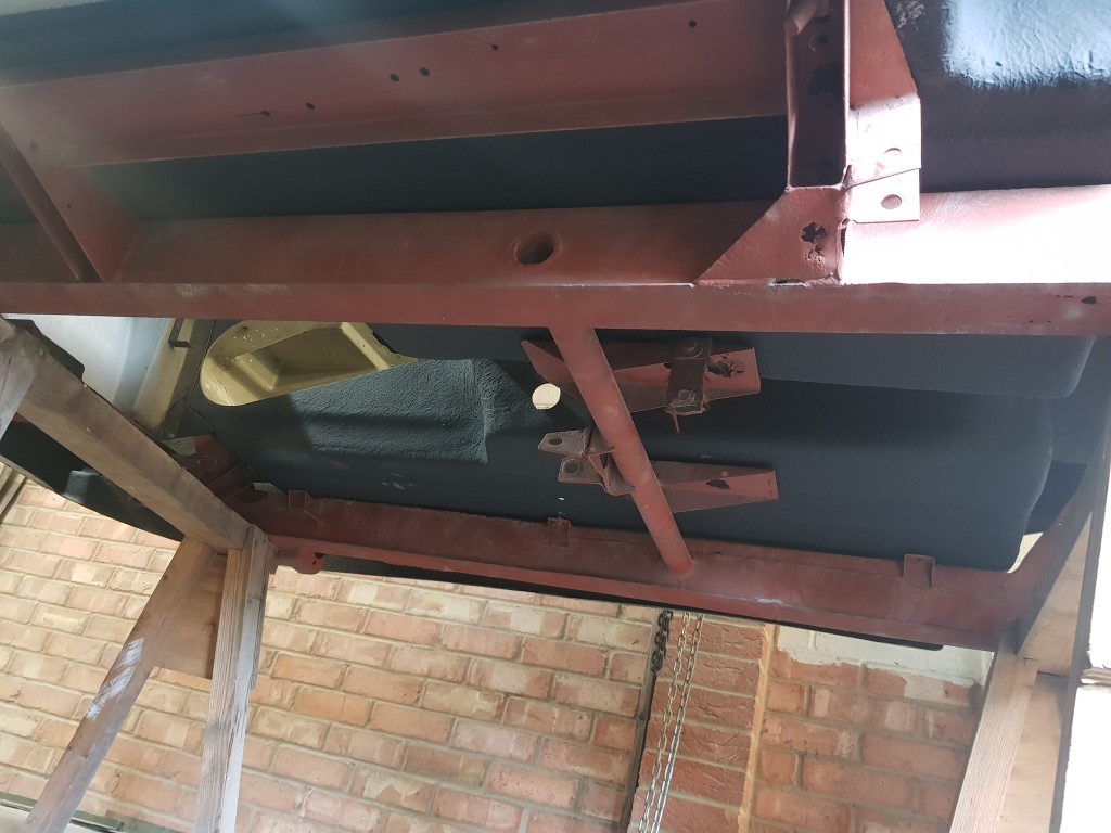

Also whilst the body was up in the air I took the opportunity to test fit the chassis to see if all my body repairs were ok, and I'm pleased to say that apart from taking a couple of mm off the edge of the Rad scoop it all fits !
20200515_140011 (Medium).jpg (154.39 KiB) Viewed 10753 times
20200515_135857 (Medium).jpg (161.33 KiB) Viewed 10753 times
20200515_135737 (Medium).jpg (110.72 KiB) Viewed 10753 times
The next picture is the air scoop where i had to take a couple of mm off the left lower corner, this was very minimal so im well pleased with that...
20200515_135757 (Medium).jpg (186.05 KiB) Viewed 10753 times
That's it for now, I've still got some more filler work to do but its all the little fiddly bits now, then i can get it in primer, I'm not sure if I'm going to paint it straight away or start getting the chassis sorted so i can build it into a complete van, then paint it, haven't decided yet, on we go, also keep an eye out for an update on "Poirot" ;) :dance: :dance: :dance:

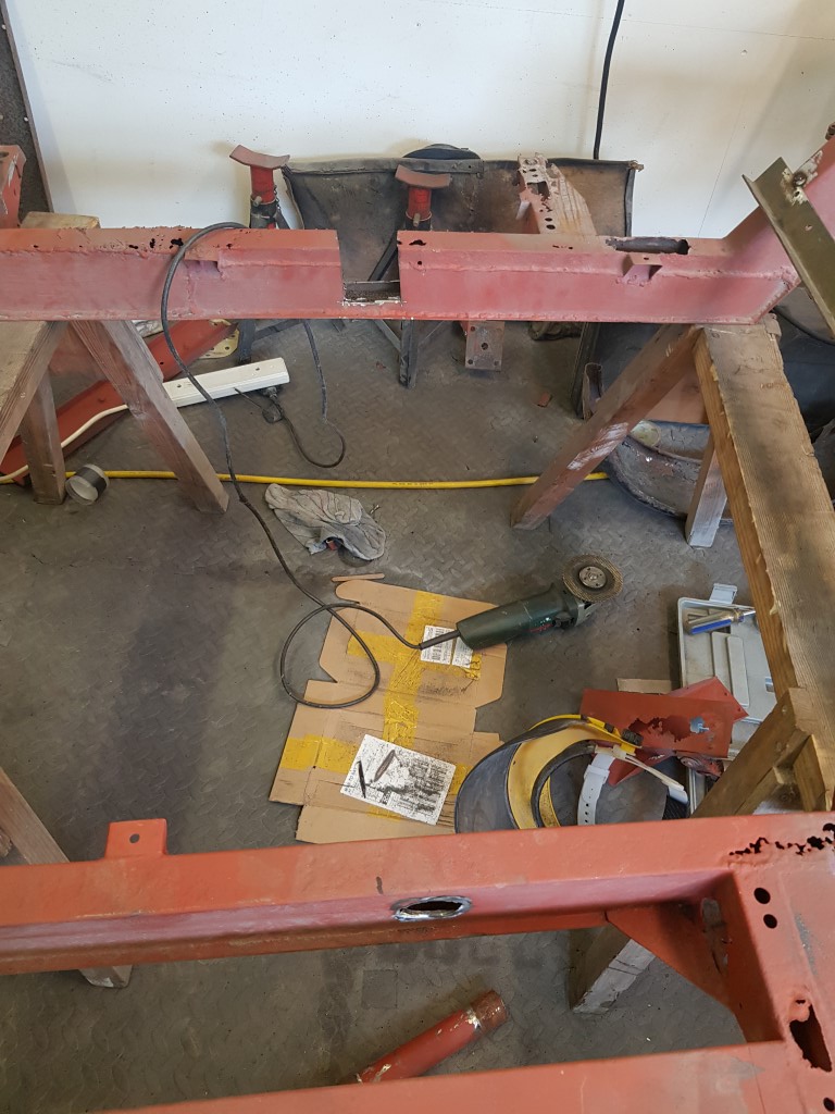

Right then Project Plonker continues !! ...
To say i got fed up with filling and sanding is an understatement so for a change i have left the body alone for a while and have been working on the chassis, now although the chassis looked "solid" it had been repaired a lot and not to the best standard so a lot of what i have done is making right whats been done badly before along with other repairs it needed along the way

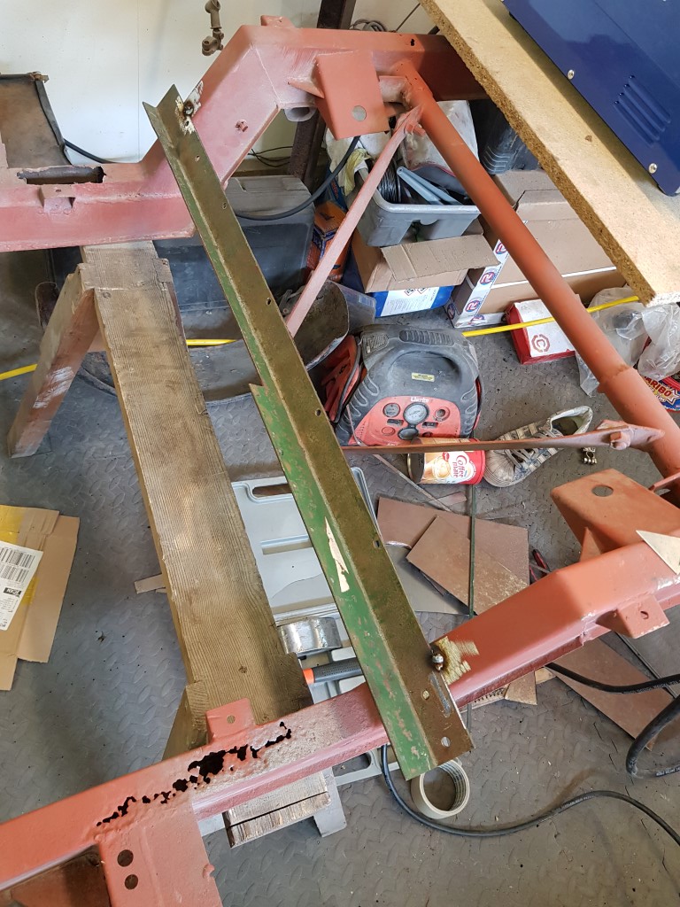

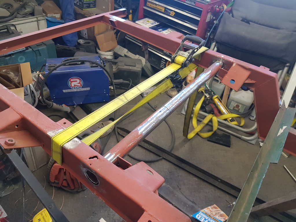

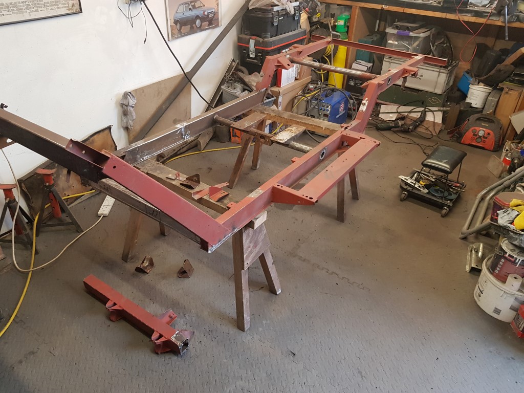

I started off by bracing the chassis to keep the width correct...
20200618_135911 (Medium).jpg (256.8 KiB) Viewed 10577 times
20200618_140408 (Medium).jpg (304.59 KiB) Viewed 10577 times

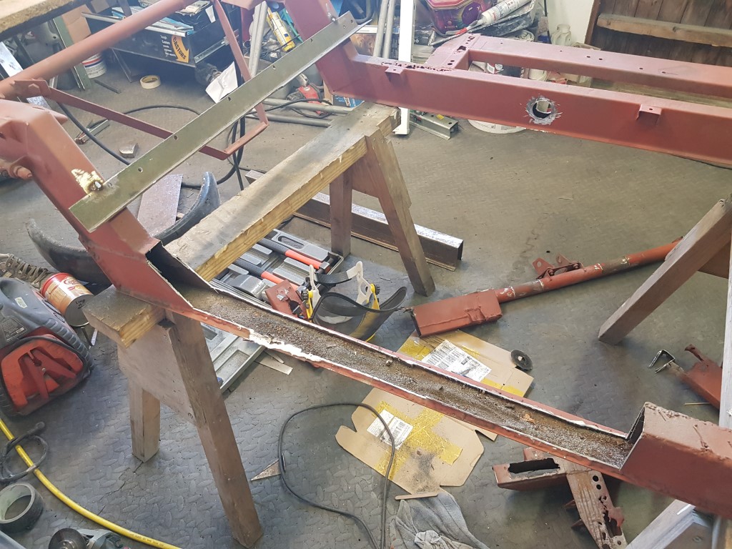

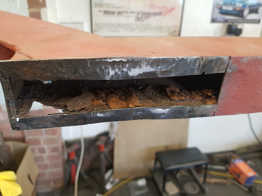

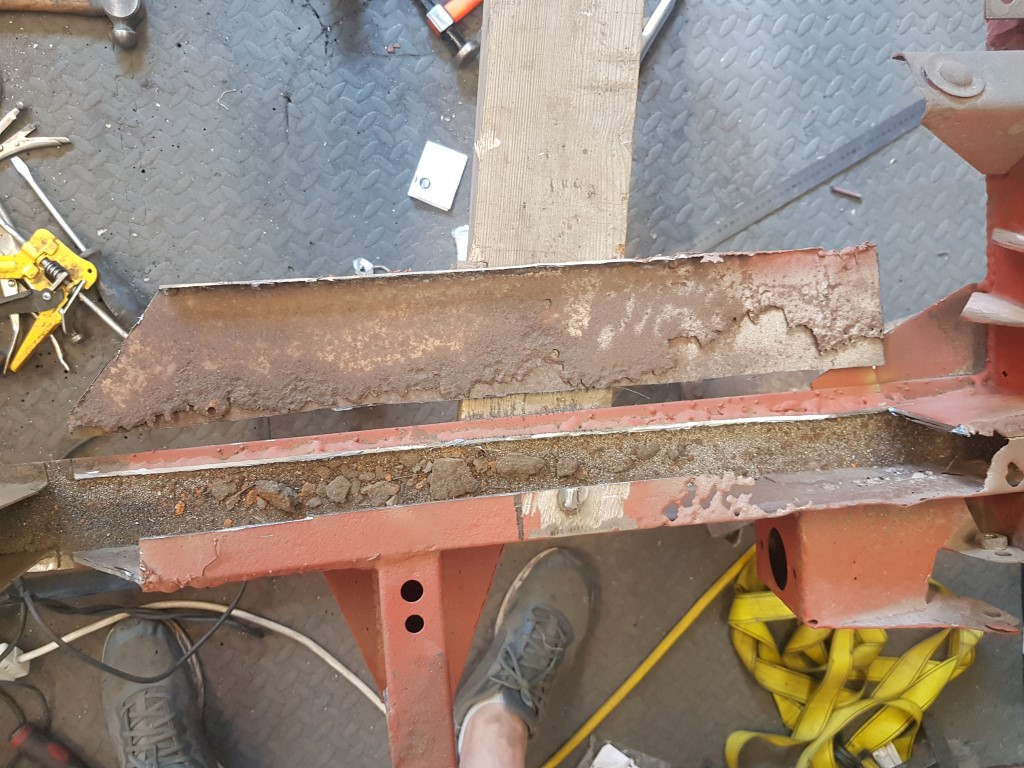

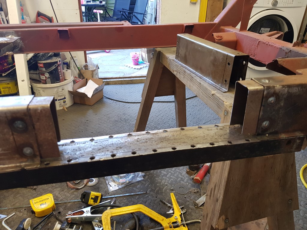

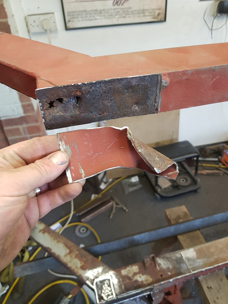

After these were in, the 1st repair i started with was the biggest as you do lol, this started but cutting out the centre bar which holds the rear gearbox mount...
20200618_151356 (Medium).jpg (233.4 KiB) Viewed 10577 times
you can see in this picture some of the holes and previous repairs that had been done on the drivers side chassis rail
20200618_151359 (Medium).jpg (216.67 KiB) Viewed 10577 times

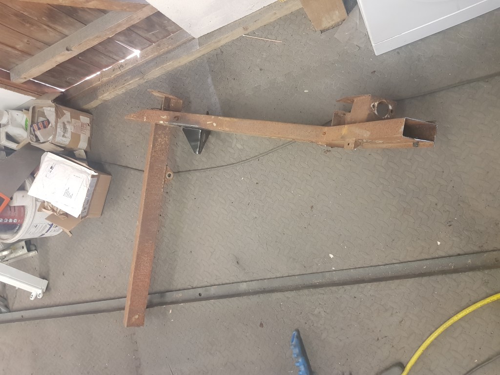

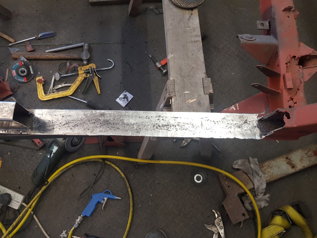

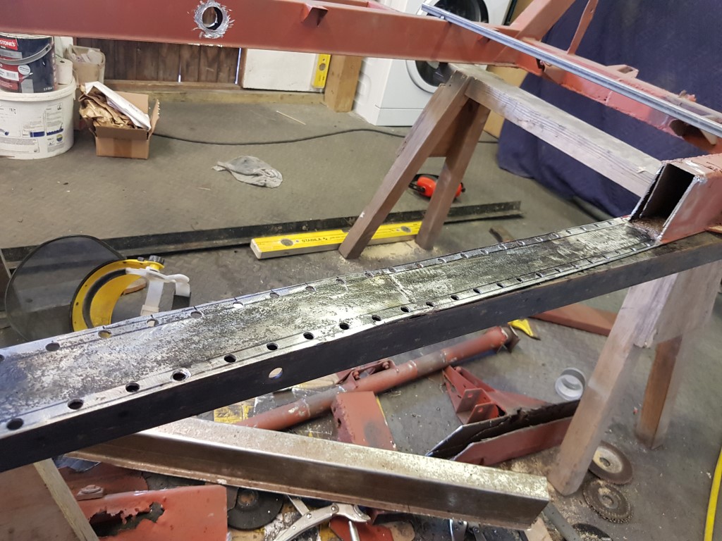

this is the bar that was removed, i have another one of these in better condtion with the flat plates and gearbox mount already on so this bar is going to be re used further in the post

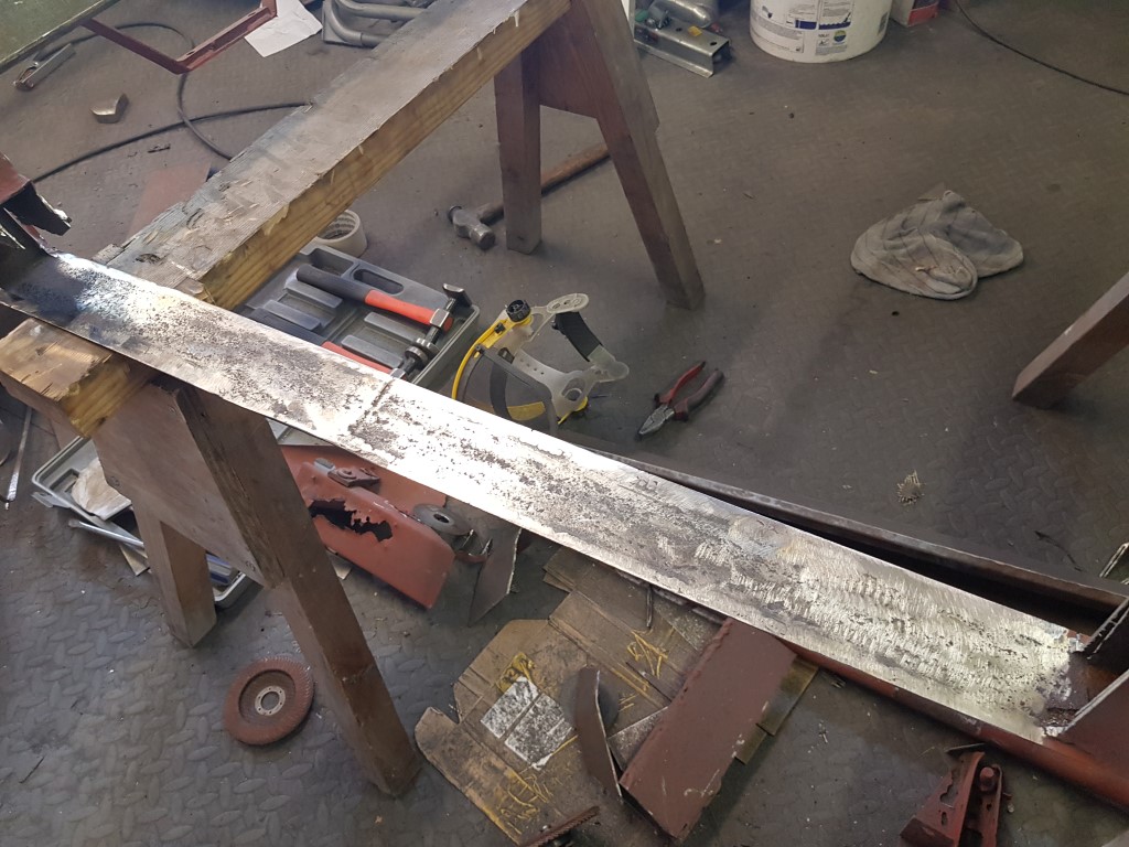

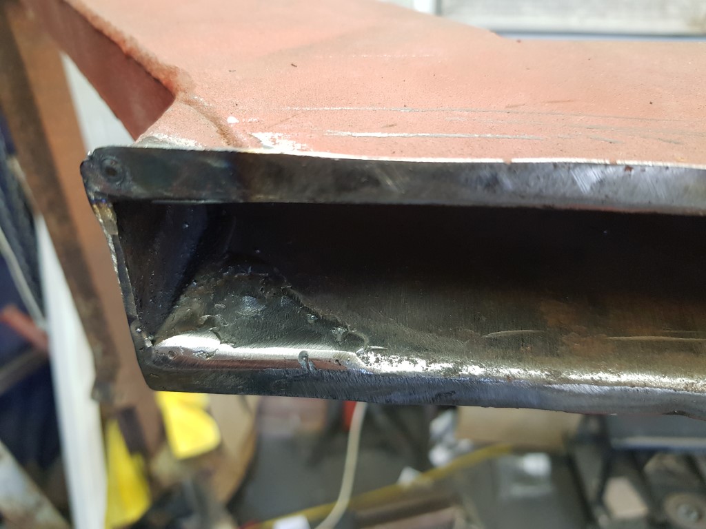

this section of the chassis rail was then cut out and all that was left was the bottom plate which had already been replaced and is in good condition so I left this in place to re use ...
20200618_154701 (Medium).jpg (288.51 KiB) Viewed 10577 times
this was then all cleaned up...
20200618_172944 (Medium).jpg (236.43 KiB) Viewed 10577 times

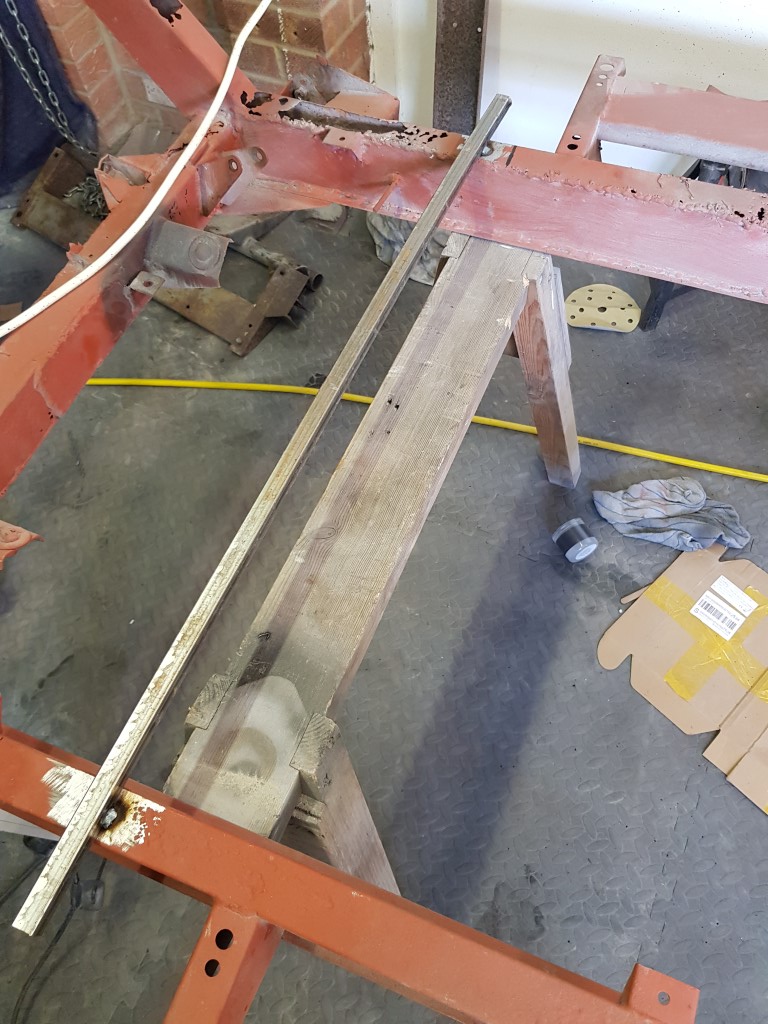

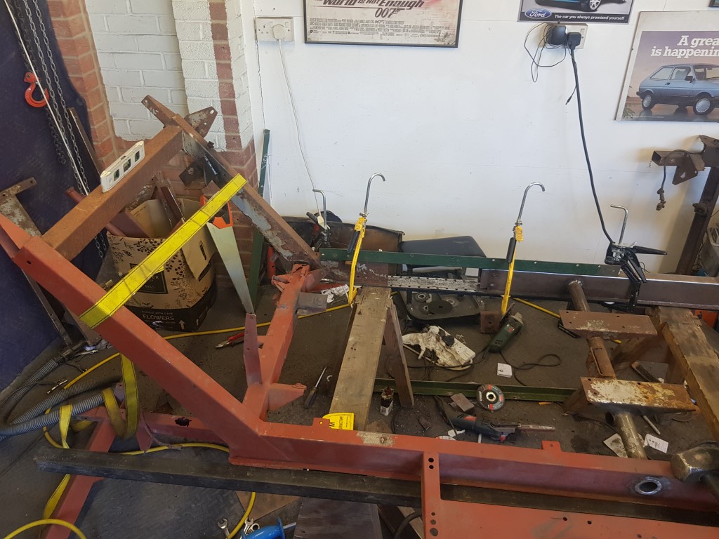

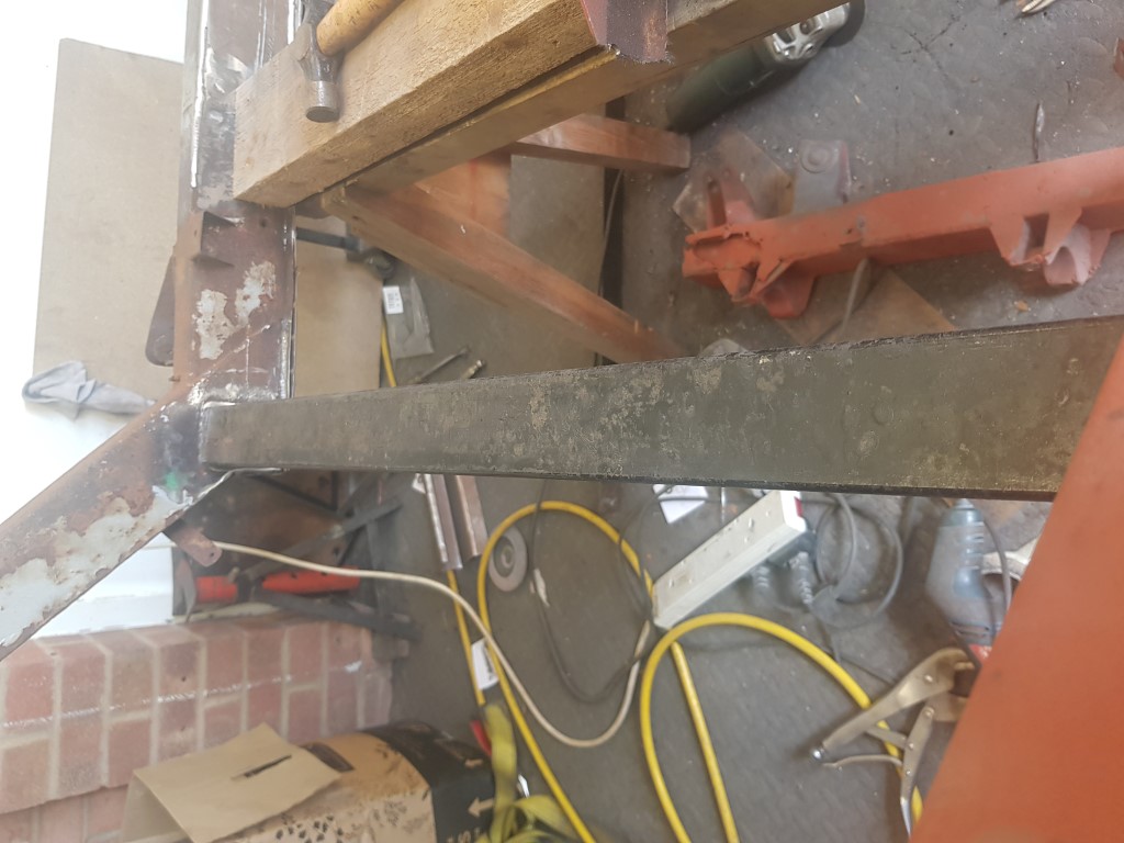

I then place the chassis on angle iron both sides to level it up and also to keep the strength whiilst sections were cut out...
20200619_133256 (Medium).jpg (238.54 KiB) Viewed 10577 times

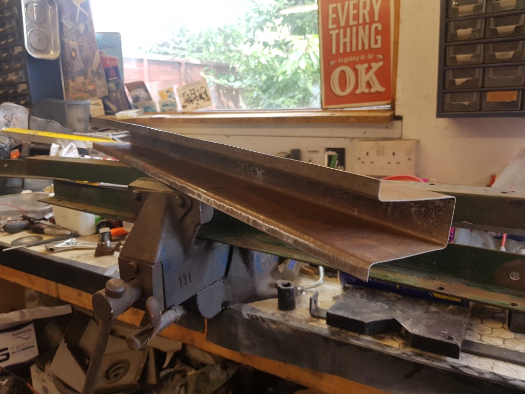

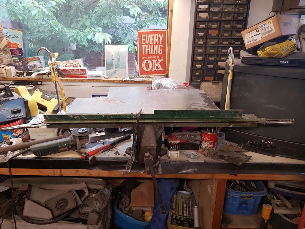

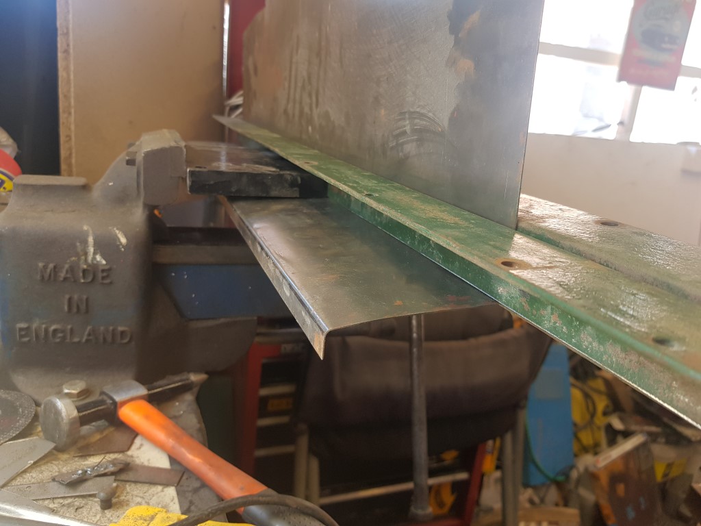

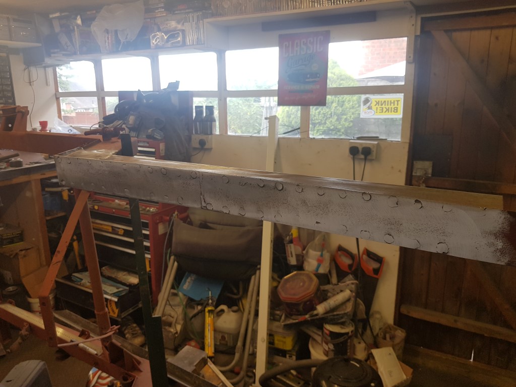

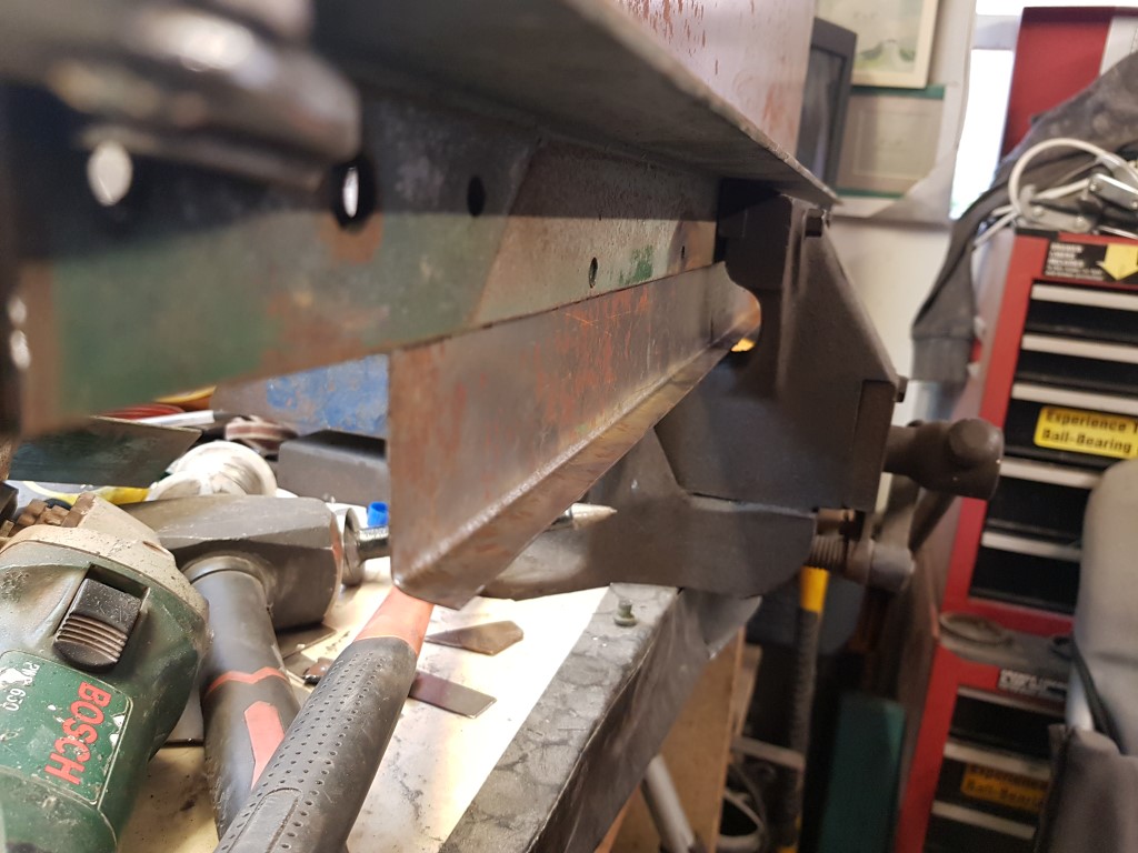

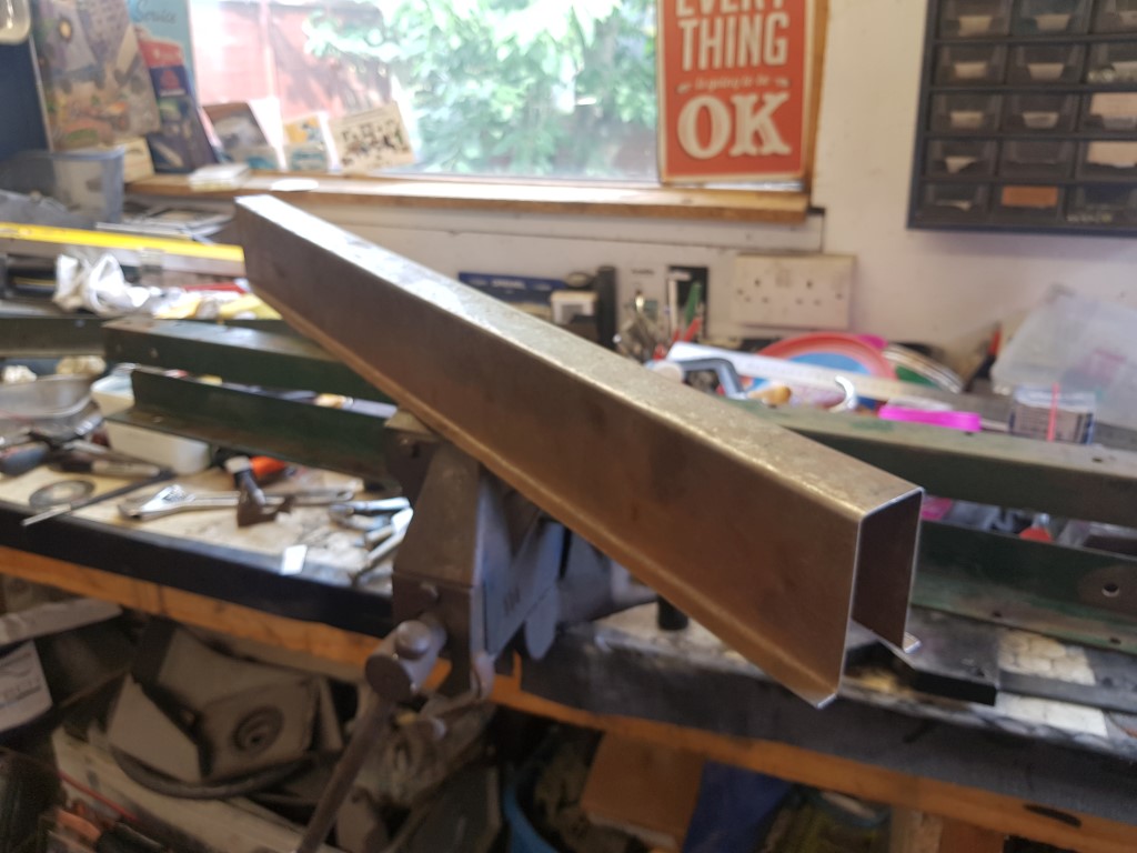

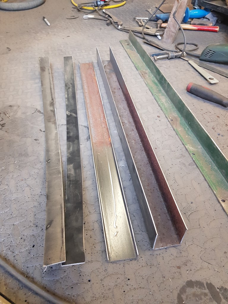

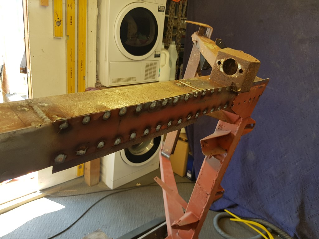

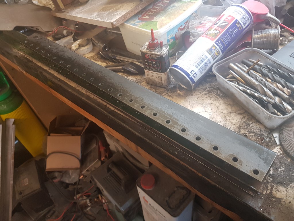

So then what do I do about getting a new chassis rail for a 50 year old reliant, well i did ask my old mate Alex D if the company he uses for the delorean chassis metalwork could make me a section, he helped me out loads as usual and did some drawings and sent them over to the company, however they seemed to have a problem with making the small lip on the bottom of the panel so then it started me thinking, do i have the skill to make it ??

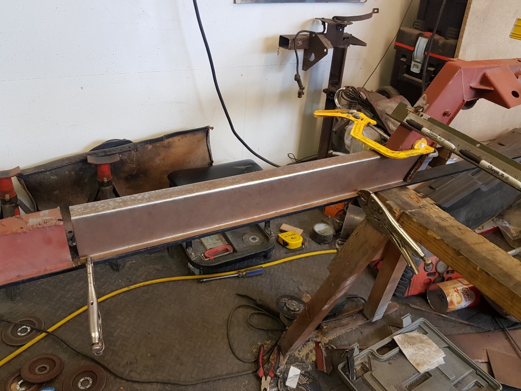

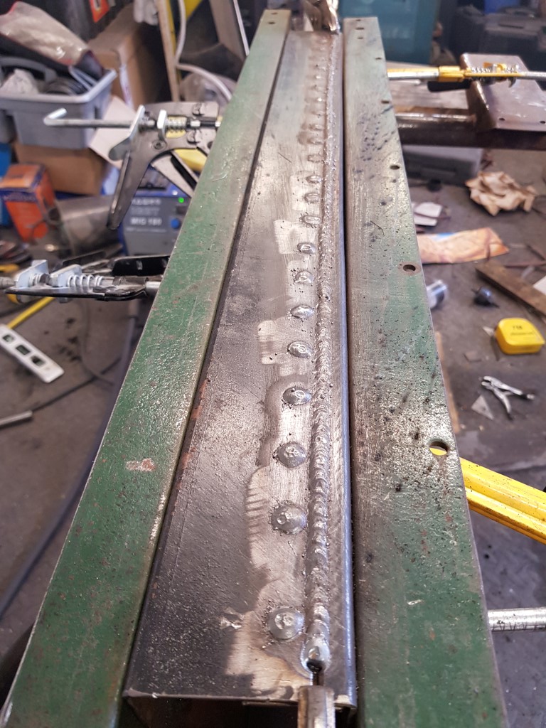

Well I thought sod it il have a go, i have a sheet of the 1.2mm steel sheet from ages ago so its not going to cost me anything to try just my time, I must also stress I DONT have a sheet metal break for folding metal, this is what i came up with ...
20200612_185040 (Medium).jpg (291.01 KiB) Viewed 10577 times
20200612_190030 (Medium).jpg (191.85 KiB) Viewed 10577 times
20200614_105820 (Medium).jpg (165.94 KiB) Viewed 10577 times
In case your wondering, that's a vice, 3 pieces of angle iron, 4 C clamps, 2 pairs of mole grips, a lump of metal (my hydraulic press base) and a club hammer and this is what i ended up with ...
20200617_155753 (Medium).jpg (174.08 KiB) Viewed 10577 times
20200617_155810 (Medium).jpg (207.25 KiB) Viewed 10577 times
Not absolute perfect but I'm pretty chuffed with the result

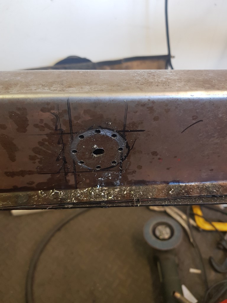

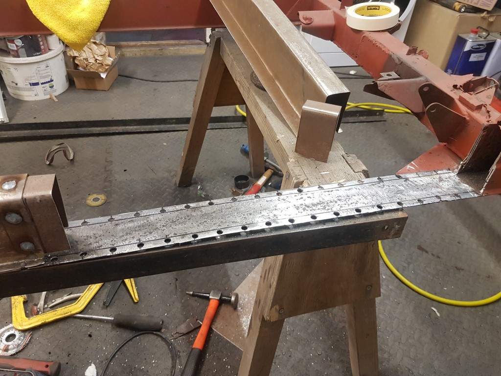

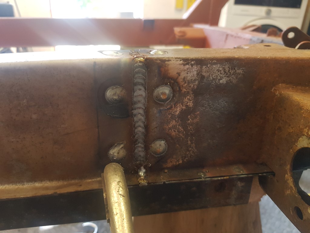

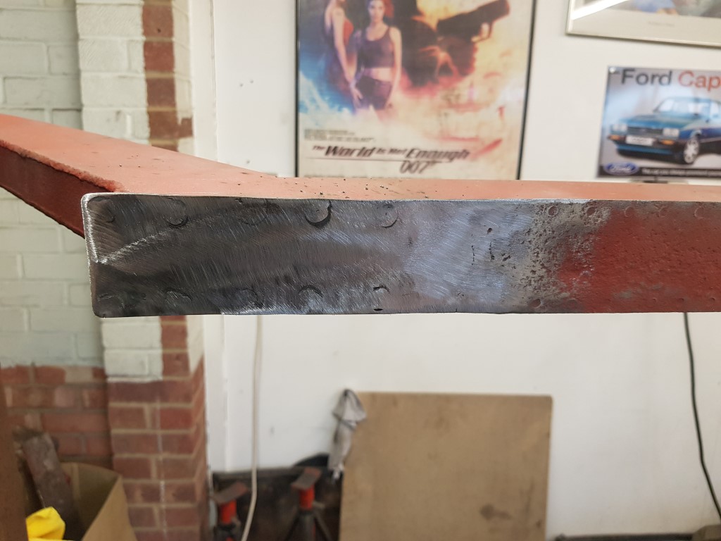

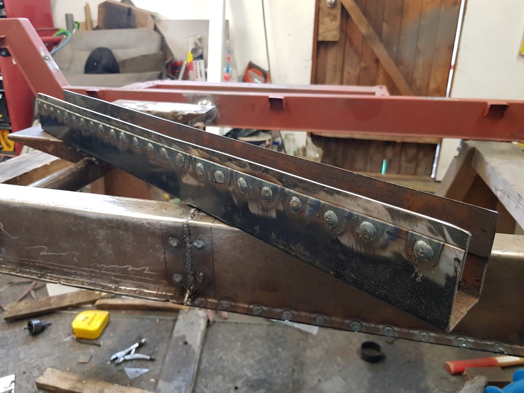

All seemed fine, so i then proceeded to drill the base plate so i could plug weld the new home made panel on, this is effectively the same was the original would have been made only when Reliant did it, it was spot welded
20200619_172056 (Medium).jpg (261.05 KiB) Viewed 10577 times
20200619_204603 (Medium).jpg (269.27 KiB) Viewed 10577 times
20200620_145950 (Medium).jpg (190.89 KiB) Viewed 10577 times

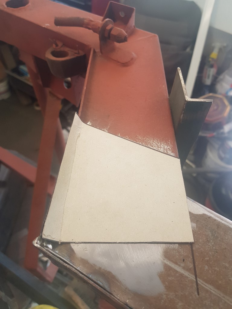

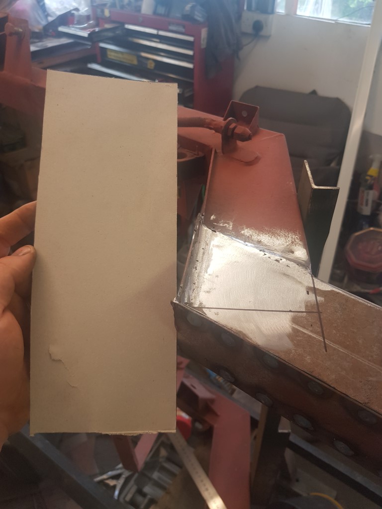

Then at the rear after welded the seams on, i did some CAD (cardboard added design) and made an over plate to overlap the join as per the original, this was also made with the lip on so it could be plug welded along the edge ...
20200620_115038 (Medium).jpg (162.29 KiB) Viewed 10577 times
20200620_115331 (Medium).jpg (166.15 KiB) Viewed 10577 times
20200620_144620 (Medium).jpg (185.42 KiB) Viewed 10577 times

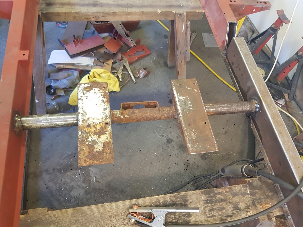

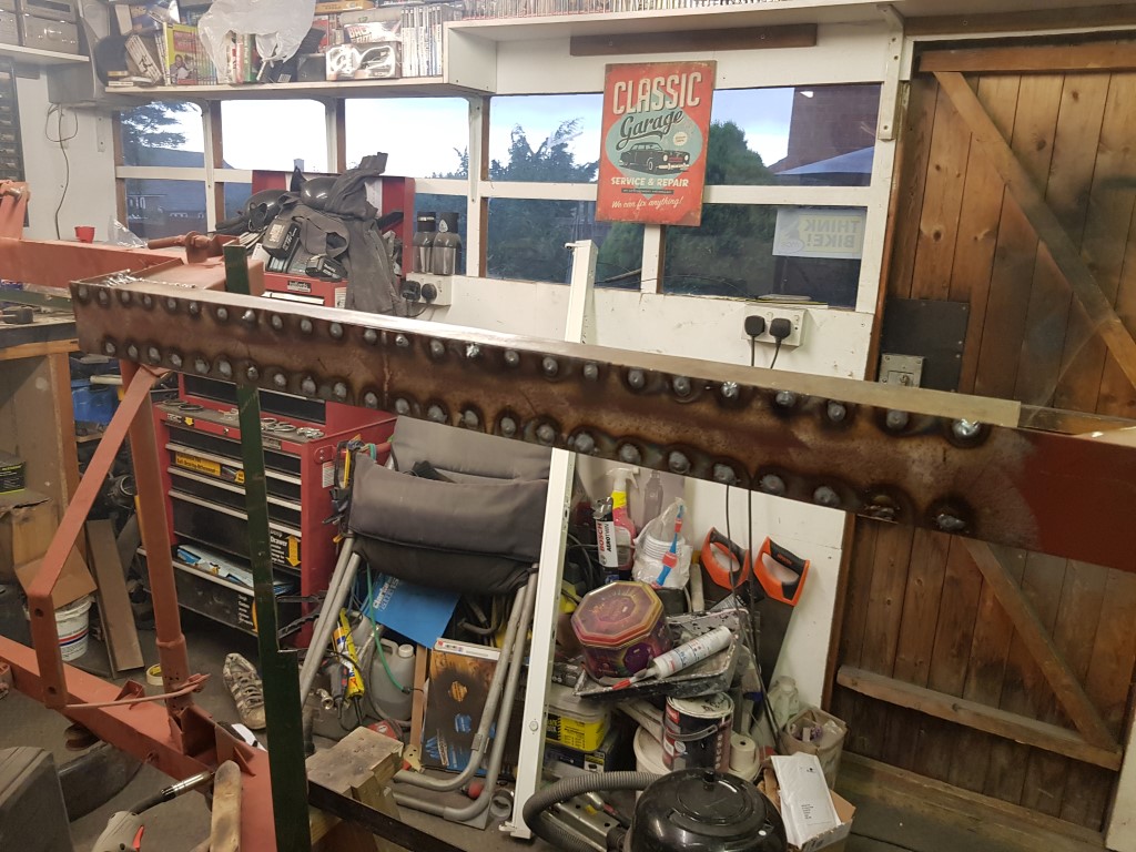

Now Before i went any further, i wanted to put that centre bar back in to keep everything in place and the dimensions right...
20200620_154450 (Medium).jpg (171 KiB) Viewed 10577 times
20200620_171755 (Medium).jpg (279.18 KiB) Viewed 10577 times

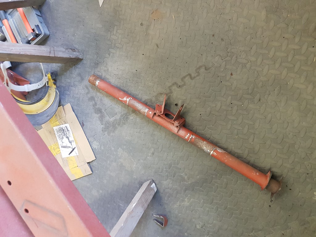

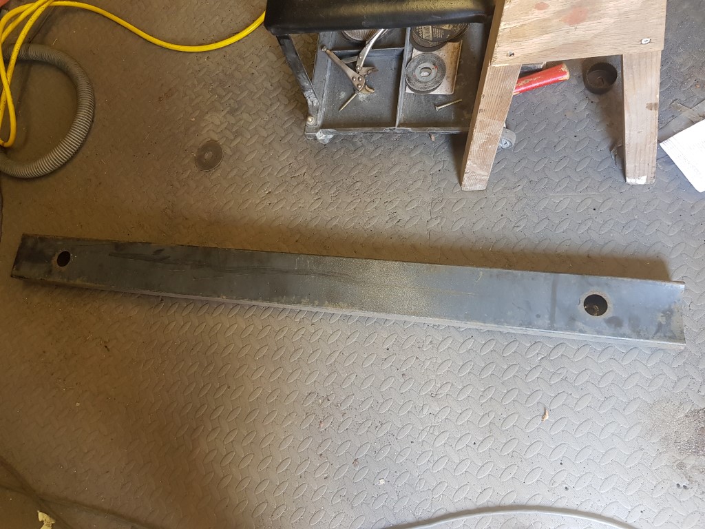

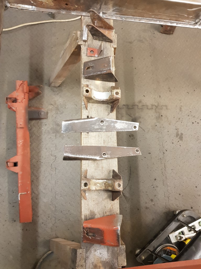

And you remember the original centre bar that i took out, that has now been cleaned up with the brackets removed and relocated to the rear of the chassis to replace a previous very badly repaired bodge...
20200622_172129 (Medium).jpg (252.82 KiB) Viewed 10577 times
20200623_123647 (Medium).jpg (155.12 KiB) Viewed 10577 times
20200622_175848 (Medium).jpg (186.6 KiB) Viewed 10577 times

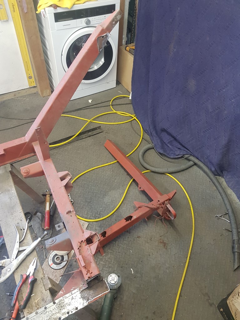

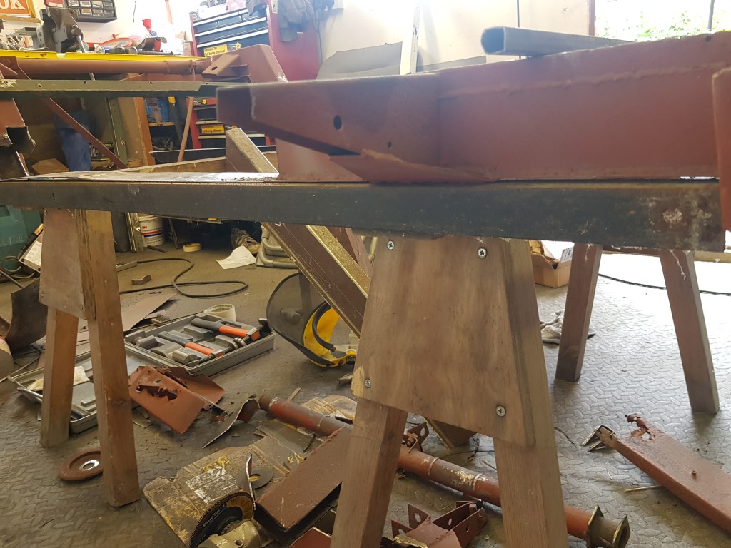

Right with that in i went back to the chassis rail to carry on cutting out more previous bodgery...
20200623_145703 (Medium).jpg (270.36 KiB) Viewed 10577 times
20200623_161910 (Medium).jpg (224.76 KiB) Viewed 10577 times
20200624_213956 (Medium).jpg (259.79 KiB) Viewed 10577 times

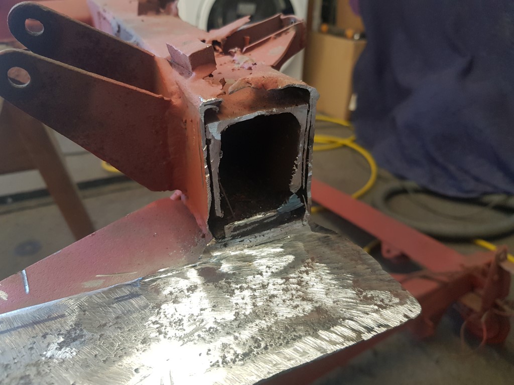

I then cut out the rotton but on mine ...
20200625_115304 (Medium).jpg (276.05 KiB) Viewed 10577 times

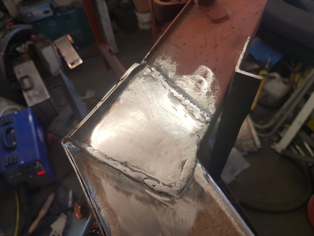

Top of the front section welded...
20200625_150033 (Medium).jpg (228.13 KiB) Viewed 10576 times

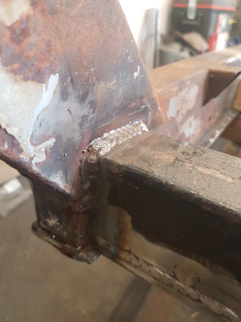

This was also plug welded underneath as per the rest, with this in, i could then come back to the final bit of the chassis rail, I made 2 sleeves which were fitted inside the box section and plug welded in place ...
20200625_171645 (Medium).jpg (278.93 KiB) Viewed 10576 times

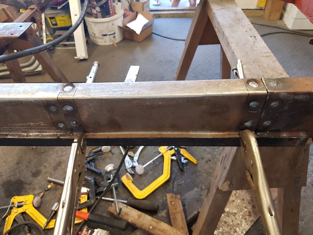

I then made another piece of chassis rail in the same way and cut this to fit in the gap over the sleeves, this was then plug and seam welded into place ...
20200625_172513 (Medium).jpg (237.87 KiB) Viewed 10576 times
20200626_110401 (Medium).jpg (160.42 KiB) Viewed 10576 times
20200626_111316 (Medium).jpg (187.65 KiB) Viewed 10576 times
20200626_122151 (Medium).jpg (191.32 KiB) Viewed 10576 times

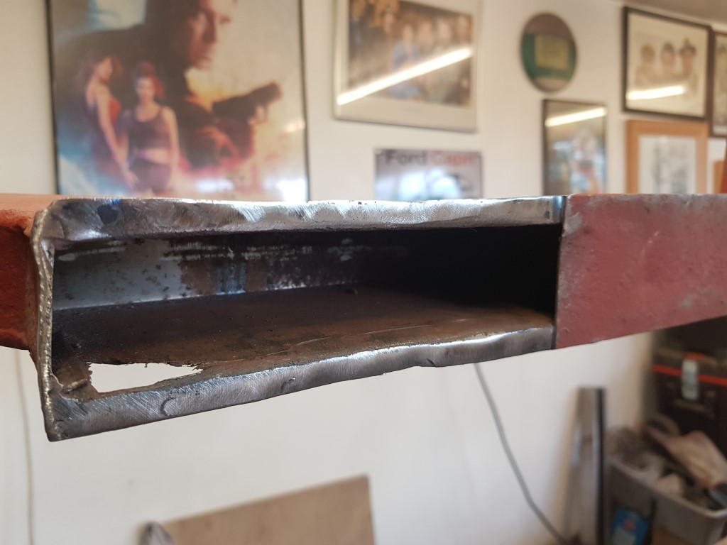

Right with that all in I turned my attention to the front A frame cross member, this again has had previous bodgery and had gone rotton again since, so needed replacing properly this time, this is what it was like inside, looks like someone had rammed a piece of box inside the original to try and strengthen it...
20200625_122455 (Medium).jpg (206.17 KiB) Viewed 10576 times
Now the original box section is a funny size mainly because its not proper box section is 2 C chaped pieces of metal joined together, this meant i couldnt source an off the shelf piece, now as luck would have it I saved My Cab rear X member from when I got rear ended last year, this turned out to be the perfect width but was too tall so i thought mmm, I could mod that, so this is what i came up with ...
this is as it started...
20200626_132212 (Medium).jpg (266.21 KiB) Viewed 10576 times

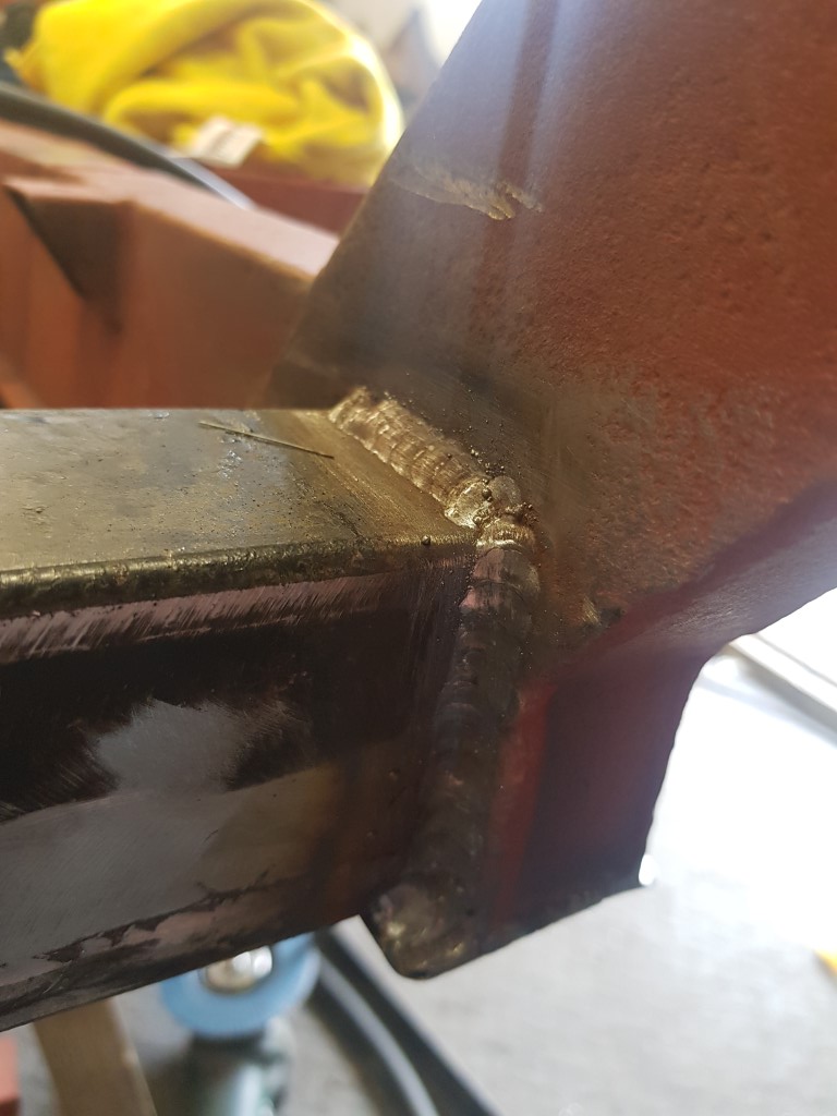

I then cut the top off and cut 2 strips out the sides to make it the right height ...

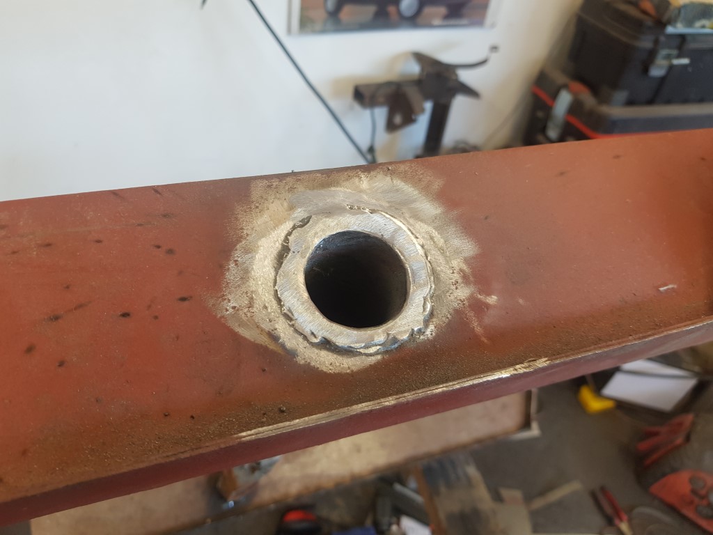

20200626_194331 (Medium).jpg (290.36 KiB) Viewed 10576 times

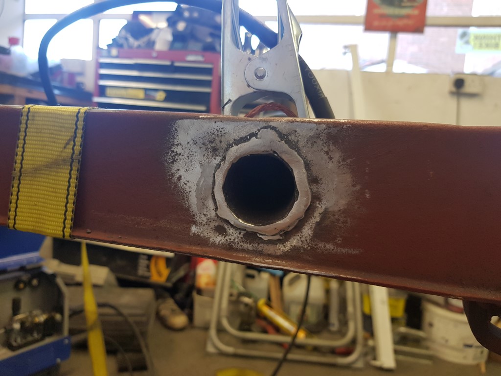

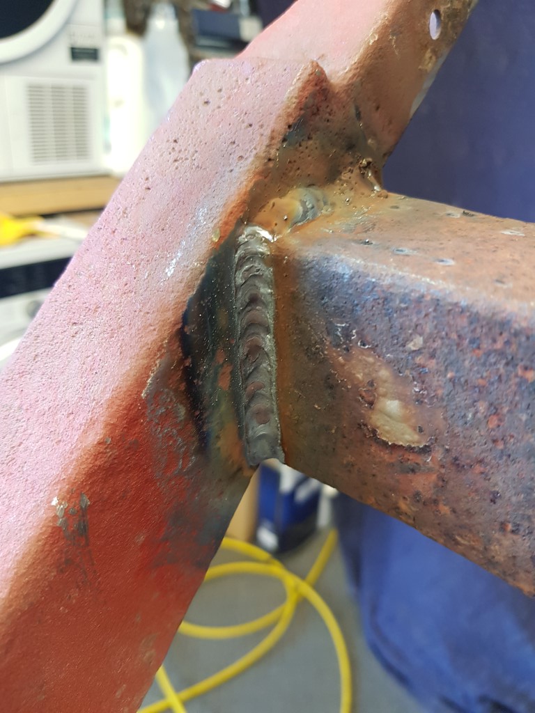

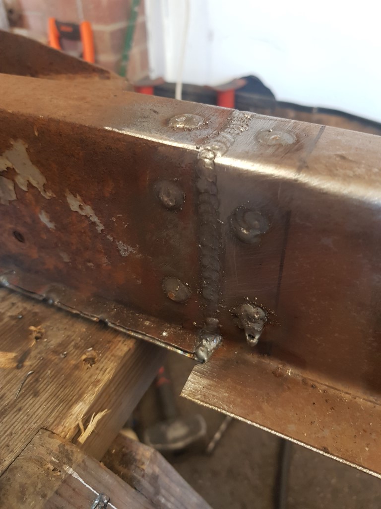

I then drilled holes and plug welded the 2 strips id cut out to each side to form an overlap for the top to sit over...
20200627_121852 (Medium).jpg (246.88 KiB) Viewed 10576 times
20200627_165608 (Medium).jpg (209.59 KiB) Viewed 10576 times
I then seam welded the top back on both side to give a very strong join...
20200627_170751 (Medium).jpg (294.4 KiB) Viewed 10576 times
20200628_123836 (Medium).jpg (177.04 KiB) Viewed 10576 times

So this is where im up to now...
20200629_185802 (Medium).jpg (255.5 KiB) Viewed 10576 times
Not finished yet but a hell of a lot more solid now, next job is to re attach this little lot ! ...
20200630_001321 (Medium).jpg (211.39 KiB) Viewed 10576 times
That where im up to, Stay well everyone !! :dance: :dance: :dance: :dance: :dance: :mrgreen: :mrgreen: :mrgreen:
