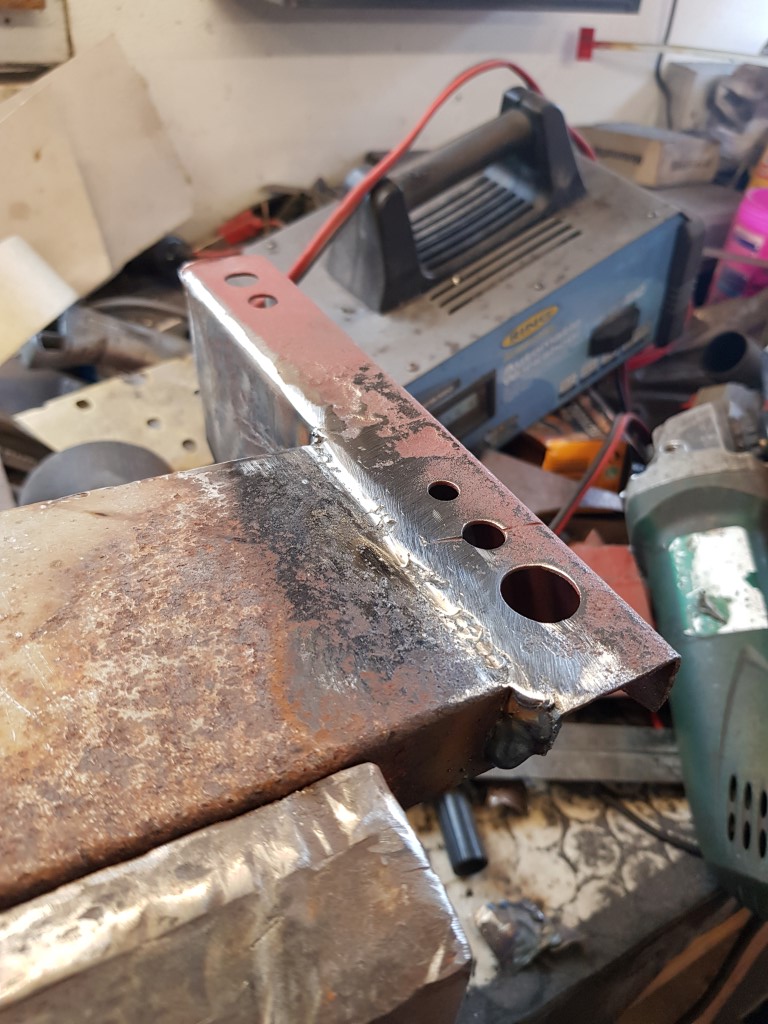

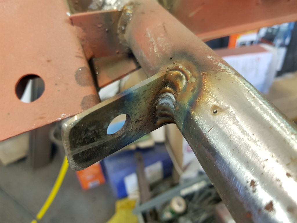

Right then, carrying on from the previous post of chassis work, the cutting and welding had carried on at a fairly fast pace...

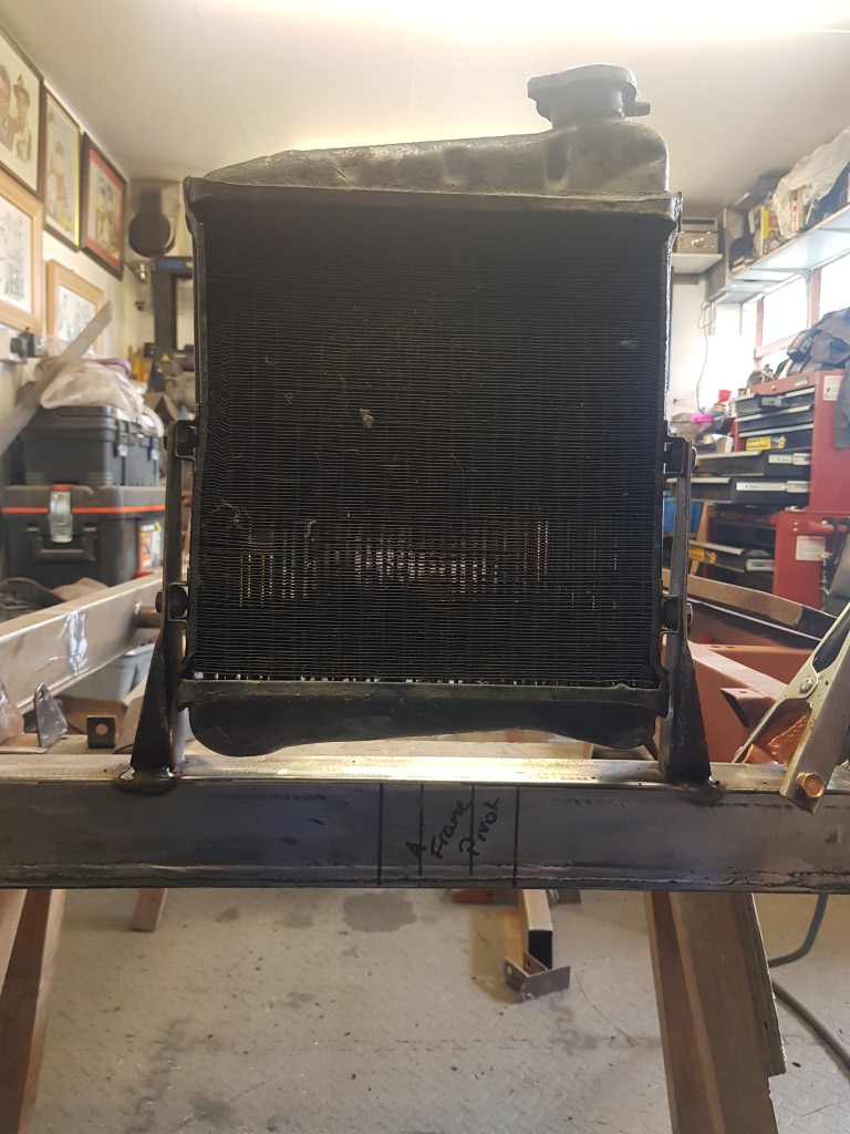

I carried on with the A frame X member brackets shown in the last pic of the previous post, starting with the radiator mounts ...
20200702_131805 (Medium).jpg (226.14 KiB) Viewed 10499 times

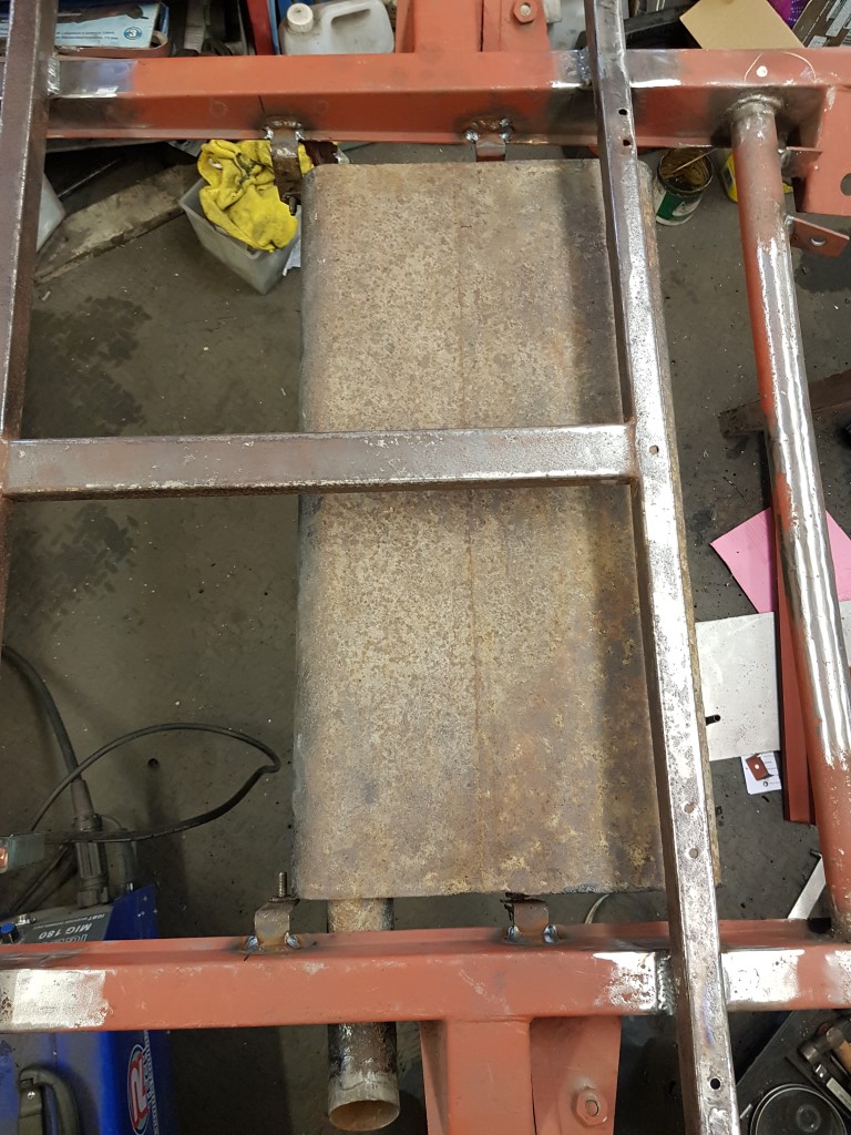

I then attached all the other mounts including the front A frame mounts...
20200702_140713 (Medium).jpg (337.29 KiB) Viewed 10499 times

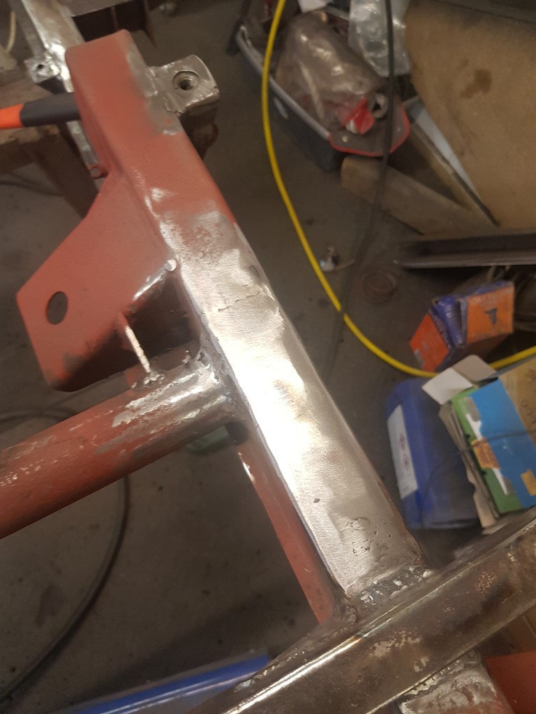

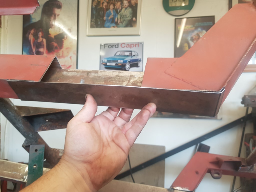

Now this was done i turned my attention to reinstating the drivers side outrigger and also repairing the passenger side one which meant repairing a section of the passenger side chassis rail too...
Il start with the drivers side one, i had 4 outriggers which i had to make 2 good ones from...

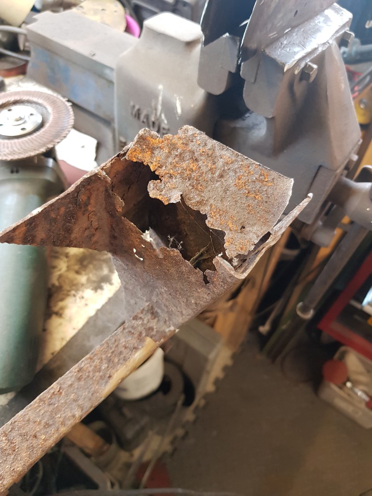

You can see in the following pic the condition of one end of the outrigger i had, not good, so I used the one good end off the original one i cut off to repair it...

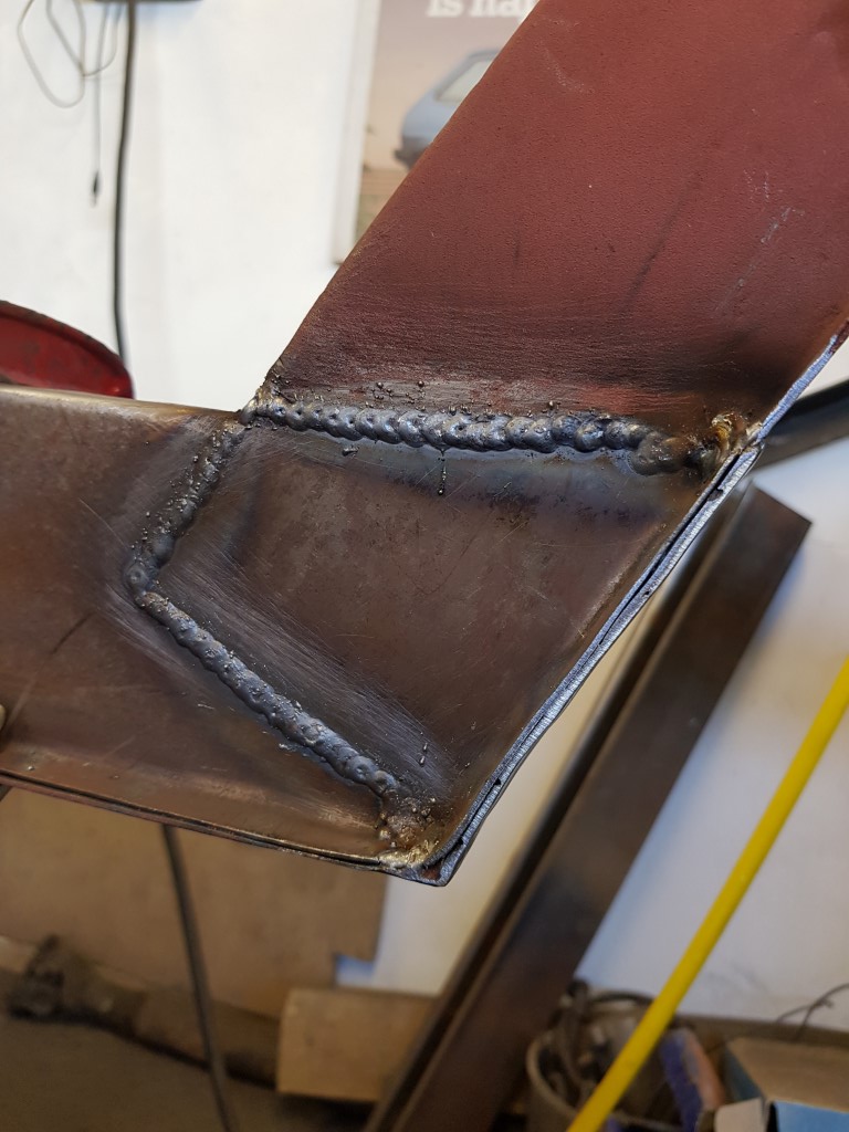

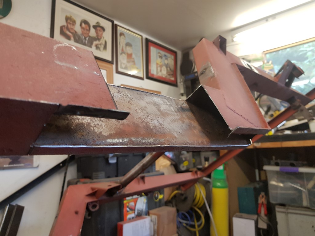

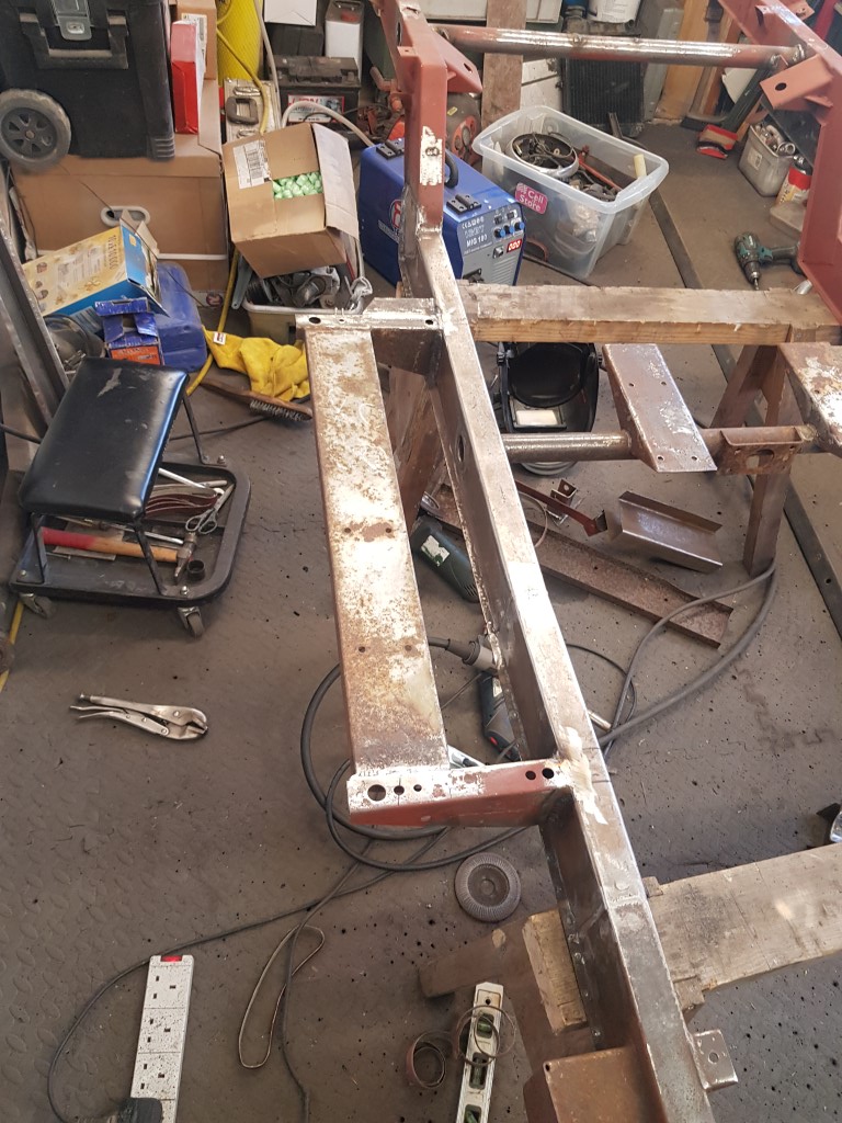

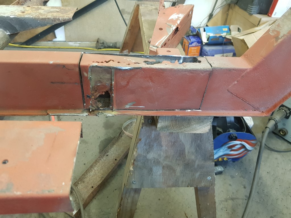

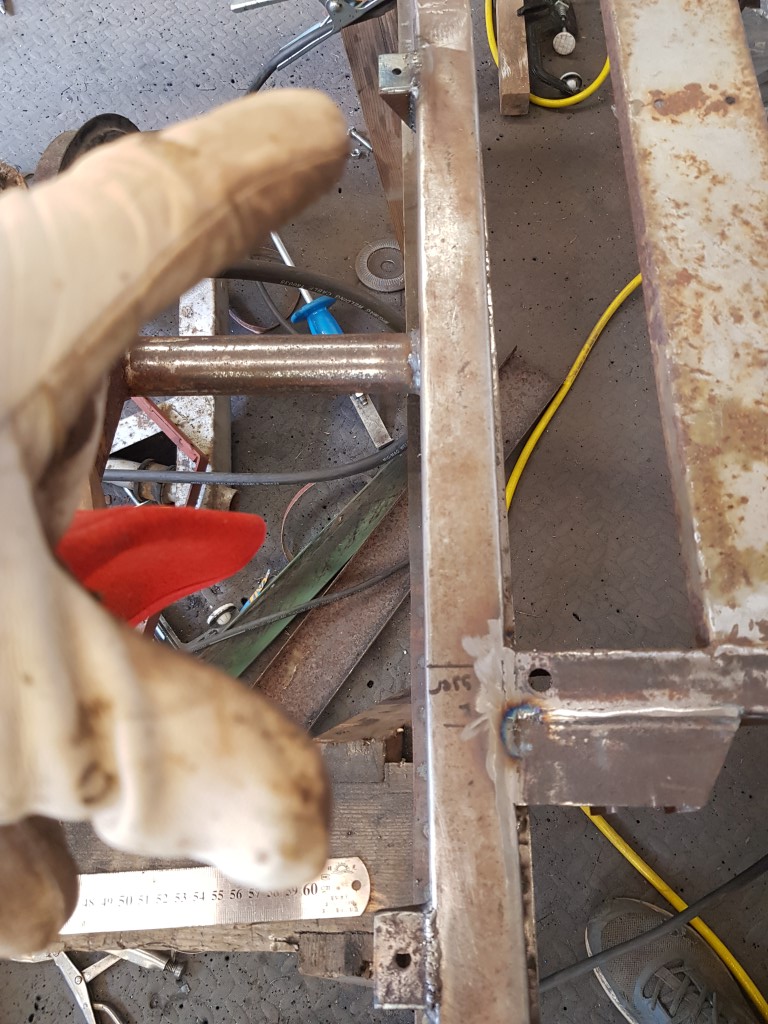

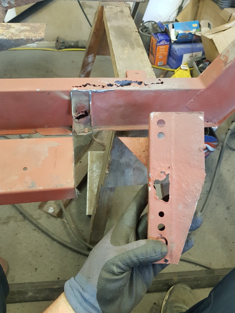

So then i started on the passenger side, again this outrigger was good at one end but not at the other and it had taken part of the chassis rail where it mounts to with it, so more surgery...
20200702_180805 (Medium).jpg (196.54 KiB) Viewed 10499 times

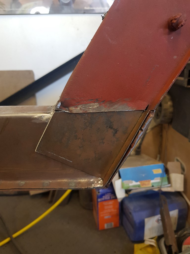

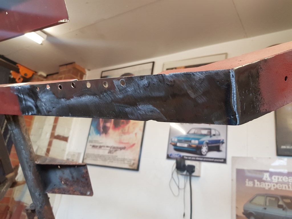

Now with that done, i could get back to the original outrigger repair, a new end was welded on along with the rear leaf spring hanger to complete this repair ...
20200703_212640 (Medium).jpg (244.14 KiB) Viewed 10499 times

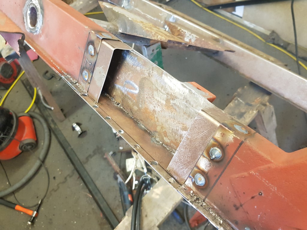

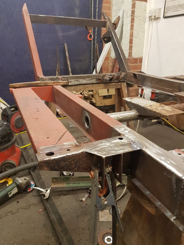

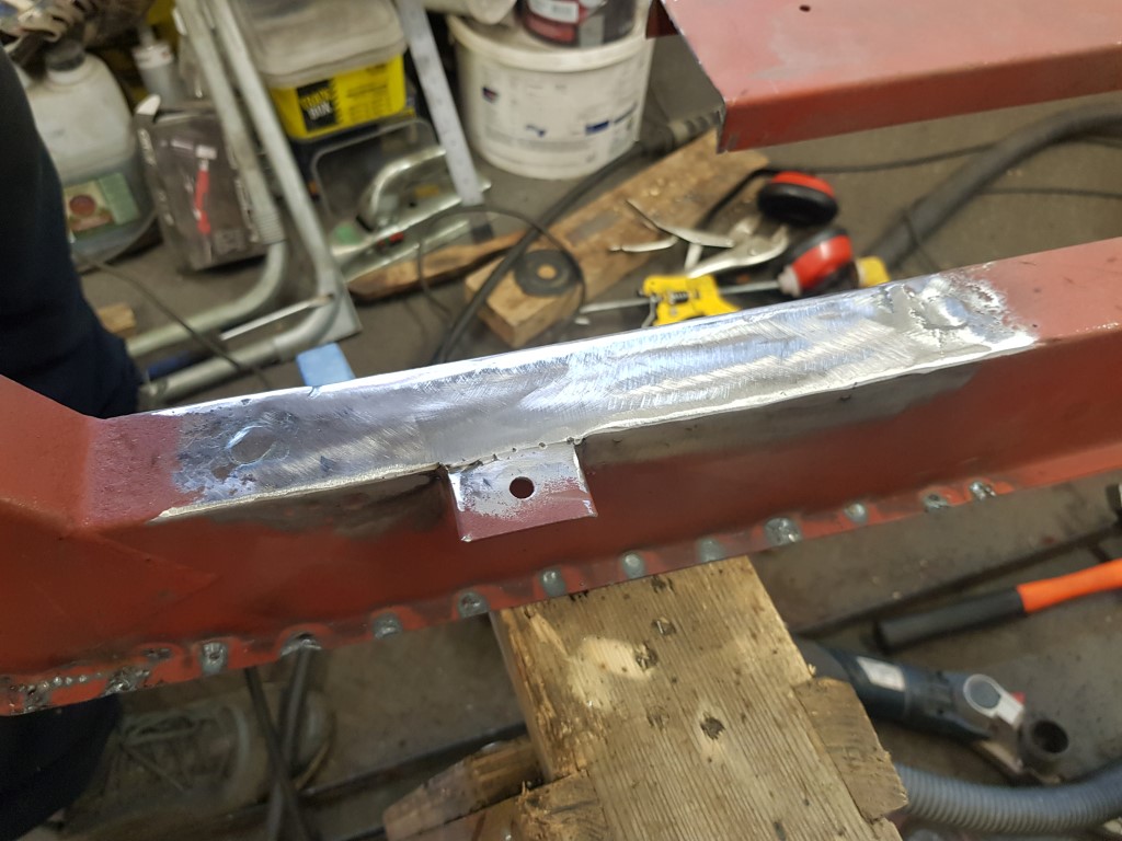

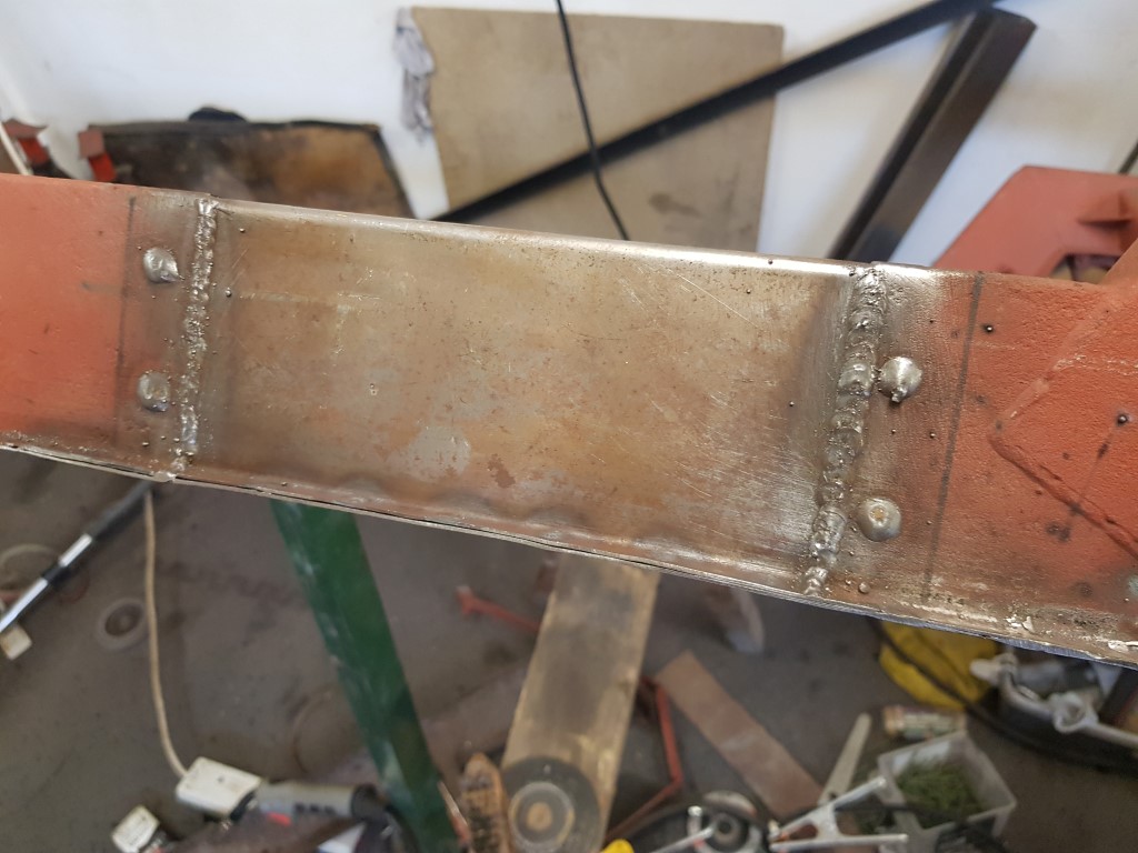

I then went back to the rear of the drivers side chassis rail to finish of the rear overlapping plate as per original, this couldn't be done before as i had a support brace in the way which is now removed...
20200705_122712 (Medium).jpg (177.13 KiB) Viewed 10499 times
20200705_163536 (Medium).jpg (199.64 KiB) Viewed 10499 times

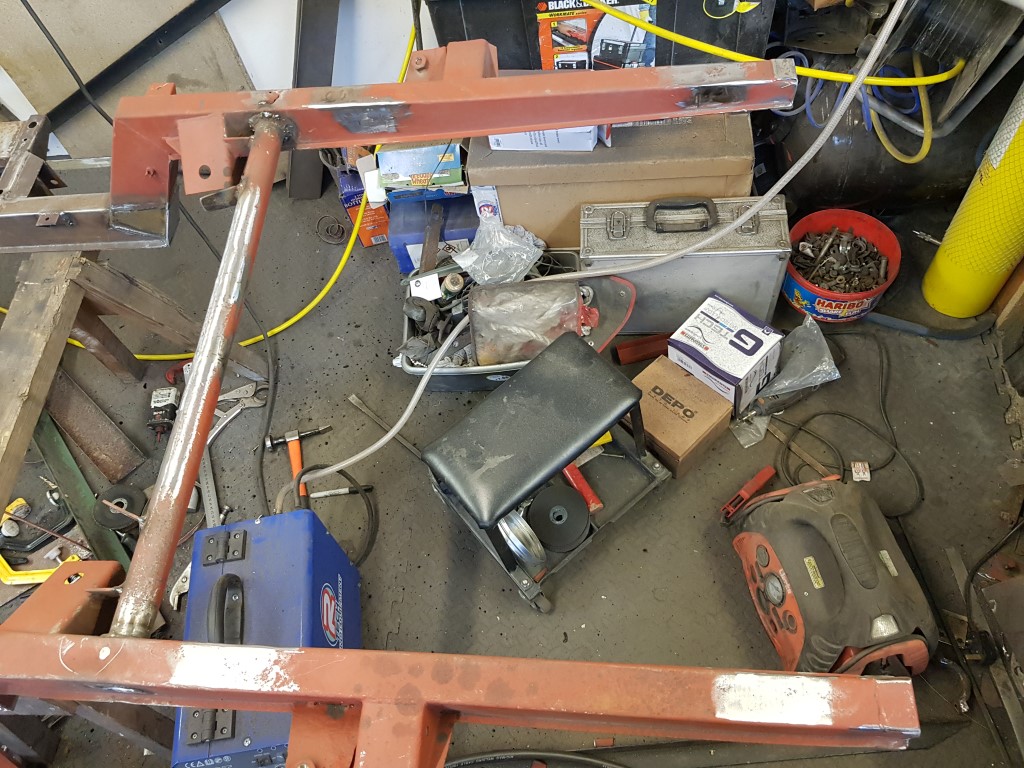

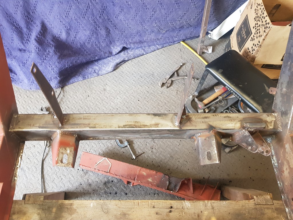

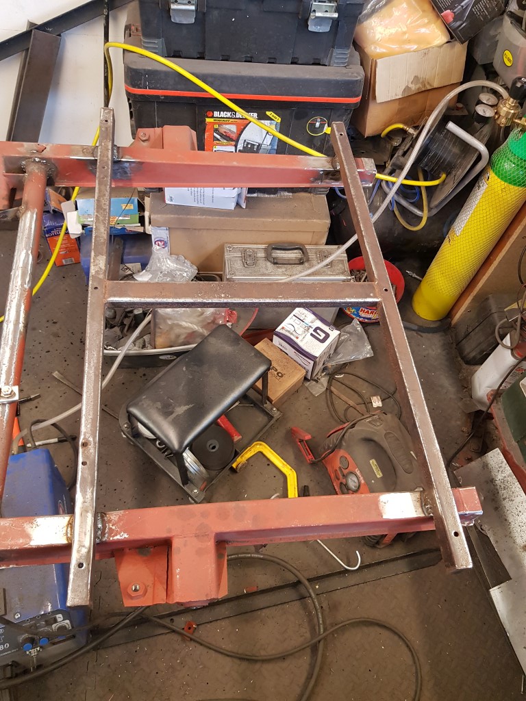

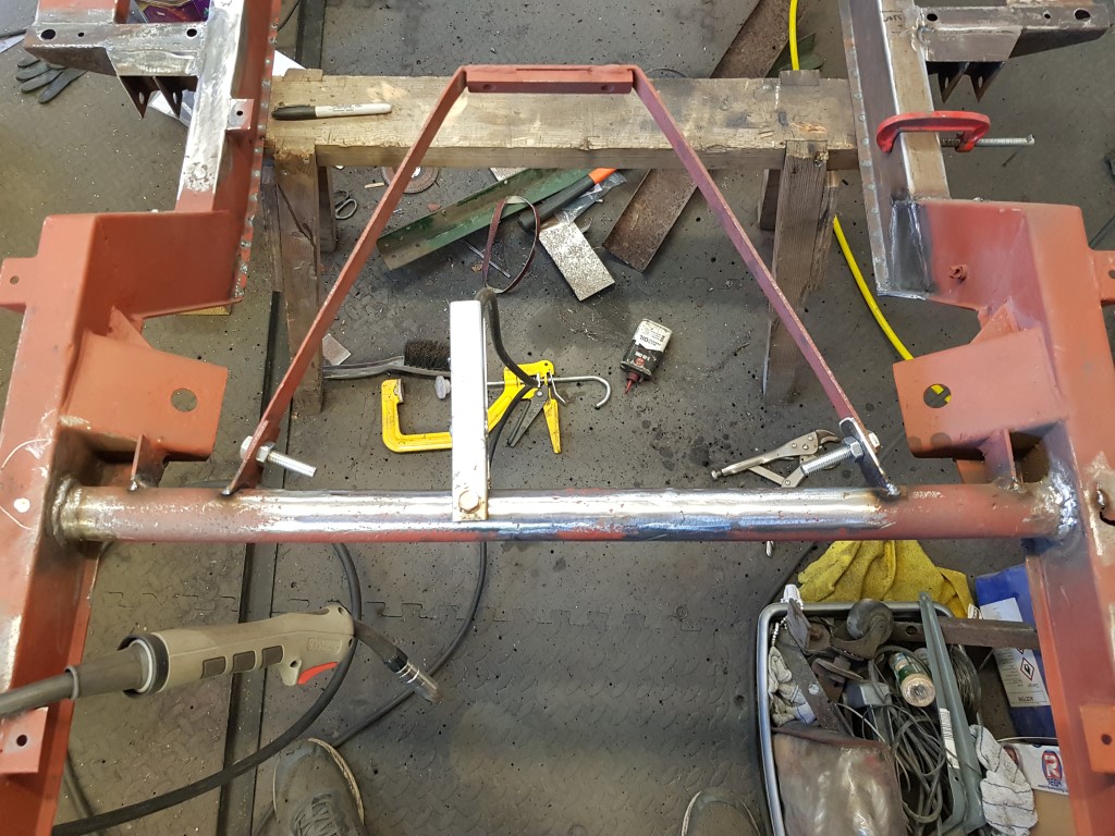

I also deleted the rear X member as only the saloon models had this and replaced it with the now repaired orignal van H frame ...
20200706_192459 (Medium).jpg (298.95 KiB) Viewed 10499 times
20200706_194816 (Medium).jpg (315.26 KiB) Viewed 10499 times

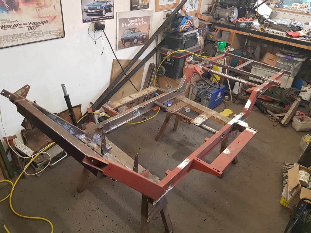

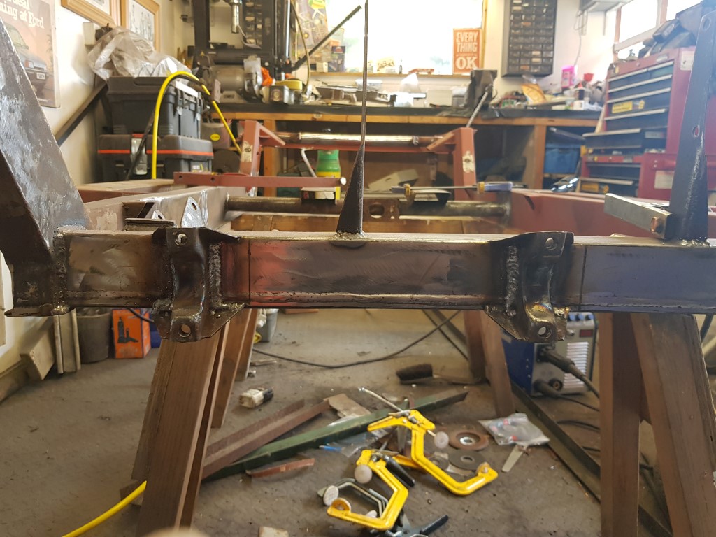

So the final welding repair was completed this afternoon...
20200709_145758 (Medium).jpg (183.16 KiB) Viewed 10499 times

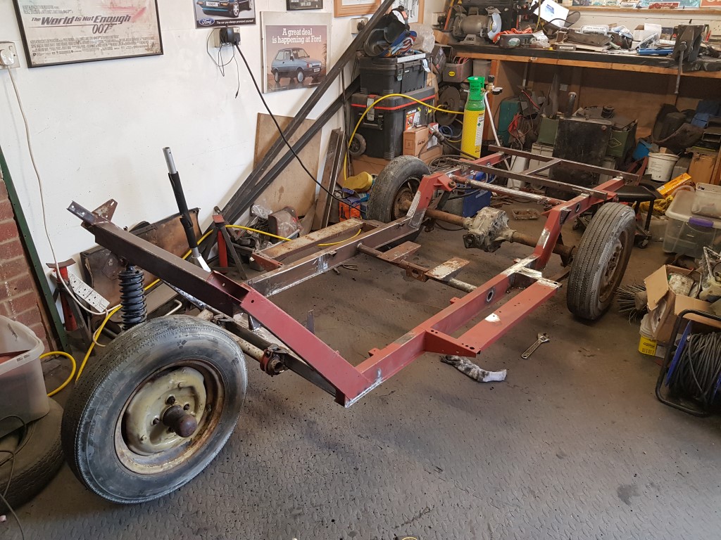

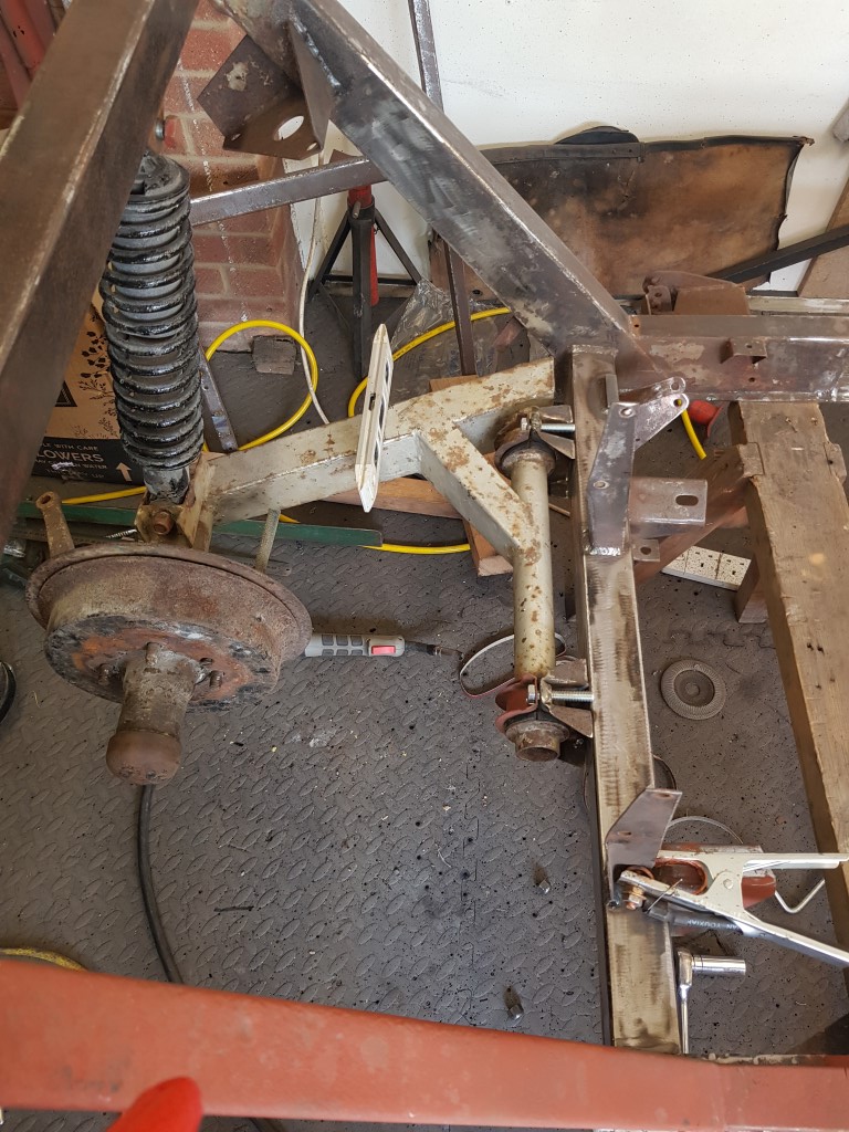

Here is the chassis now after many many hours of work, it doesn't look like much but when its galvanized and powder coated I'm hoping it will look good...
20200709_151737 (Medium).jpg (275.78 KiB) Viewed 10499 times

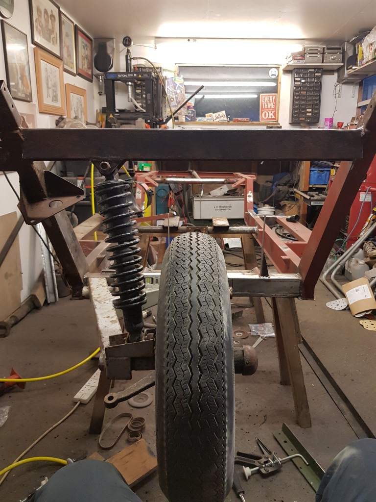

And finally, quite a moment, for the 1st time the chassis is on its very own 3 wheels !! ...
20200709_172557 (Medium).jpg (313 KiB) Viewed 10499 times
I got 3 wheels on my wagon and I just keep rolling along :dance: :dance: :dance:

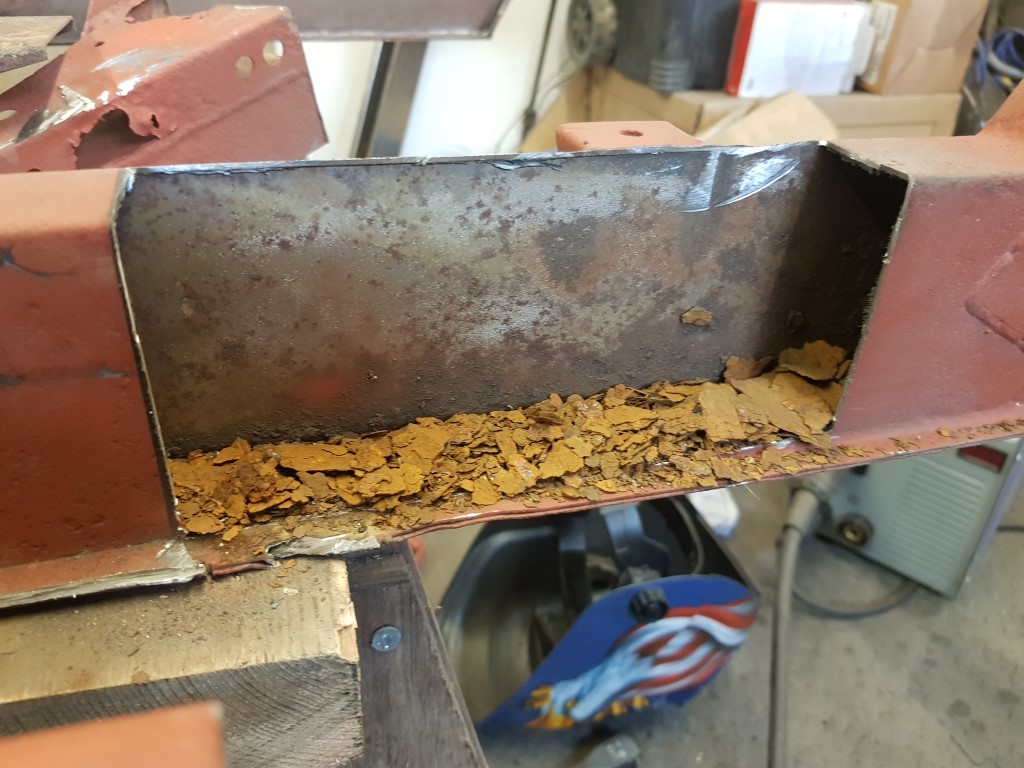

Mega job, (or should I say ‘Mec’a job’ ;) ) top work as ever, that looks great. Just one thing, why had someone been storing cornflakes in your chassis? :D

Thanks Me Julie, Ha ha yea that did look a bit like crunchy nut :lol: ;)

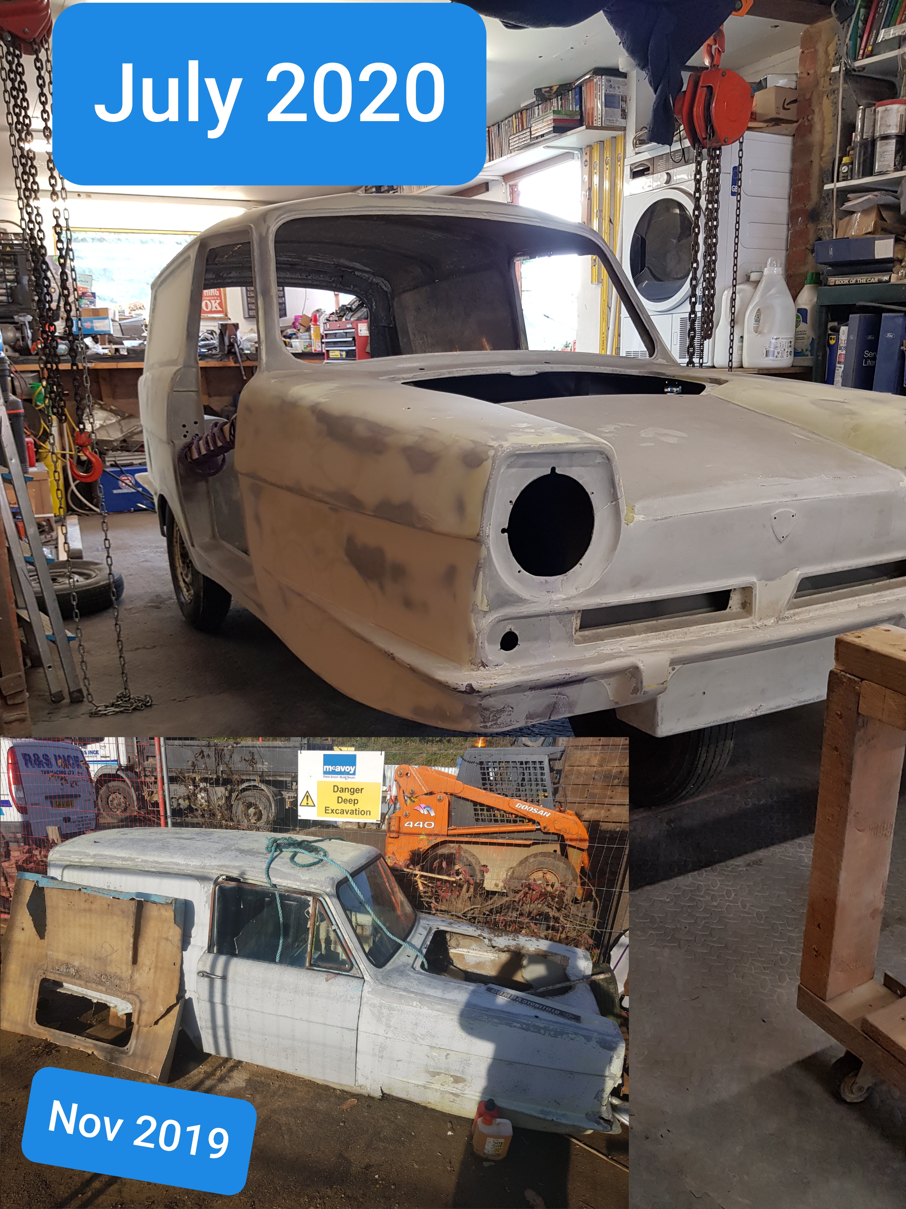

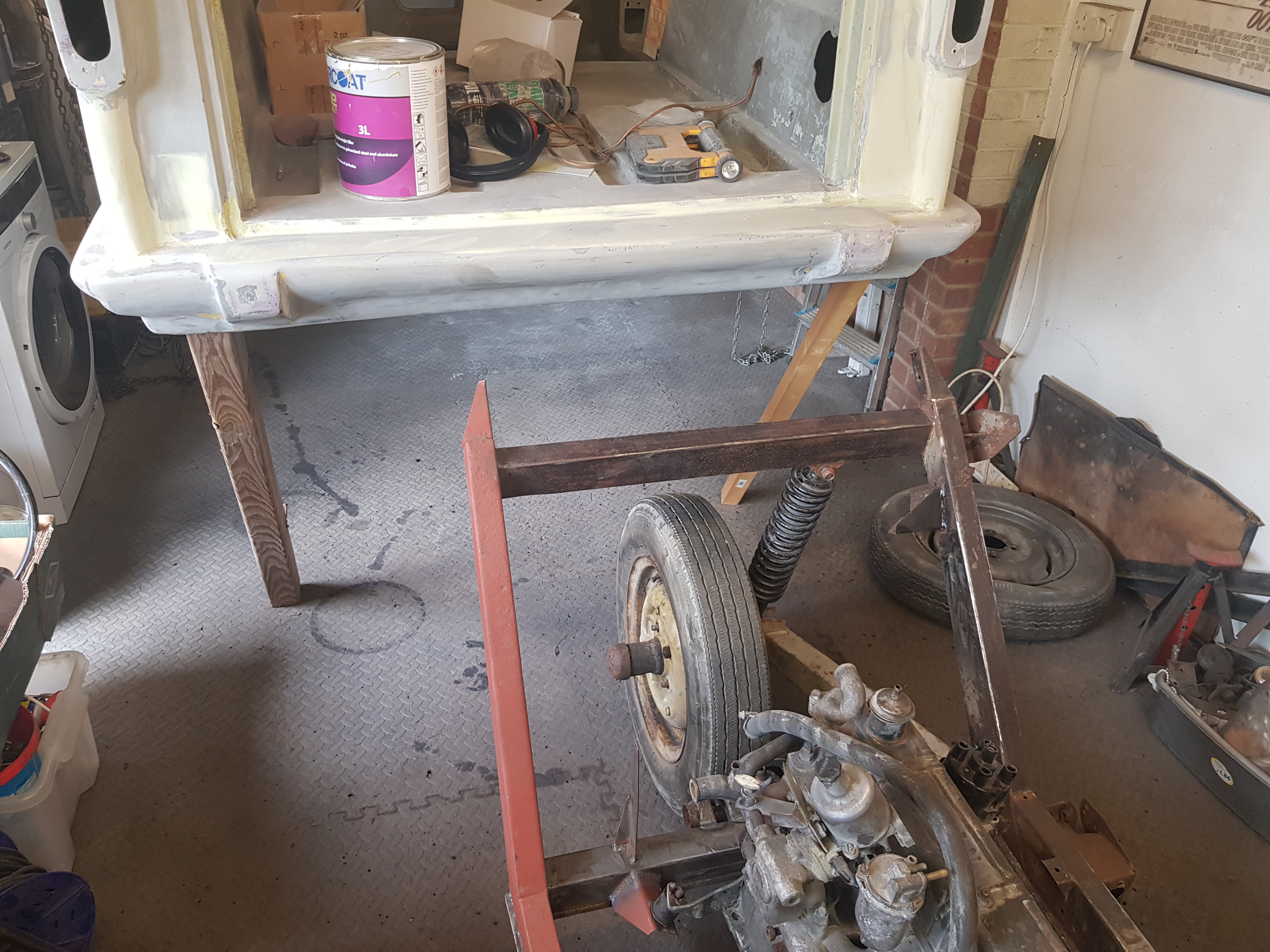

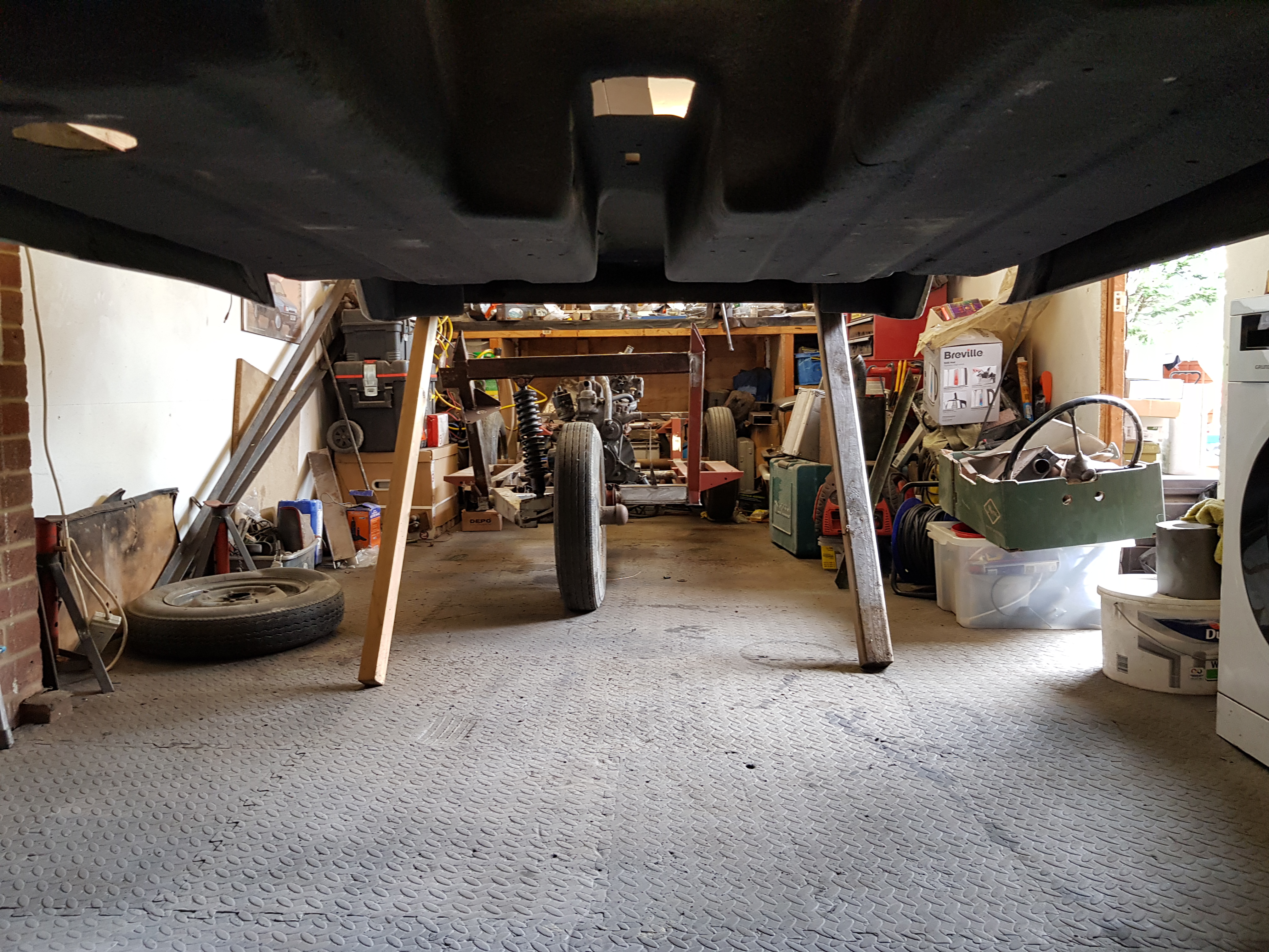

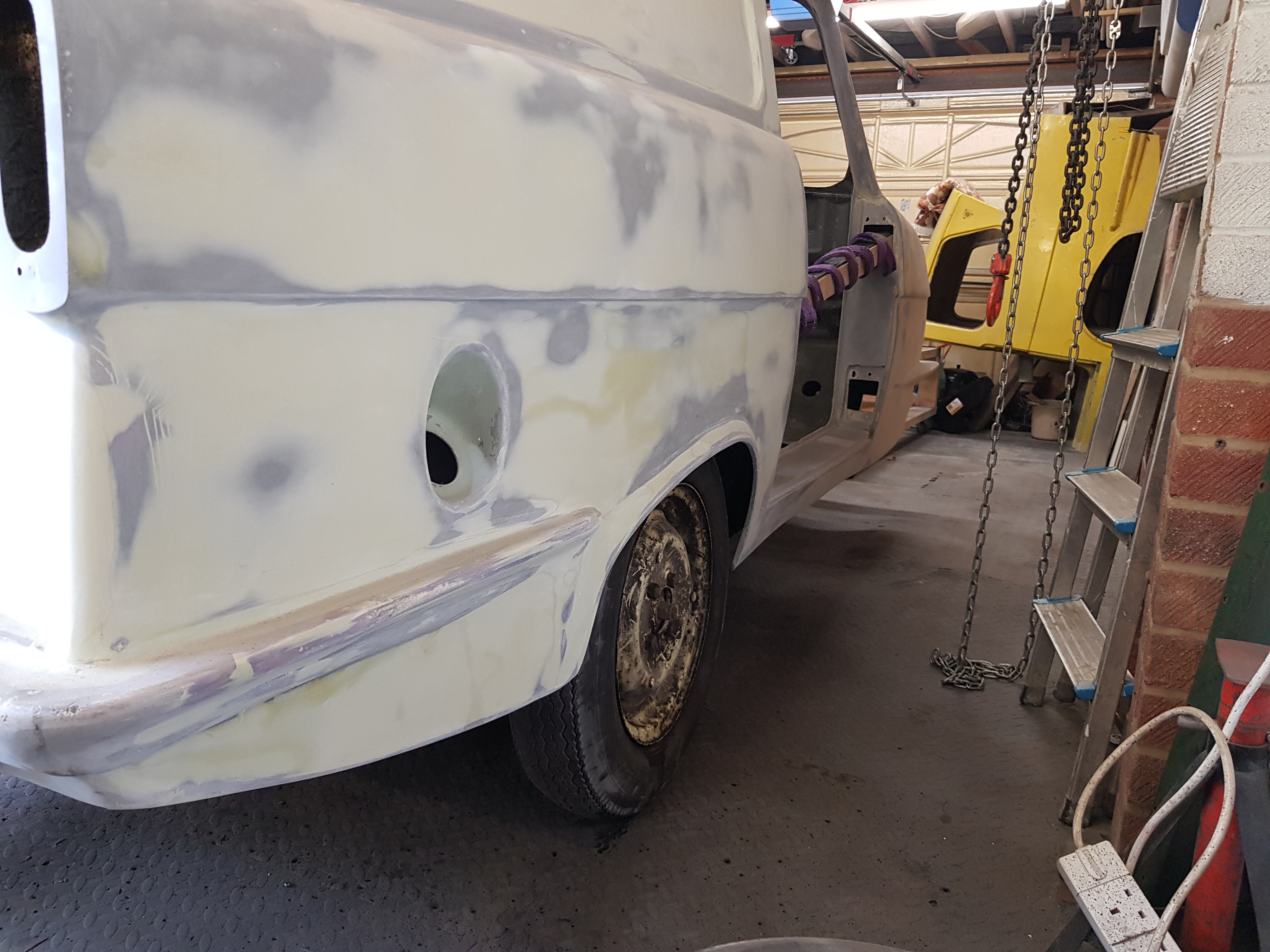

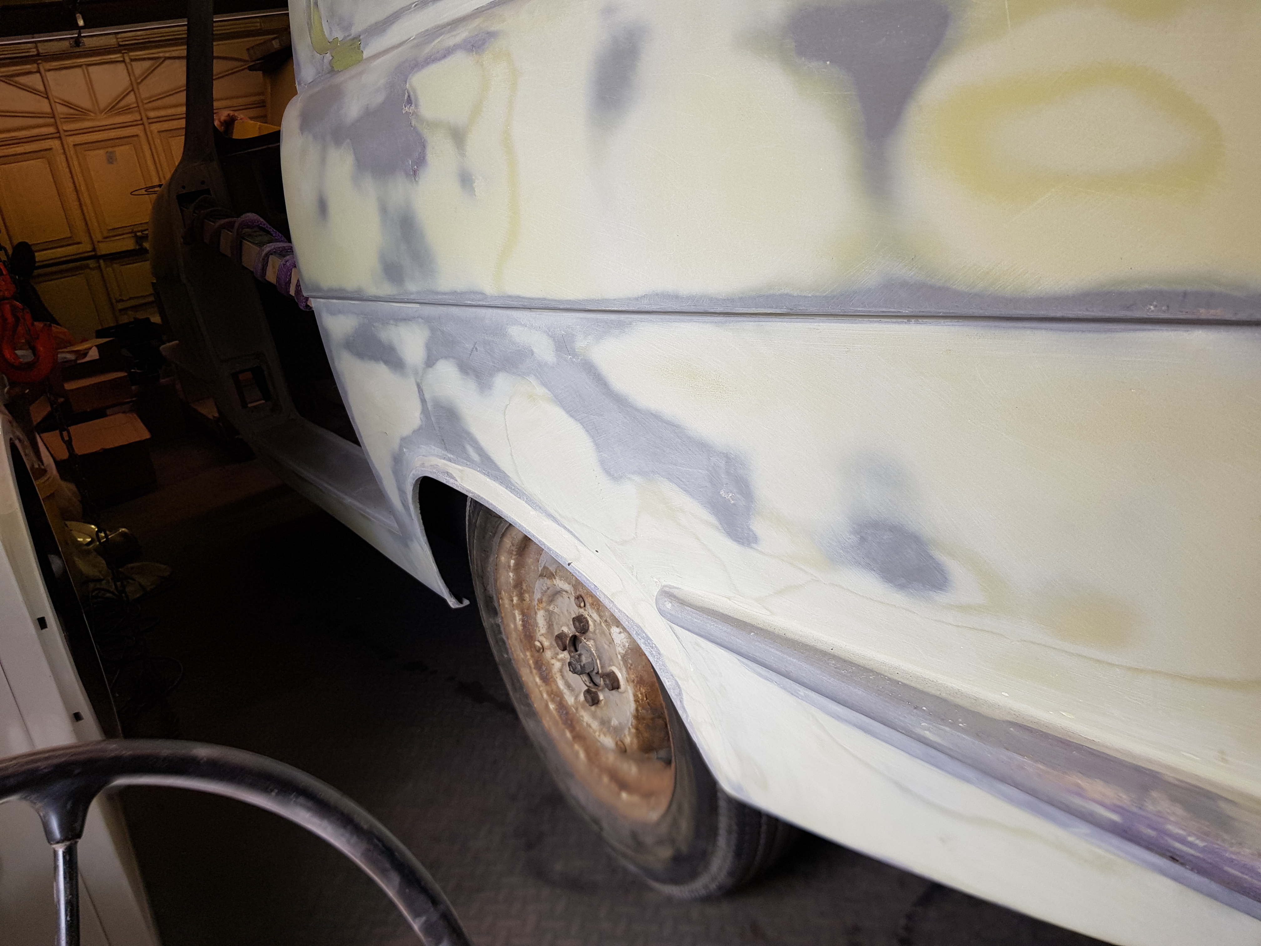

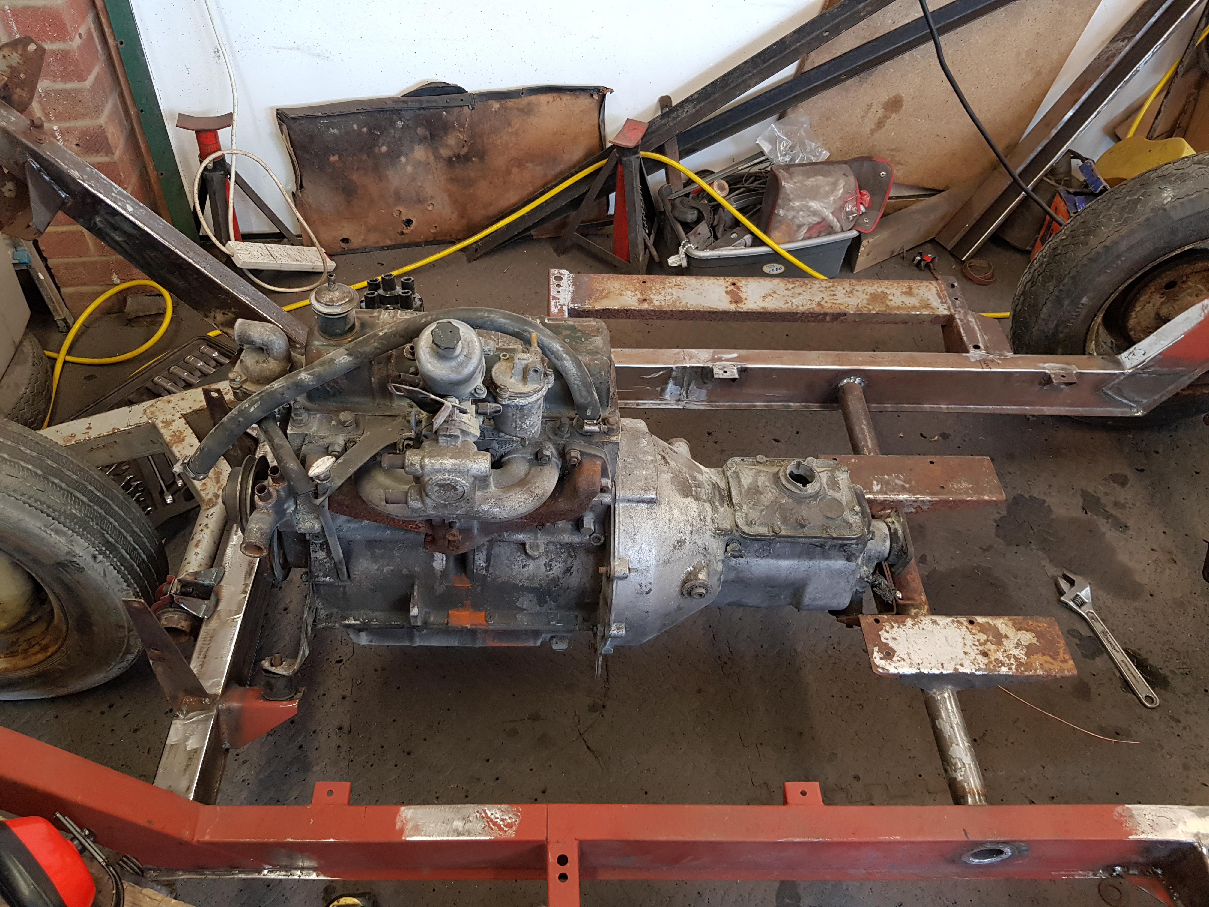

Little update for u guys, i got the engine fitted last wednesday which all fits fine...

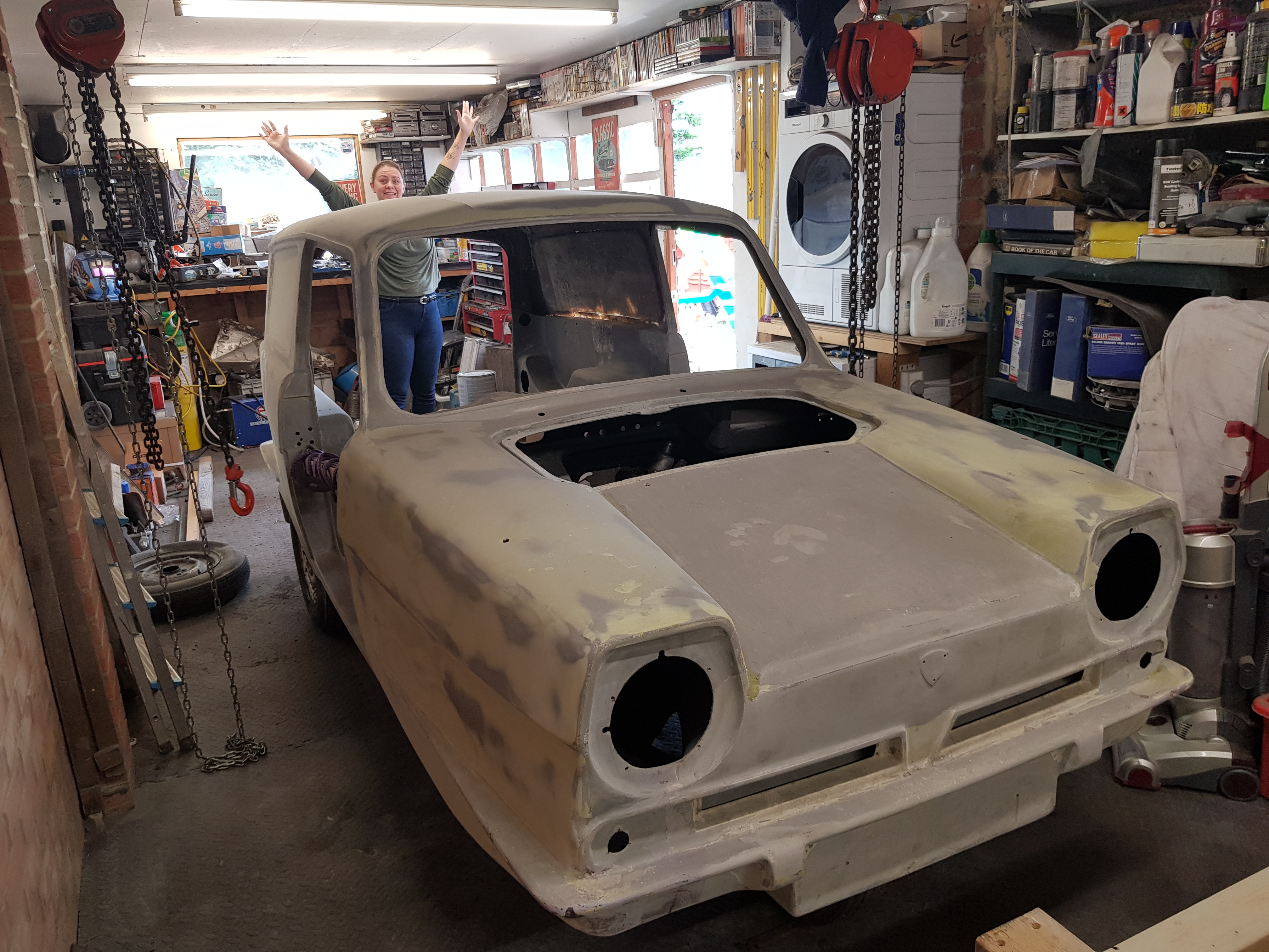

Then thursday was quite a momentus day in the restoration, the body and chassis met for the 1st time ! ...
So there we are, it all fits and the measurement between the rear wheels and arches are within 3mm of each other, as is the front wheel to either front wing, considering how many different repairs ive done and how many different parts have come together im well happy with that :dance: :dance:

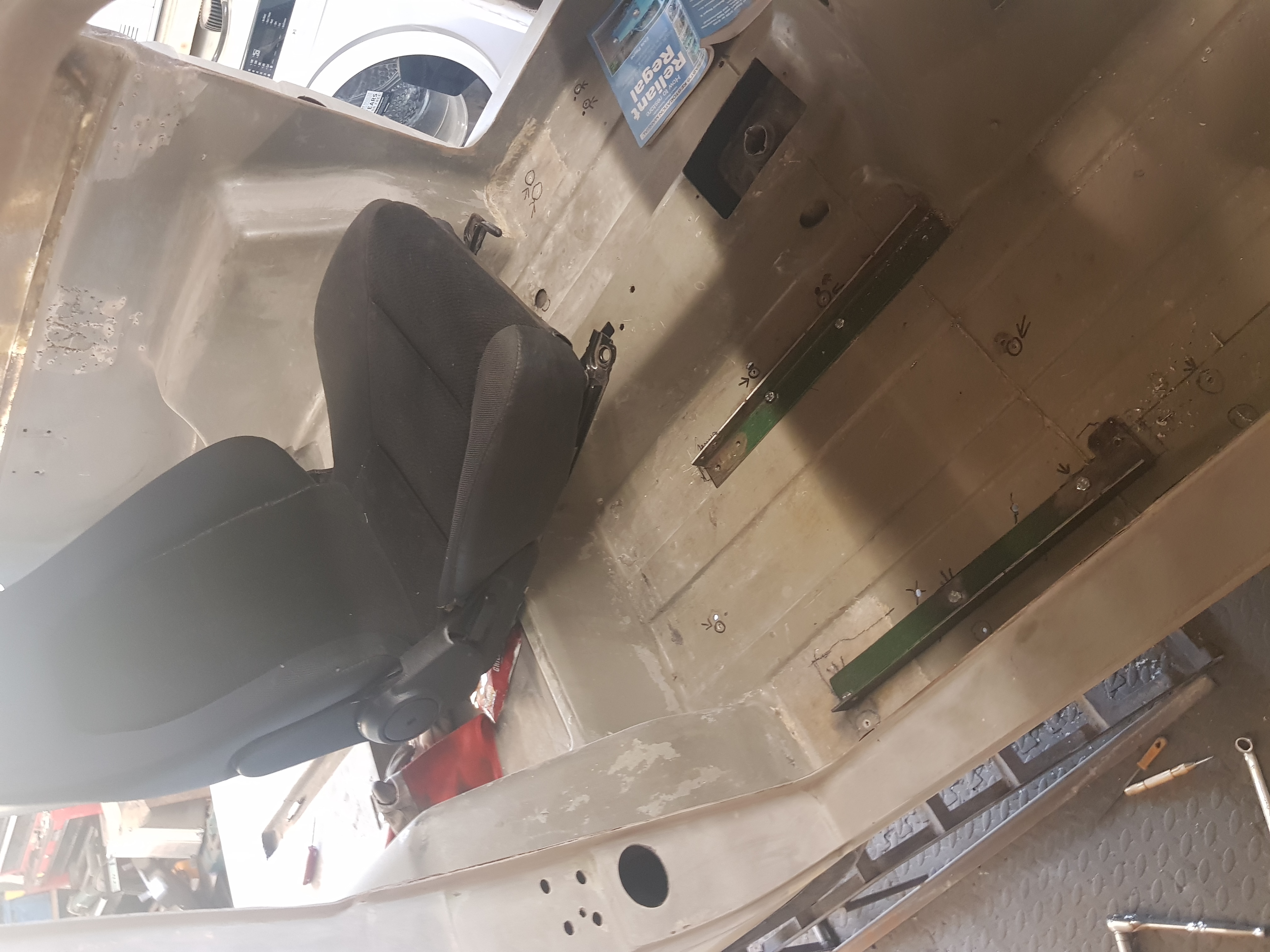

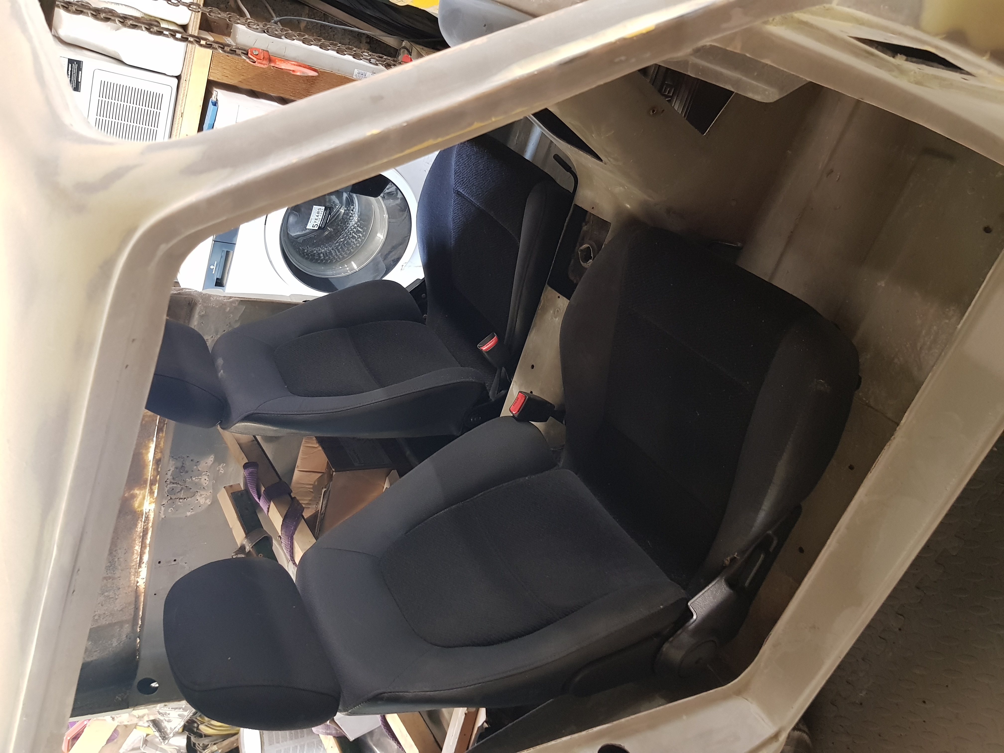

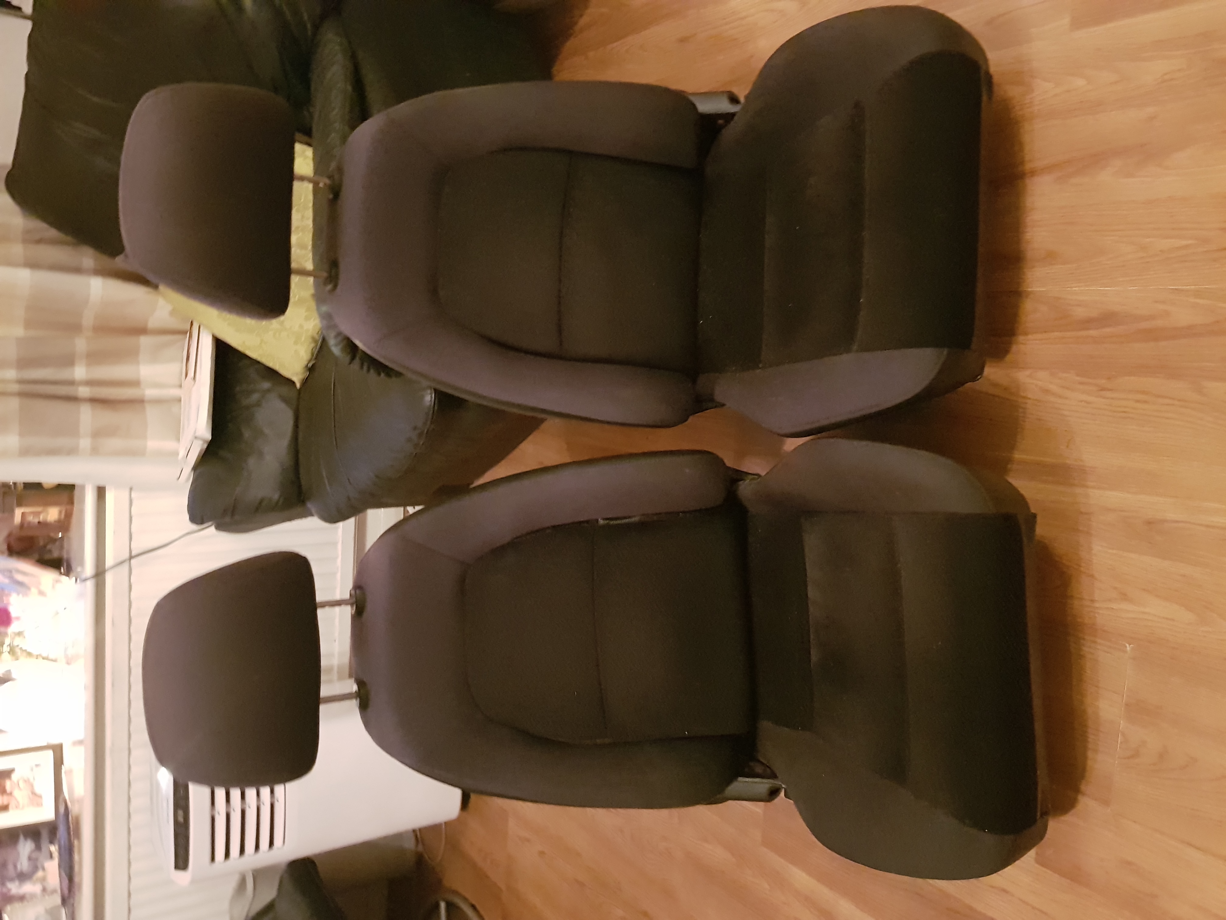

Also i got a facebook bargain with some Mk2 Mx5 seats for free ! ...
All i had to buy was the runners which i got for a tenner ! So ive been fitting these too ...

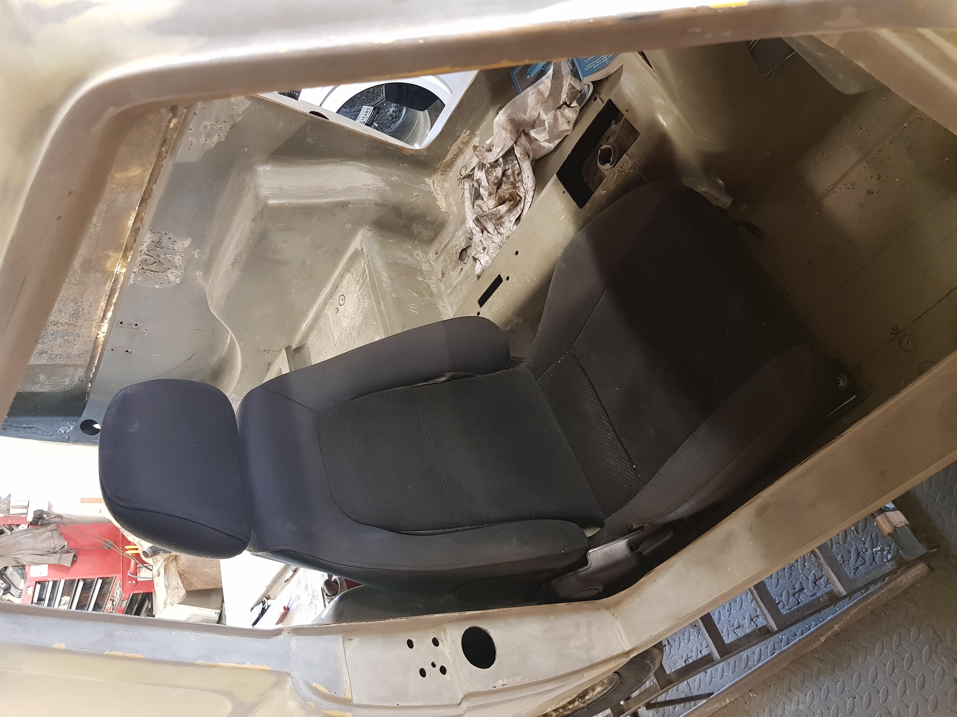

I made extra strentheners from angle iron for the seats to bolt too...
The drivers side is fitted so far ...
These are so much more comfortable than the original deck chair style seats and they fit nicely too, ive been drilling all the mouting holes back in the body too, now ive gota fit a few more things like pedals and the steering column to make sure they fit ok, then i gota take it all apart again ! thats it for now folks :mrgreen: :mrgreen:
