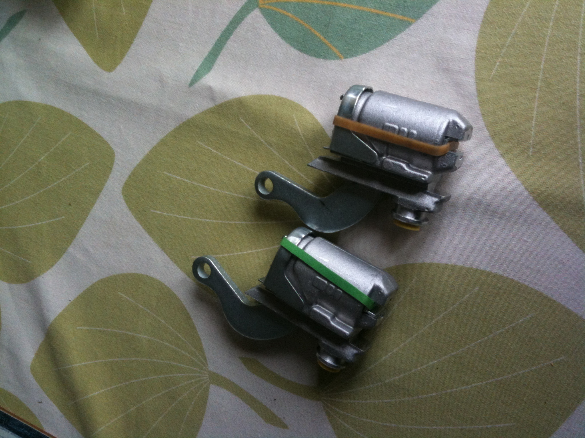

Firstly got a pair of rear wheel cylinders yesterday while seeing MEC at a local car show

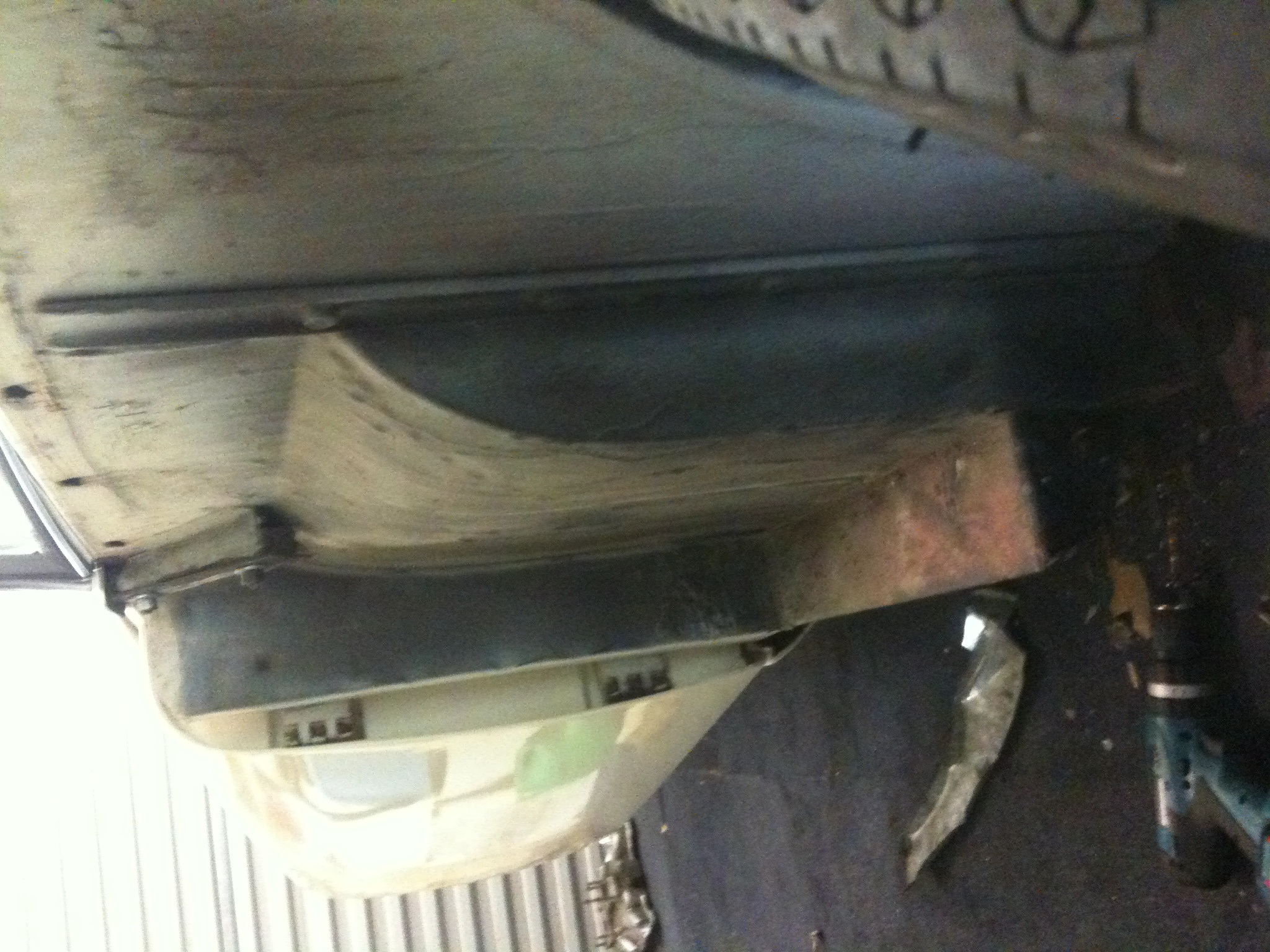

Took wing off nothing too bad here
Re: Mga restoration
Postby Darren C » Sat Nov 17, 2012 9:43 pm
Looks like you got a good one there Tone. :thumbsup:

Thanks Darren :) it's gone a bit where the floorboards meet the chassis and a bit on the inner cills but the boot floor is good and most of the structure is really sound .
Head gasket has gone but I'm hoping its just that and not a cracked head
