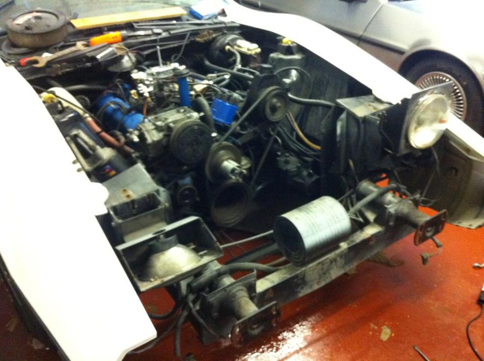

Hope you don't mind, I thought I'd post some updates on my Brickling re-furb progress.
So far I've:
Re-wired the doors / replaced the main rams and tested using an external pump to pressurise the tank.
Replaced a faulty Holly Carb with a new Edelbrock 600cfm quad barrel unit.
So today I started stripping down the front of the car to replace a leaking radiator and give me access to install an electric air compressor for the doors.

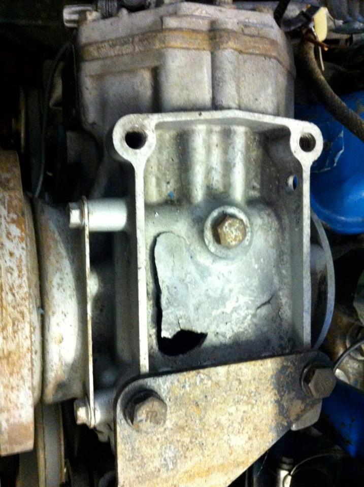

I think I've found the problem with the Air con too!

Postby Admin-bloke » Sun Dec 30, 2012 12:33 pm
That must have been one big bang when that exploded

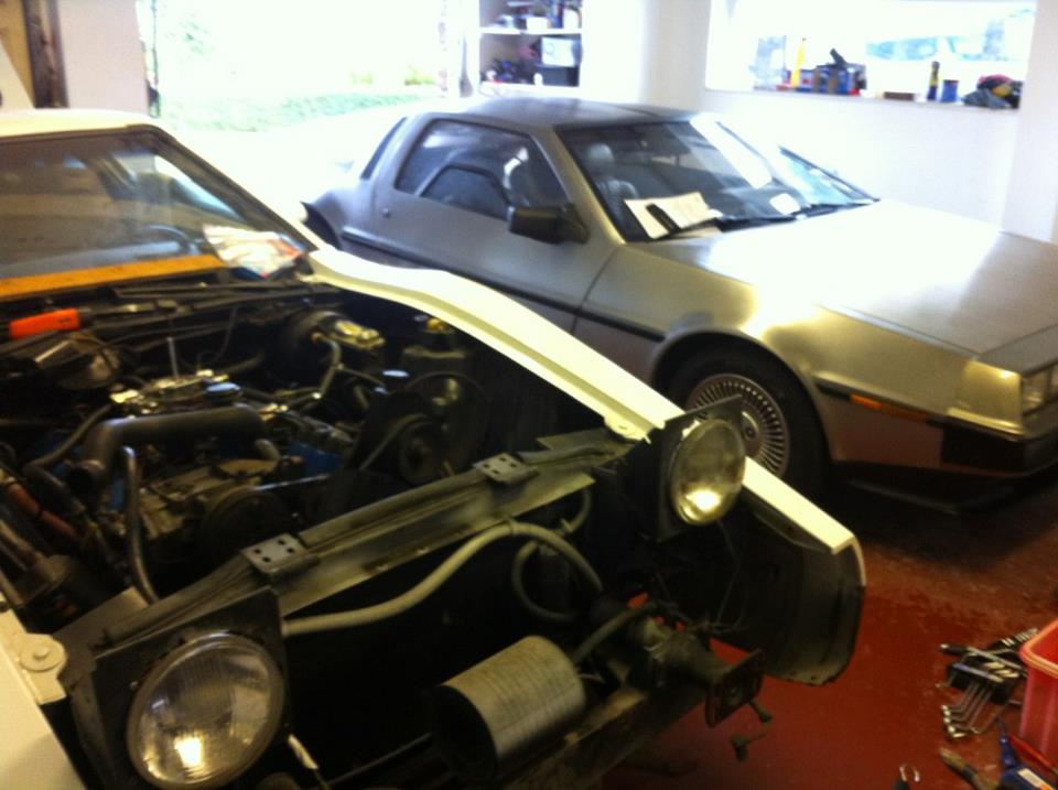

Postby Manxmann » Sun Dec 30, 2012 8:05 pm
Bastard child of a TR7 and a Delorean, with a bit of shower tray thrown in for good measure.
Bit more progress today.
Looks like a PO took a cutting torch to the light actuator mounts for some reason :roll:

Postby Darren C » Sun Dec 30, 2012 8:39 pm
Hi Manx,
Thats a York A/C Compressor. Looks like it's thrown a rod. Usually by running with no gas and lost oil. I'd check the pressure switch before you fit a new one.
Used on Astons...
http://www.ebay.co.uk/itm/ASTON-MARTIN- ... 5650a40154
and on my V8
I can refurb them if you want......but not your old one as it's definately had it!
Re: Bricklin progress
Postby Manxmann » Sun Dec 30, 2012 9:56 pm
And here was me thinking you where up for a challenge!
Thanks Darren, I'd been doing a bit of research myself. I suspect the damage was done many years ago, the car has was sat in a museum for the last 20years!
When it happened the PO, or should that be POS, removed a number of other air-con related items. At the moment I'm going to skip re-instating the air-con and concentrate on the big ticket items need to get her on the road.

Postby Dan 6511 » Mon Dec 31, 2012 1:01 pm
Headlight actuators are vacuum and look similar to my corvette ones.
Postby Manxmann » Mon Dec 31, 2012 3:57 pm
Hey Dan, they should they're exactly the same!
Turns out the hatchet job on the lights might actually be a factory recall, they did this to upgrade the lights on the original cars :shock:
