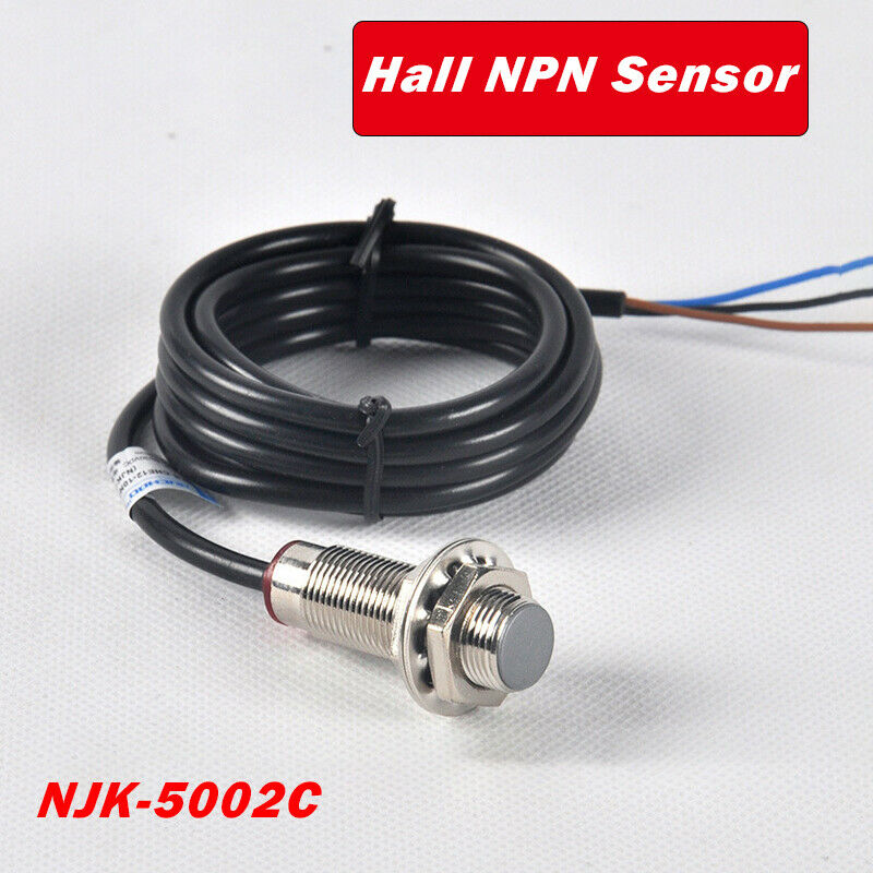

I then tried a Hall effect sensor, however it came without without instructions, I think I also fucked this. Trying different permutations of the live earth and switch wire means that I think I got it to work, (bulb lit when magnet is close by) now it doesn't.
Q2 Could excess current demand also fuck this??
Q3. Could shorting or similar also fuck it??
Can anyone tell meif I am barking up the wrong tree before I throw another few quid at a hall effect sensor??
Or any insight about how to wire it? 3 wires are Brown Black and Blue. Presumably blue is the switched, but with the magnet present will this supply the 12v fed into the sensor??

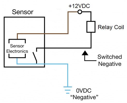

I just looked up your sensor and the max load is 150mA so make sure your relay doesn't draw any more than that. It is also an NPN sensor which means the negative is switched, so wire as below:

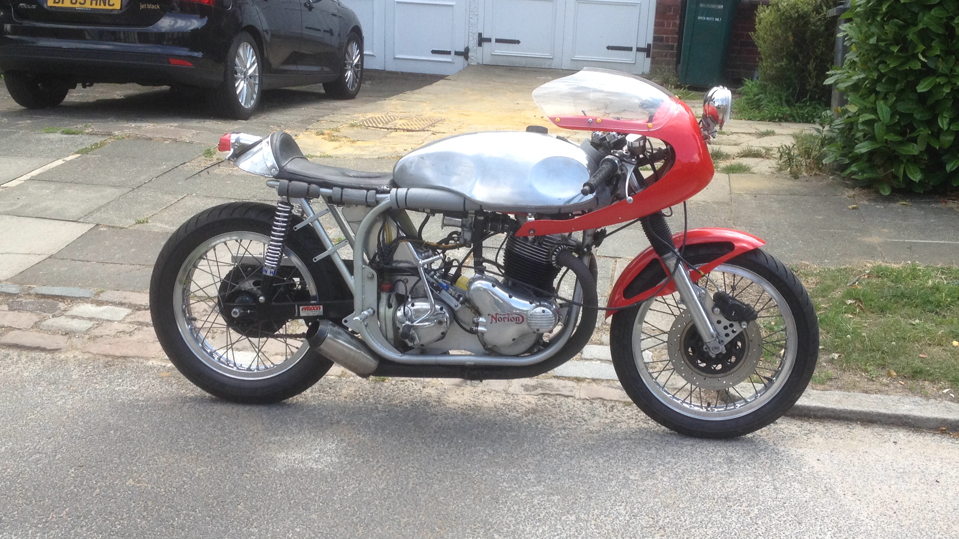

Nope, I have late nights in a shed and not enough sleep. You modern motorcycle riders take it for granted that there are no puddles under your bike if it's left for a week!!

Postby andyd » Mon Sep 16, 2019 9:12 pm
In fact you can see the tap and mk1 microswitch on the oil line between the oil tank and crankcase in that pic...
