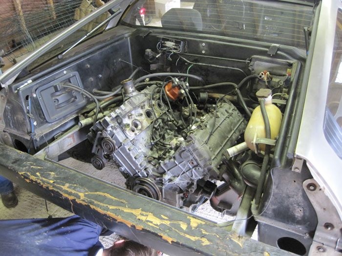

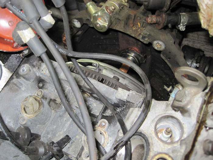

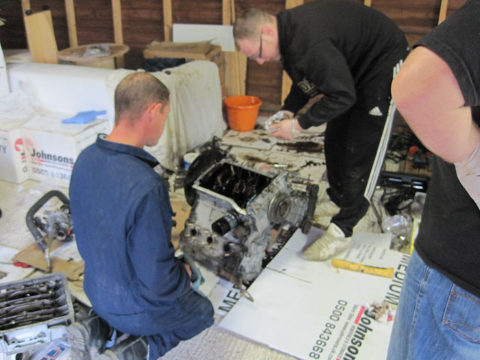

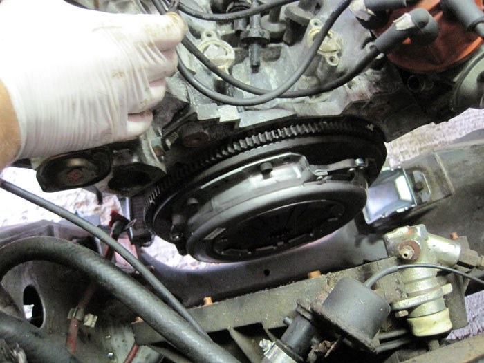

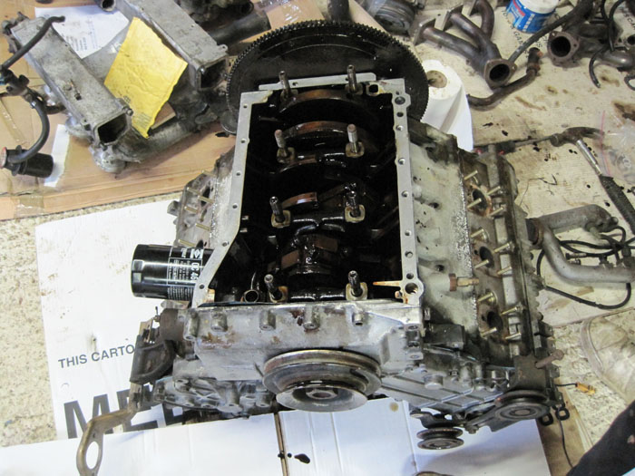

Some pics!
New engine's Volvo crankcase is off - time for the D one.
Crankcase off, awaiting TT's...

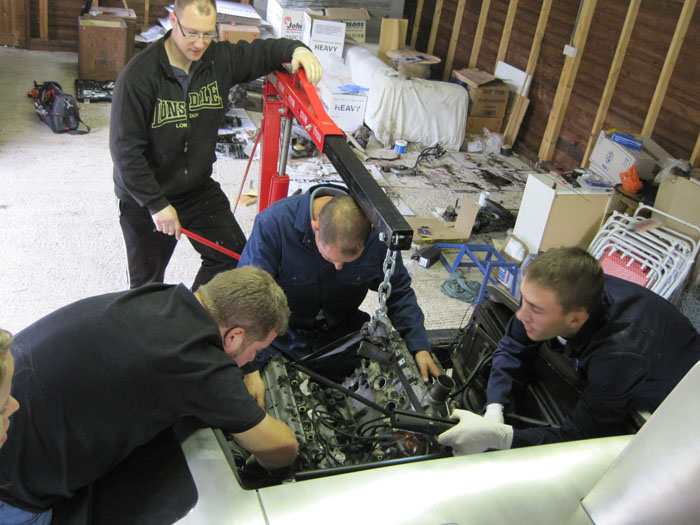

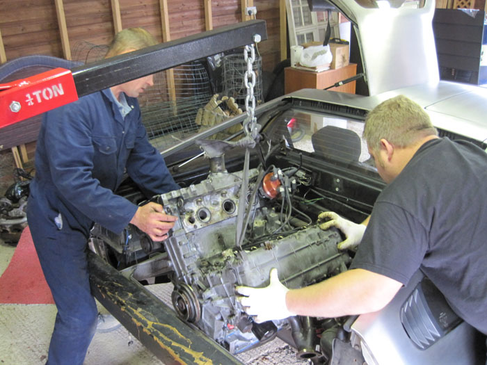

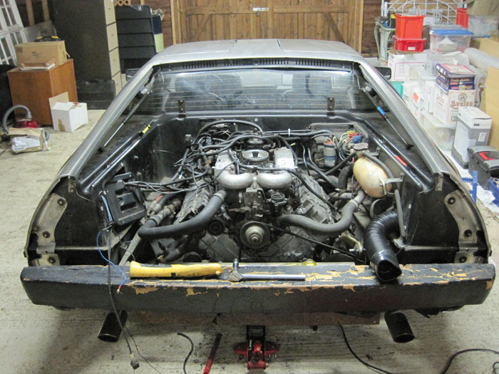

Re: GezTec - 25th September 2010
Postby jerzybondov » Mon Oct 11, 2010 6:25 pm

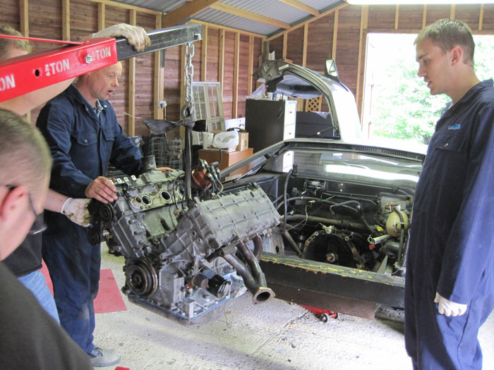

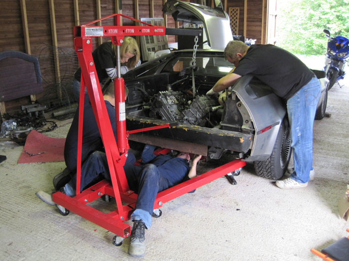

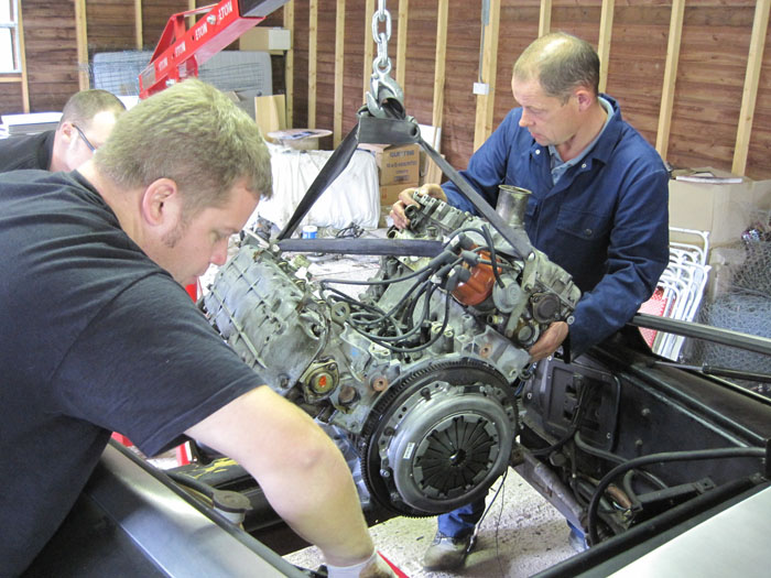

And some more...
TT assumes the position...
It's in!
As it was left Saturday night
