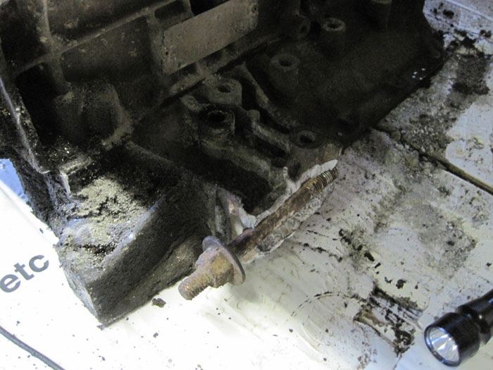

Here's a close up of the other side of the sandwich plate / crankcase, with the bolt corroded in. This one is conceivably less terminal than the other side. TT what do you think?

jerzybondov wrote:Here's a close up of the other side of the sandwich plate / crankcase, with the bolt corroded in. This one is conceivably less terminal than the other side. TT what do you think?
Can't you take it to an aluminim fabricator and have it repaired? I'd be supprised if it's beyond repair.
The company that do my numberplate surrounds do all sorts of aluminium related work.
TBH without seeing the broken one next to a good one I'm not sure what to look out for as I've never looked in detail at that area of the engine.

I've pinged DPNW and Josh emails, will wait to hear back. TT wanted to see pics of the crankcase as he knows places which can repair I think. If that's possible then that'll be the preferred option I think!

Postby tourettes tony » Mon Sep 27, 2010 5:17 pm
that can be repaired no prob's
Re: GezTec - 25th September 2010
Postby jerzybondov » Mon Sep 27, 2010 5:41 pm
tourettes tony wrote:that can be repaired no prob's
And this one?!

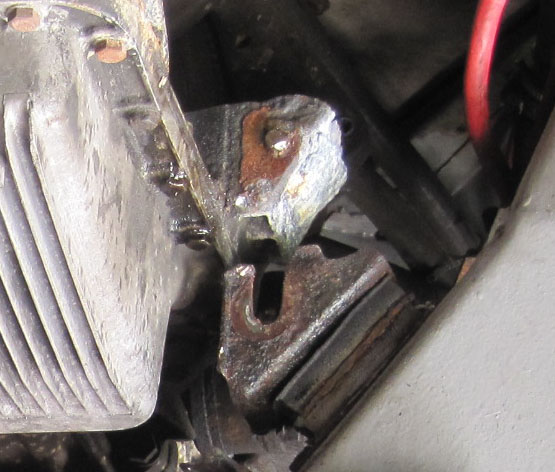

Postby delorean12uk » Mon Sep 27, 2010 5:55 pm
get the egine mounts machined off and then bolt on new machined alloy one's from the inside, I would not weld them because the alloy composition is shit. I might have some alloy block in work, give me some rough dimensions and I'll see what I can do.
Postby A Van » Mon Sep 27, 2010 6:14 pm
There is quite a bit of strain on those mounts, especially as you have put new rubber mounts in which will have no give at all for a while, so it needs to be pretty spot on.

Postby jerzybondov » Mon Sep 27, 2010 6:40 pm
I think the idea is this wouldn't happen quickly enough so I take TT's to put on my engine and then I'd replace his with either a repaired version of my one or another if that's not possible... But in any case you'd hope a repair would be strong enough to take fresh stiff mounts!

Postby A Van » Mon Sep 27, 2010 7:19 pm
Has anyone ever welded one successfully before ?
