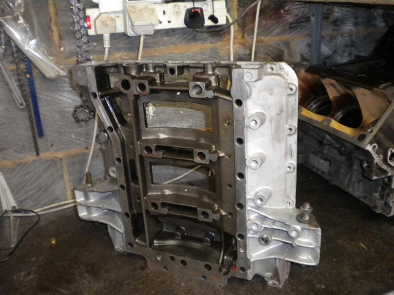

Mat Nickles old one was welded in those spots, he might have a photo.

jerzybondov wrote:I think the idea is this wouldn't happen quickly enough so I take TT's to put on my engine and then I'd replace his with either a repaired version of my one or another if that's not possible... But in any case you'd hope a repair would be strong enough to take fresh stiff mounts!
i wont take that one Gez :shock: that will snap off , not if but when :( just replace mine with new cheers tt

can you still get hold of them, I wonder if the renault alpine had the same sandwich plate???

A Van wrote:Has anyone ever welded one successfully before ?
Best bet is to take it to somone who works with alloy and get them to have a look, I'm sure it could be sorted with a little research.
I'm sure the casting it'self is probably made from a poor quality alloy (as Jay said) they usually are, but that doesn't mean it can't be fixed by the right person.

well gez can have mine for the time being, i wont need it for a about a month maybe longer :D

Houston have them http://www.delorean.com/store/p-6121-crankcase.aspx
Works out at £206 though :?

Lawrence Lormand just emailed back to say he may have one, will know in a week or so.

Postby tourettes tony » Sun Oct 03, 2010 2:48 pm
well its off TT
