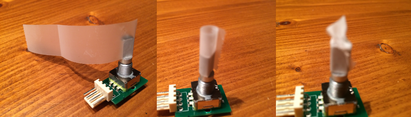

I have noticed that using the right amount of tape on the rotary encoder (about 2-3 inches) works far better than any adapter knob i could have come up with. I've attached a picture that should demonstrate the way I applied the tape. This will make sure that the dial sits properly.

I'll be swinging by my lock-up tonight to pick up an appropriate tool to wedge in and get the connector out :) I'm sure the tape on the dial works, but it doesn't feel up to the quality of the rest of the engineering you've put into the project to be honest!
