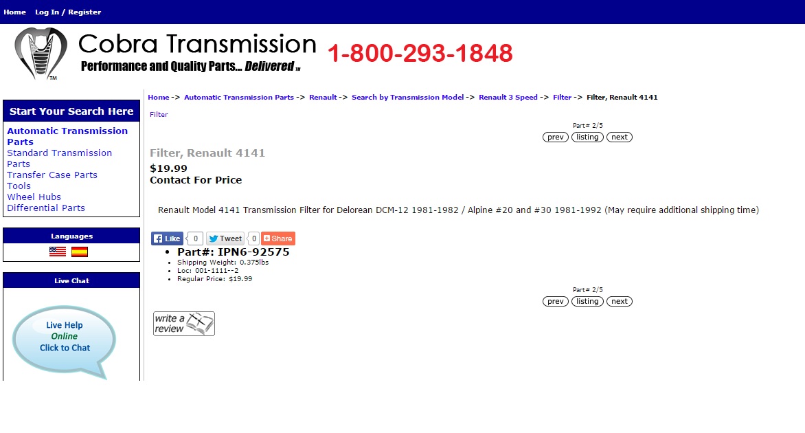

Postby delorean12uk » Mon Jun 22, 2015 7:56 pm
arranj wrote:Here is the thread in question Jason: viewtopic.php?f=19&t=2228
cheers Arran, it has been discussed before, as Al, Admin and myself posted on it!!!
getting back to this thread, unless your filter has a hole in it I wouldn't understand why you would want to replace it
reanult 4141.jpg (125.92 KiB) Viewed 6254 times
