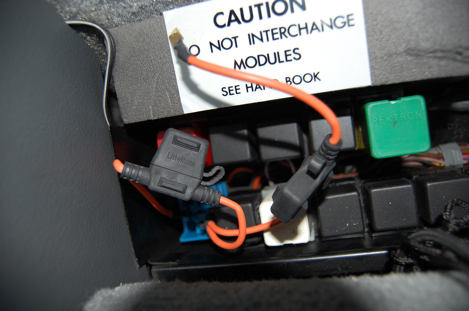

As Nick said, that is a common upgrade. However it would be better/safer to have the revised version of the jumper wire, which has a fuse covering each fan.
Re: VIN 17005 New Zealand
Postby gary290 » Thu Oct 26, 2017 7:30 pm
Thanks Mike, what size fuse are you running?
My order for a new thermostat, otterstat and relay turned up so they all got installed last night with great success, so far everything works as it should, temp gauge now works and the fans come on when the engine gets up to temp so i am very happy!

That looks an interesting electric mod for the fans nice one!
