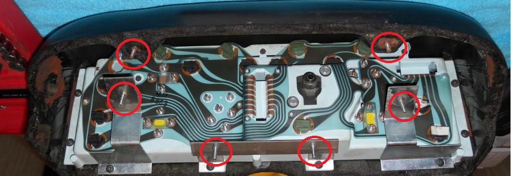

I would appreciate photos of how the instrument binnacle is attached to the dashboard. I only did the front two 5mm screws.

Postby MikeWard » Thu Jun 06, 2019 4:48 pm
There are 6x studs in total, circled in the image below.

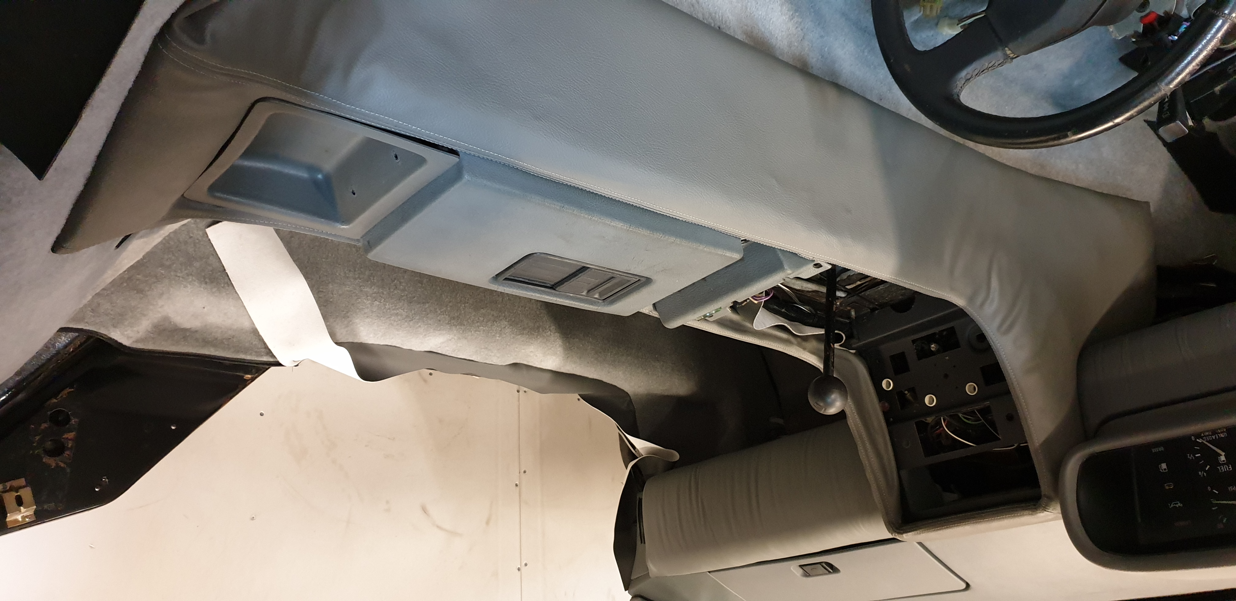

Postby gruffalo » Tue Nov 05, 2019 10:15 am
Long time no see, I'm working on the interior now. Well, for the most part I'm not working on the car at all, but this is where I'm at:
