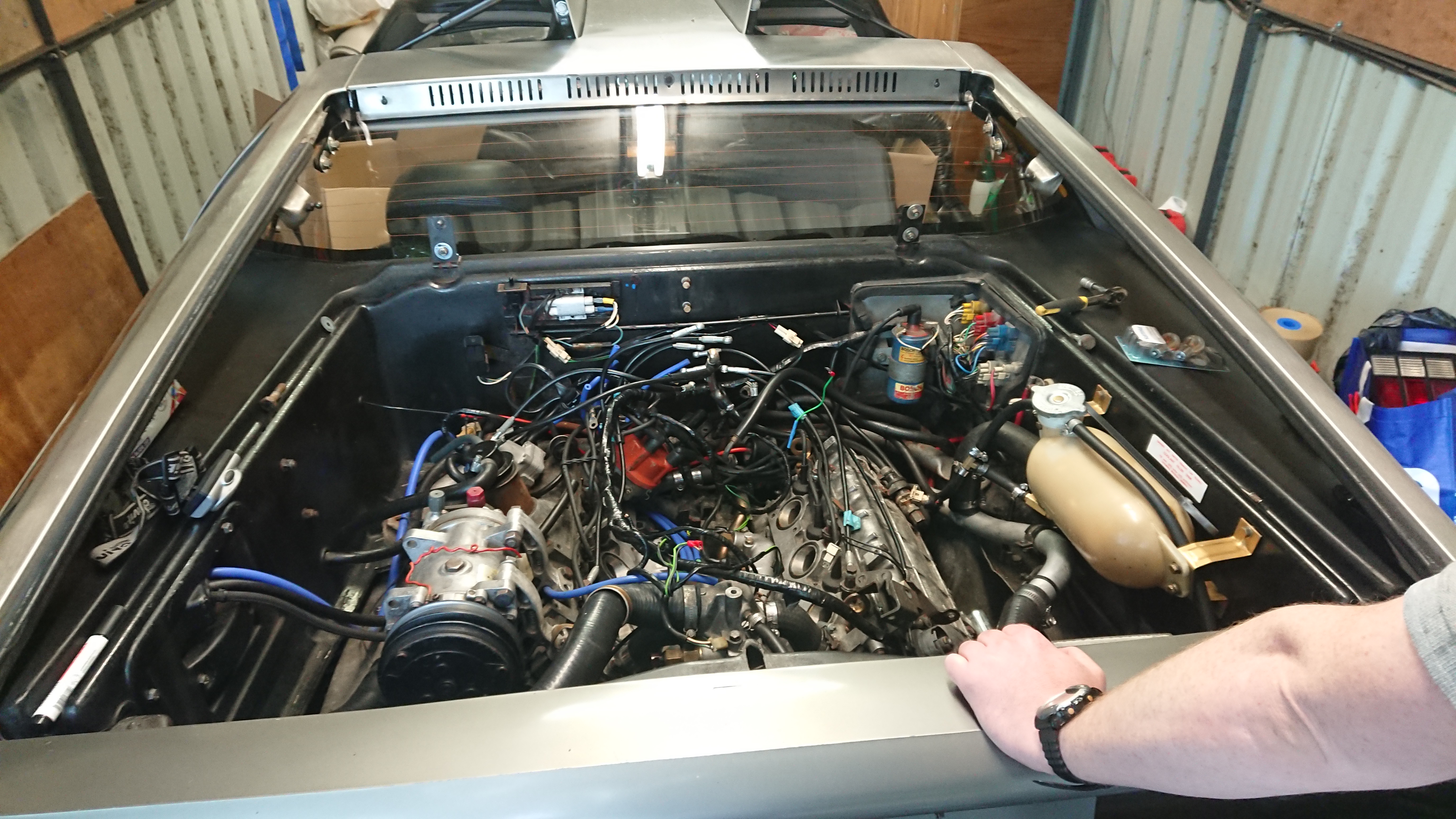

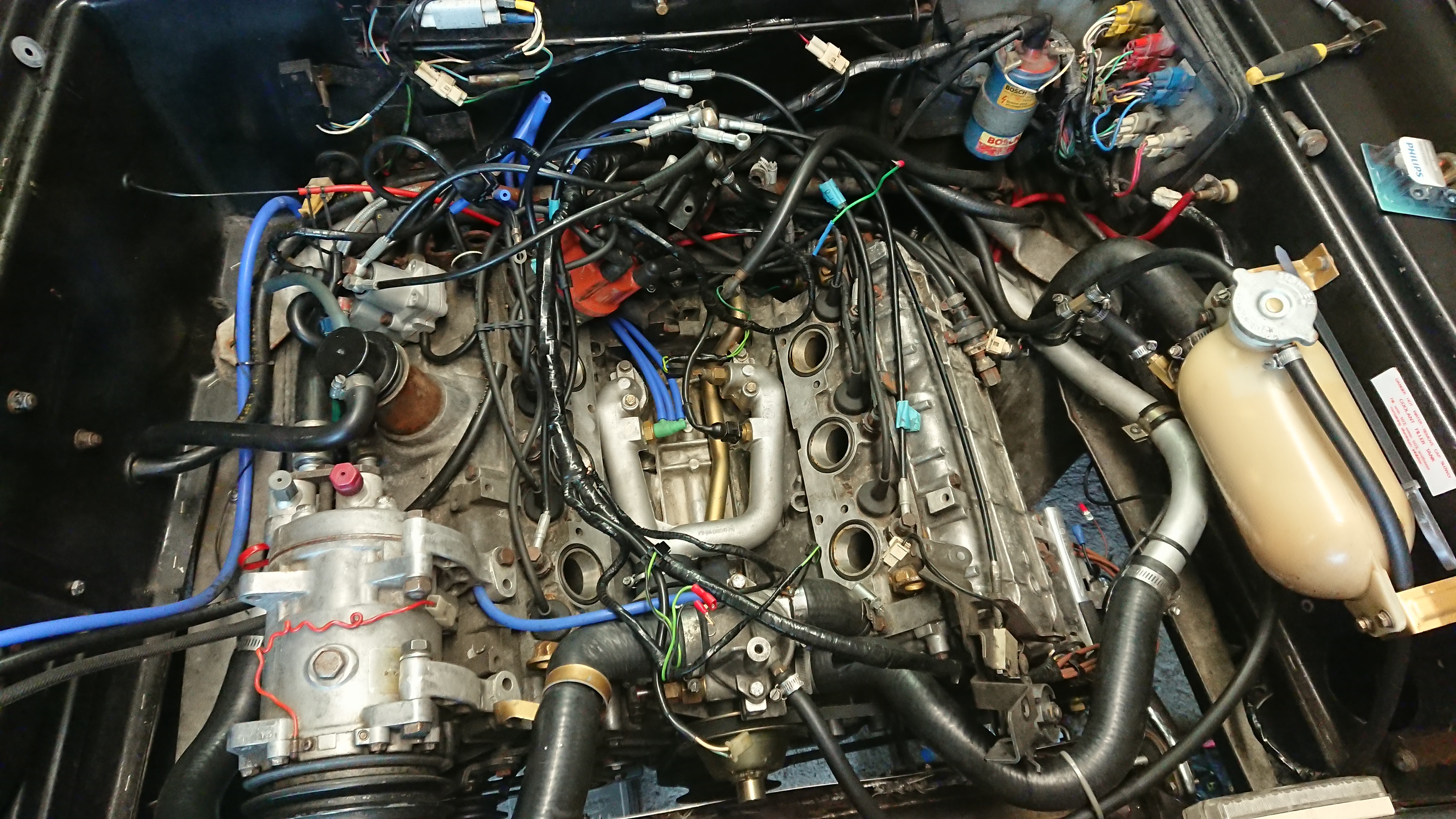

Postby cis6409 » Sun Sep 02, 2018 6:48 pm
The time has come to do a full tare down and rebuild of my engine.. was going to eventually do this job one way or another but head gasket failure and worry over block rot issues has pushed this up the schedule..
Hopefully she ll back back on the road better than ever!
I'll try and update as often as I can
Shane
It begins

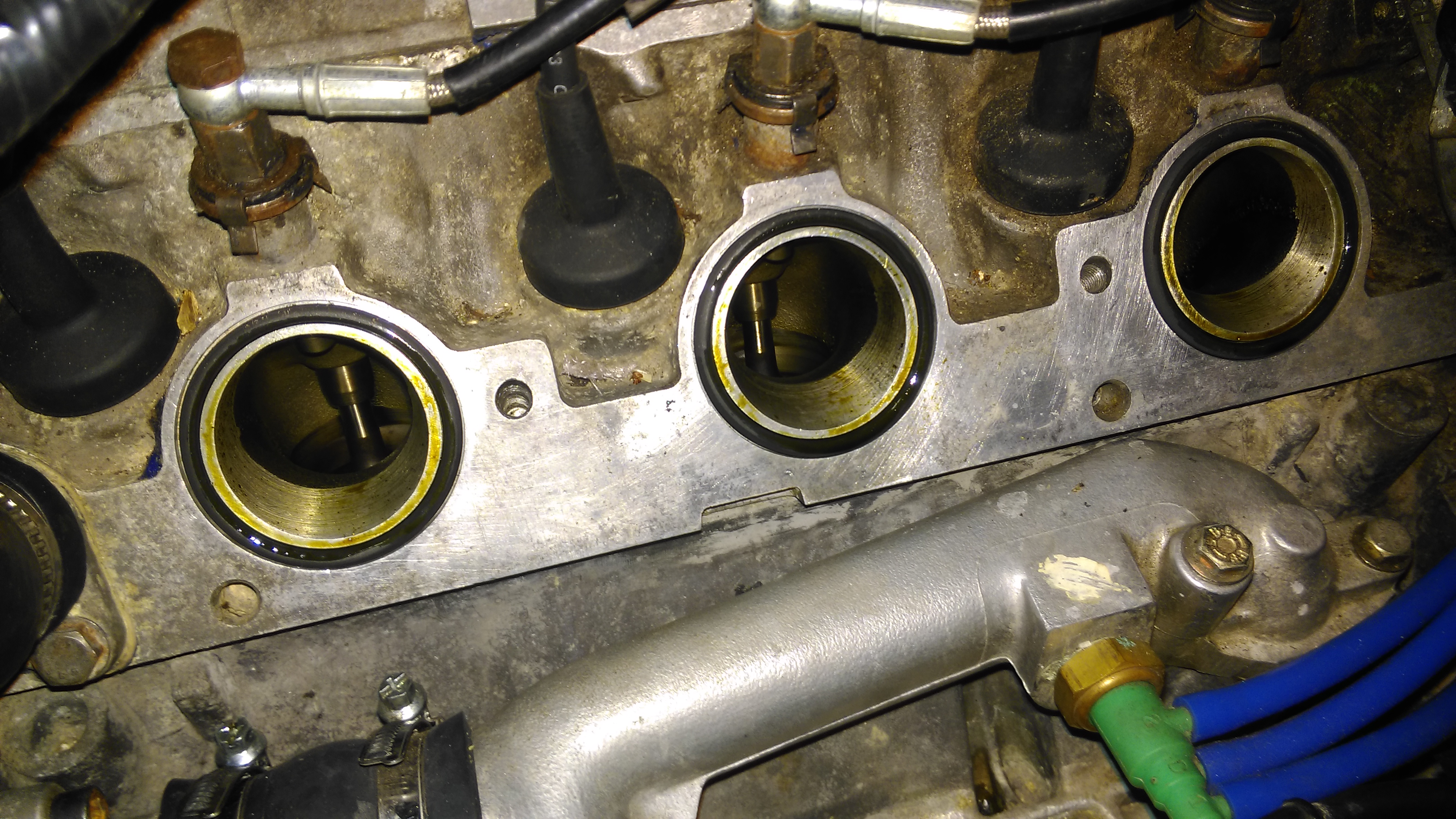

Postby cis6409 » Sun Sep 02, 2018 6:50 pm

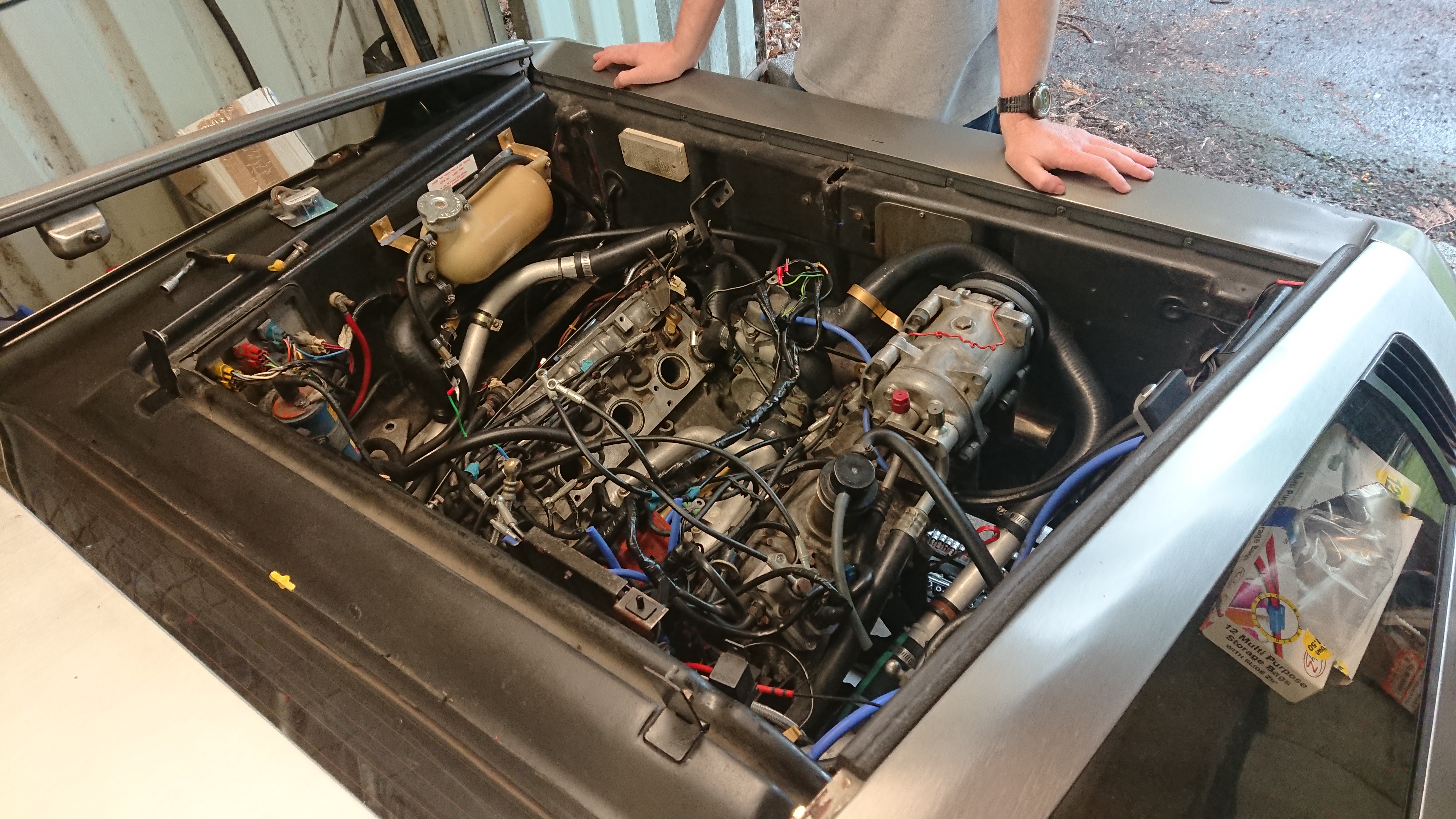

More

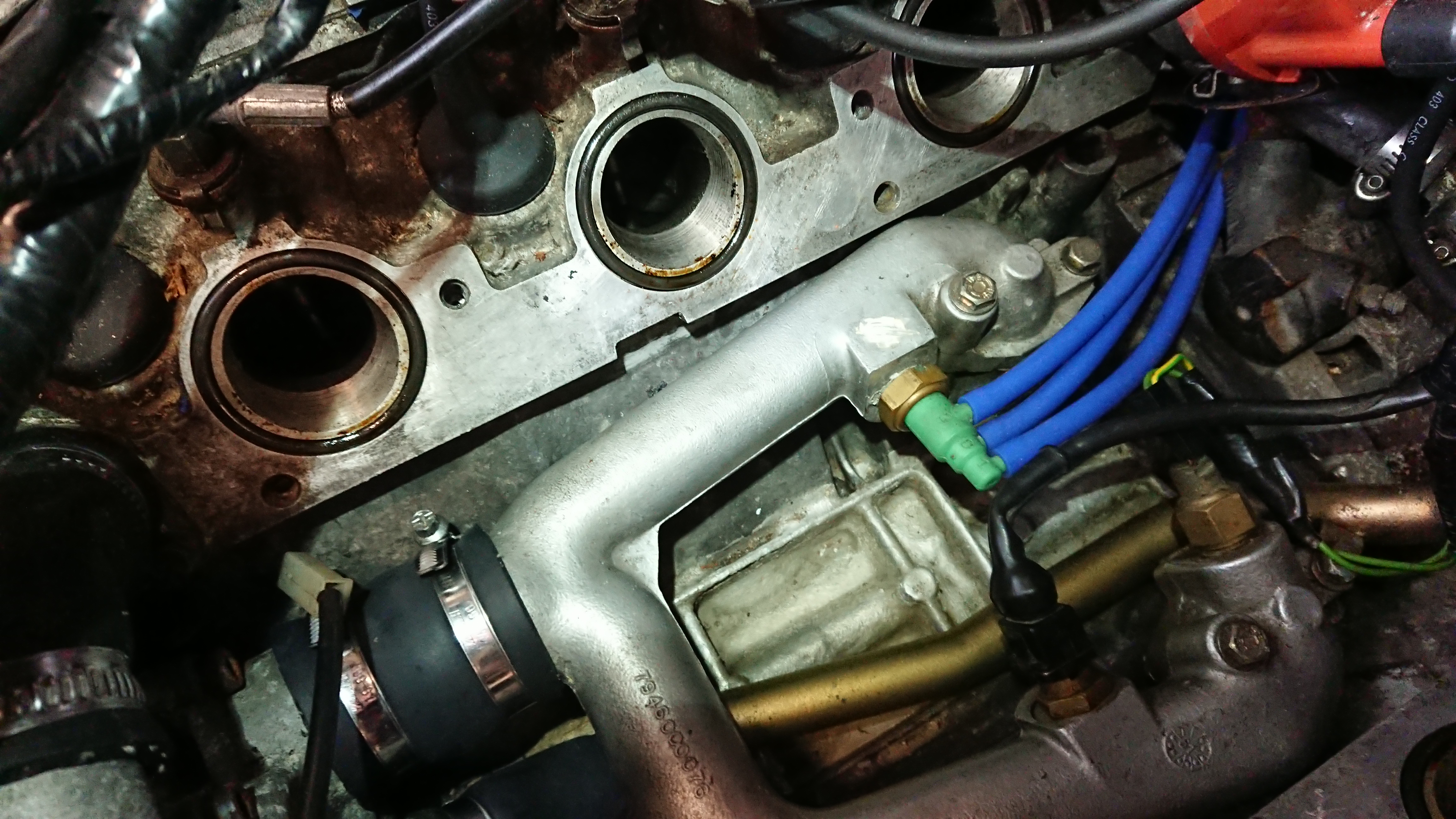

Postby cis6409 » Sun Sep 02, 2018 7:00 pm

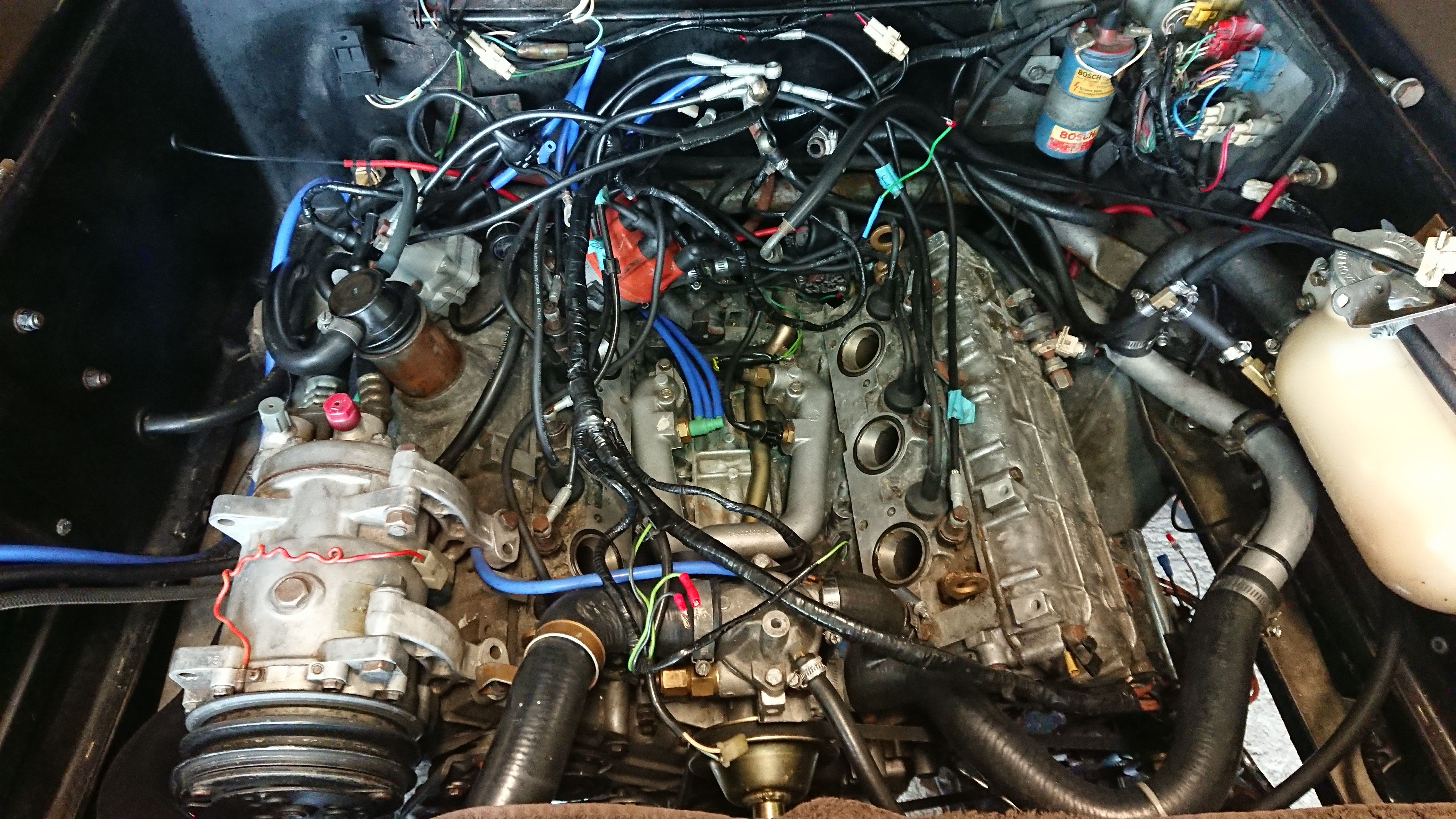

M

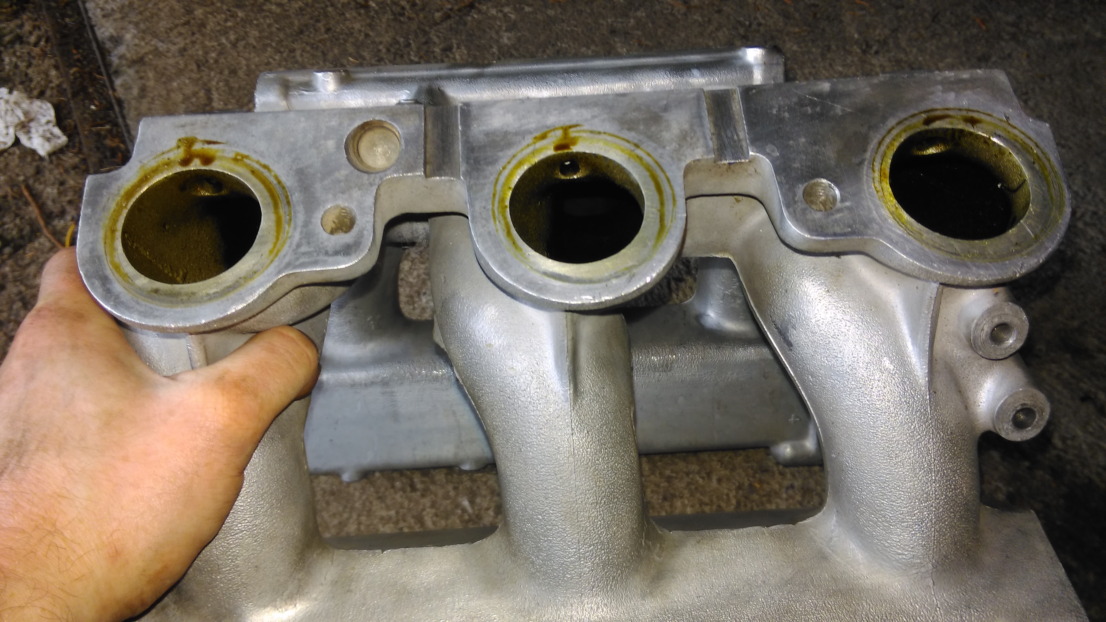

Smell of coolant out of exhaust travelling behind not mad but noticeable and also towards the end oil in the intake manifold which was never there before :(
Oil in the intake
