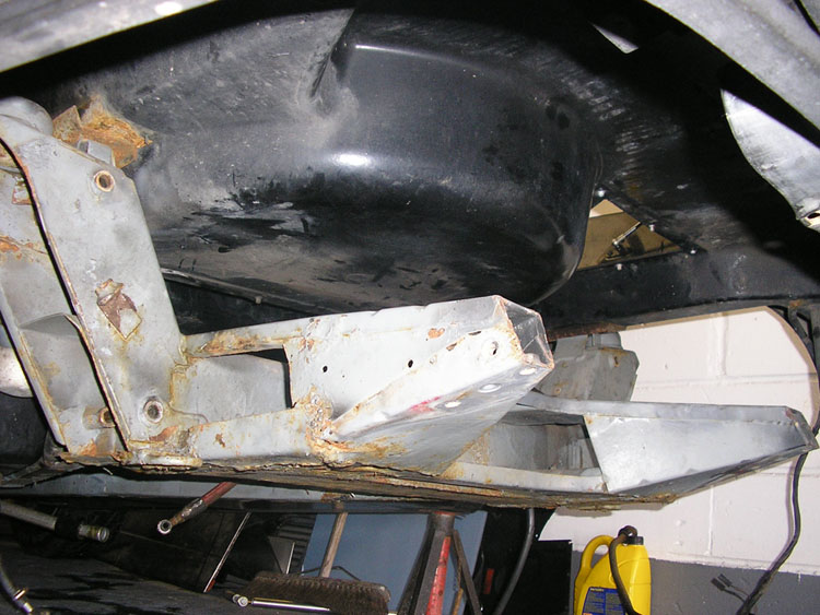

My car is in for it's second stint at PJ Grady's, where Chris is busy sorting the frame out and a bunch of other things! Have a look at the pic for the state of the frame before he got to work...

Wow Gez I didn't realise it was being stripped back that much!!! Wouldn't it be easier to pop the body off now its stripped that much already?
Re: VIN 7176, grey manual - November 26th 1981
Postby jerzybondov » Sun Apr 11, 2010 3:35 pm

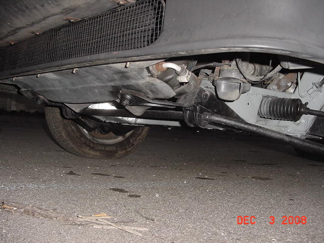

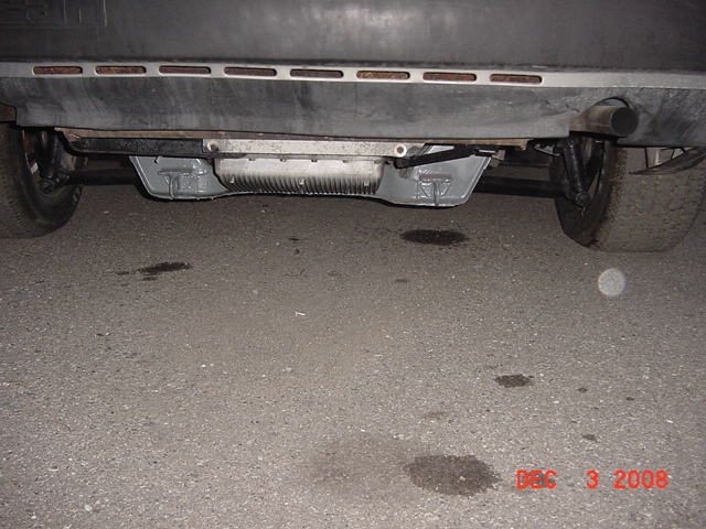

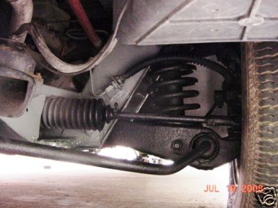

Well, perhaps... but I'm going along with Chris's advice on this really and he doesn't think it needs it so I'm good with that. What I'm perplexed about is how much the frame appears to have deteriorated since Lawrence took these pics after his work just 18 months ago... Why do you think this is?

Postby Admin-bloke » Sun Apr 11, 2010 3:47 pm
paint over untreated rust is the cause I'm afraid..................
