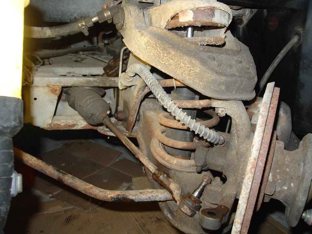

Next up front end stripping:
Postby ALEXAKOS » Sat Aug 10, 2013 10:56 am

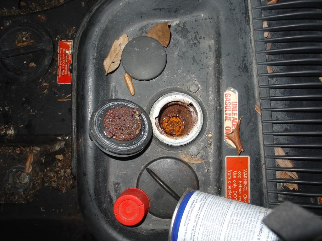

final stage for the day, I removed the rear engine covers and the air filter.
My best friend for the next days: WD40
This D looks like it was pulled out of the bottom of the ocean. NOT ONE SCREW has been left without corrosion... :nervous:
Oh.
and your opinion guys....
IS THIS BAD>>???

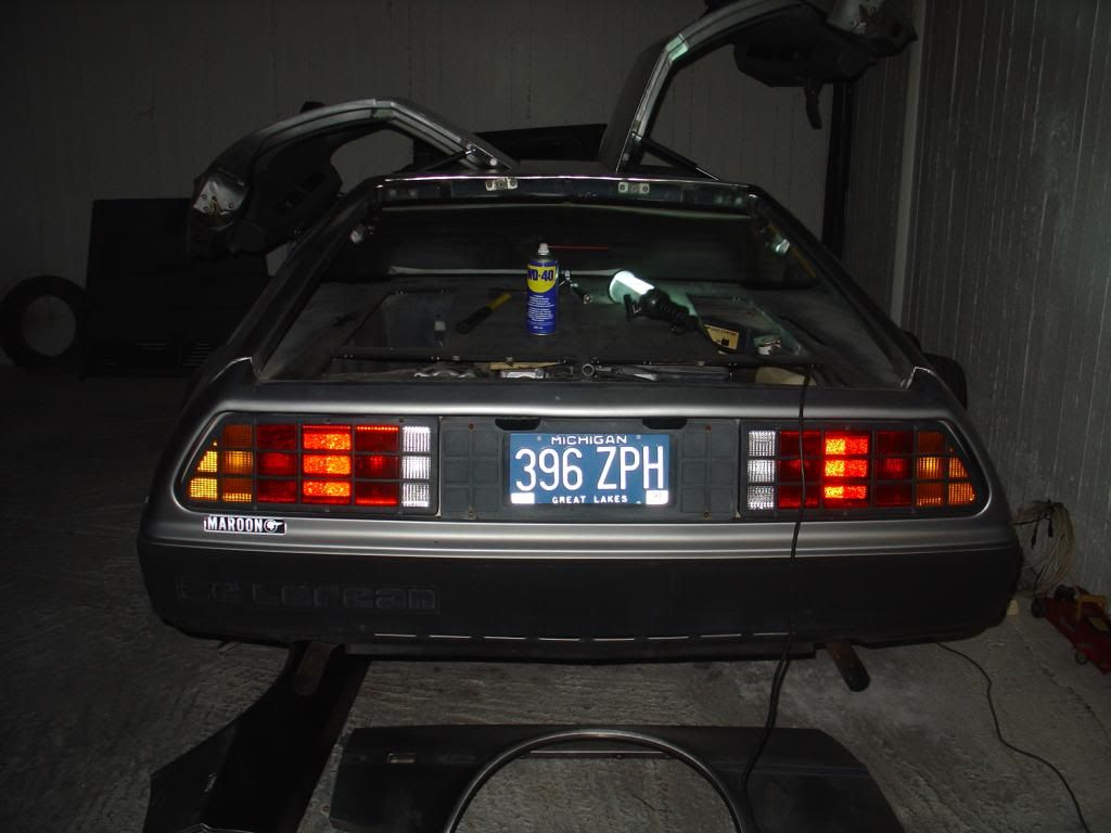

Another hour and a half in my garage working on my rear fascia.
I know nothing you ain't seen before. And nothing that requires skills. The disassembly is a no brainer really.:chairfall:
Tail lights off, Centre plate off.

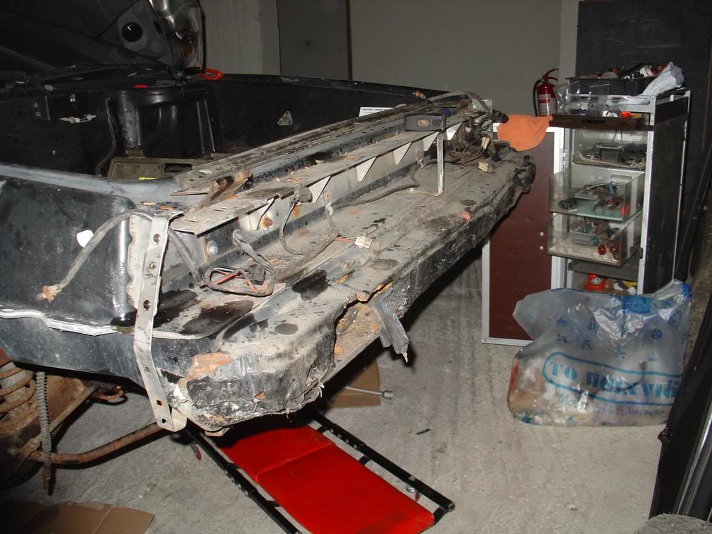

Lots of stuff came down today.
Started with the rear bumper and a little surprise!
No wonder my car is all rusted!!!

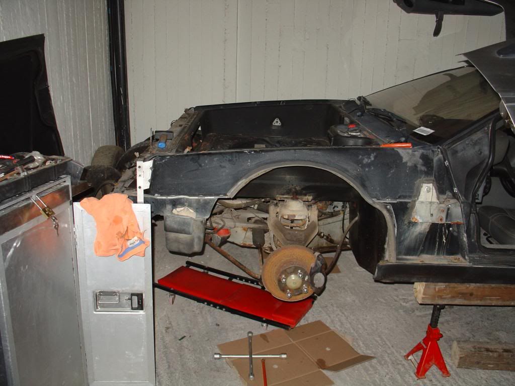

Next came the rear fenders
My D is the fastest of em all! Frame 6000 came onto my 5992!!

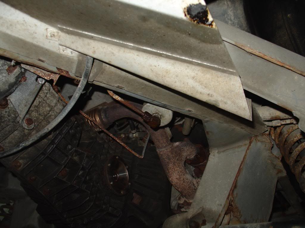

giving a better view of the rusty trouble on the rusty exhaust system

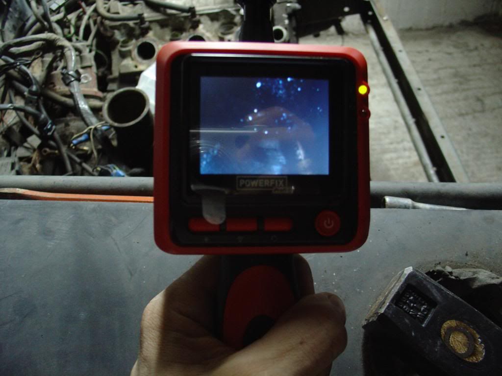

Bought my self a mini handheld camera spy. Was looking inside my engine and them valves are in bad shape! This engine must have run for several miles with a very bad fuel/air mixture

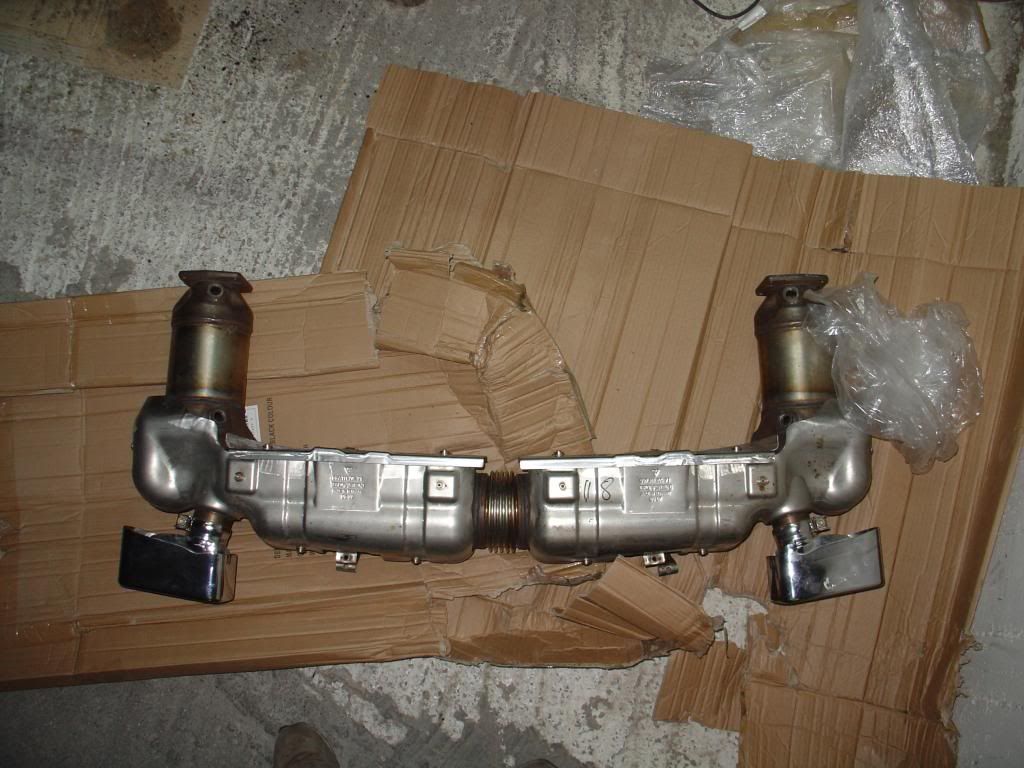

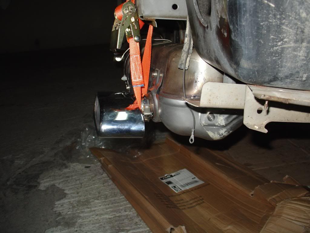

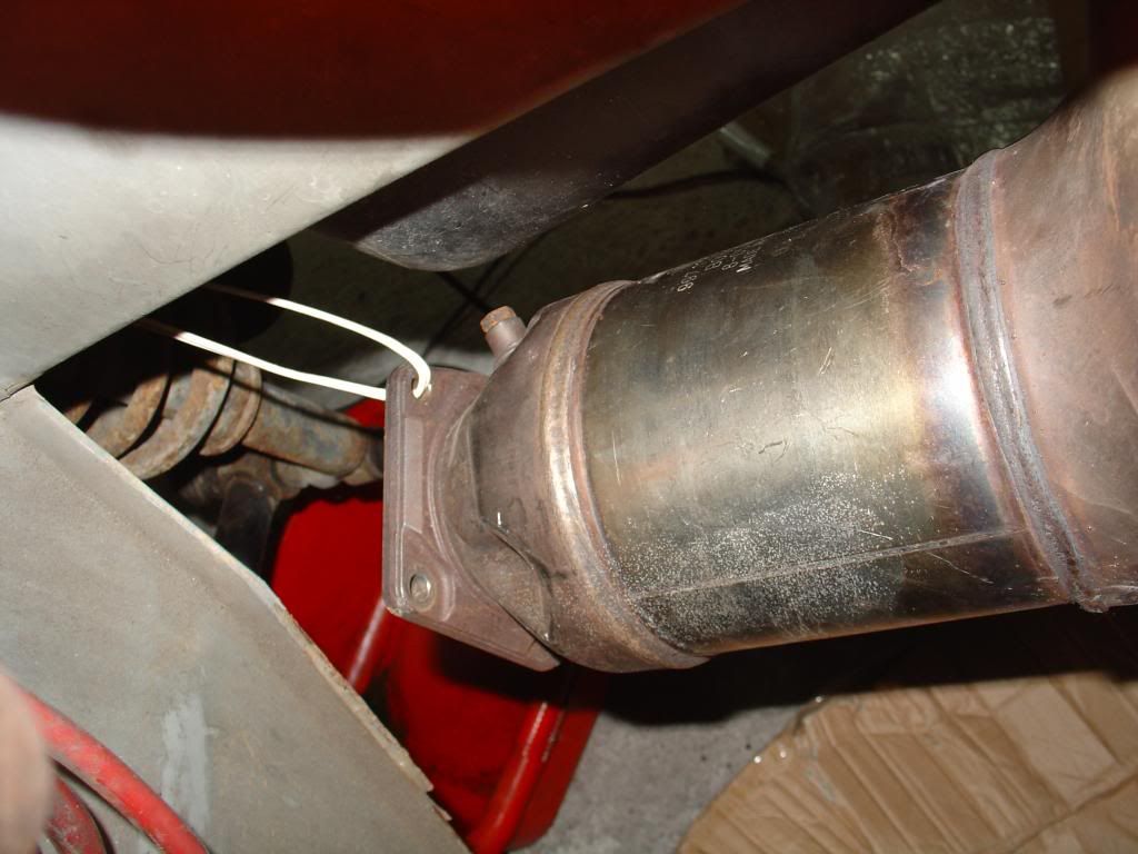

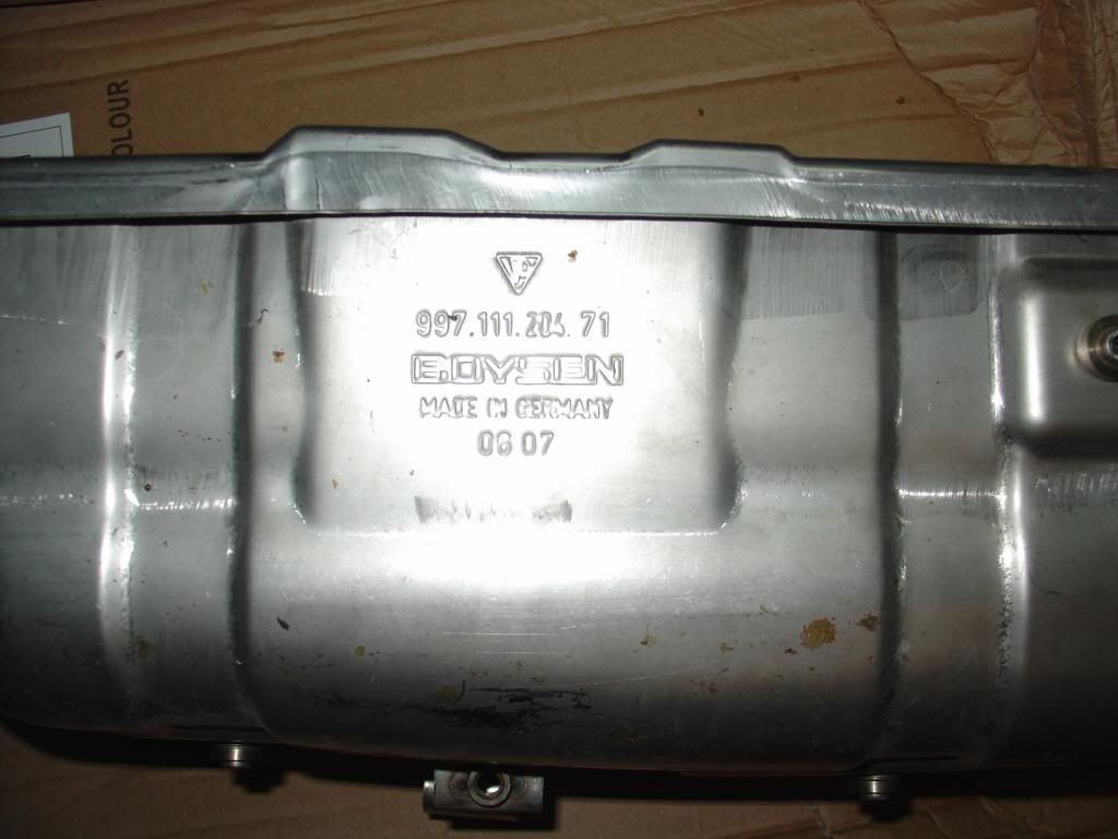

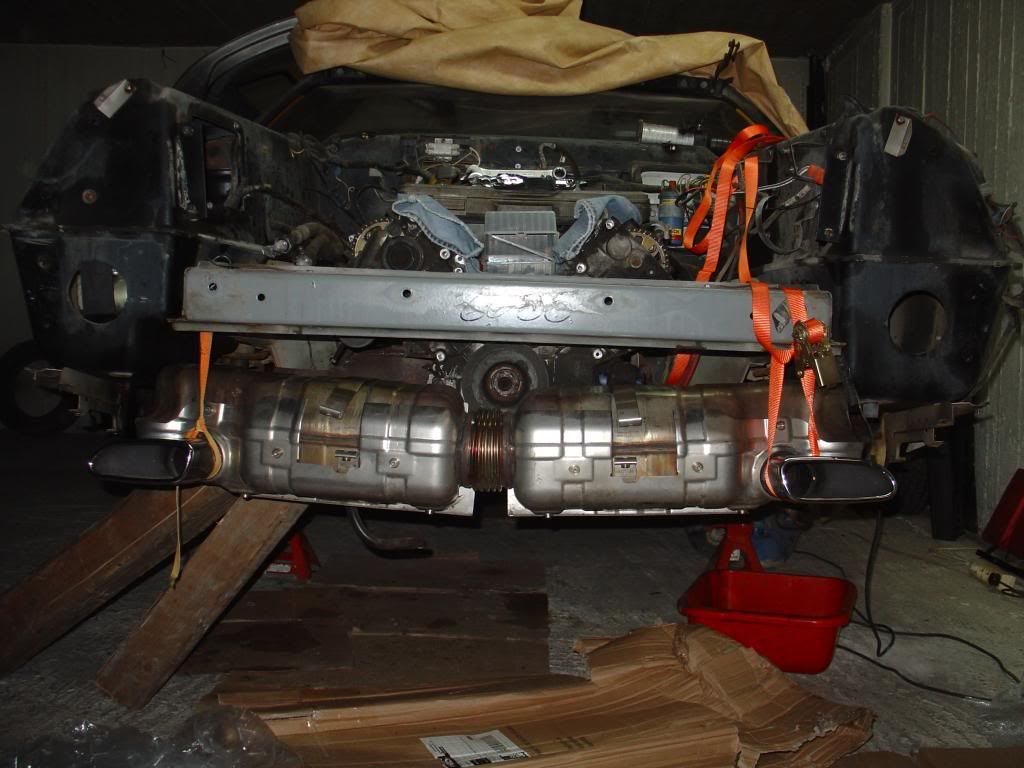

My 997 exhaust arrived today and I placed it in position for fitting testing.
Nick was right. I need to have the manifold got around the frame to connect to the exhaust.
Also on Nick's well noticed speculations, the exhaust barrels are quite large and will have to mod the rear fascia's lower part.
I tried the fitting with the system up side sown to have the bulky part on the top
Here are the images
The fitting
Catalyst looking behind the frame

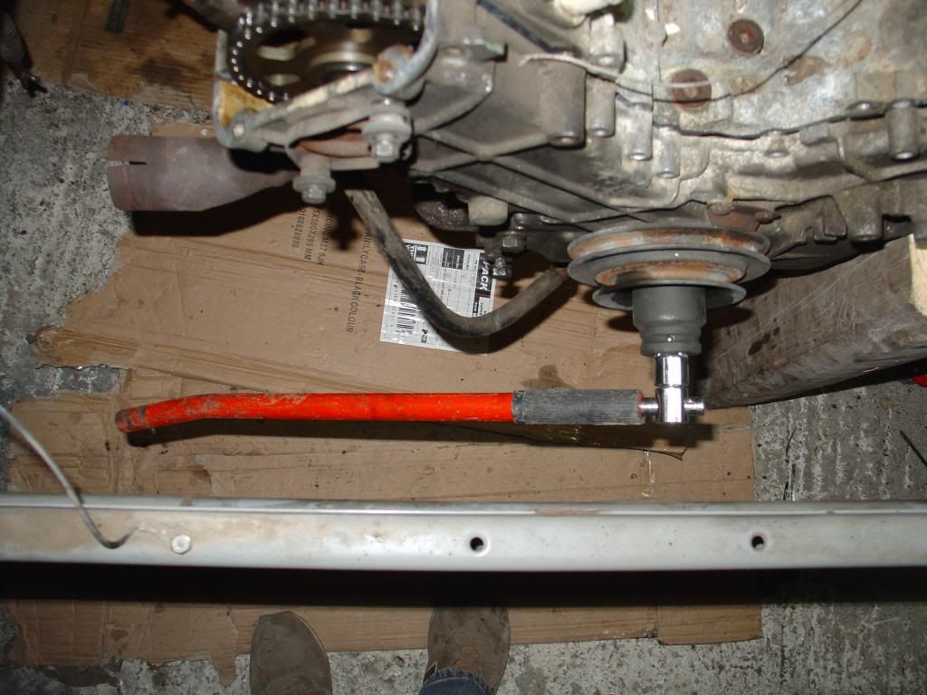

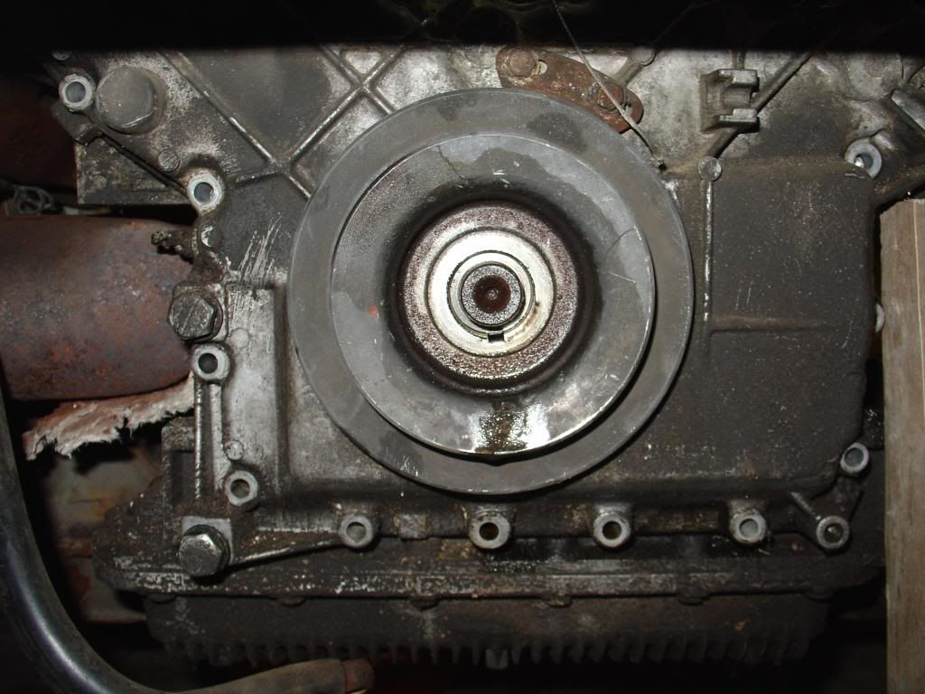

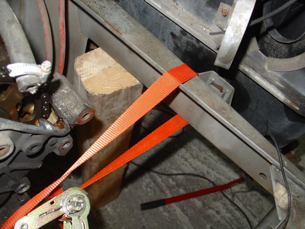

Postby ALEXAKOS » Sat Aug 10, 2013 11:01 am

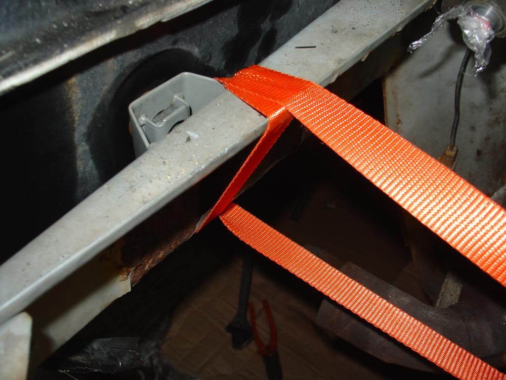

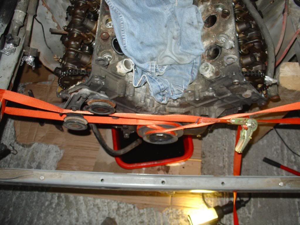

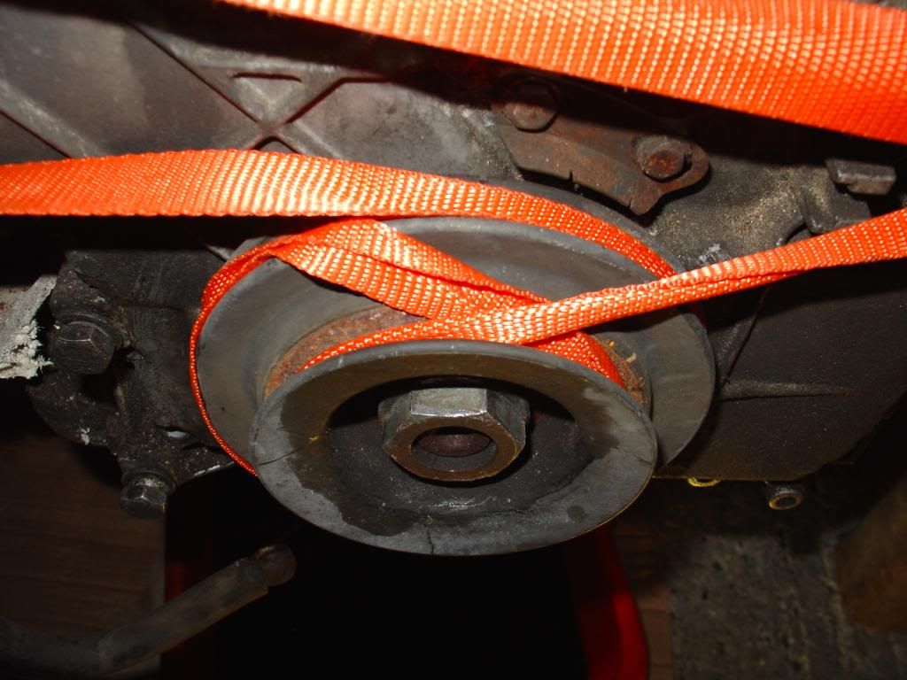

Damn that crank pulley is tough to open!
I stabilized the crank with tension mounting straps with the frame!
That damn crank was pulling the frame together!!!!
Anybody have another way of getting this done?
I can't:
Push the car (got no wheels)
Start the engine (got no battery)
I am aware of both those tricks. That damn crank disk does not have any holes to stabilize it!
See here my failed effort:

Postby ALEXAKOS » Sat Aug 10, 2013 11:02 am
Leverage gives to tiny David the strength of Goliath.
Like wise I am back to tackle that Crank pulley.... after 3 days of efforts and read several threads with most people having failed it.
I use for extra leverage the hydraulic lift's bar as an extension of my tool.
If I need more power... I simply extend it :blahblah:

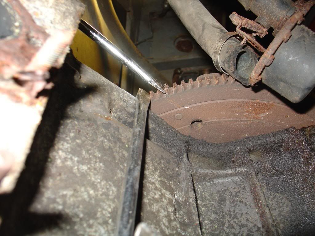

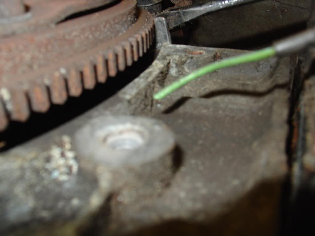

Next I blocked my flywheel with two sturdy screwdrivers. One horizontally right over the original position of the starter
and the other diagonally pressed between the flywheel and the anti sway bar.
I started giving it some pressure.... extended my leverage bar... Then some more.... and suddenly.... CRACK!!!!
CAN YOU FEEL THAT!????
HUH? CAN... YOU.... FEEL... THAT...
SUCK IT CRANK PULLEY BOLT!!!
Sorry I had to do that after a weeks fight!:banghead:

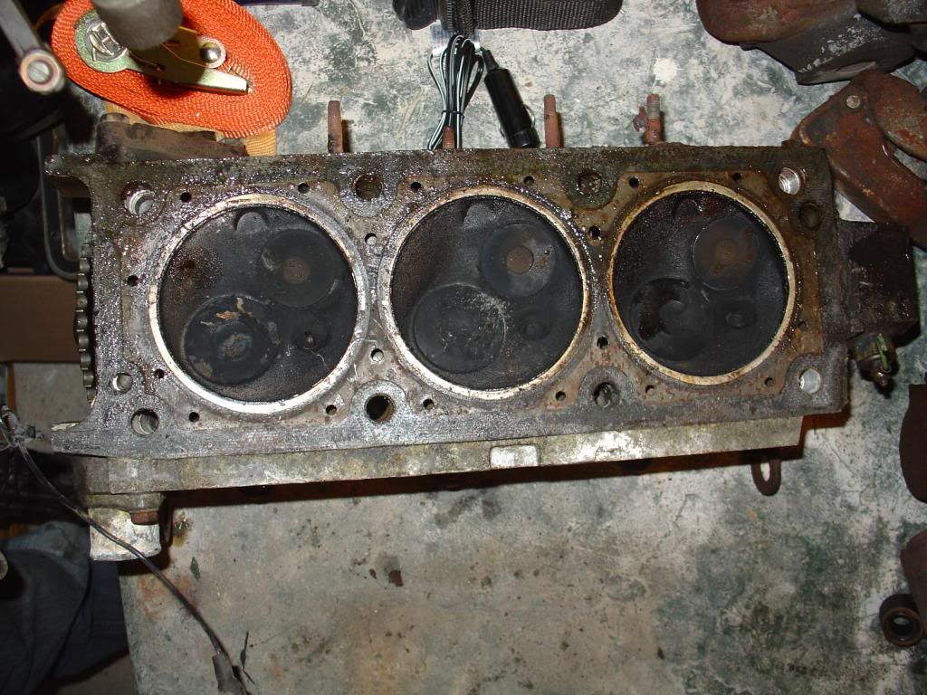

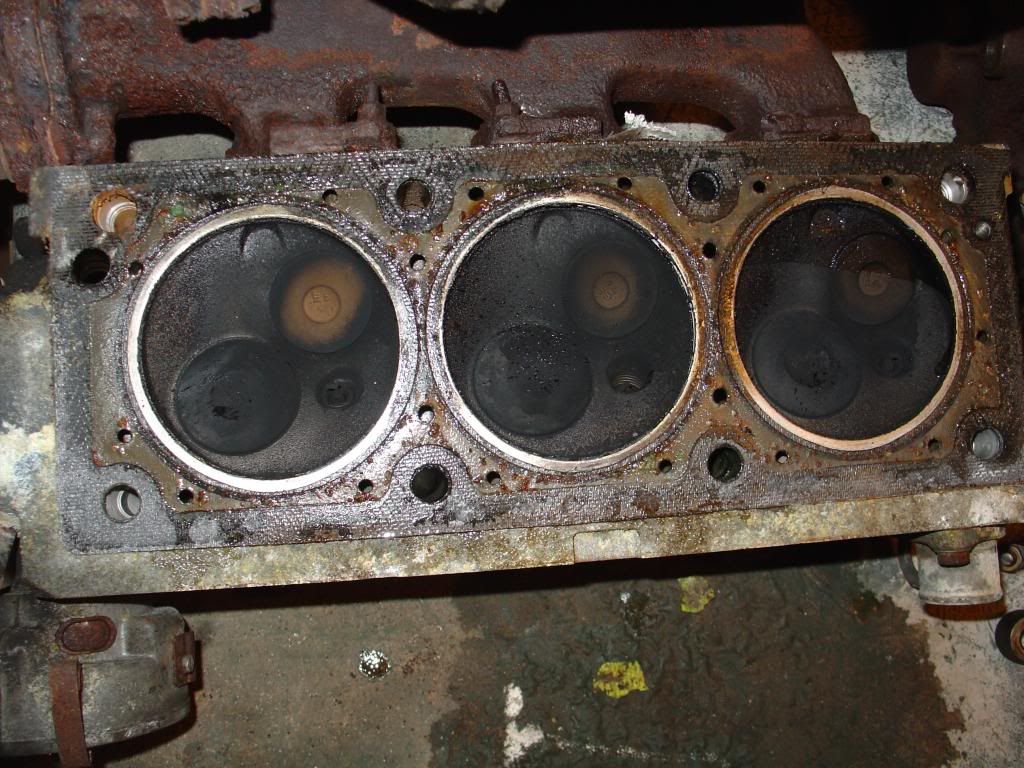

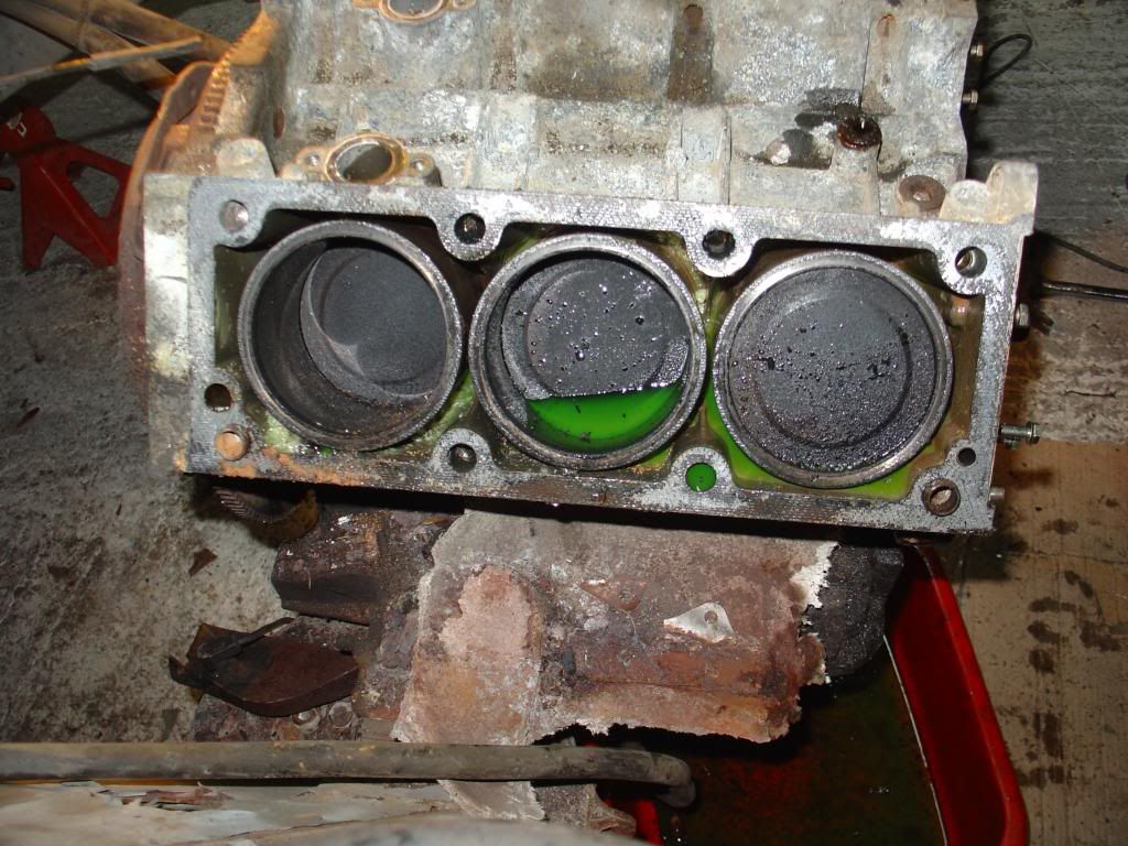

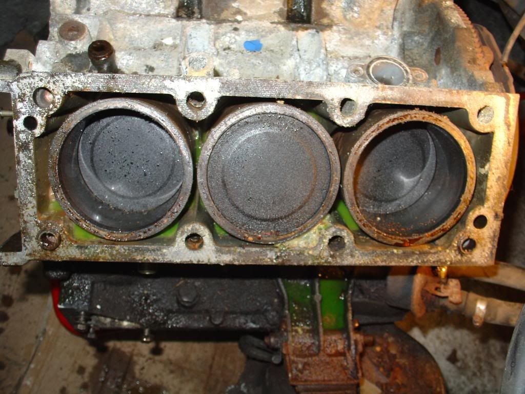

So having that said and done here are my images of the cylinder heads and valves....:mooning:
What a mess....
Coolant has created a gew all over those....
and the valves... Oh man....
That car must have been sitting for 8 years and somebody filled it up with fluids and just took it for a drive... until it finally died on him. RIP
