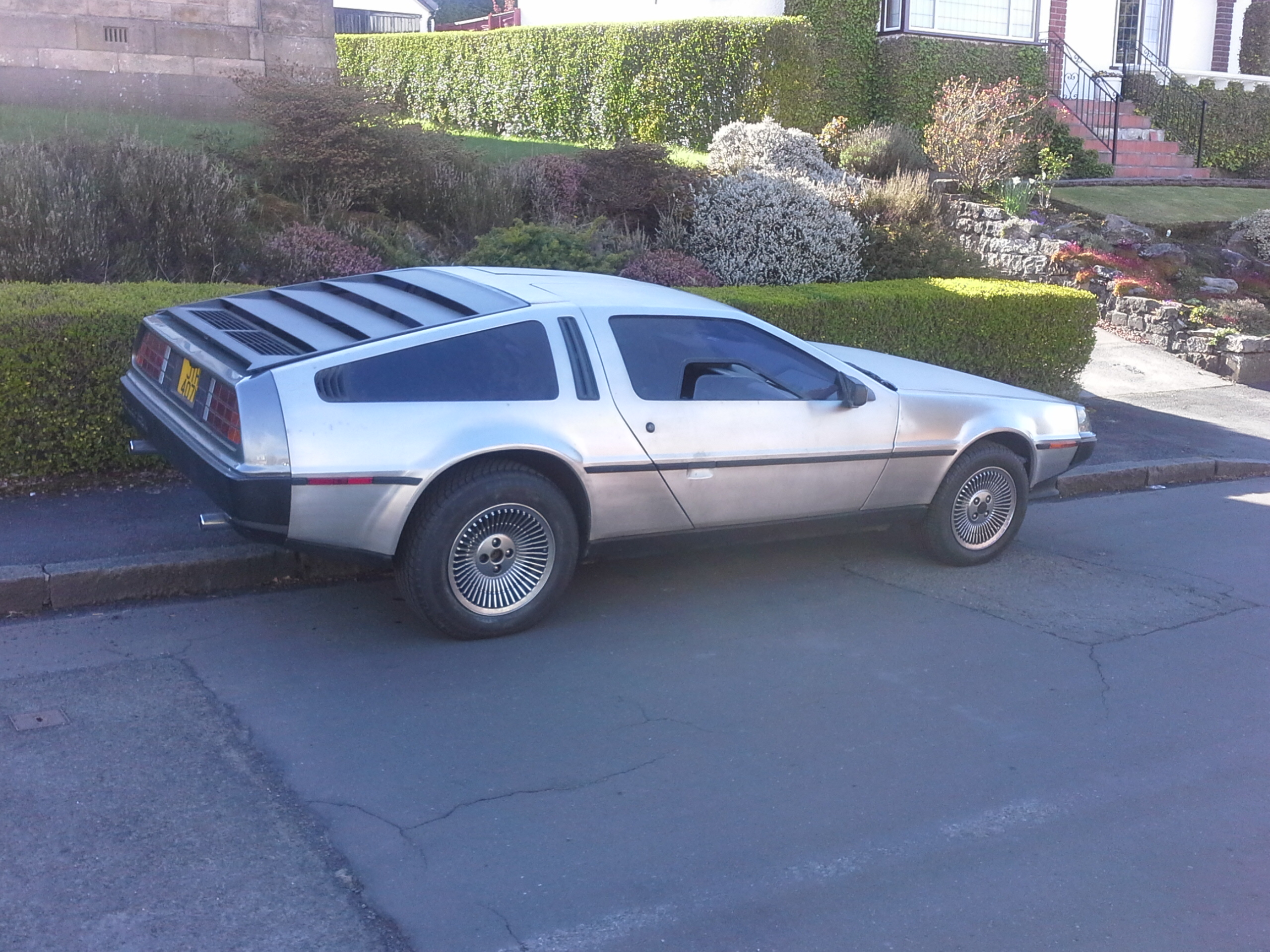

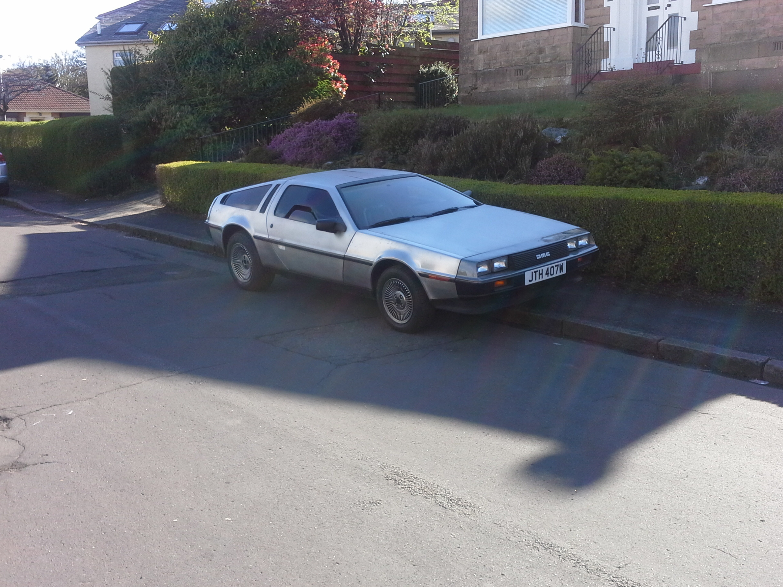

Still looks rough, and is utterly filthy, but drives a whole lot better. The clutch is a revelation. Not only much lighter but smooth and progressive. The ride has no clunks or bangs which is a bit of a novelty too. Gear shift is really nice too with a new correctly adjusted x-gate cable and pivot bolt. Grease on the linkage and new oil in the box probably helps too.
The front looks high here, but I had just had the jack up derived the front to seat that wheel properly.
So there is still a pretty big list to do, but it's probably just about mot-able. I've refitted the fog light and am looking at my lada front indicators as the mot guy didn't really like the yellow running lights. But it's close!
