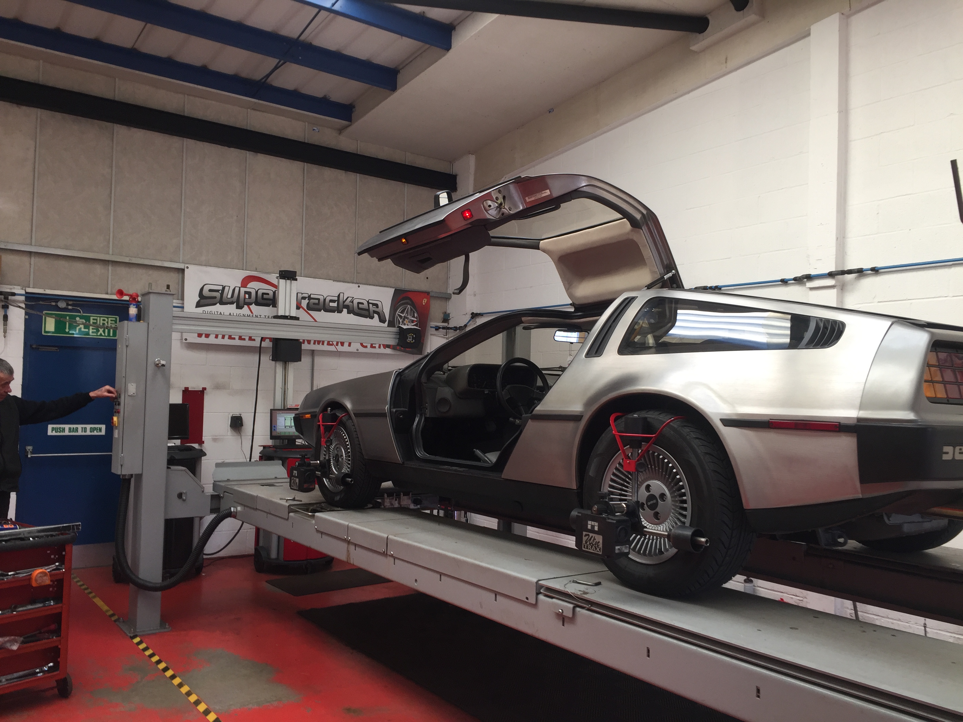

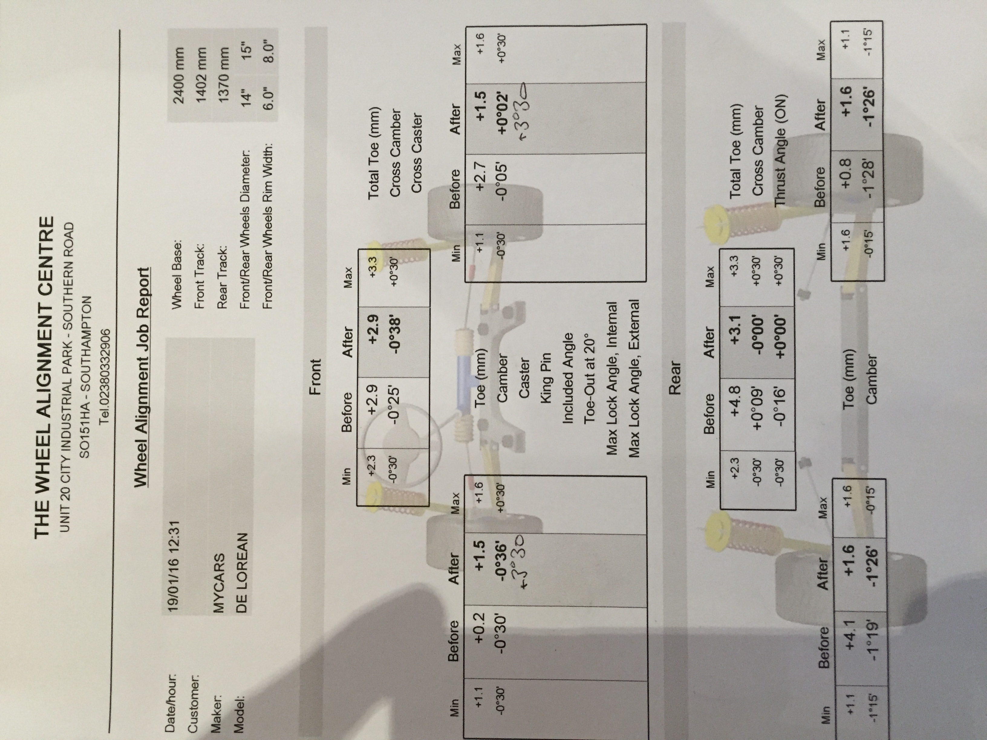

Right all back together now
Took it to the wheel alignment centre in Southampton today and what an excellent job they did
Im very happy with the result, the car drives true and handles really well now
Big thanks to admin bloke for his tech assistance
Dan

I've got to say that is one of the best results I've seen on a geometry report. That result is more accurate than most new cars. Considering that you've reworked the rear, it's an excellent result.
I bet it drives a lot better than it originally was.
Looking at the before and after readings, I bet you could even tell the difference on the ride to the alignment place and back.

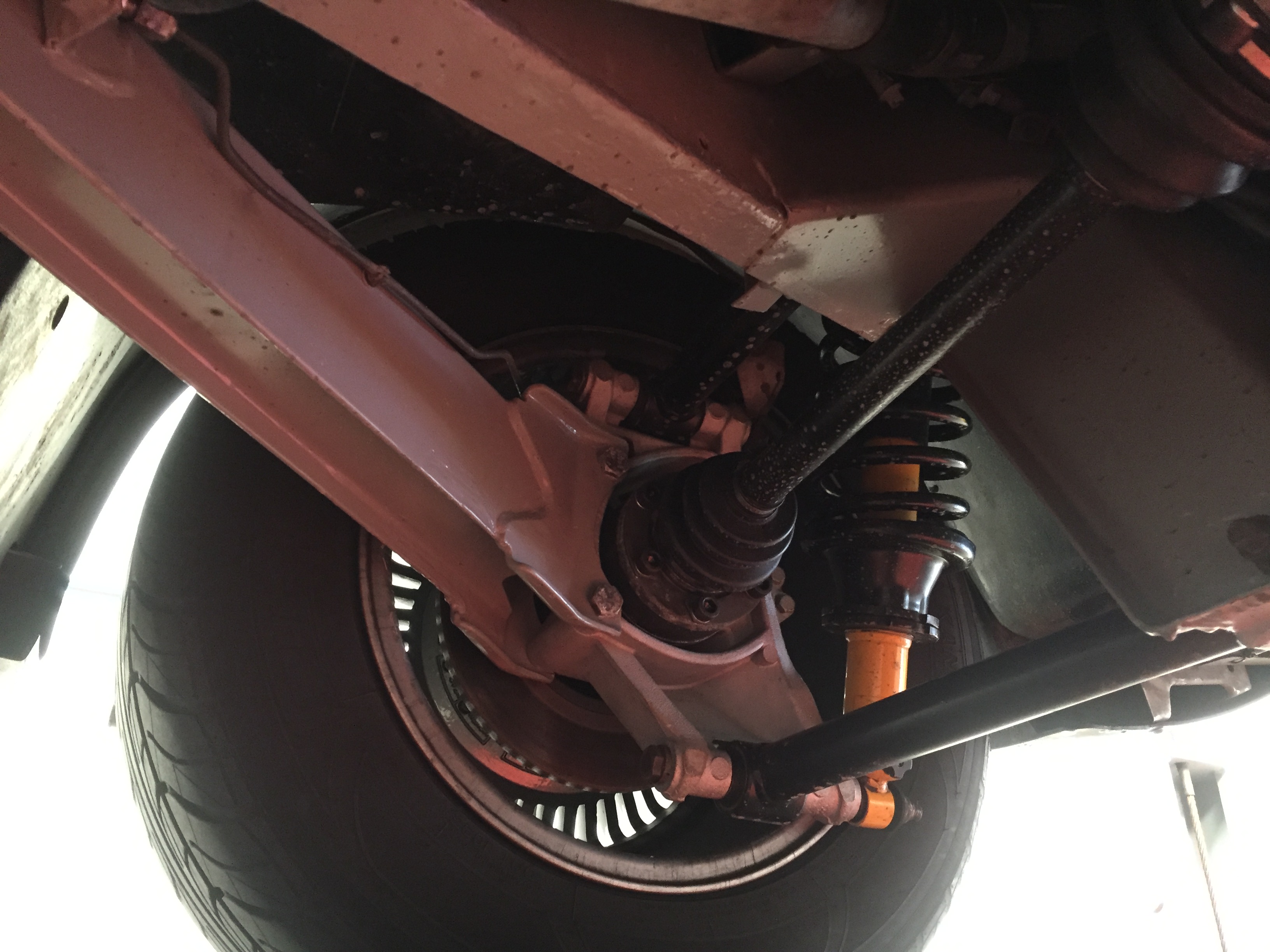

Hi Dan, I noticed you have changed the bolts for the driveshafts to cap heads. Where did you get those? The standard hex heads are a pain in the arse to do up as you can't get a socket on them I found.
Re: Bent Tabs worn TAs
Postby dmc4087 » Thu Feb 25, 2016 4:09 pm
Dan 6511 wrote:Hi Dan, I noticed you have changed the bolts for the driveshafts to cap heads. Where did you get those? The standard hex heads are a pain in the arse to do up as you can't get a socket on them I found.
Good spot, interested in this myself.
Postby DJK73 » Thu Feb 25, 2016 6:15 pm
Well spotted guys
That is one of the Dmods I have tried out for the club
Yes they are a pain with hex head and these cap heads are much easier to work with
You will be able to buy them from the club soon
Dan
